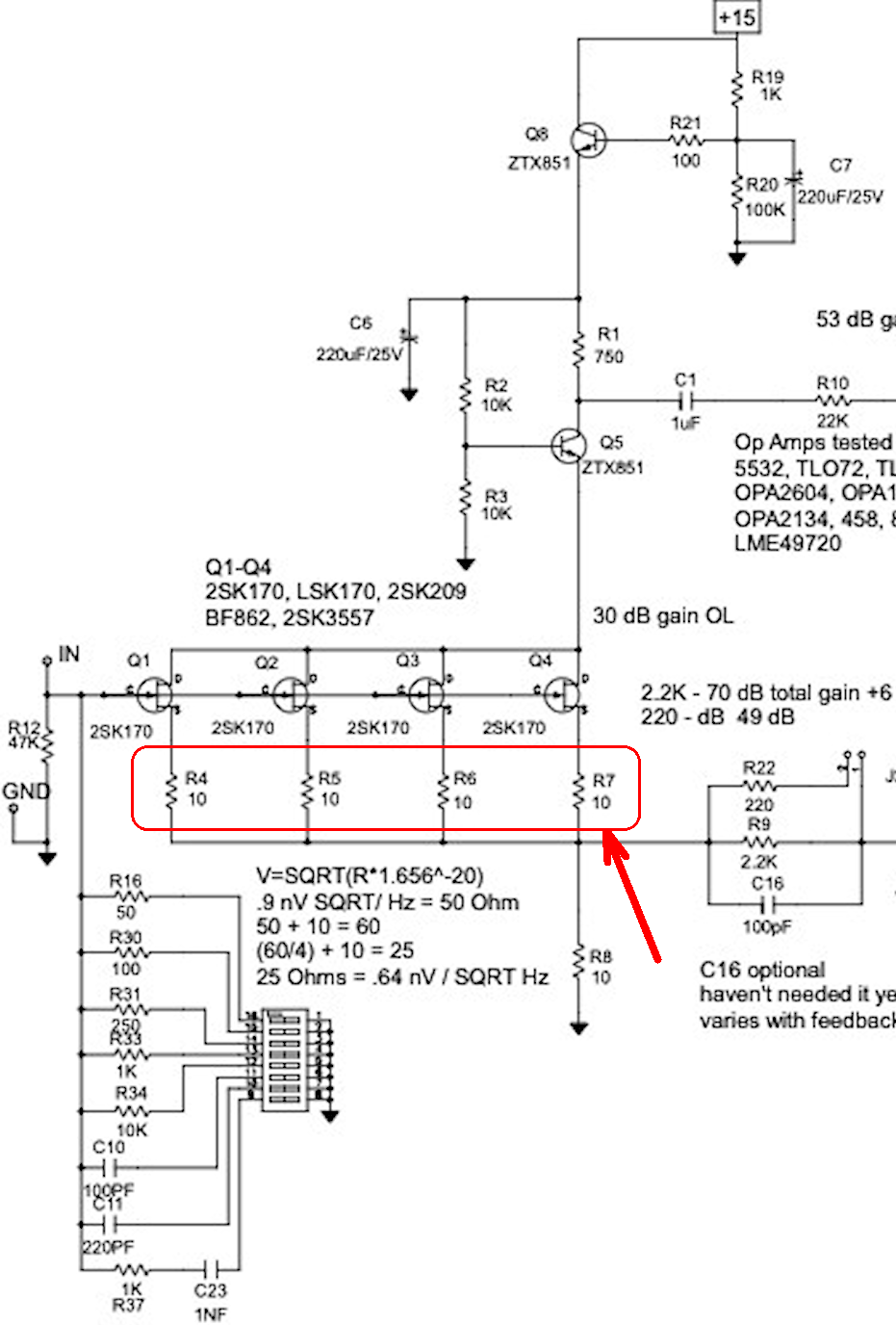

Ask your circuit designer to run a SPICE simulation of the Pearl 3 with wildly unmatched 2SK3557 devices. Have her simulate it twice; first with R4-R7 = 10 ohms as in the official Pearl3 design; then a second time, with R4-R7 = 0 ohms (short circuit). What is the effect of wildly unmatched 2SK3557 devices with, and without R4-R7?

I'll run it later this evening if i manage to grab some time away from new family member 😁
Passive HF eq. and active bass boost in the second stage combined with low supply +/_15volts voltage gives not so good overload margin in this phono stage. This RIAA topology is a popular approach of many american designers. All in one fully active topology is better for op amp based phono preamps. See Doug Self books.
My Borbely 419 and John Curl Vendetta clone which I built have the same RIAA topology , but they are based on discrete components with +/-24V power supply voltage. John Atkinson in Stereophile measured 32db overload for Vendetta phono for 0.5mv input. Op amp phono preamps have much lower overload margin.

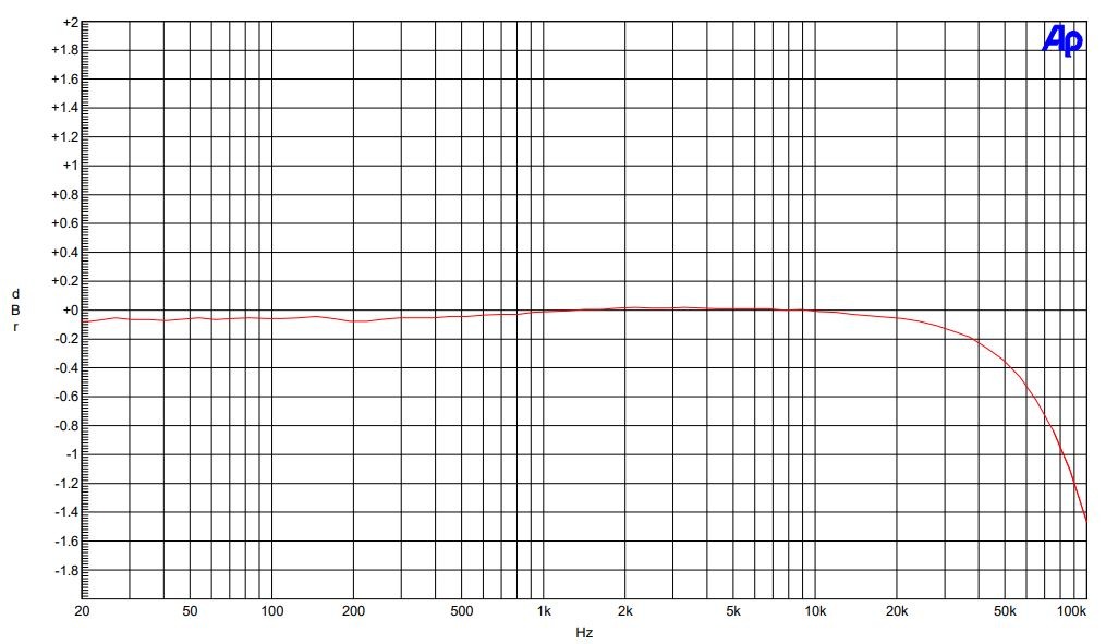

...so pretty much as accurate as any phonostage ever made, it seems.
The Pass Labs XS Phone state (which is a top of the line phono stage?) is specified +- 0.1 dB accuracy (20 - 20 kHz).
The Pearl 3 looks more like -0.1 dB accuracy (20 - 20 kHz)? .....so better than the XS ?
The spec is + - .1 max on the XS but typically better. This Pearl 3 I used 1% Dale RN55 and 2% caps measured to .1% because I could. I guess you could call it + - .05 dB. If you use the parts straight out of the bag with no matching even on the fets I doubt you would see much difference. But being diy you might as well chrome it or gold plate it like the boards that are coming will be.
I think the Dale RN55 also exists in 0.1% precision (from memory I think I got some of these.......packed one by one and quite expensive). But if you buy 100 of each in 1% for the P3 then it is easy to "hand select".
