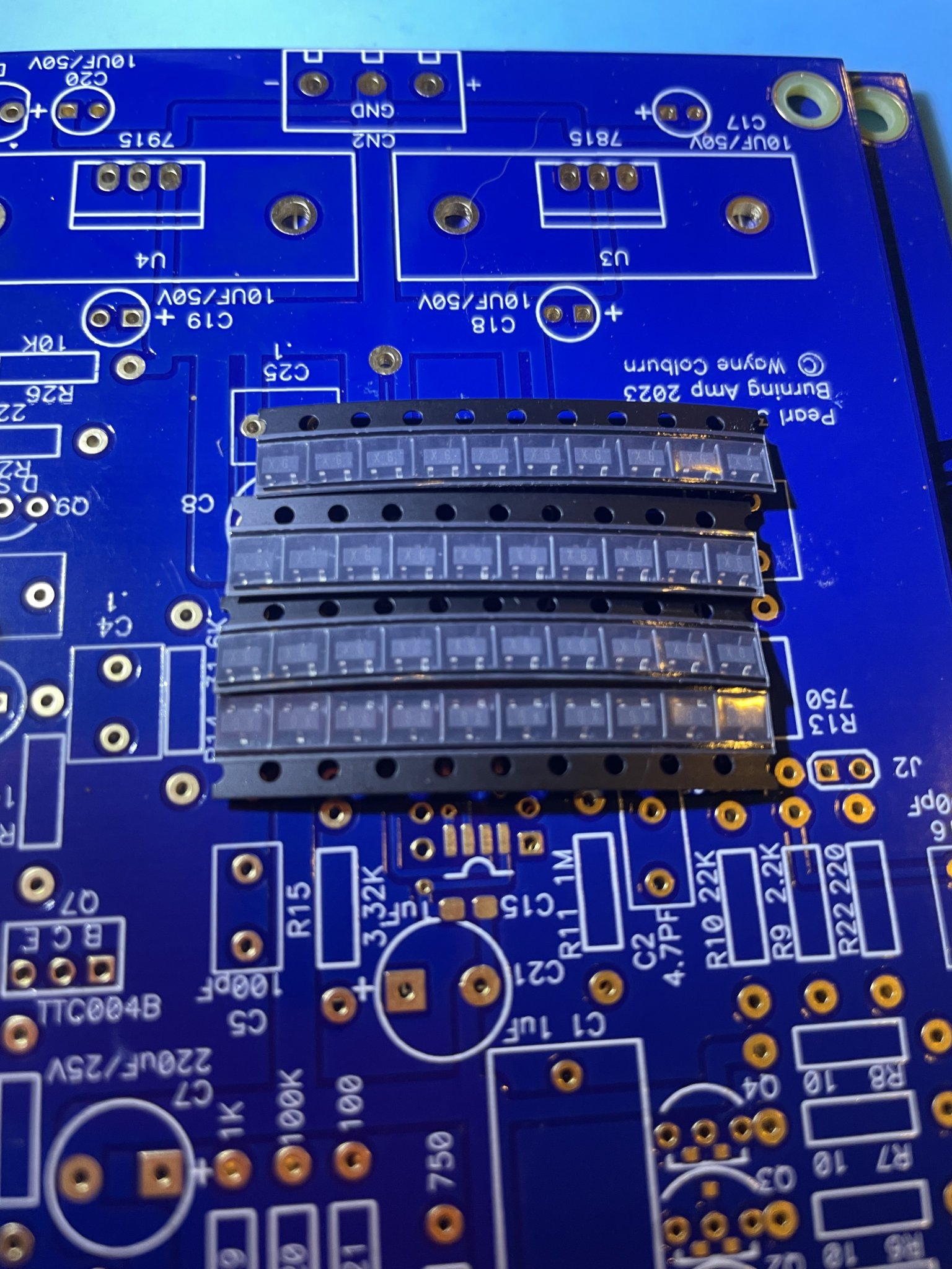

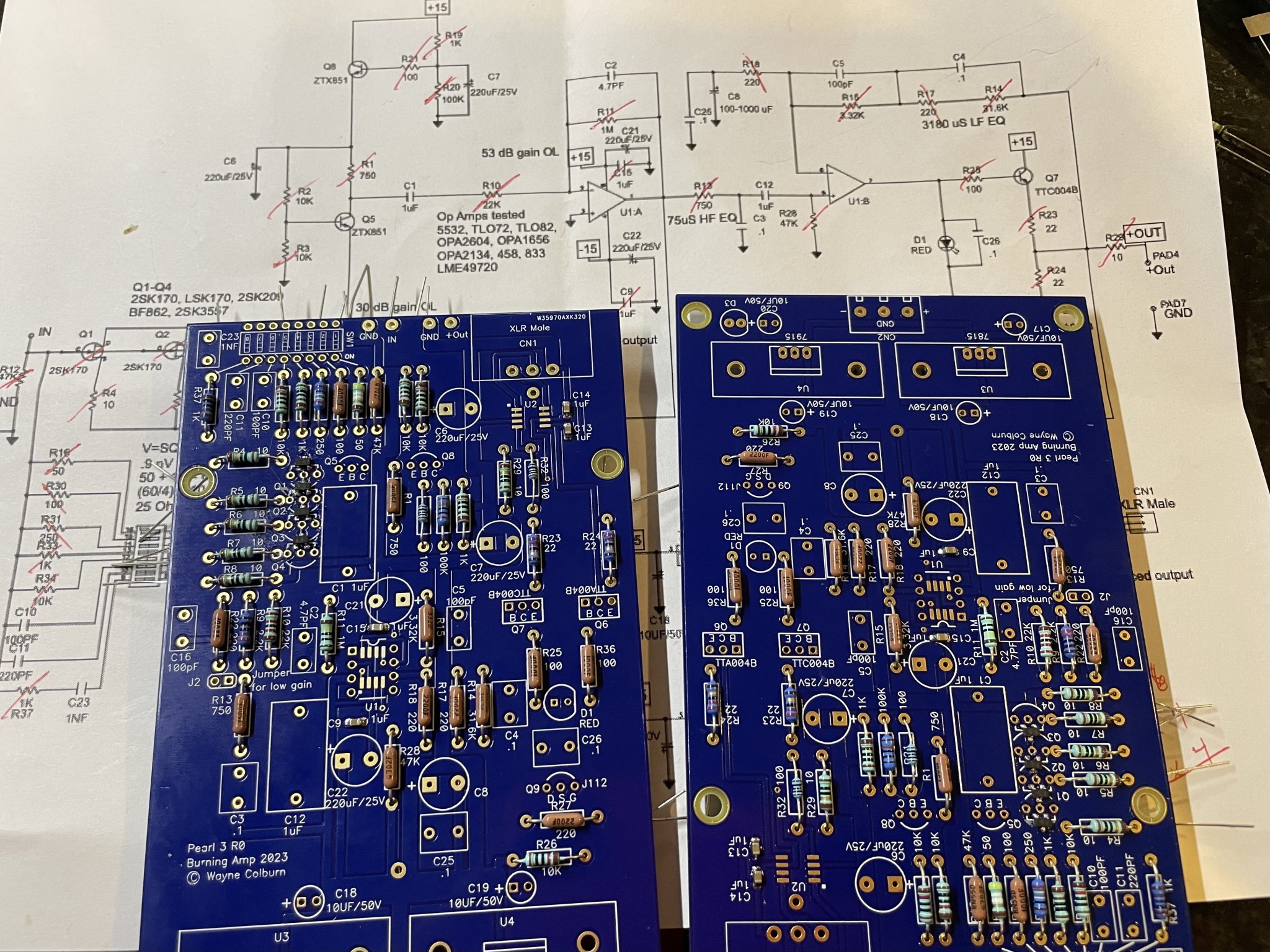

What is the desired current through Q9 (J112)? Someone had asked earlier but I didn't see an answer. (Hopefully I hadn't missed it).
Id 5.3mA from the simulation. (J5 in the attached file)

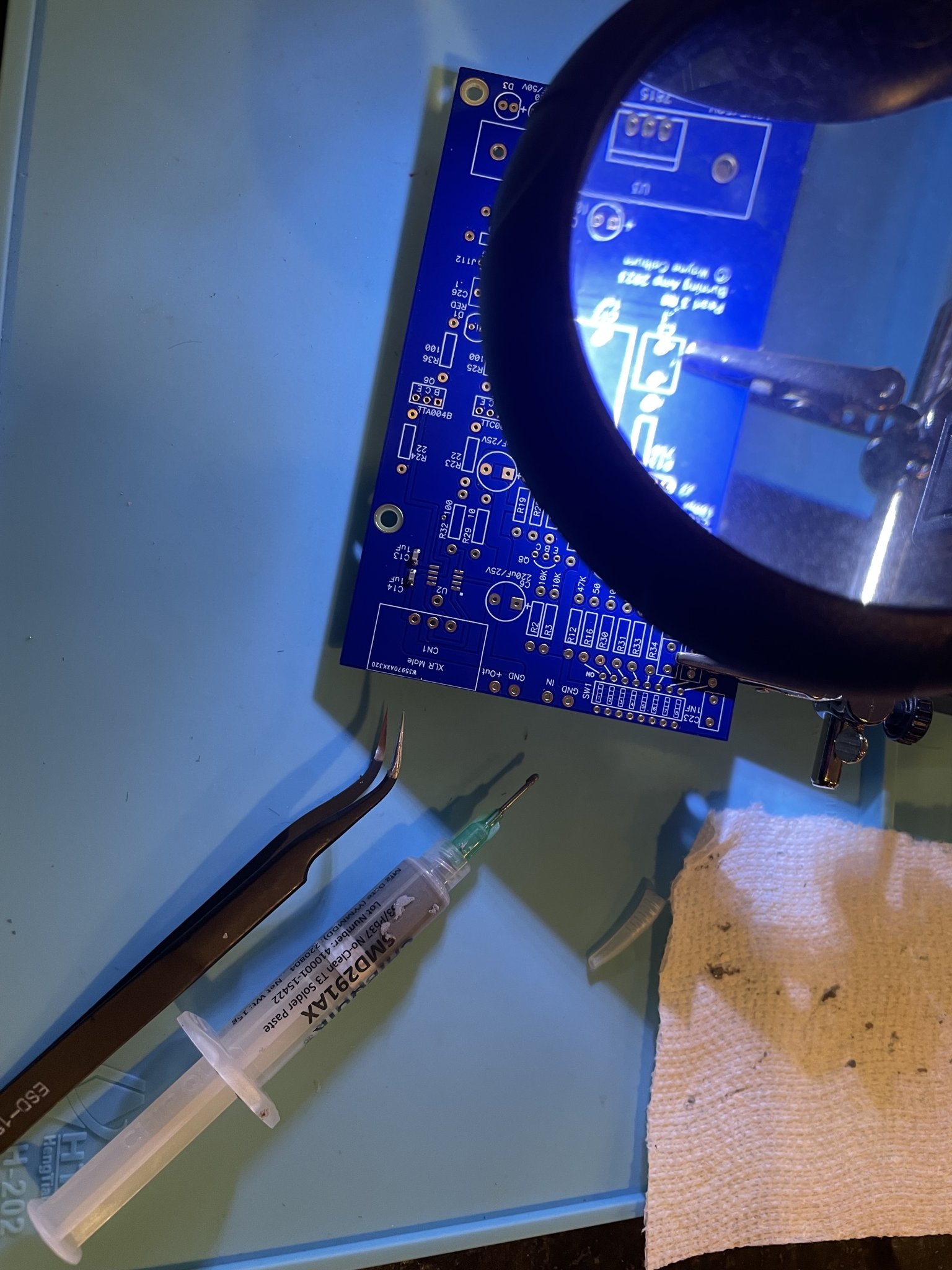

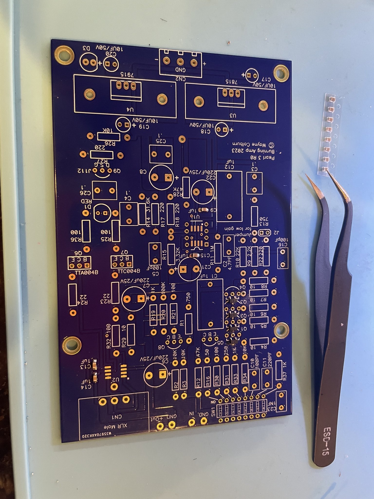

Any news on the timeframe, for the PCBs being available to order?
Everyting at diyAudio happens at the speed of volunteerism.
That said, things are nicely moving forward on Pearl 3.
