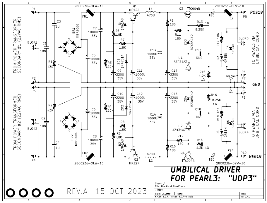

Circuit description here - https://www.diyaudio.com/community/...rl-3-psu-into-its-own-distant-chassis.404413/

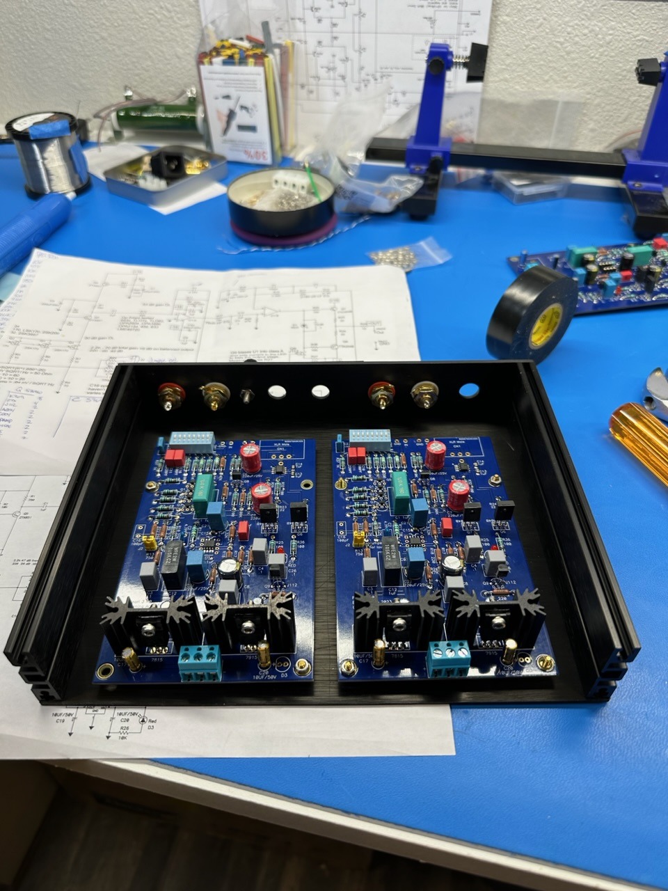

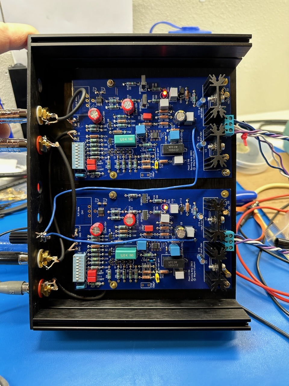

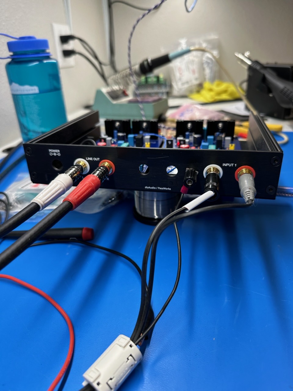

Running beautifully in my bench rig. Powered from my old HP bench PSU, not even a dedicated supply yet, and I am pleased beyond words.
Note the ground wires, they originate at the unlabeled hole on the PCB and attach to the ground post on the chassis.

Just wait, the crew is working on a turn-key chassis solution. It will be much better than the reused B1 Korg panel shown here.
