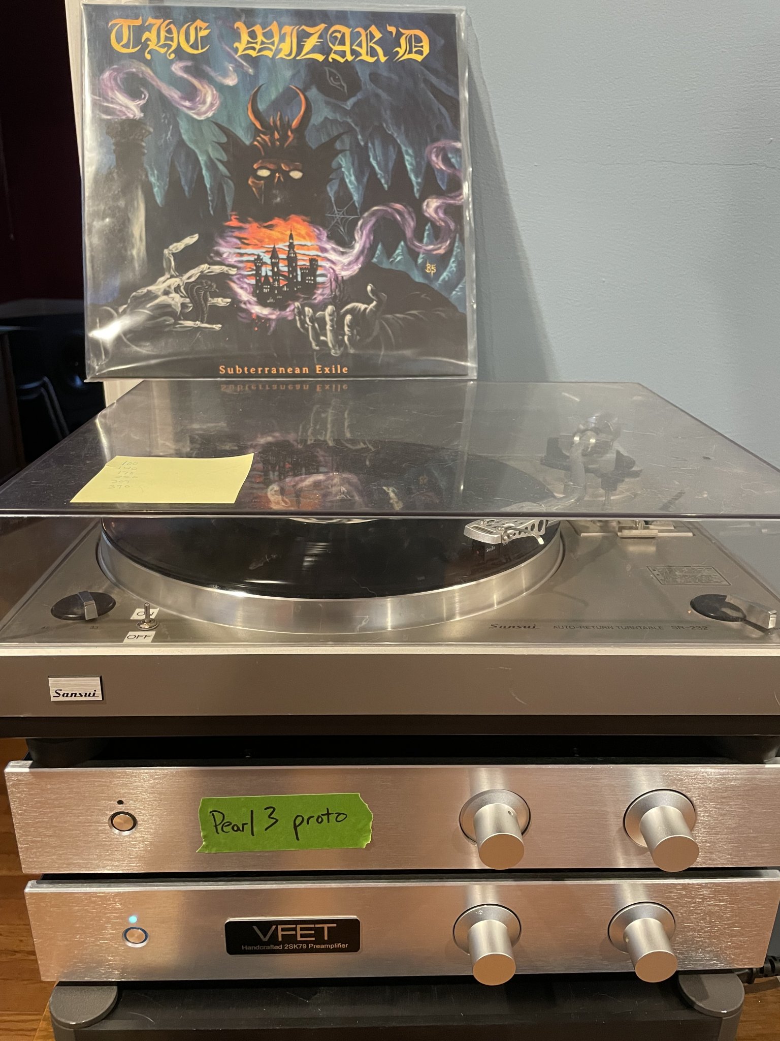

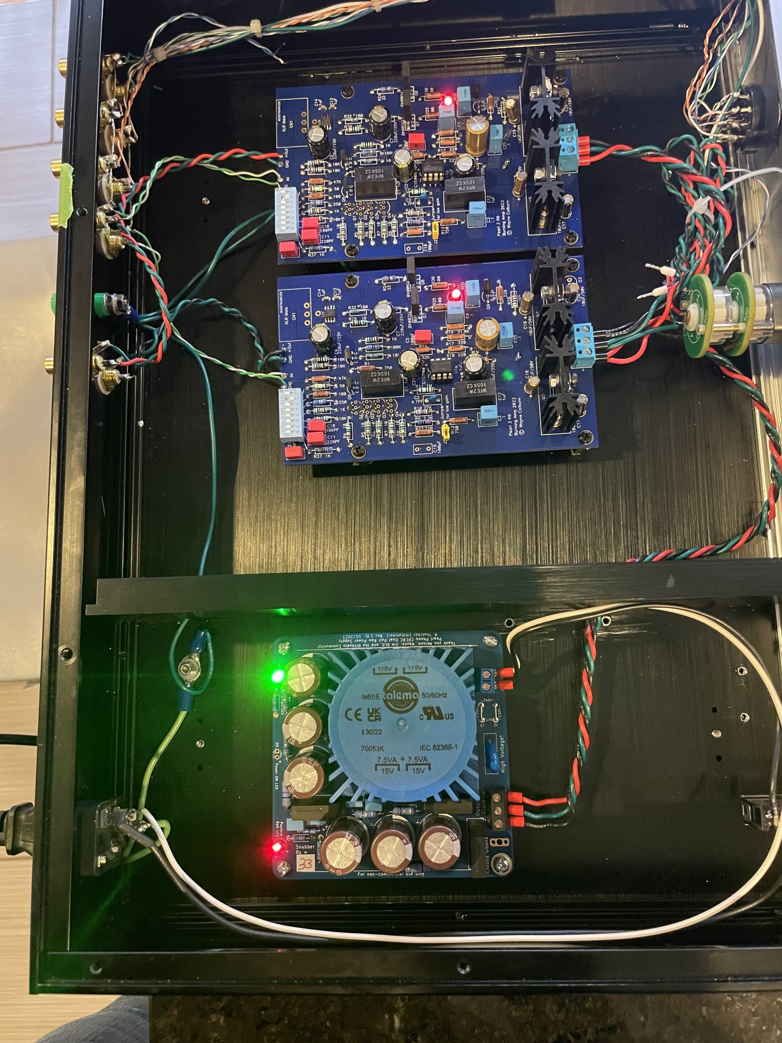

Single chassis prototype is singing. This is in a linestage chassis that is temporarily being repurposed for this test. Sounds great so far! I’ll move these boards to a 2 box setup next. First I need to finalize a couple of details with Gianluca.
Raw PSU rails are about +/- 22V
This setup is using a Shelter 901 MC set at 100R. High gain. And the first record Tasmanian NWOTHM / Doom band The Wizar’d.

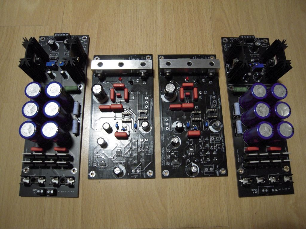

Hello PEARL 3 -phono-pre-freaks,
still some work left... 😳
Getting closer with my PEARL 3 - project.
A few OPAmp-leftovers from M2X and DRV134 and THAT 1646 - audiolinedrivers... Hmmm!
What's going on here?
Cheers
Dirk 😉
