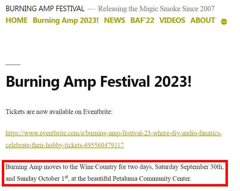

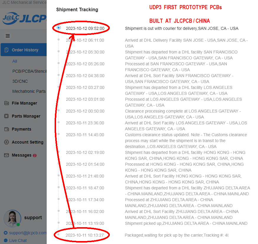

The timeline will help you decide: which happened first, the Burning Amp Festival or the UDP3 circuit boards?

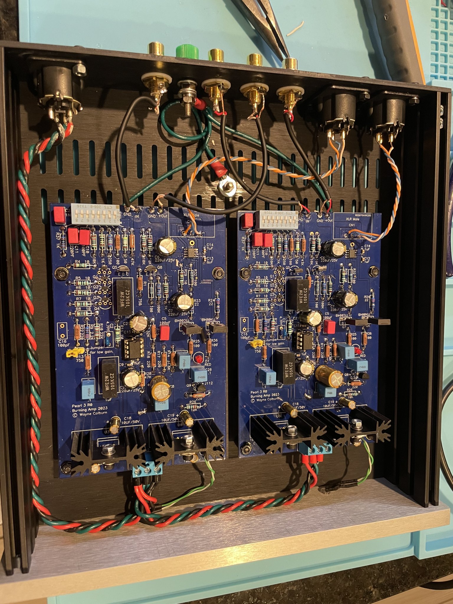

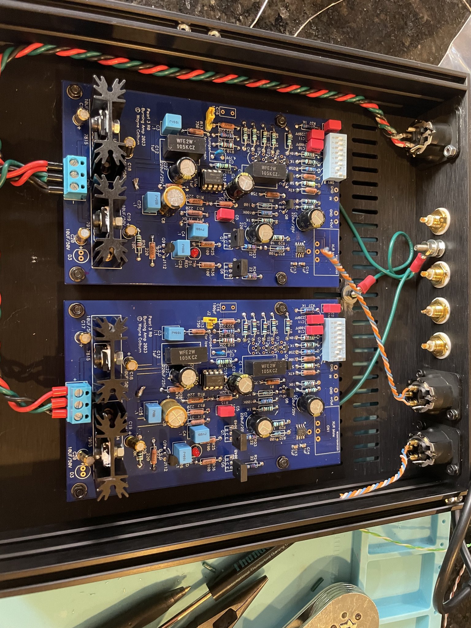

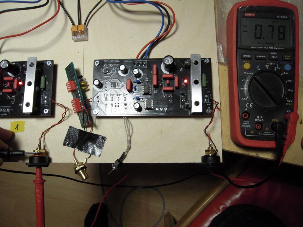

Good evening PEARL 3-builders,
today I started my boards the first time. It was a crazy day...
First, I adjusted the outputvoltages of my PSU to +-15 V DC - no problem.
Put two OPA2134 into the boards.
Switched on - no LED lighting - reversed. Repaired...
Switched on again - uuuh, LED on.
Some measurements (over the resistors):
voltages over pcb 1 pcb 2
R4 (10Ohm) 0,048V 0,048V
R5 0,048V 0,048V
R6 0,048V 0,048V
R7 0,048V 0,049V so, all JFets are running at 4.8 to 4.9 mA (ONSEMI 2SK2394)
R27 (220Ohm) 2,36V 2,37V circa 10 mA out of the J112- pretty high. Wayne suggests 2-5mA. I think I have to increasee R27
offset at output below 1mV 1mV was slightly fluctuating, but in both channels below 1mV!
R23 (22 Ohm) 0,34 V 0,338V
R24 (22 Ohm) 0,34 V 0,338V so, bias of the output BJTs is anywhere around 15,36 to 15,45 mA.
Enough for today. I am done.
Good night!
Dirk 😴

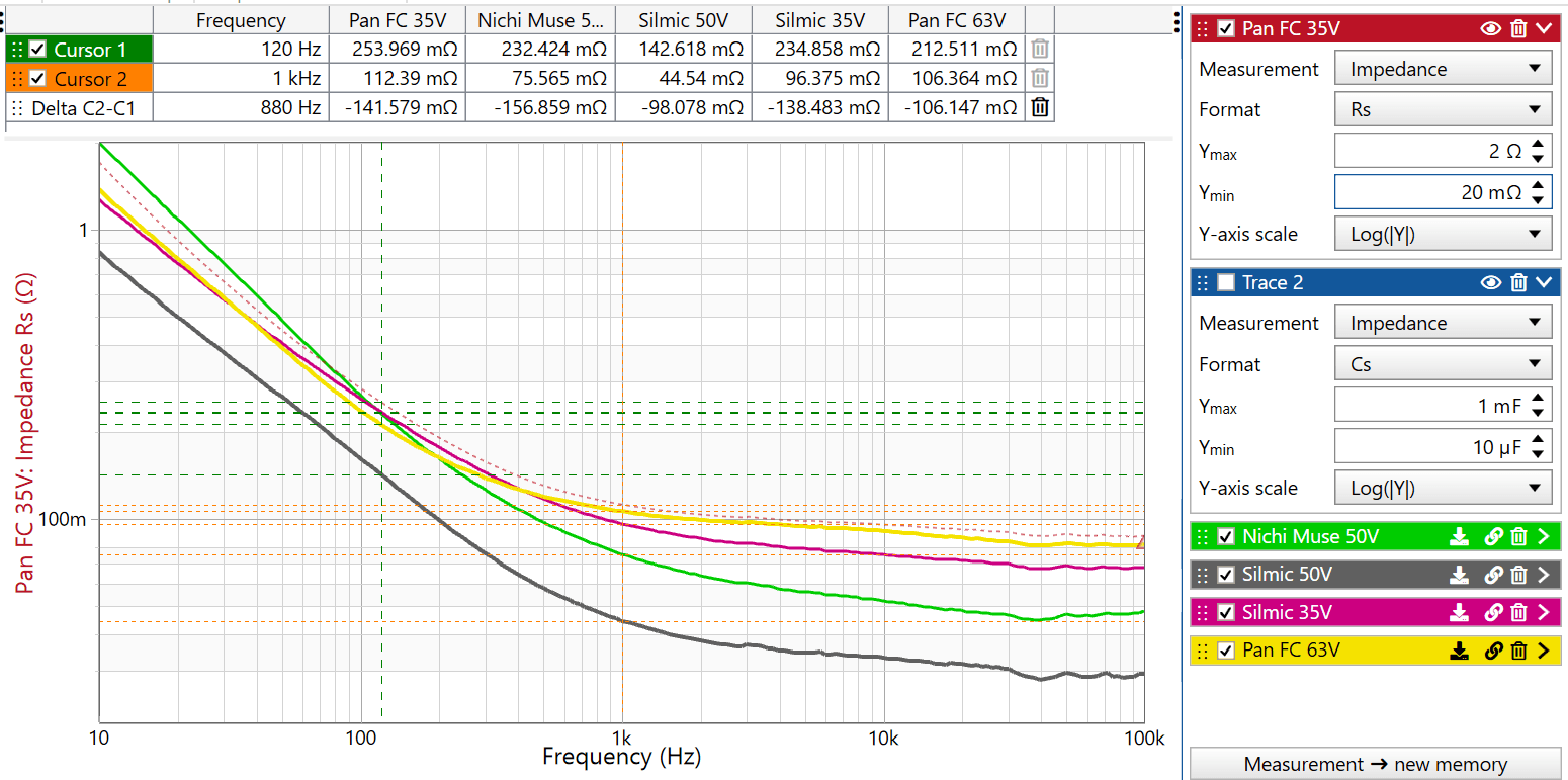

Yes for the 220uF electrolytics, 50V is okay. I wish the ESR wasn't so big and I wish the ripple current wasn't so small, those details will reduce its effectiveness a little bit. But the unit will work correctly and provide clean power to the umbilical cable, while you wait for the low ESR and high ripple current parts to arrive. Then when you swap in the correct parts the unit will work (a little) better and the cable will get (a little) cleaner power. Like when you switch your high performance sports car from 89 octane petrol to 93 octane.
I put aviation gas into the generator and my leaf blower.
For the noise test I illustrated a few days ago I used the Silmic 220uF 50V (perhaps I should have noted that.)
Panasonic FR and FM are among the very best electrolytic capacitor possibilities for the Perl 3 umbilical cable driver, if you can find them and afford them. FC not so much. Nichicon UHW are also top tier, but the UHW product line doesn't include a 220uF / 35V model.
