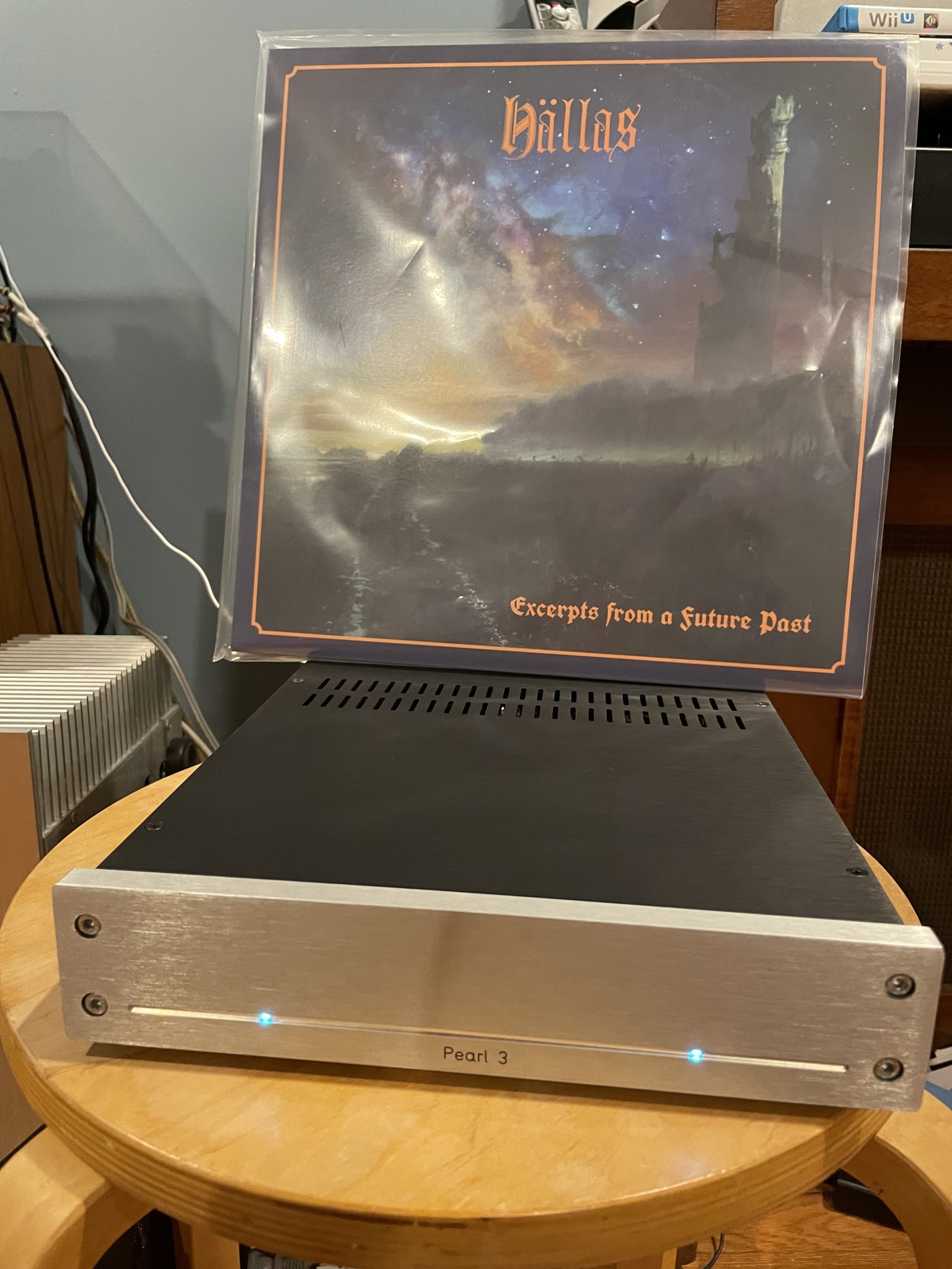

Sound is GREAT!
First LP is by a Swedish progressive “adventure rock” band I saw over the weekend called Hällas. I can say they were a Top 10 live act for me, and that’s in a very large pool of gigs I’ve enjoyed. Volume is LOUD while my wife is out for the next hour.

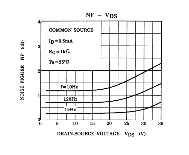

Regarding the Noise Figure for 2SK209 I found this curve in data sheet:
dB ? .....how can this be compared to the nV/Hz-2 "figure"?
Ok......Google is your friend......I understand it now......or better......
https://rahsoft.com/2021/05/26/what-is-snr-and-noise-figure-nf/
From a noise perspective the 2SK209 isn't as quiet as the 2SK170. The Data sheets both have noise references in dB and the 2SK170 also has nanovolts per square root Hertz. A quick way to look at it is to compare the transconductance of 15 mS Vs 22ms. With 4 in parallel 450 pV vs 530 pV. This is close enough.
Ok, nothing to worry about.
