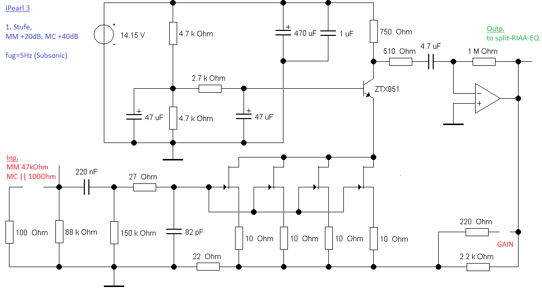

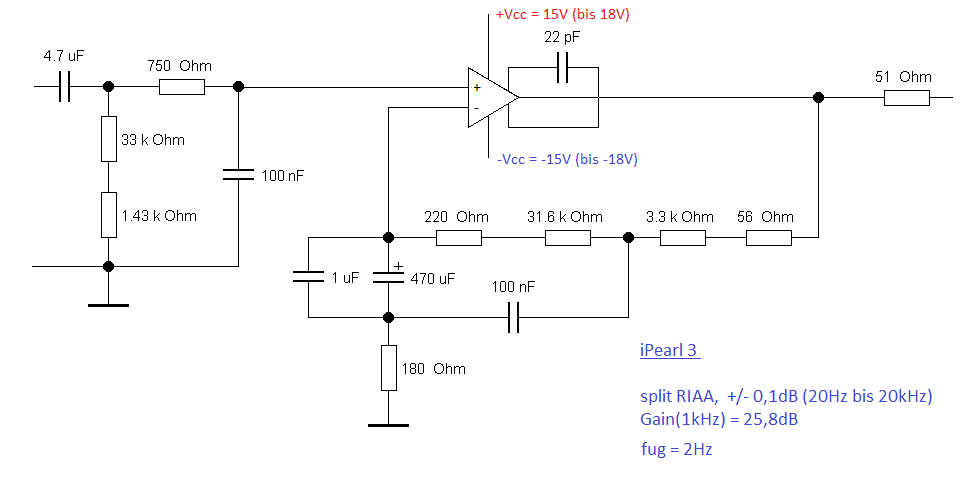

Without the outputstage Q7 & Q6, in my opinion you dont need it, i prefer a sligth modifikation for the secondstage. OP-Amp. is the NE5534. The accuracy of the RIAA-Fit is a little bit (with selected and matched component) better then Mr. Colburns choice - original design of the EQ.

A question of taste? Some quick modification of the firststage, now with more openloopgain for better distortion and control at LF. I like a -3dB (approx 5Hz) cornerfrequency at the beginning of the chain, so i add firstorder highpass ...
OP-Amp. maybe TL071 or even better.

If you plan to use single opamps like NE5534A, you'll need to create a new PCB layout. Wayne's PCB layout assumes the builder will plug in dual opamps like OPA2134.
You might want to take a look at post #146 of this thread. Wayne posted Pearl 3's measured frequency response RIAA inaccuracy. Measured on an actual, physical Pearl 3 in the real world {not a circuit simulation}. Here's Wayne's plot from that Forum post:

Hello Mark Johnson,
your are right (i know), but the idea is not only based on simulation. In the past i build many Phono-EQ's, measure and compare it. Also i hear Wahne's explanation and see the impressive frequency-response ...
What do you thing about my quick posted schematic, sligth variation of the original ciruit?

It's an illusion to get a better overall-fit of +/- 0.25dB. The deviation in our realworld buildings of RIAA-EQ's with pluged pickup (and cord, or wire) is never better that figur. Sometimes better, sometimes worse - it depands on clever choose the circuit, the OP-Amp, the value of components ... material, device form, the routing, ... in my example of the inputstage with TL071 you get +0,3dB to -0,1dB, with NE5534 +0,1dB to -0,1dB -> never better! It is impossible to get better flat response as +0,3dB to -0,3dB with 1% tolerance resistors and 2% tolerance capacitor - "belive me" [quote Douglas Self].
Not only the best approximation (with no derivation) counts. In Wahne's prototype he used the best approximation to 100nF. In my deepest respect to Wahne's (knowledge and overall-measurement, and the AudioPrecisionSystem, ...), but how did /get Wahne the measurement(?).
It's a nice EQ, i like the approach and implement that topologie many times - nothing really new, but quite interesting every time.
The core of the Cambride Audio 651P, the split-RIAA-EQ, is theoretically (with nominally value of R's and C's) much better, namely +0,03dB to -0,01dB. The problem is the inputstage, in particular the MC-Stage.

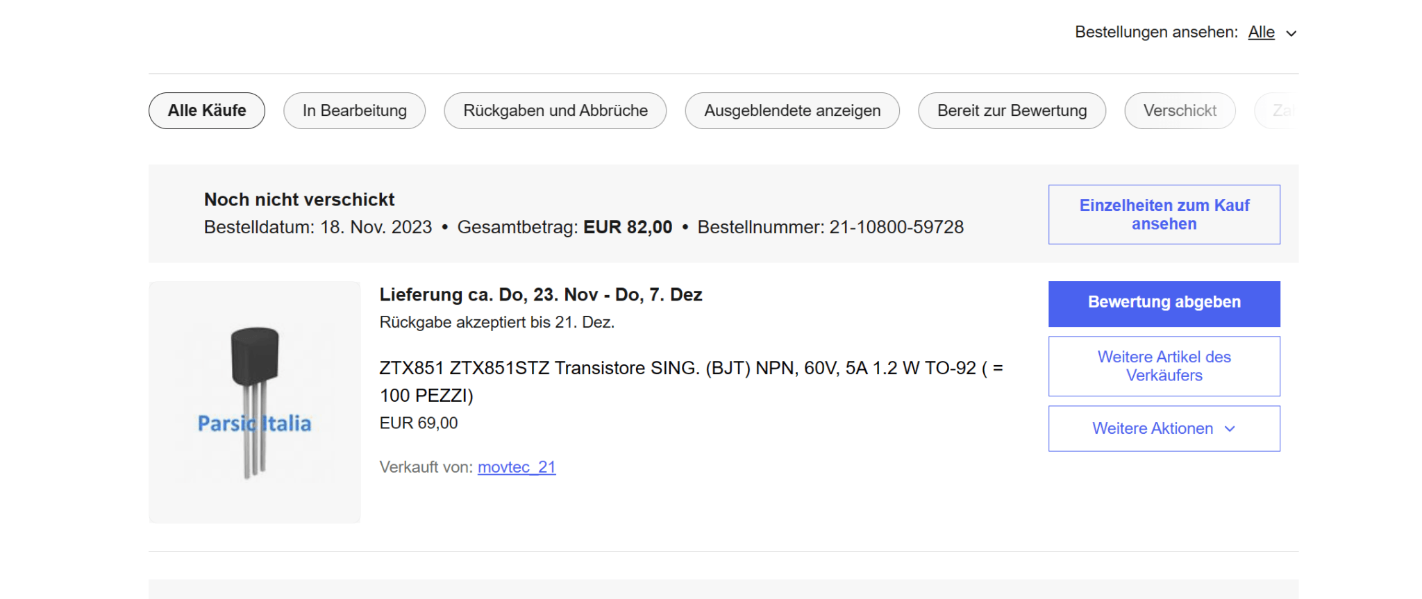

At least it was possible to order 100 pcs (from seller movtec_21 from Italy). He has a lot more and also have 250 pcs packages (which is of course cheaper).
I also got confirmation via email now. Paid with PayPal which is good. If any troubles I can get money back 🙂
Now I have used enough money for today I think 🙂 ......time to go go bed......
