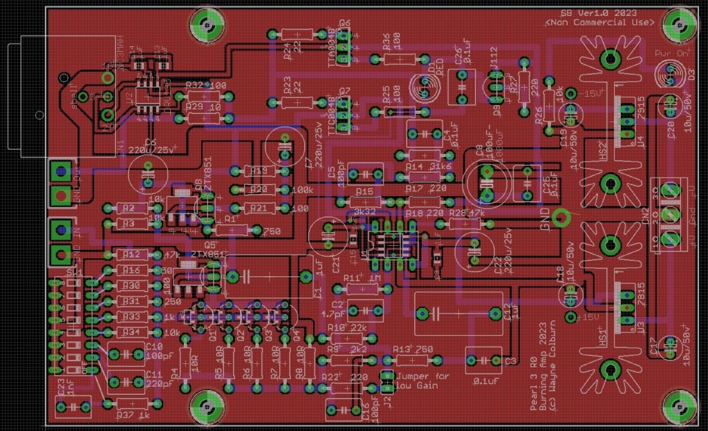

Have a look at the first stage with the JFETs. It connects to the positive rail but not the negative rail. It draws power from the positive rail but not the negative rail. Eureka.
If you wish you can solder a 1.5K ohm, 0.5 watt resistor between Vneg15 and ground, which will increase the negative rail current draw another 10 mA. Now both rails draw 55 mA and balance is restored to the Force.

Some progress…. PSU checks out, no drama (thank you Mark!). Faceplates to come.. Lid not done…
@rhthatcher and @6L6 are putting together a build manual that will have Mouser and Digikey part numbers. I've put together a mostly complete Mouser cart to assist them in the effort, but the complete parts list and build guide are being worked on by those fine gentlemen.
At this time, it looks like it will be necessary to obtain parts from more than one supplier.

if it's intended for Store (agreement between Wayne and DiyACrew), then it's matter of proper manners not to post (anyone's) gerbers in public

Having the boards in the store helps support the diy website.
The boards are also a known quality to help insure a successful build.

What is the benefit of having the discrete output stage? Just higher drive capacity?
