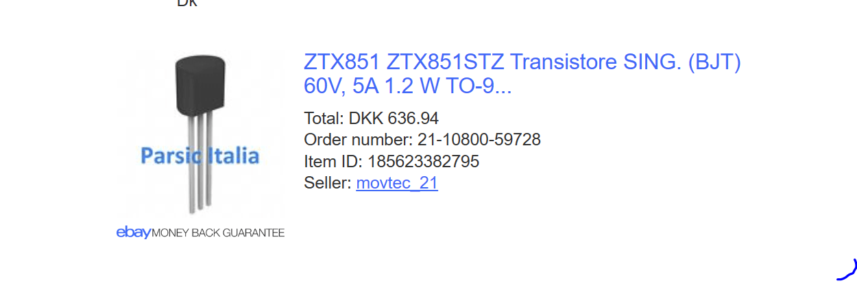

Has just been shipped (100 pcs):
Assume I get genuine ZTX851. Can see from his ebay shop that he sells a number of older vintage semiconductors. Germanium stuff also......
Ok.....price a bit higher than from "normal" providers. But in low numbers ZTX851 is not the cheapest......anyway.
i guess I get plenty now for one P3 build. I can match them very closely
