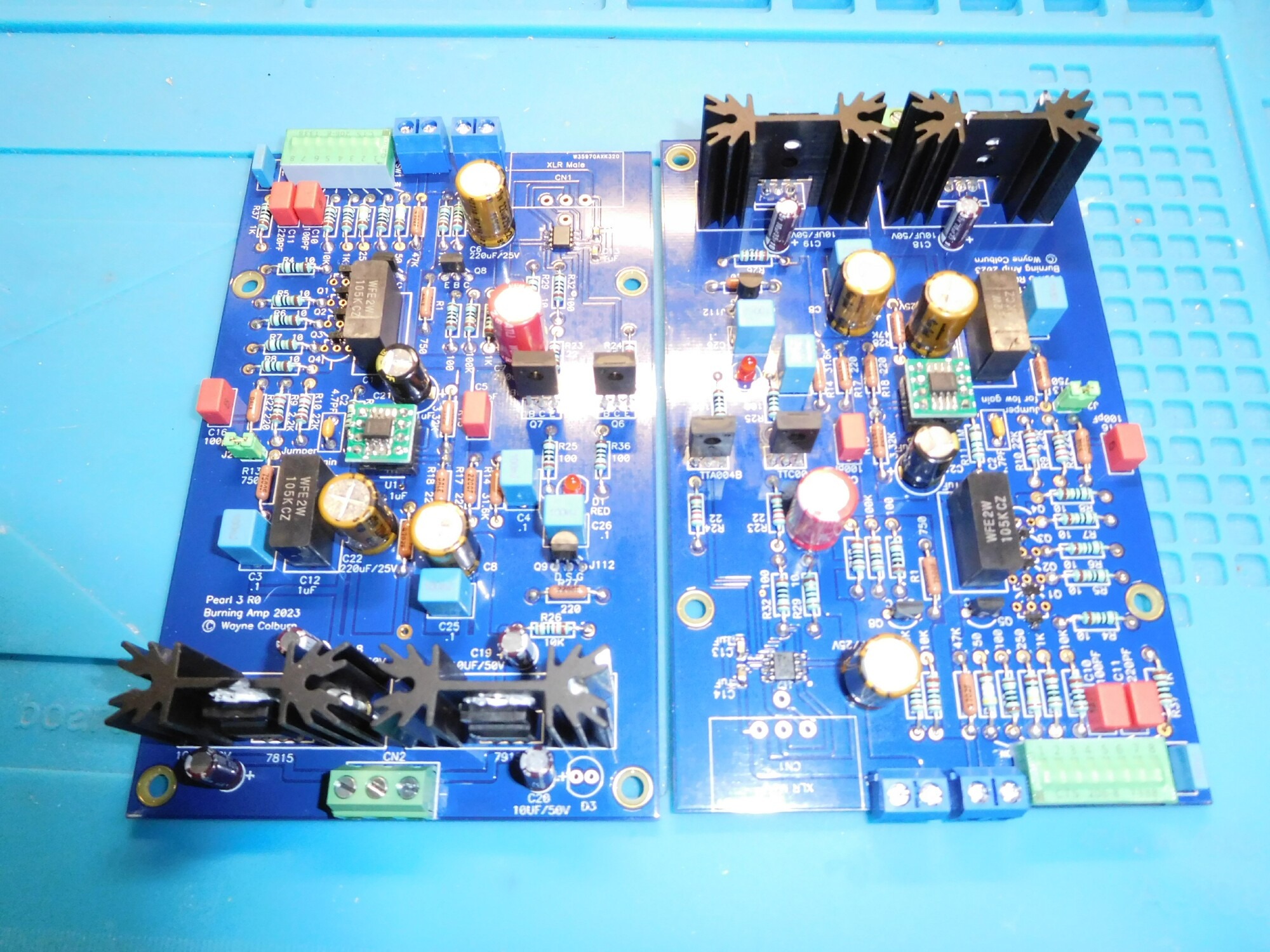

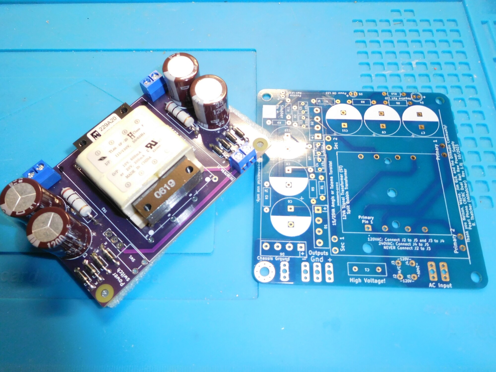

My boards are finished, but I'm still working out a chassis, either permanent, or temporary if I get the official version. Also, I had intended to try it first with one of my own PS board assemblies (lower Voltage example shown), but realized I have already used the 0-15, 0-15 flat pack transformer I had, so now I'm waiting for parts to complete the project-specific PS.
In the meantime, I will wire up some signal connections, connect my reverse-RIAA circuit, and run some initial function/noise tests with my lab power supply.
