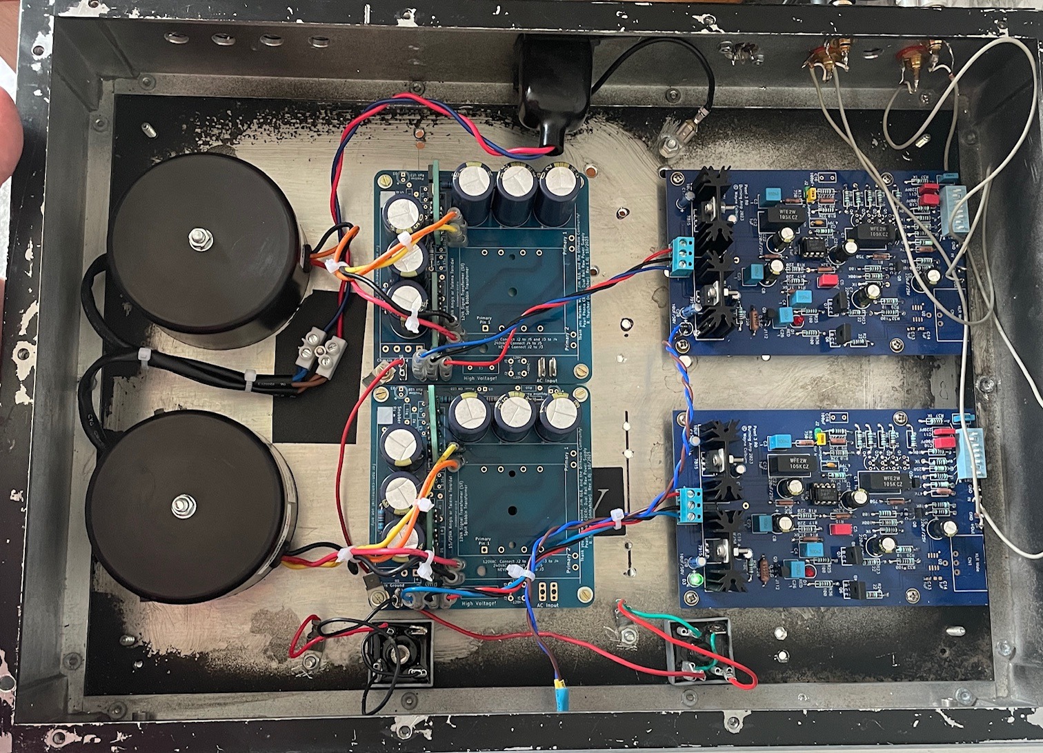

I have been enjoying the Peal3 with just a single PSU but noted some have had nice results and Wayne suggested give it a try with a Duel Mono setup. I was using 30,000uF 63v CLCRC but this is to much uF IMO and to high V, Im back to 4700uF 25v caps CRCRC config. As you can see I just threw this together just to see (hear) the benefit/s.
Yes there is clear sonic benefit to Duel Mono, more drive, dynamic and perceved clarity and or a deeper 3d sound stage being able to pin point vocals and instruments in the presentation without loss of musicality. Its quite a lift.

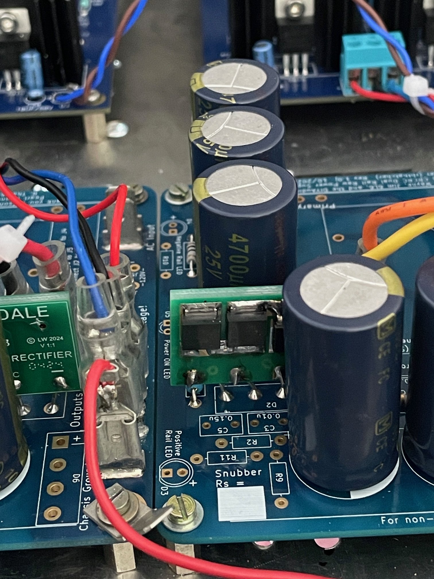

As a side note..I have used the Avondale Audio FWB3 module (bridge rectifies) these have the ability to null transformer ringing so no need for the snubbers with these PSUs.

My Pearl is working well except for the front panel LEDs, which I managed to reverse my wiring at the LED legs,
. Before I replace them, I am concerned with the voltage that I read, 20v on both sides?

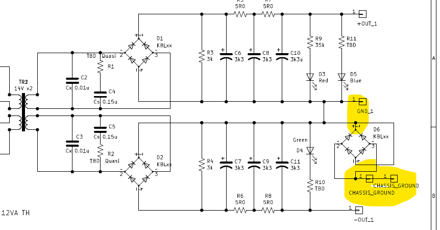

aside from the off board transformers he appears to have a pair of chassis-mounted bridge rectifiers...@laverda - without D6 installed please your check the connection from the audio ground to chassis ground. Is it floating?
The issue is that the audio ground is connected to the 2 chassis ground connection points (corner hole & wiring point) through D6. Empty D6 - no connection. So the bridge on the chassis floor appears to have no connection to the circuit.

agreed. those diodes should be wired to the D6 "+" point.
on the other hand I still think this ground lift bridge might easily be wired past via the grounding in the signal chassis and the umbilical.
