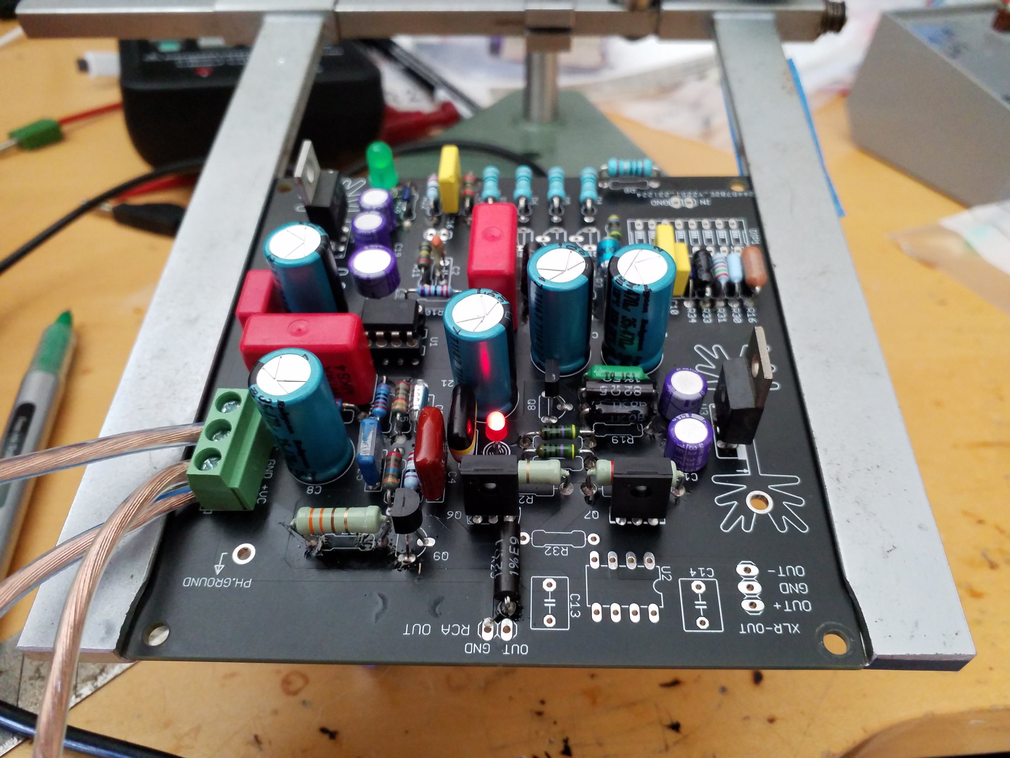

One thing I have seemed to notice about builds here, is most problems are reducing hum or the like. Has anyone had problems with the tiny parts ( SMD) and their installation? I noticed on
Wayne's BA line stage that cleaning solder residue from around them is important as you would expect. However, everyone seems to have taken to them with greatest of ease. I know I had my doubts. I haven't yet invested in one of those hot plate deals, only by hand...

I would not say that. There is definitely a learning curve.
Solder / flux paste in a syringe works well.
Hot air tool from sparkfun.com
Solder wick if you need to remove excess solder.
procedure
Wash, rinse with drug store 91% alcohol and dry the PCB.
Apply small spots of solder / flux paste to the pads on the PCB.
Place the part(s) on the PCB.
Slowly heat the PCB and parts with hot air tool.
Move the tip of the hot air tool closer to the PCB.
watch the paste sizzle, dry and the solder melts and flows by capillary action onto the PCB pads and part legs.
Move the heat away.
Cool.
Wash with drug store 91% alcohol and a firm tooth brush.

I'd been imagining putting small dabs of solder onto the device pins, flux the boards and "pin" the device in place with downward force, heat... then cool. and clean.
the notion of locating the device by soldering one pin first, then the rest. with very "local" heat so as not to disturb "done" joints or have the device "skate" on the board (Canadian, eh) seems a good one.

that's another problem besides not having hot plate thing, I do not yet have hotair gun. Not a lot of experience with the tiny critters, just Waynes line stage, two of them and the Pearl 3. First go round I used the helping hands and chop stick method to get one foot tacked in place. Then did others.
Last couple times tape to hold in place, get one foot, do rest as before. And some tiny capacitors on Pearl 3 as well. In all cases I used Hakko solder station, tiny chisel. Tiny. Looks pointed at first, closer look chisel, by hand. All worked fine so far, you never know.
I know there are some even tinier pieces than these I did on Pearl 3 and some with mutiple legs. Your method would be necessary for sure, and for me the hot pad deal and air gun. So far not necessary.
My point was I dont see builders of these particular projects having trouble with them. Most of it just ridding any noise grimlins. I did qith 2018 BA line stage. Once scrubbed back of board with alcohol it was fine.
Just do one pin, then others are in place, hit them.@DualTriode

if you put dab of solder on the pins it'll be a small dab... or should be... because the pin is small. in effect just tin the pin..
one thing I've observed in many of the photos of projects is an excess of solder. my thinking is to try to head that problem off at the pass.

If there is an excess of solder or even solder bridges that is what solder wick is for.
