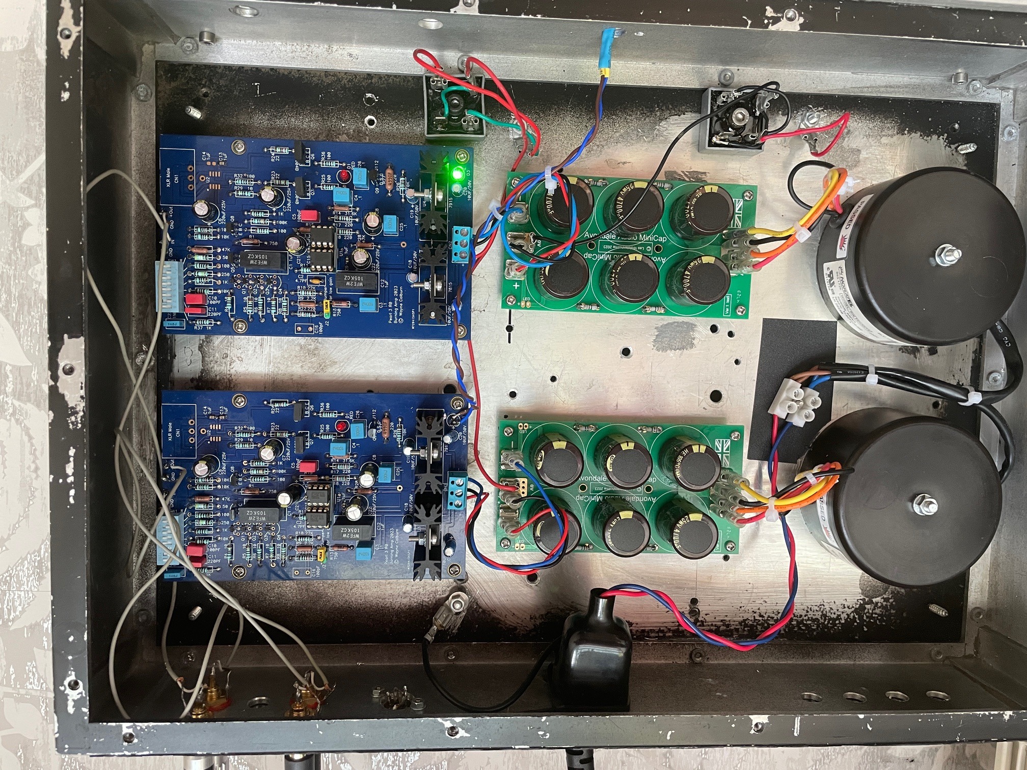

Yes it must be, the PSU 0Vs are connected to the + pos of the bridge. The AC's are strapped to the chassis along with the IEC safety earth to chassis.@laverda - without D6 installed please your check the connection from the audio ground to chassis ground. Is it floating?
Totally silent, very impressive.
Been doing some more 'auditioning' of PSU's. The Kit PSU's I was using in Duel Mono config don't belong to me (built some more P3's for others) so I had to use my own, which was originally 30,000uF 63v. So Ive now swapped those out for some 4700uF 25v with Nichicon (so called) Audio Grade CAPs4700uF 25v in the CRCRC config, the rectifiers are SMD's on the under side of the board.

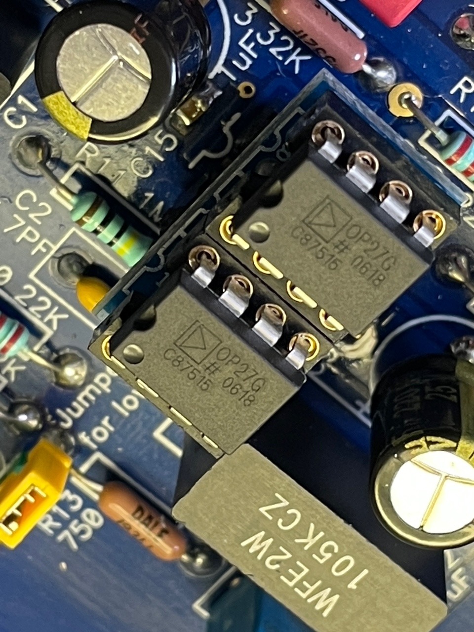

and opamps.... These OP27's singles, sound really good, yes I'm pushing them at 15v (these are at least 20 years old should be 12v new variant will run to 22v) but back in the day used these in a few CDPlayers with great results. Early days though....
There seems to be a benefit to running two single opamps.
