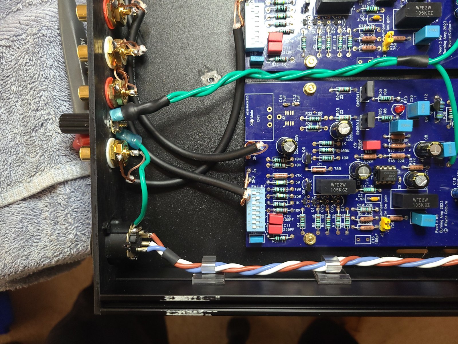

Third rca from top, red on next to ground on back panel. Is that a little strand of wire ina loop? Kind of looks like it's from a ground, touching anything?I re-did my ground connection as per @GKTAUDIO's suggestion, turned on the Pearl and immediately had a very pronounced 120 Hz hum playing through all inputs with or without mute, though it was several dB louder on the Pearl input. After being on for about 45 sec. the hum dropped significantly in level, still noticeable with my ear to the speaker at a reasonable volume setting.
I certainly appreciate all the help, and would love to determine what is causing the problem. Especially if there is a ground issue in my wiring.
The level increased a bit again, and when I powered down my Aleph and re-started it the hum was present briefly as the Aleph powered up and dissipated. The hum does seem to be the same that I experience until the Caps charge in my Aleph. It's just that it comes and goes!

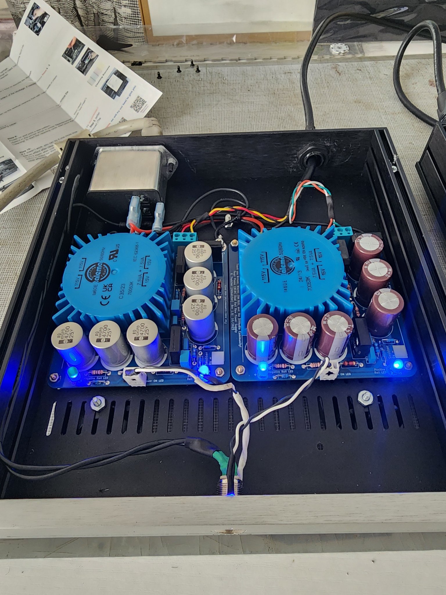

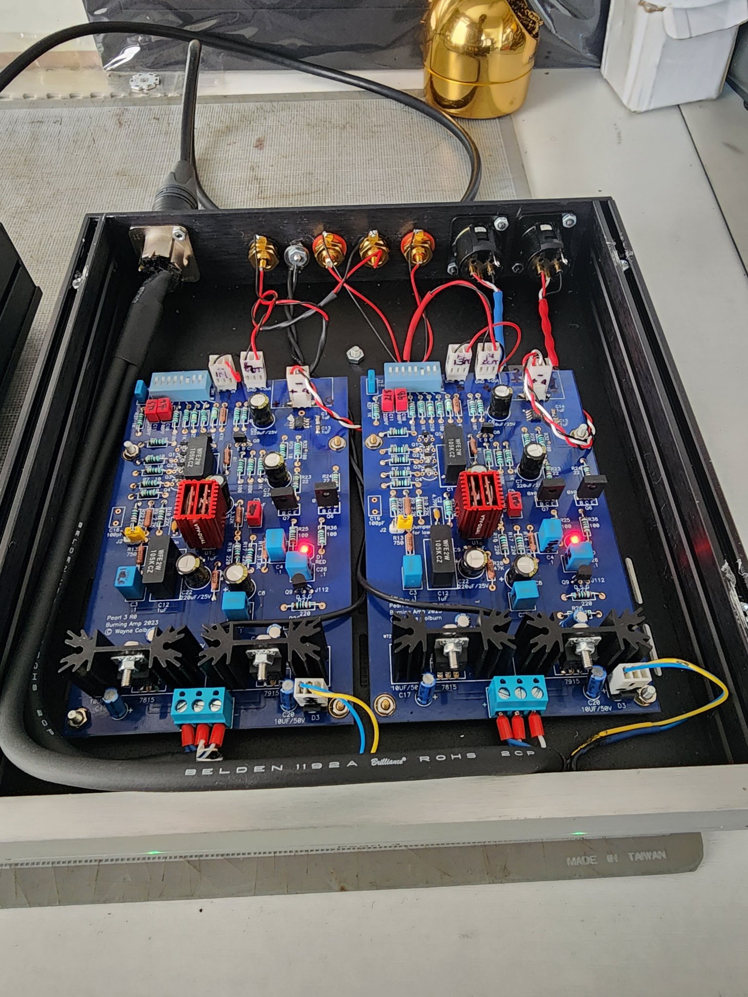

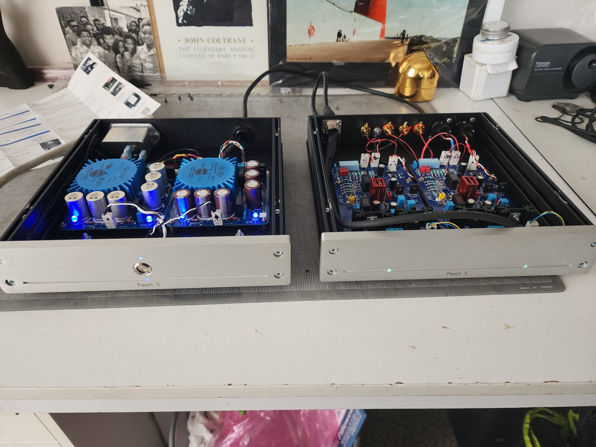

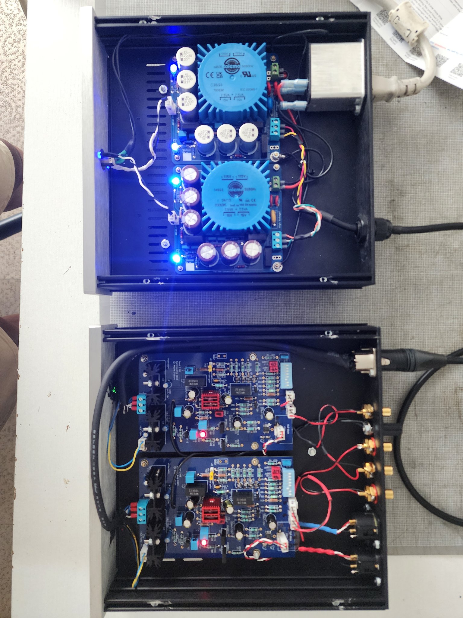

Thanks to 6L6 and rhthatcher, the beast has grown a second heart - Dual PSU.
I had to finish my Burson v7 review (I will post it soon) before I built this, so it's just done.
I'm still listening to it, so I'd have to evaluate it more carefully, but I can say that it sounds better.
There has been a subtle change, with more precise placement of instruments and a little more clarity and precision, but we cannot be certain.
Definitely a change in tone, and I have to figure it out.
So much fun building it.
r27 report - Left: 575ohms giving 4.989mA
Right: 581ohms giving 4.869mA
@PhopsonNY: Congrats and hello to the Dual PSU world! Your comments are excellent and you might want to compare my thoughts above, #3839. Timbre is a definite improvement -- first I found this to be fuller and more secure realism. After turning my entire chain into separate PSUs for each channel, this trend continues and I am listening to both vinyl and digital sources with the "turtle" chain intact. Beyonce, for eample, sounds throatier and darker now with the Dual PSU approach added to Wayne's linestage. Have decided that what we are doing is making each channel more accurate and powerful with a discrete power supply and this brings out more of the original studio sound and intent.
Looking forward to your additional analysis of timbral changes.
BTW, see that you have added a second Pearl PSU that doesn't have the regulators. For this reason, you might not notice as much noise improvement as those of us that are using Dual PSUs with regulators. Randy has referred to this as "pre regulation" and notes it improves the noise floor.
