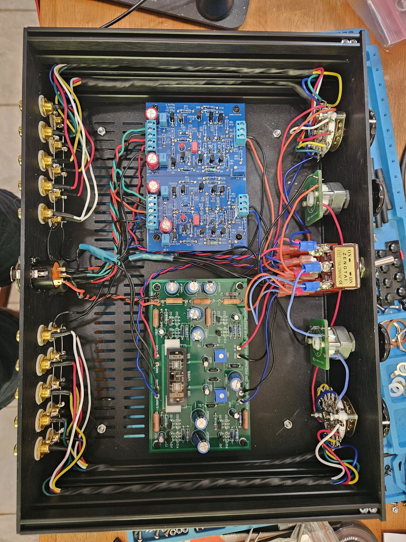

Step 1 complete, top plate with 2 front nuts is lightly tightened waiting for glue to set. I didn't have 2 part epoxy, but did have Gorilla Glue, which needs moisture and time to cure.

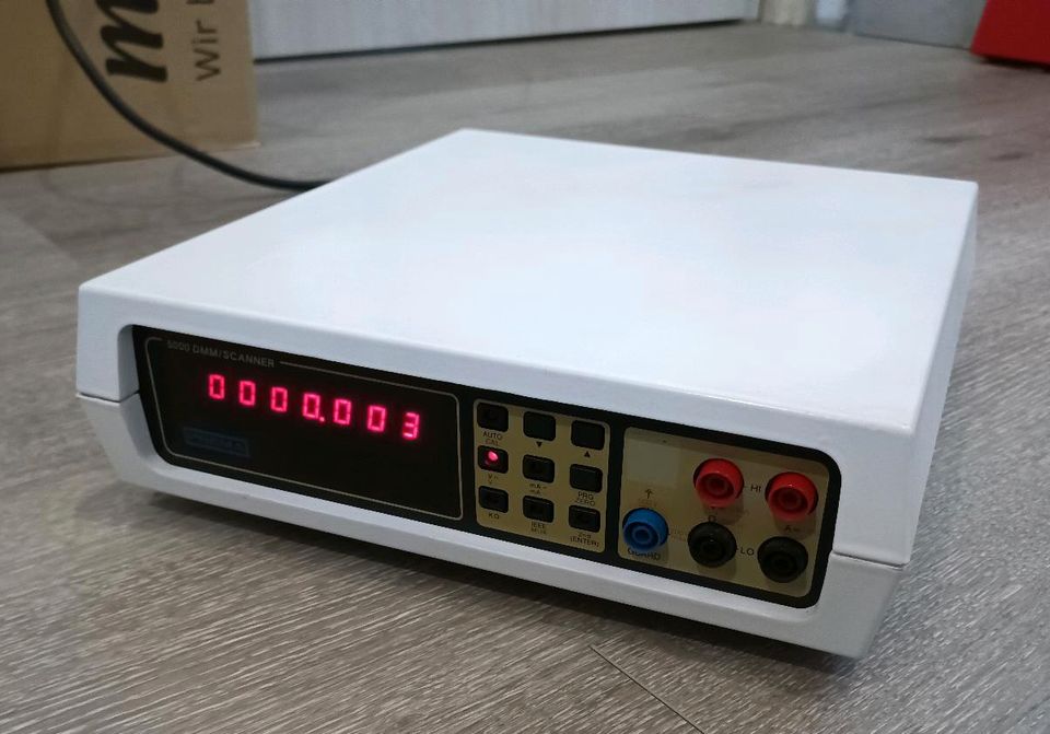

No it's not a hammond, it's my old prema 5000 multimeter chassis, the dac chip died and are unobtainable, figured the chassis might be handy.
Ps photo is not mine , mine is yellow, so a paint job is needed.
Front and rear are standard 3mm aluminium rectangular that sits in slides, couldn't be easier

Initial cure of the front 2 screws is beauty, needs to fully set overnight. The 2nd set of screws are in place and curing. It wasn't quite easy peasy as lining the nuts up with the slots in the rails

I just stick something in hole, tilt chassis until nut slides down to hole, put in screw, go to next one. Or, if top off, use same thing you poked in sc rew hole to slide nuts where they need to be, put top on and screws in.Or use Blu Tack?

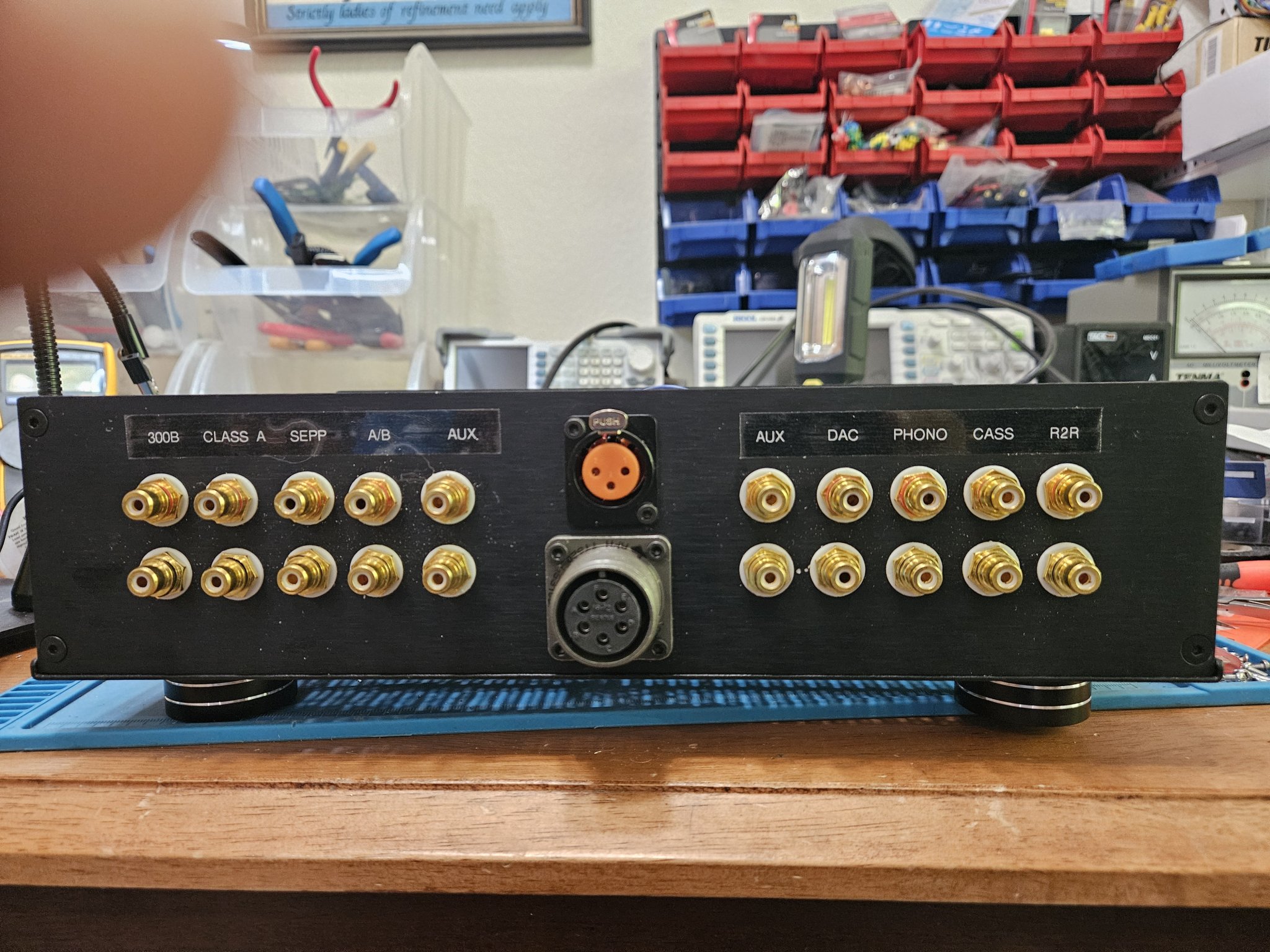

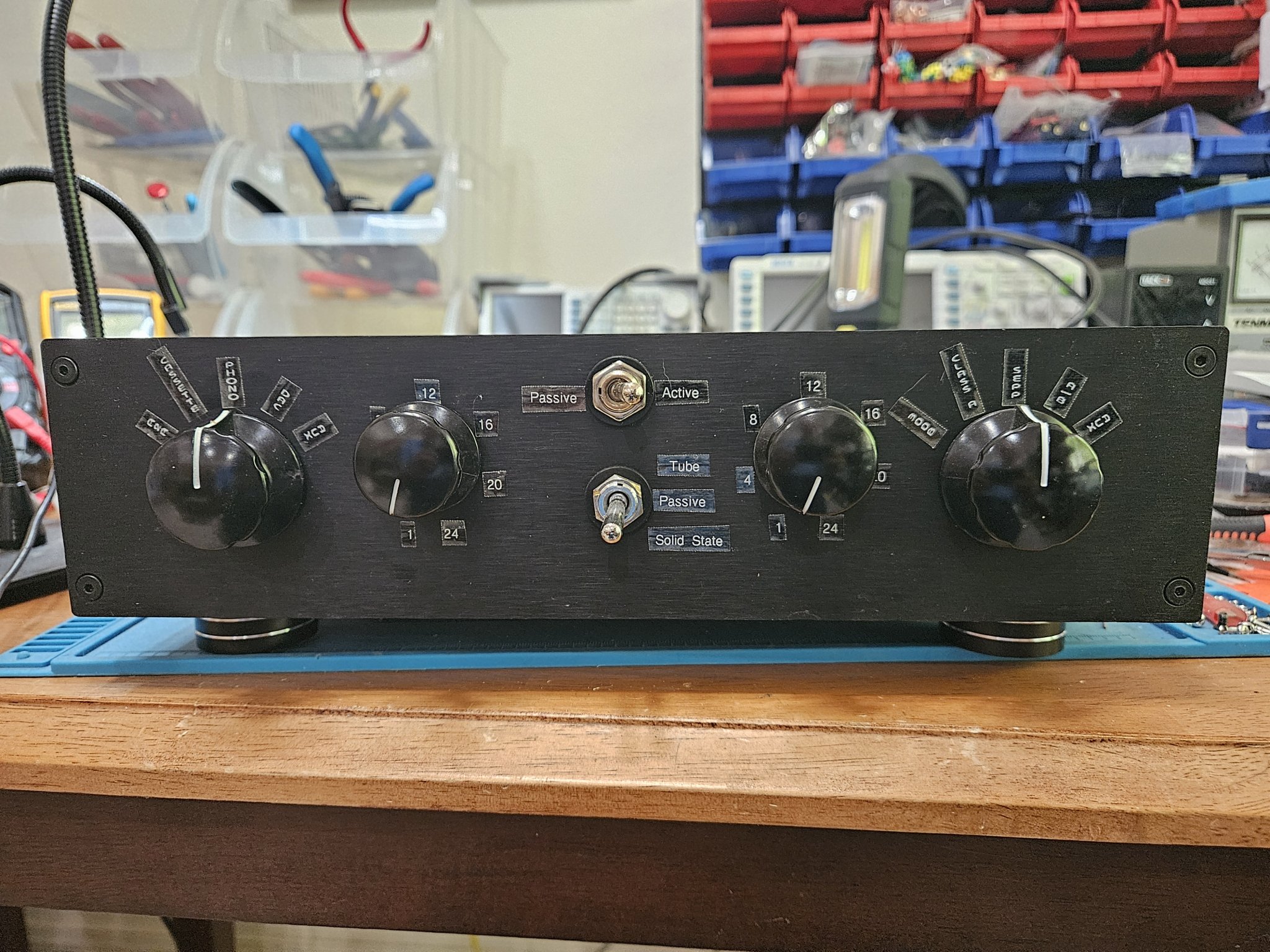

Have just finished this for my complete system and want to share some info.
Just done today is the preamp – see the attachments. This has been developing in order to allow me to connect and control all of the amps and media sources I use. Here are some characteristics:
The device is copper wired from point to point and has no noise (outside of the Korg Tube pre).
It can operate in passive or active modes.
Active modes select either tube or SS preamplification.
Five in and 5 out allows for rapid switching to any of 5 amp types (a listening technique I term active amp listening).
Was just able today to finish this 2-PSU pre and, now, have the entire system with discrete right and left channels.
The difference is significant.
