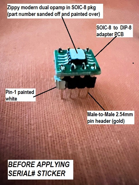

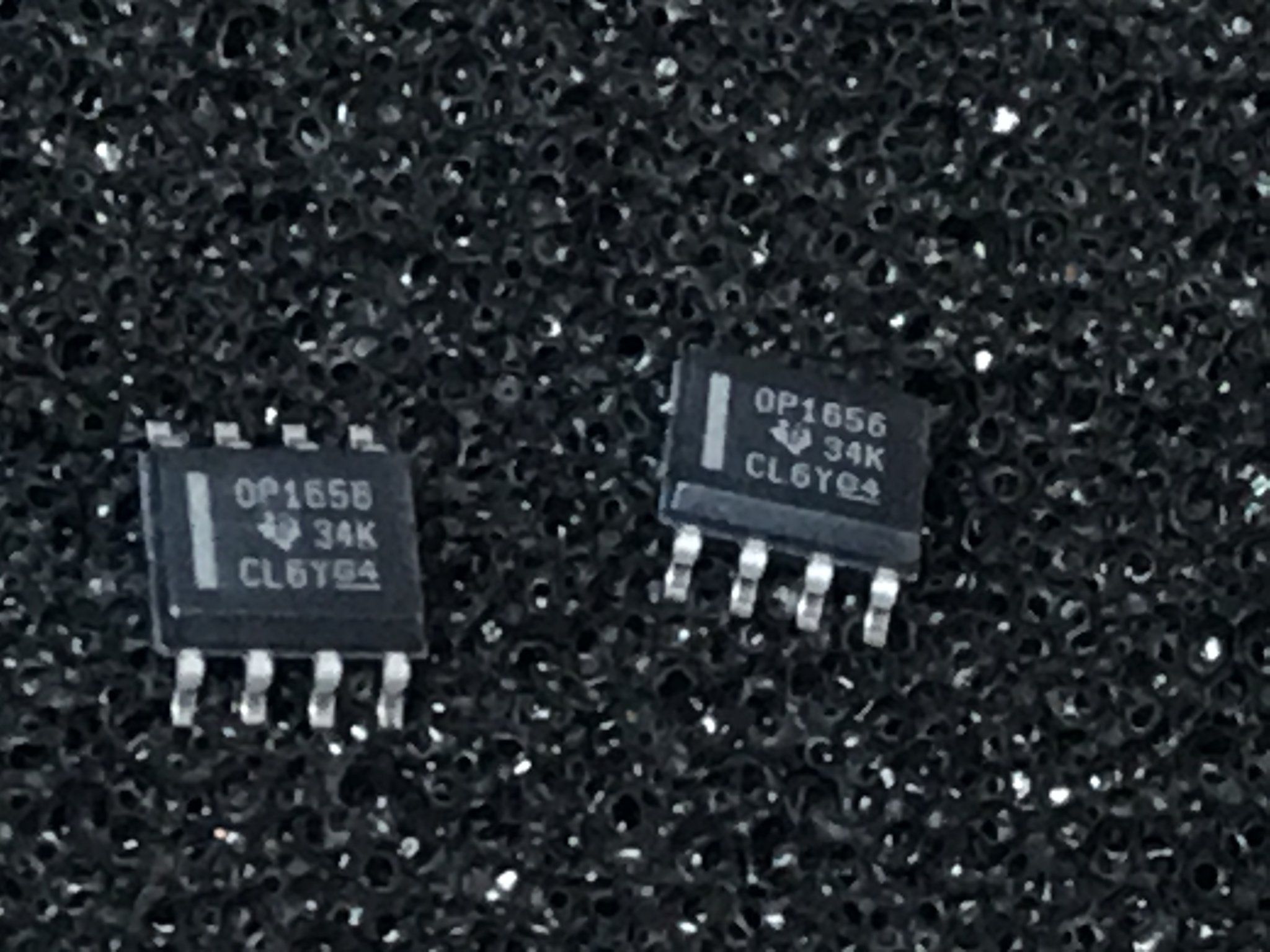

Another option is BrownDog adapters..https://www.cimarrontechnology.com/product/browndog-970601-so8-to-dip8-adapterCan someone direct me as to where can I find the OPA adapters? I expected them to have pluggable legs that would plug into the sockets I have. I was surprised to receive legless OPA1656s!

SO, I looked at that BrownDog site.
Looks like I can get some SOIC opamps already mounted on the DIP adapter.. Which ones should I try?
When I'm just feeling lazy and don't want to either place a separate order to Digikey or Mouser for the opamp or taking the time to solder them onto the adapters, I just buy it from CTs already mounted. Never had an issue. All of them are original parts.
