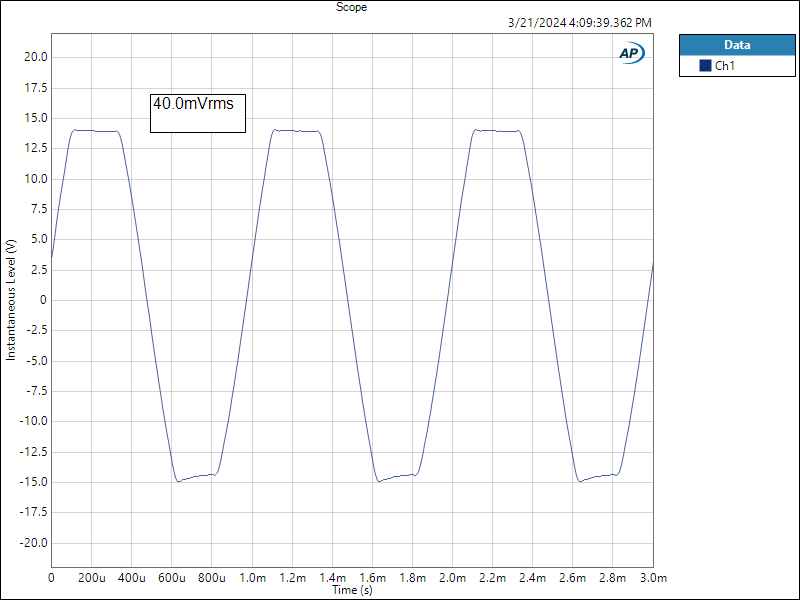

Hello,Hello DT!
Just under 10Vrms means 28Vpp at f=1kHz, of course you are already slapping the rails.
Let's calculate back 14Vp/16 = 875mVp, 875mVp/23 = 38mVp. Well, the cascaded input stage should be able to supply and process 1.75Vpp without complaint. 3.8mAp should also be no problem for the 1st op-amp at Rload=230Ohm.
Should! First of all, the question of the highest possible input level must be clarified. What does the Ortofon 2M blue spit out? The data sheet says 5.5mVrms ... etc.pp. Sampling capability 80µm -> +/-40µm !?
Perhaps measure again directly at the exit of the first stage or at the entrance of the 2nd stage.

I think of it as kissing the rails. Add just one more increment of input Voltage from 29mVrms to 30mVrms and the top of the sine wave output begins to flatten (clip) and the THD+N jumps up to near 1%.
For the sake of discussion, the question of the highest possible input level, is a good question, any one know what the voltage output of the M2 Blue is with one of the big surface clicks or pops?

30mV is about 16 dB above the nominal 5mV@ 5cm/sec level so I guess it can happen.Is there any chance a 5mV output cartridge can output 30mV?
E.g. the Ortofon MM is specified 5mV at 1 kHz at 5cm/sec. What I miss it how "heavy" that 1 kHz test groove is modulated?

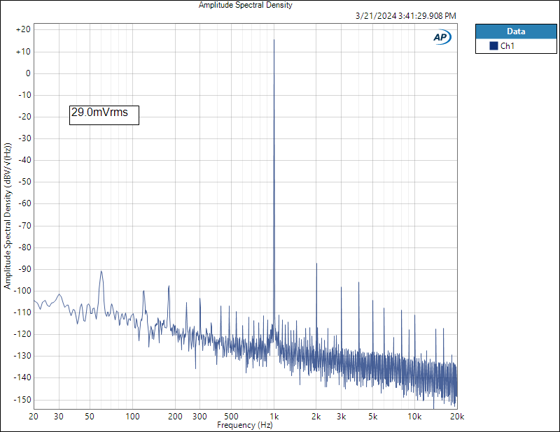

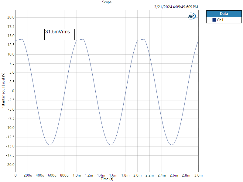

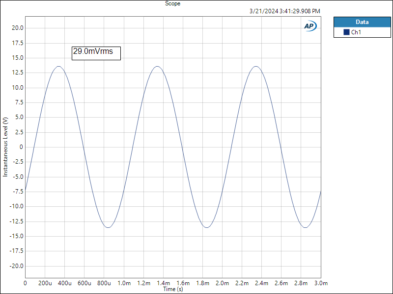

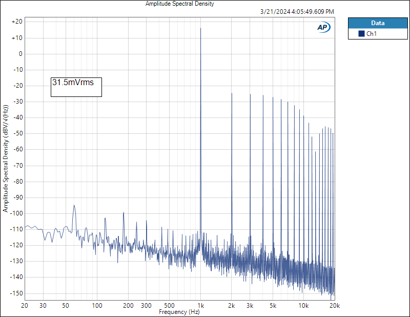

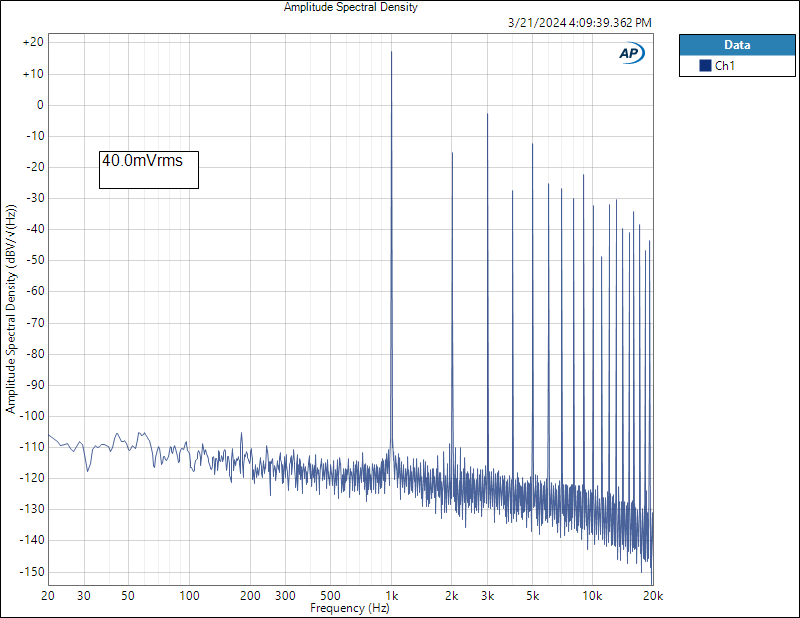

Today I went for a walk in the neighborhood and gave overload some thought.
You know that these cartridge's have a finite dynamic range. Amplified to little some of the small detail may get lost in the noise floor. Amplified too much some of the large grandiose things may be clipped or distorted in the upper limits of the power supply rails.
If you reserve 40dB's of headroom to capture the dynamic range of damaged vinyl you will be sure to be giving up small signal detail to the grass on the noise floor. The noise floor is there all day every day even for a shiny new LP.
Much of this conversation (beyond a point) is a solution in search of a problem.
Just for fun posted below are a photo of the neighborhood, time domain plots, and frequency domain plots someone else can post the dollar domain graphics.
Out For a Walk:
No clipping:
A little clipping:
More clipping:
