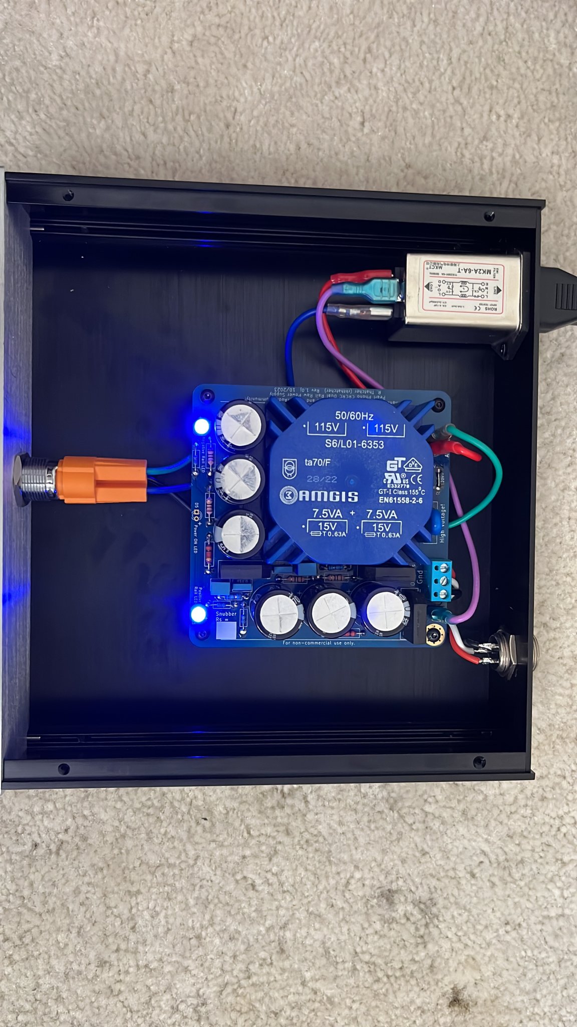

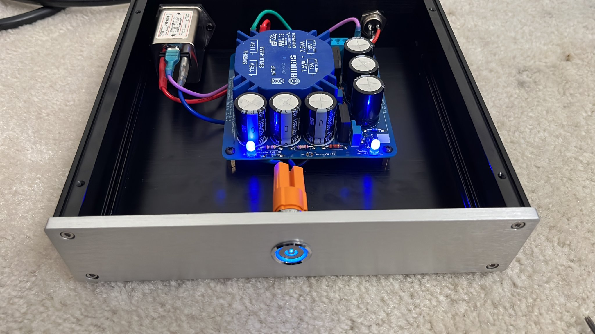

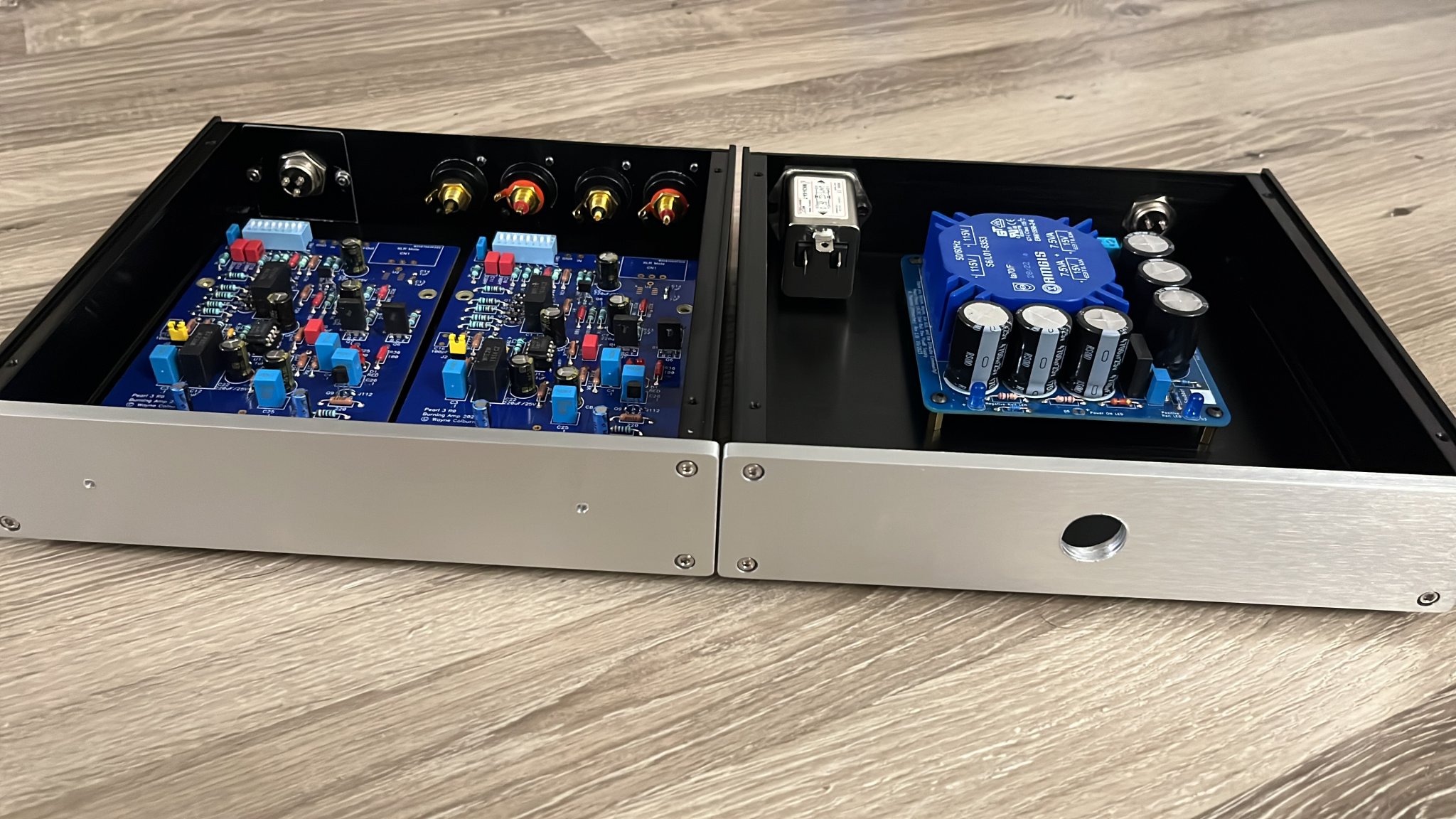

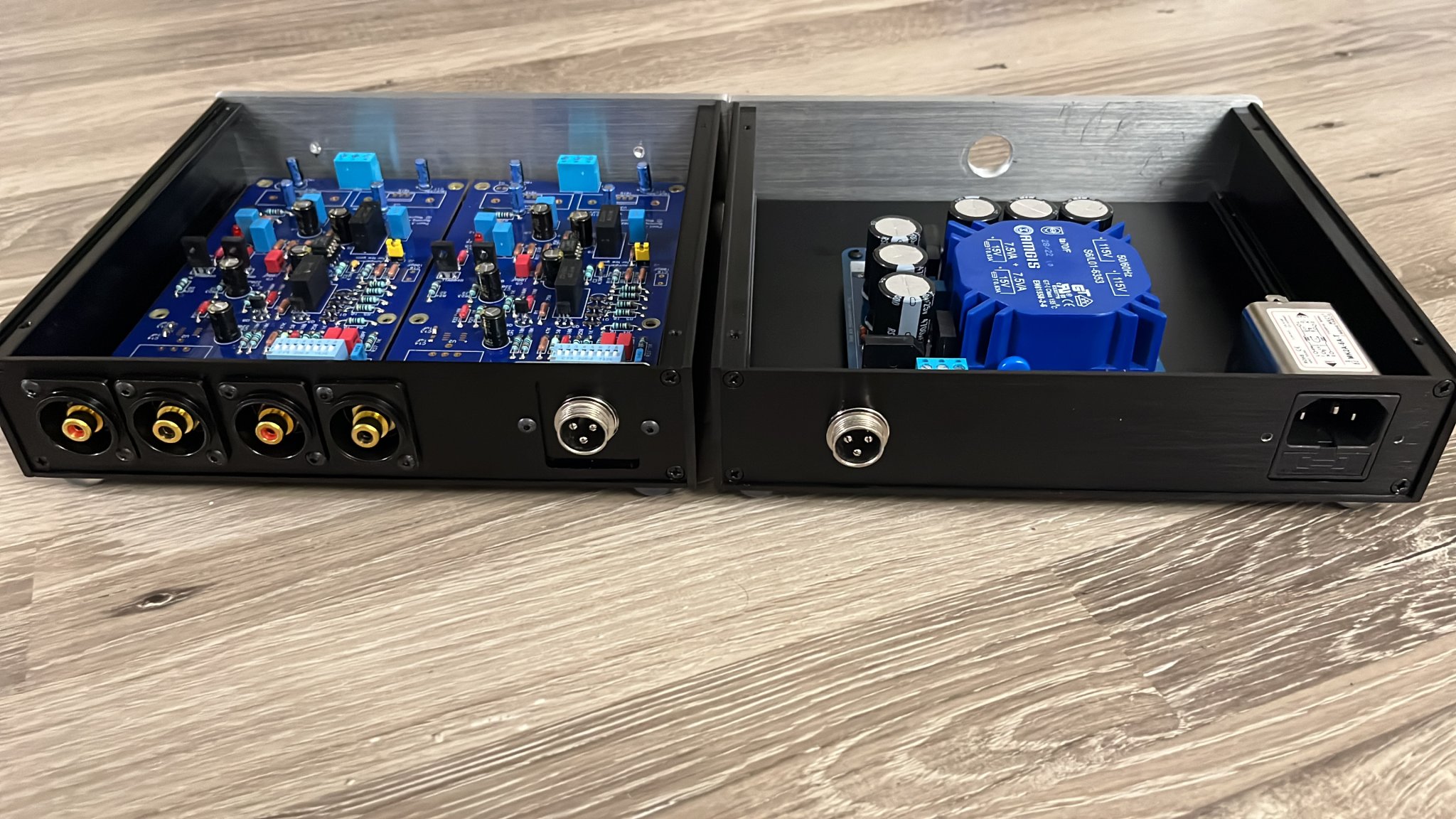

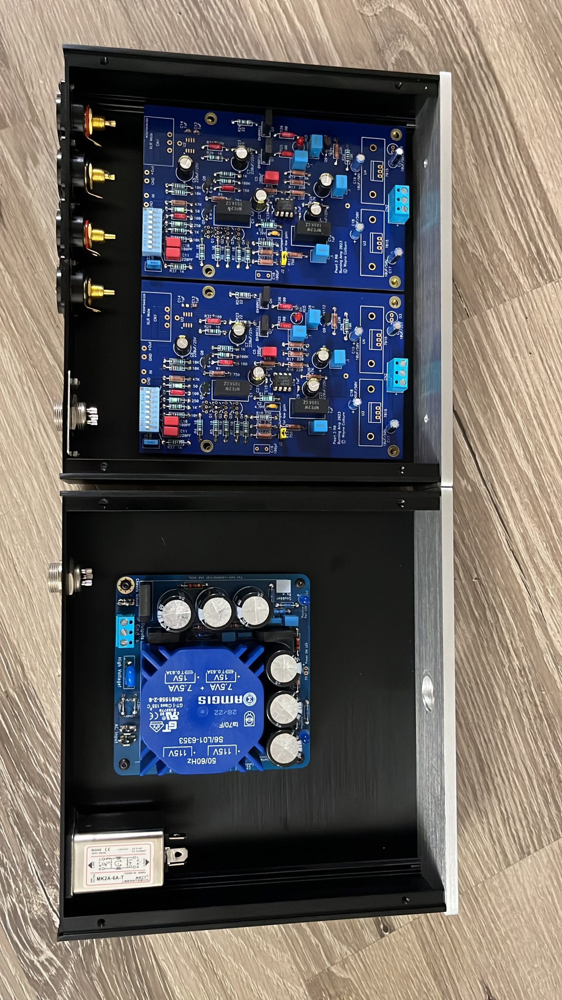

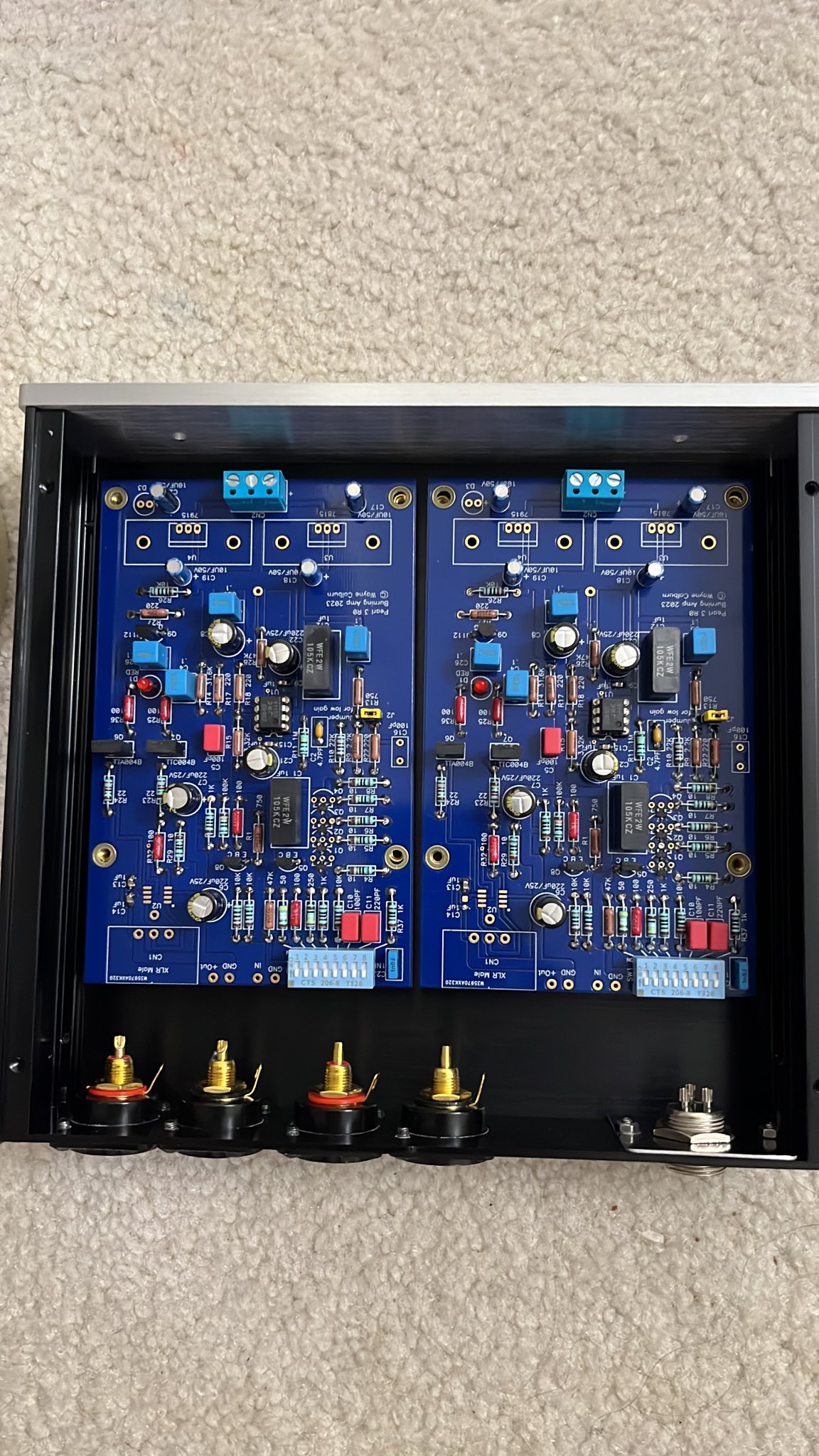

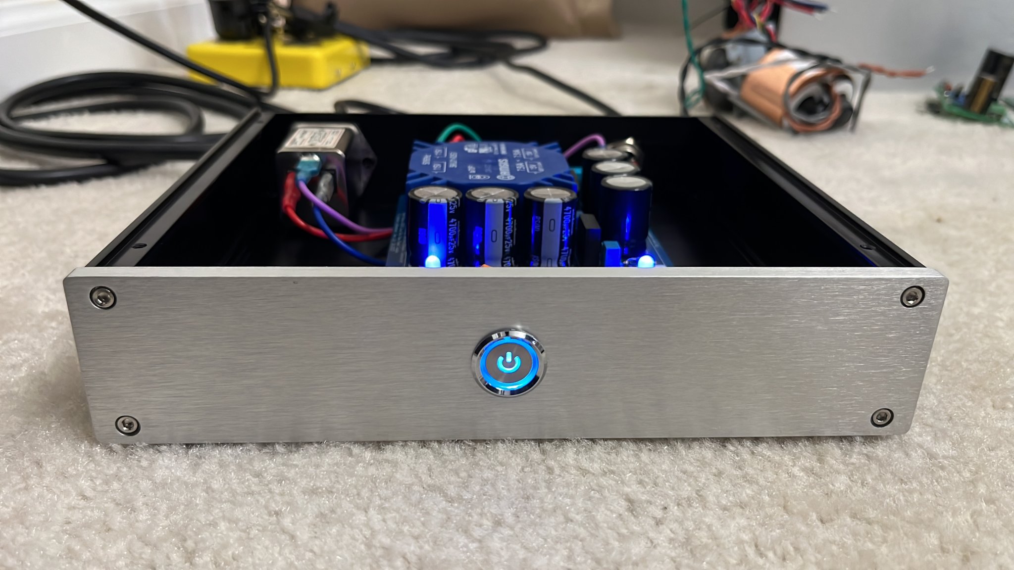

Some more progress today most of the hardware is done

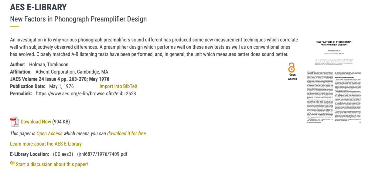

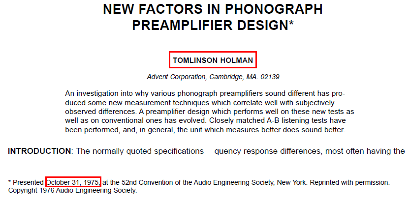

Rather famous audio guy Tom Holman (Wikipedia entry) published an AES technical paper about phonographic cartridges, their outputs, and related topics. His paper covered output level, ticks, pops, and other details a phonostage designer might wish to explore. Here's a little preview of the Copyrighted first page.
