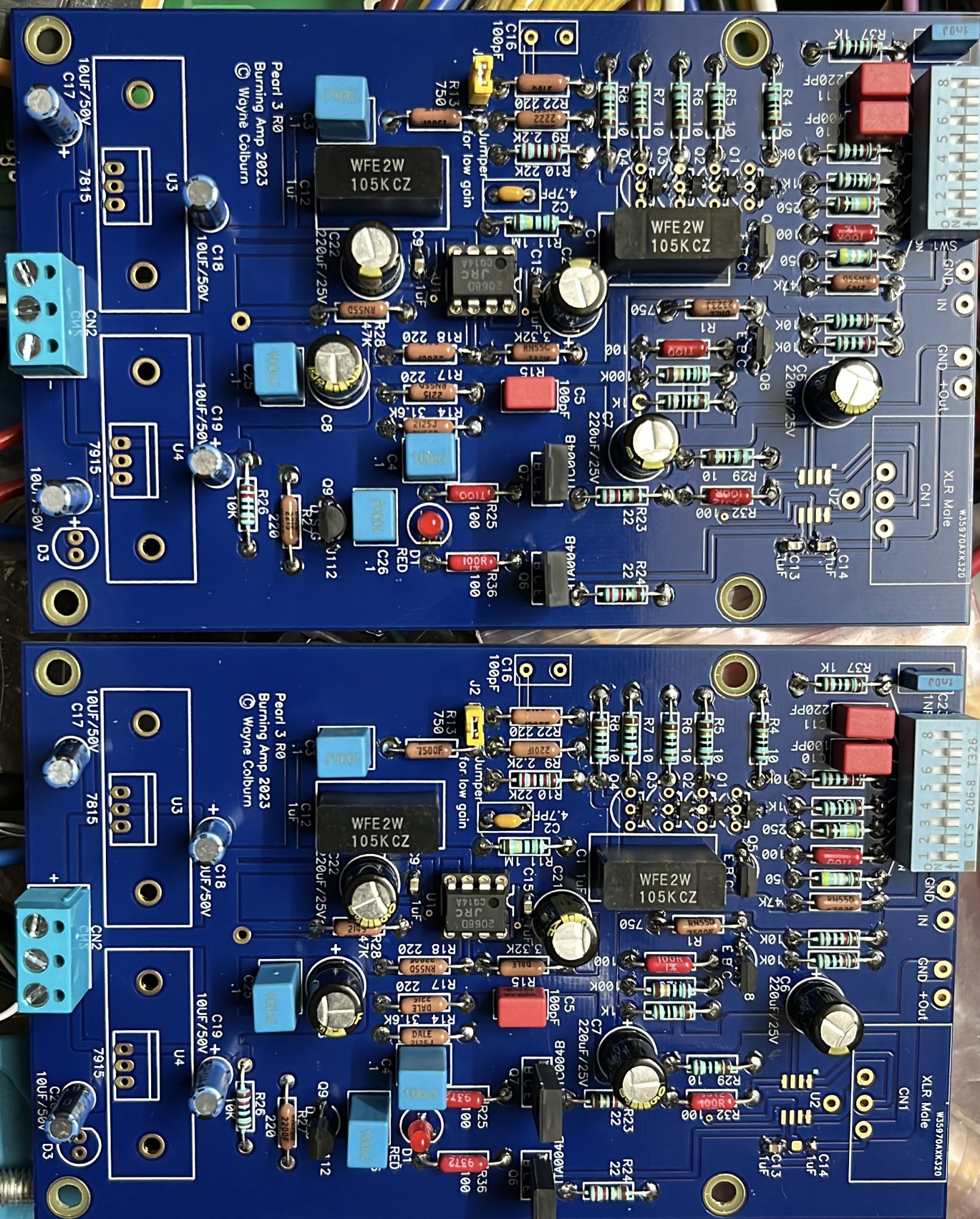

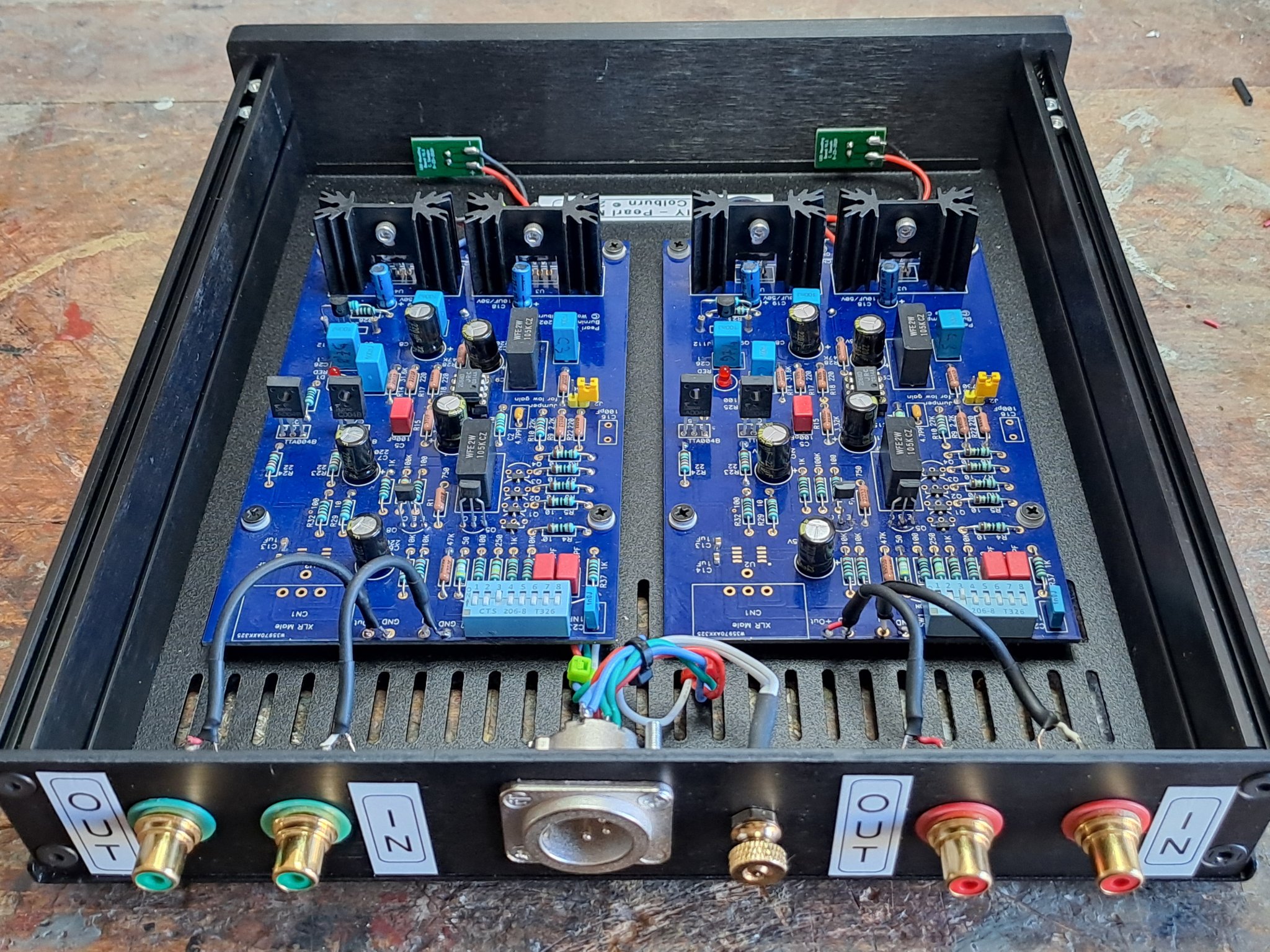

I appreciate the suggestion. That’s right - two conductor shielded - red hot, white ground, shield is actually floating. Maybe I should ground the shield. More to play with when I get time.Actually difficult to see. Maybe it´s just done with red/white/screen-cable, with red as hot and white/screen together?...... Probably.
If so, just disregard my post 😊
Start by disconnecting the XLR, and try to get it quiet on RCAs first.
Also doublecheck that you have continuity with all the chassis panels to eachother.
Yes....... You should definitely connect screen to at least the RCA connector. Then try both floating or connected on the PCB side,I appreciate the suggestion. That’s right - two conductor shielded - red hot, white ground, shield is actually floating. Maybe I should ground the shield. More to play with when I get time.
and chose for yourself, which one is the most silent 😉
NO 😉or perhaps better to the chassis (or ground post) since the jack's themselves are floating?
You have signal ground and chassis ground.
Always keep input signal ground away from chassis ground!! Output SG okay.
Yeah... that´s another way of doing it. Just explore all options, and settle for the most quiet 😉@Boydk
respectfully the screen isn't the signal ground in this case so by doing as I suggested you'd in fact be keeping the signal ground wiring separate from the screening function connection... as you advocate.

From the posts in this thread it looks like a MC is a minimum requirement. With R22 selected the gain is right at 50dB and with R9 selected the gain is at 70dB.
@DualTriode
I am pleased that everything is now working as you wanted it to.
Everything is working as expected using the Pioneer Kit part values.
What I would want is 36dB gain to use with a 5mV output MM ortofon Blue M2 cartridge.
Thanks DT
