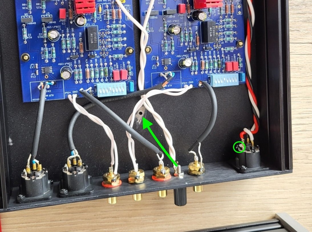

I need a fresh eye. Maybe you can spot something I missed. My P3 was amazing and dead quiet. Barely any noise and no mains hum. `Then, out of the blue, one day there is a significant amount of mains hum. Nothing was changed.
50/60Hz or 100/120Hz hum or is it noise?
Short the input, is the hum still there? If it's gone you have an issue with the wiring from turntable to P3.
Careful dressing of power supply wiring
Adequate power supply filter caps
Ground loop breaker
If it's noise, could be oscillating JFETs in which case you would put a gate-stopper resistor or a small ferrite. BF862's I know are susceptible to oscillation.

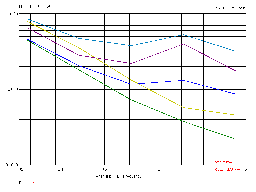

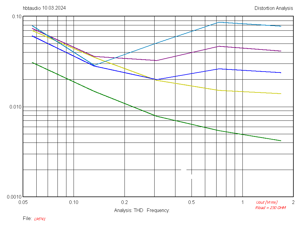

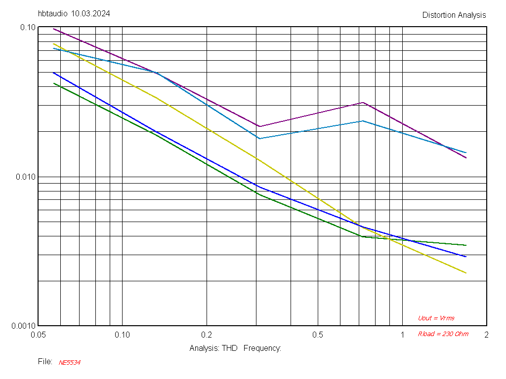

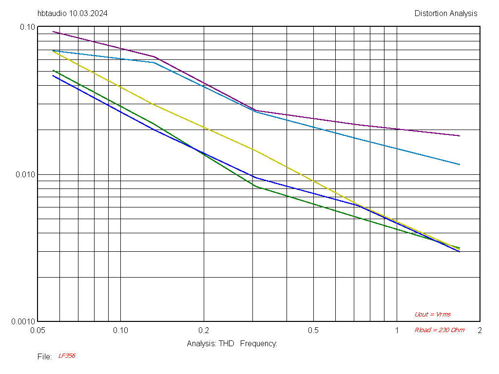

I need a servant and a lab - Improvised conditions at home
Please bear in mind in all comparisons that this is a fairly free table setup and shielding is completely absent.

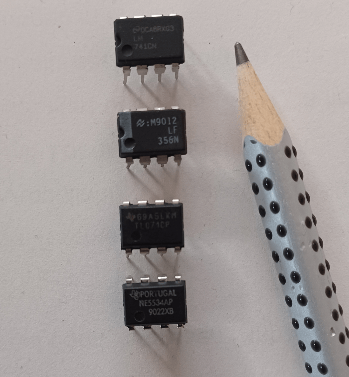

A sample from hundreds of old operational amplifiers DIL8, gathering dust in my chambers. Really random, I just made sure not to plug in the really good stuff.
The green curve corresponds to THD_1kHz, yellow THD_3kHz ... in percent of course.
DC offset:
741 < 53mV; 356 < 12mV; 071 < 5mV; 5534 < 500mV;
SNR the same for all OPs!

Setup:
Marantz PM-14S1 SE amp
Oppo BDP-105D player
Avid Ingenium turntable
A server connected via USB to the Oppo
Things I have checked until now:
Interconnect cables
Power cables (Oppo has a loose cable and moving it increased the noise. Replaced, the hum stayed)
Optical inspection of the inside of P3
Moved cables around (nothing, the hum is independent of how cables are laid)
I'm happy to hear any recommendations as I'm honestly baffled. Perhaps I missed something.
It might be worth double-checking that all your chassis parts are making good solid ground connections with each other. Someone earlier in the thread suggested removing the powder coat on the top / bottom panel screw hole chamfers using a countersink. If you want to go bootstraps & suspenders, you could add a ground wire from the rear GND post to the amp bottom panel, with star washer to get a good bite into the exposed metal.
You can also try opening vs shorting the umbilical shield to preamp chassis link to see if breaking or closing that connection favorably alters a nuisance ground loop in the system.

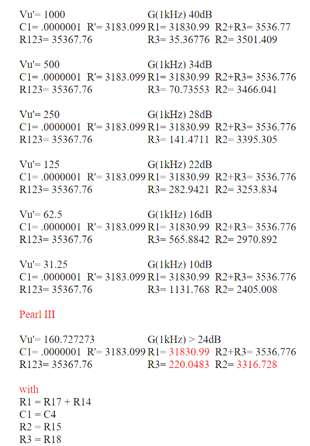

Am I mistaken thinking that it is easier to increase the P3 gain and that we are are already close to the lower limit of adjusting the gain lower.
You are not mistaken about the first stage.
The main problem is the 10 ohms of the R8, the common source resistance for Q1,2,3,4 is a real problem for the U1:A. If the first stage is to have an amplification factor of 10, you load the OP with 90+10 = 100 ohms. It doesn't really like that, because the (resulting) >7mAp (worst-case scenario) to be supplied is already straining its internal structures, and that at the end of the audio range of all places. The only remedy here is to use a lowoutput MM or other jFets or a completely different input circuit, or a different setting of the operating point of the parallel jFets - or an MC and a little more OLG.
For the second stage change both resistors R15 & R8 to adjust the gain.
The challenge is still to determine the most suitable OP for the first stage, or to justify why Mr. X is the best choice at this point. Also why R10 of all things should be 22kOhm or R11 of all things 1MOhm. By the way, R10 (||R1) represents the load for the cascode, a current flows - U1:A is a current-to-voltage converter.
Sorry for the typo.
Correct ist "R15 and R18" simultaneous.
Are you sure about R15 and R18?
To me they look like they are part of the active RIAA compensation in the op-amp feedback loop.
True if you change R15 and R18 you change gain but you also change the RIAA equalization while you are at it. If you change one thing you change everything.
About 100% sure.
Yes they are, but they also adjust the gain.
And that's exactly why you have to adjust the value of both at the same time.
I have been playing with the Hagerman Bugle "Phono Pre" where the RIAA equalization is passive, the gain can be adjusted with a resistor or 2 without affecting the RIAA equalization.
R15 and R18 at the same time and in the right ratio. Take a close look at my example table for C=100nF.

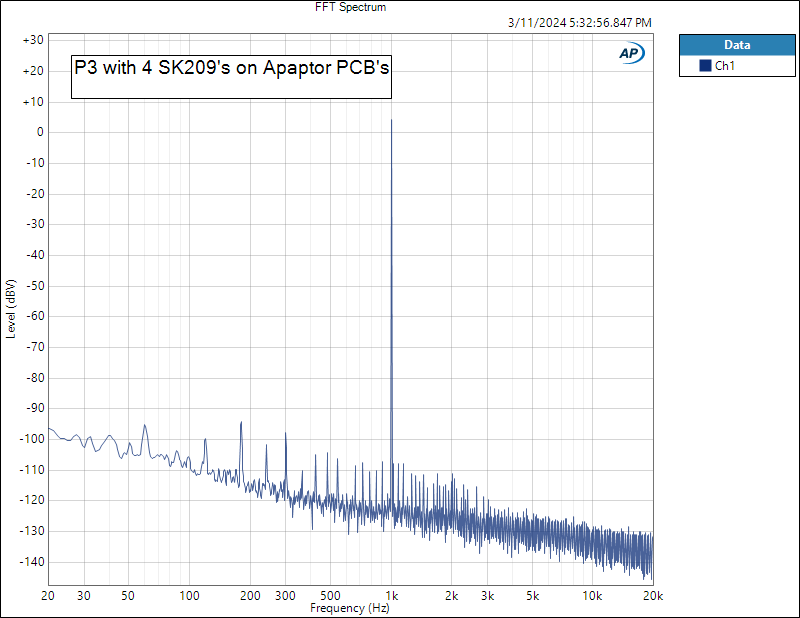

I have seen the errors of my ways.
Previously while I was setting the series output voltage of the new Keysight bench power supply I entered 19Vrms thinking that in series it would be double that for the + / - series output, it was not. Now the output voltage is corrected to + / - 19 Vrms for a total of 38Vrms. Each 7815 and 7915 on the P3 PCB has volts to regulate 15Vrms + / - at the output of each.
So now The P3 with 4 each 2SK209's functions as expected. Built with Pioneer Kit recommended part values. Thanks to @6L6
Input is 5mv
Gain is 50.39dB
output volts is 1.653Vrms
THD+N is 0.004%
SINAD is 87dB
The above measurements were taken with APx555 analyzer. My expectation is that the limting factor will be the Turntable MM cartridge.
See the updated P3 FFT with 2SK209 Jfets below.
Thanks DT
