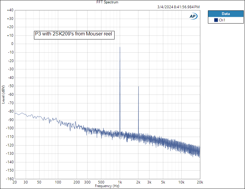

I played with reducing R1 to about 550 ohms. Using the 2SK170, Q5 was just starting to come out of saturation.
Using R1 at 550 ohms may move Q5 enough from the edge to a more flat area of the curve for the 2SK209.
With that initial testing, I am planning to run R1 at 750 ohms and use the 209s. Staying more with the original an see how it sounds. After things settle in I may look at reducing R3 if it seems Q5 would benefit.
Interesting. A pure second harmonic and not much else beyond the noise floor.Hello All.
Today I replaced I replaced the Jfets with 2SK209 GR. The Jfets are direct off a reel purchased from Mouser a year or so ago. They are known to be the real thing.
The voltage across R1 measured 6.79Volts with 9.05 ma. At 5ma input the gain is 42.54dB and THD+N is 0.462%
The noise floor is higher perhaps 1/f noise. The 2nd HD remains higher than the 2SK170
The steel J box (cookie tin) does a good job of reducing power supply harmonic noise.
See the FFT below.
I do not know the story about the elevated 2nd HD.
Thoughts?
Thanks DT

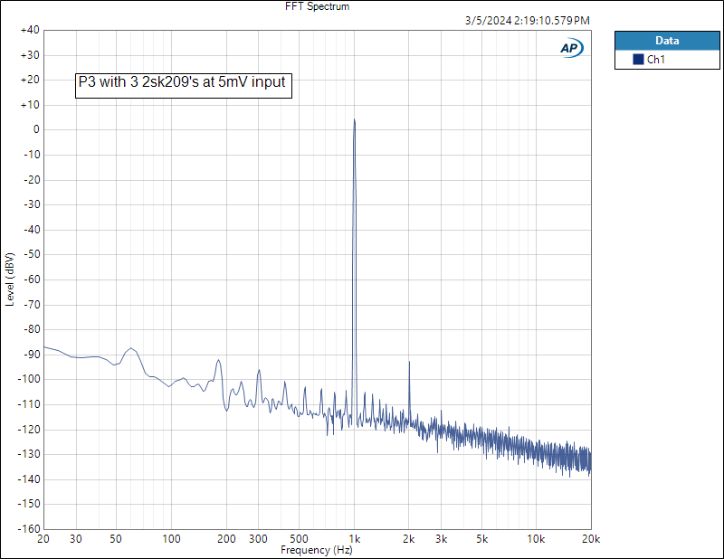

Hello,
Taking a closer look.
I plugged in the the original set of 2SK209 and noted that one had a little more current than the other 3. I removed the odd Jfet and 3 Jfets remained plugged in.
Input 5mV
Gain 50.25dB
Output 1.627Vrms
The noise floor is lower and you can see some power supply harmonics above the grass.
THD+N 0.008%
SINAD 82.2dB
The 2nd HD dropped more than a little.
With only 3 Jfets installed the current through the input stage dropped by 25% plus a little. I do not know if the cascode likes less current?
See the attached FFT.
Thanks DT

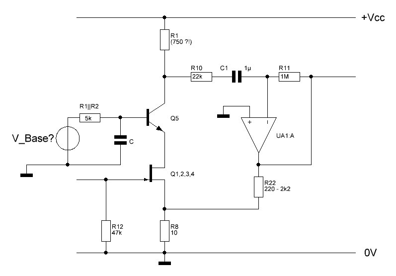

There is now less current through R1 and so less voltage drop across R1; now greater voltage across Q5, moving it further away from saturation toward a more favorable operating point.I do not know if the cascode likes less current?

With one fewer Jfet the voltage drop across R1 is reduced. R1, 5.21V at 6.94ma.
The delta V across Q5 is 2.57V. I do not have curves for the PNP's. I want to see Mr. Early's effect. Later.
The Drain Source delta is 6.18V. I do have curves for the 2SK209's
Thanks DT

At first I thought it was an unfavorable operating point on the Ids(-Vgs) characteristic curve, but a quick calculation and a look at the data sheet showed no problems.
But, if I briefly check your two cases statically, it follows that
1. Vce(Q5) = 1.06V with Vcb(Q5) = 0.36V
2. vce(Q5) = 2.76V with Vcb(Q5) = 2.06V
Auricle has already shown what happens in the first case in his simulations - but so far no one has run an FFT over it and looked at the resulting spectrum. If you force this point by simply injecting a current that is too high (for Q5), everything is back to normal because Q5 now represents a short circuit.
Obviously, the collector base voltage must also be statically higher than in your documented 1st case.
It is almost impossible to provide specific assistance or to identify the cause of the problem remotely - because you are not on site and cannot turn the measuring devices and power supplies.
Just leave out the cascode and reduce R1 to 590 ohms.
When analyzing a circuit, you have to proceed systematically and comparatively. It may well turn out that you have to increase the supply voltage of the BLs to up to 30Vdc so that you can be shure ...

Take a look at the PEARL 1, there is no problem with the NPN BJT. Vcc is approx. 30Vdc and R = 499 Ohm (not 750Ohm).
My guess is that VCE(Q5)must be >1.2V; minimum: better be in the range of 1.4V to 2V with the GRs.
The jFet exchange mania is a bit exhausting.

Higher supply V might help as well. Wayne mentioned 7818/7918 during his Burning Amp presentation, but background noise drowned him out.
Tony Z
Now let's just look for the best V_base and the correct, but lowest Vcc - for our application. Minimum distortion and minimum noise with maximum possible dynamic signal modulation /range, in the open and closed loop ... etc. pp.
Has the value of R8 been optimally selected for our application?
