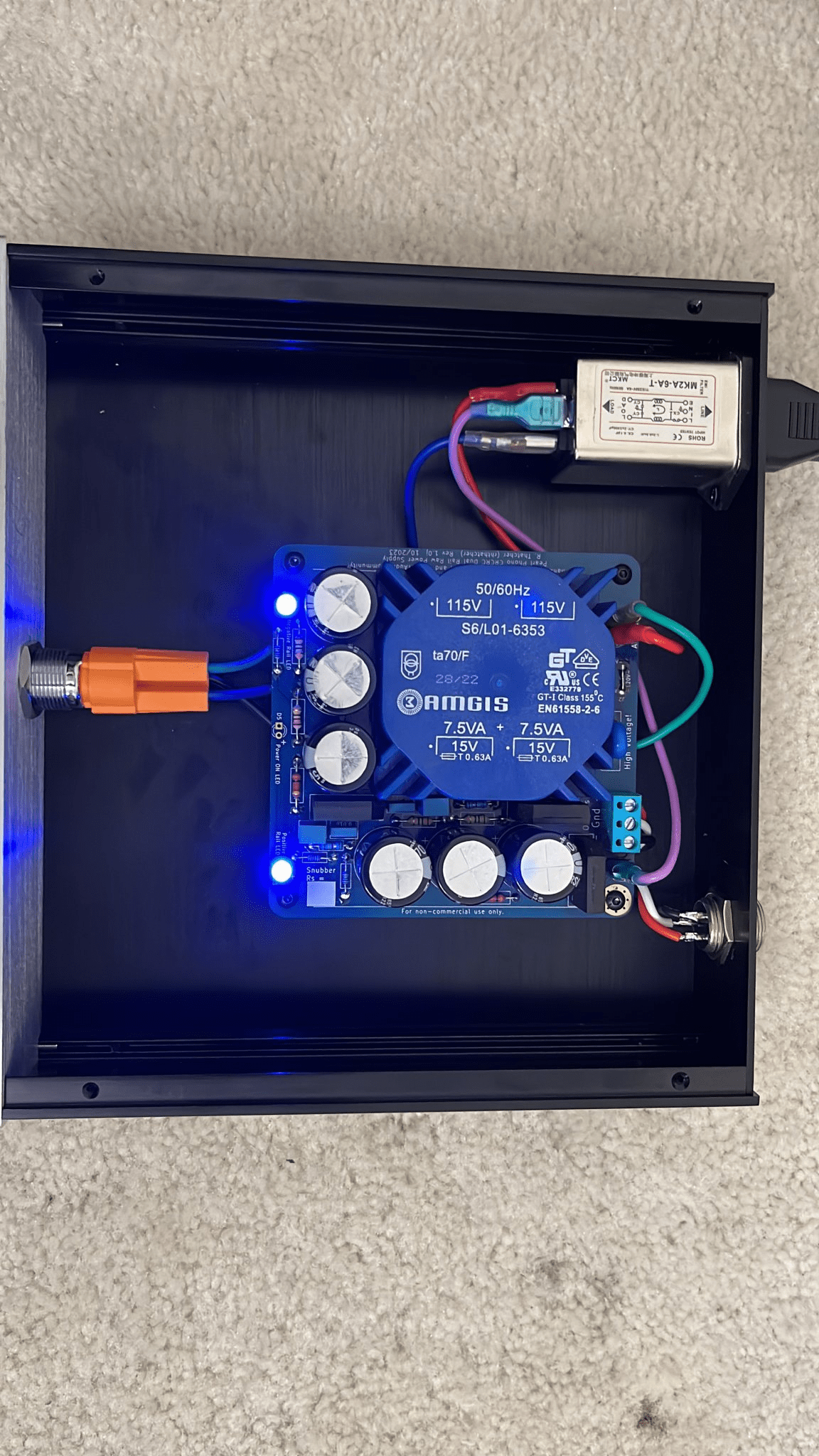

Yes @rhthatcher I have the fuse in the IEC block and currently put in a 500mA fuse as that is what I had in stock for testing. Ground post I forgot to put the provision but I need to provision that later but their is not any on my DIY TT to connect to it. Even my present Schiit phonostage too I did not connect that and no issue of hum/hiss.@manniraj - do you have a fuse in the power supply box? I can’t see if there is one on the IEC block. Also, do you have a ground post for the turntable to connect to?
I only grounded the PSU mounting pad to the chassis and then to the IEC ground. The umbilical cord to the psu output wiring is not grounded to the chassis. I wanted to try this way as I have done the same in my earlier phonostage builds so let me test and see if I get any issues. If I get into issues I have to get some 4 pin aviation plugs and connect the psu chassis to the umbilical chord. But looking at the @6L6 build notes it is mentioned that even though the chassis is connected on the psu box the same can either be connected on the amp box or you can leave it open. So I went with the open option for now. This is how I made the wiring on the psu box, Purple wire from IEC earth to the psu chassis and then next to it I have used a metal screw to the mounting pad of the psu. So the mounting pad becomes the star ground in the psu box.more to the point is your chassis grounded as a shield.. perhaps through the umbilical to the PSU chassis and earth?
I note you did not use the ground pads on the boards. it's be interesting to see if using these -- and connected to what -- made a difference.
Cheers, they do indeed add to the cost, am playing with something here https://www.diyaudio.com/community/threads/pearl-x-mc-mm-phono-preamplifier.410767/I haven’t ever used a step up transformer. The Pearl 3 is really designed to be quiet enough for MC straight in.
@manniraj
I think Jim's advice was predicated on the signal boards being connected to the ground post and the signal chassis.
if I understand it correctly you've done neither so the signal chassis is essentially floating.
again if you encounter hum you might try connecting the two chasses with a separate wire (which -- if that works/helps you can incorporate in the umbilical as a conductor or shield connected at both ends to the respective chassis.
incidentally, I would not call the chassis ground in the PSU a "star" ground though the signal ground on the other side of the bridge might be wired as such.
