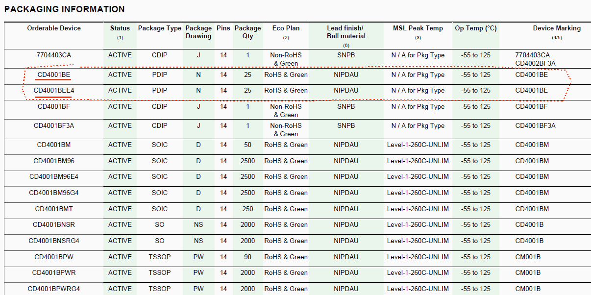

Hi All.. Working on putting a parts order in for a few of these boards.. Ran into a problem finding CD4001BEE4 (U5). Used the 'compare similar' feature on Mouser and they came up with this substitute.. CD4001BE.. Anyone know if this will work as a substitute? Thanks much!

The datasheets on both parts... regardless of Mouser's designations... are identical... Same exact file...
I think you are good.

Agree; but there can be multiple parts in one data file. In this one, I see 14 different "CD4001" parts. However I do not see the difference BE or BEE4.
These old-old parts, *usually* if you get the right CD40__ number and the right legs (ones you can solder), it will be fine.

Thanks PRR, need to do some learning about data files.. amongst other things 🙂

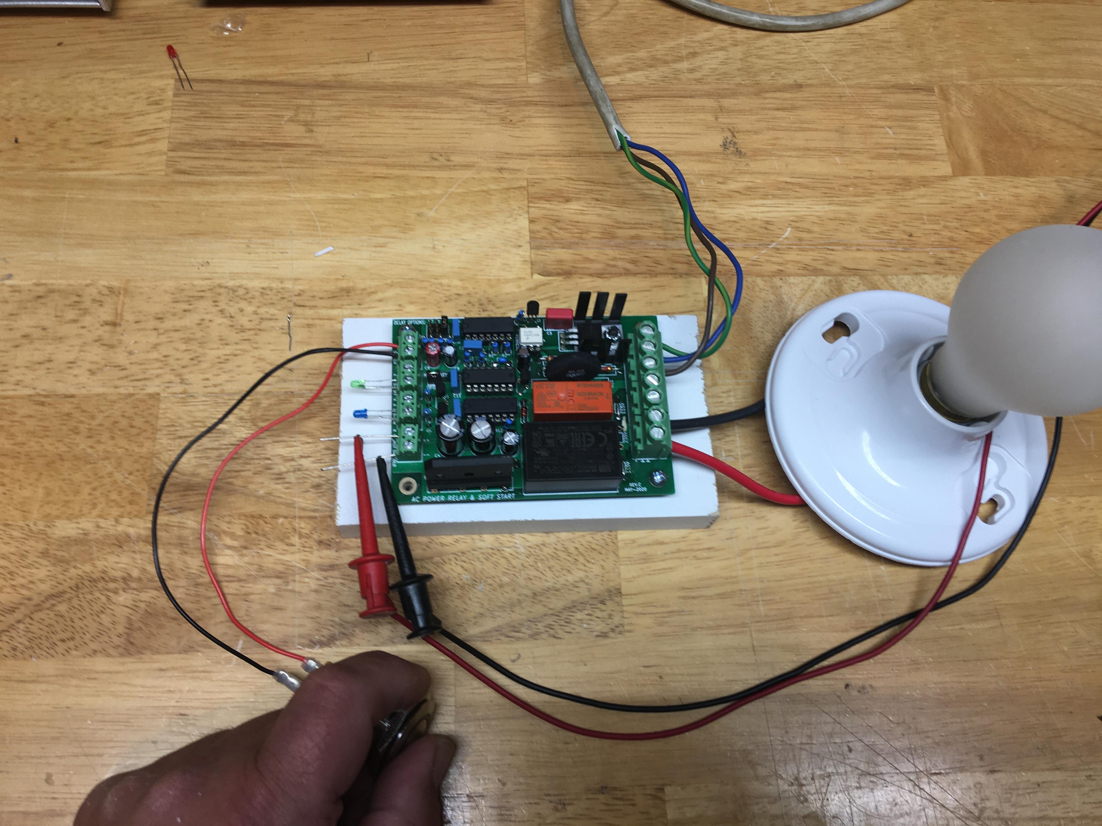

Congratulations, two times!
1. Congrads for building a board that works
2. Congrads for testing your board intelligently and shrewdly. Not many people would be able to devise your minimalist setup. Well done!!

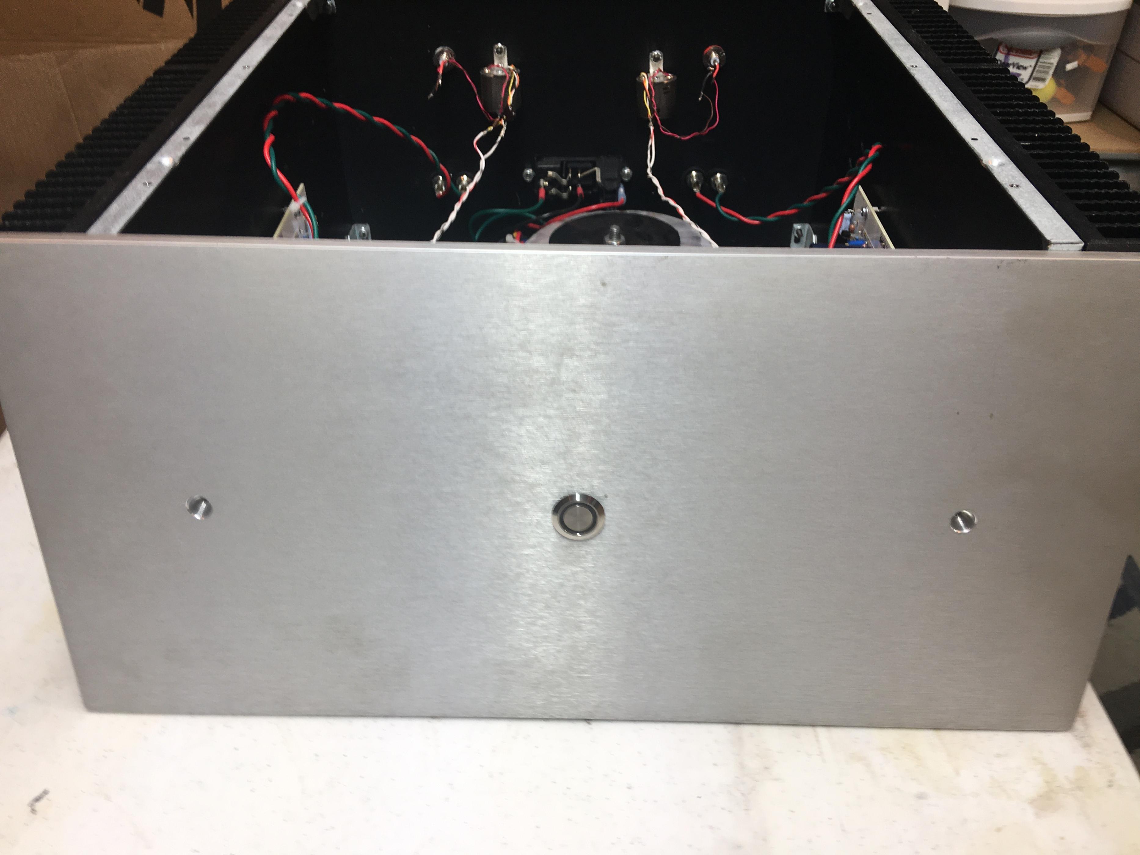

My amplifier previously had the two blue LED indicator lamps and now has a 19mm opening for an Anti-Vandal switch. My ambition is to have the switch ring lit green in "standby" mode and blue in the "on" mode with the two indicator lamps coming on as well, all powered by the H9KPXG.
I'm having a hard time finding a switch meeting my requirements:
Anti-Vandal
19mm
momentary
bi-color green/blue
common cathode
I've searched many manufacturer sites (Bulgin, E-Switch, etc.) but haven't come up with a solution yet.
I've also searched this thread and found an alternative wiring for using reverse bias diodes seen on many bi-color switches...that solution doesn't appeal to me. Audiobears bi-color solution had me excited but that switch is red/blue and 16mm.
Any Ideas would be appreciated?

If using a speaker protect board, how and where should it (if 110v, or the transformer for the board) be connected to the soft start?
This PCB is an AC mains on/off switch that just happens to turn on "softly". Use it exactly as you would use any other AC mains on/off switch.
