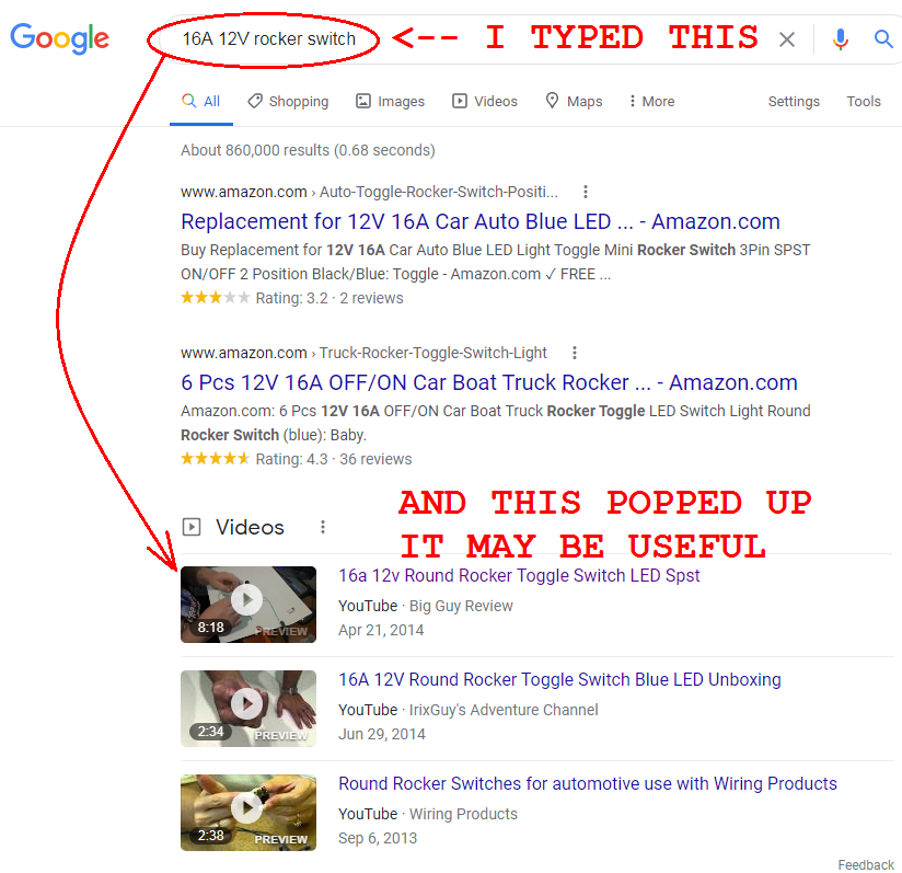

@Rtate, if you want an illuminated vandal switch that works with this PCB, I recommend that you buy one whose LED is rated 5V or lower. Then perform some lab experiments with the switch, plus your adjustable bench power supply set to 5V, and a current limiting potentiometer. Play with the potentiometer setting and find the external resistance value which gives you the LED brightness that you prefer. The switch itself could possibly include a resistor inside, and so your preferred brightness might need a >>ZERO<< ohm external resistor. That's why you do the experiment, to find out what's best for you.
Once you know the resistor value which pleases you, buy a fixed resistor in that value (or whatever standard value is closest) and use it for R4 on the PCB.
You might like to own a kit of standard resistor values, so you don't have to wait for a shipping-delay in those cases when you only need a resistor or two.

This is one with only 2.5 mA flowing. Most 12V versions are even too bright on 5V... Since I detest overly bright LEDs I only use 12V versions on 5V and some then even need an extra resistor to taste. My suggestion is to choose a higher rated vandal resistent switch as modern/recent produced LEDs are insanely bright at very low current. Their sweet spot is between 1.7 and 2 mA (green/amber/red) for acceptable brightness in daylight and not blinding one in dark circumstances. For some reason they are factory set at way too much current.
Thanks Guys , that makes perfect sense now.
So the 4.7K R4 is a starting point.
I don't like my led's bright either !!
So many switches to choose from sometimes I get "paralysis by analysis "
Yes , many switches to choose from but you will discover strange things when ordering the very nice looking but cheaper switches made in China. I have received switches that were 40 Ohm resistance, had steel contacts with a gold like paint etc. I sent stuff back and got my money back without much hassle but it is not good experience. The ones in post #1 are available in good and bad quality and you won't notice a visual difference!!! The blue contra-connector as in the picture is often made with steel contacts where as the switch itself may have gold plated brass contacts.

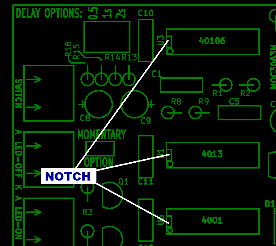

I'm just stuffing my boards now and was wondering if the chip sockets have to be mounted in a specific direction ?
They don't have any requirements, but if you purchased the ones provided in the parts list from Mark, you might consider aligning the notch in the socket relative to the proper orientation of the part on the board. This is particularly recommended if the socket will obscure the silkscreen. The notch is there, why not use it to best effect vs. potentially causing confusion (however unlikely) in the future.
Again, I agree that it's not required, but sharing an additional thought.
The "notch" in the integrated circuit's plastic DIP package, tells you which of the two ends contains pin 1.
The "notch" in the DIP socket, tells you which end of the socket to plug in the pin 1 end of the IC.
I recommend you align the notch of the socket with the notch on the top silkscreen layer (white printing) of the PCBoard. This will provide a visual reminder of which way the IC should plug in.
If you're REALLY nervous about plugging in chips backwards, put a little dab of fingernail polish in the notch of each IC socket before you stuff and solder the socket into the PCB. Days later, when you insert the ICs into the sockets, you'll be able to see the notches on the sockets very clearly. They're the ends with fingernail polish!

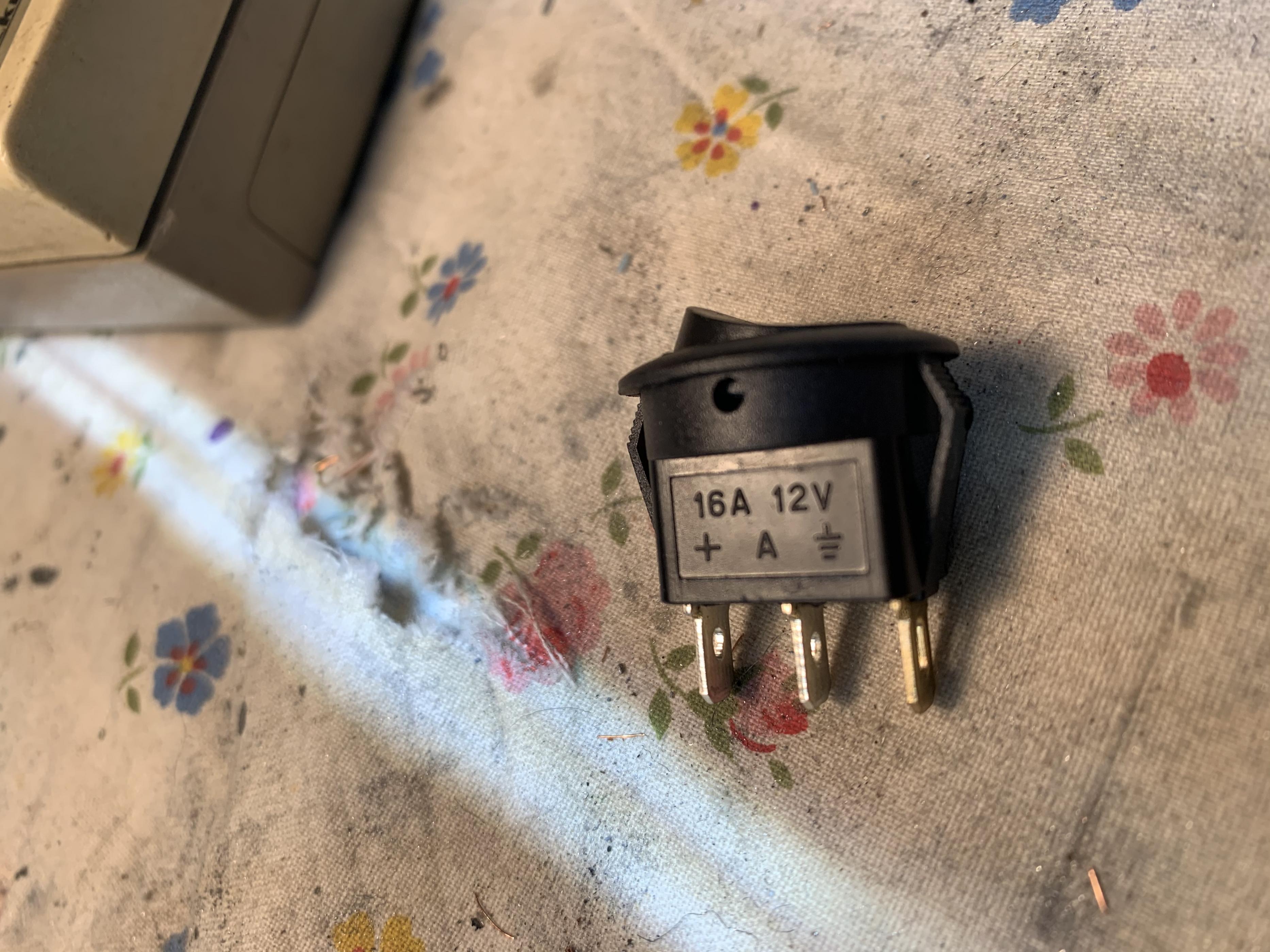

Thanks Mark, I did use the force but still cant get my head around how this will connect to the H9KPXG.
2 wires to the "switch" terminals and then -5v from the 5 volt terminal ?
So I put the "+" and "A" to the switch terminals and the switch works, then I connected the "ground" copper tab to -5 volts and the led comes on but stays on in either state on or off...
I know its simple but I just can't visualize it and don't want to destroy the switch...

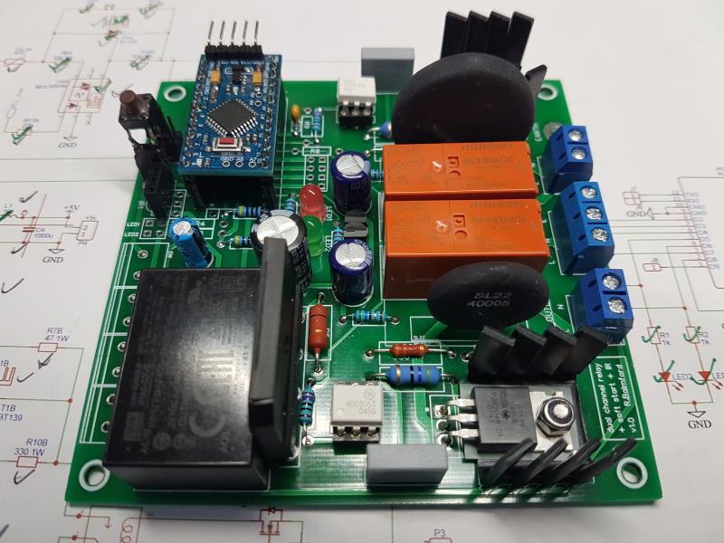

I've got the PCB for my 2-channel 'variation on a theme' built up and tested now. There were a couple of minor mistakes on the board, but nothing that could not easily be worked around.
Both the SL22 and MS32 series ICL's fit well, with plenty of clearance to the relays and heatsinks (see photo for example of both fitted).
For my application I settled on using 40 Ohm SL22's, which reduced the initial inrush current from ~30A down to ~5A. And the IR control works great too!
Thanks for the original design, and helpful pointers to get this board together.
