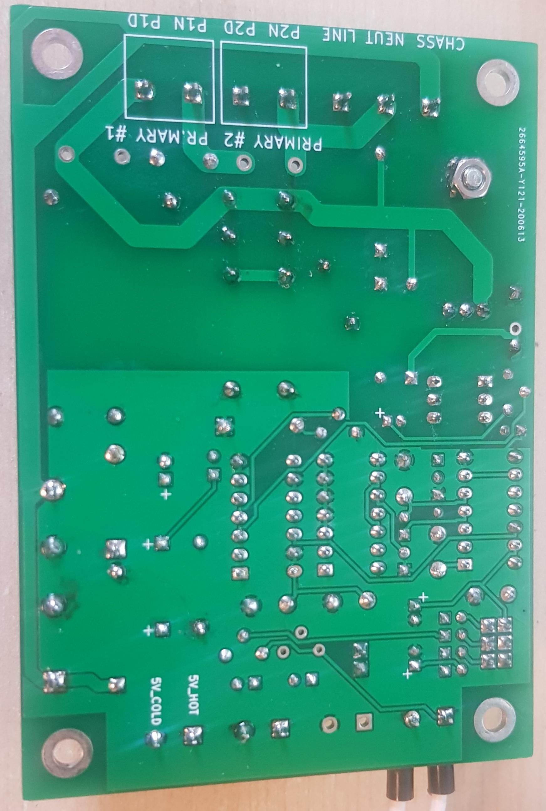

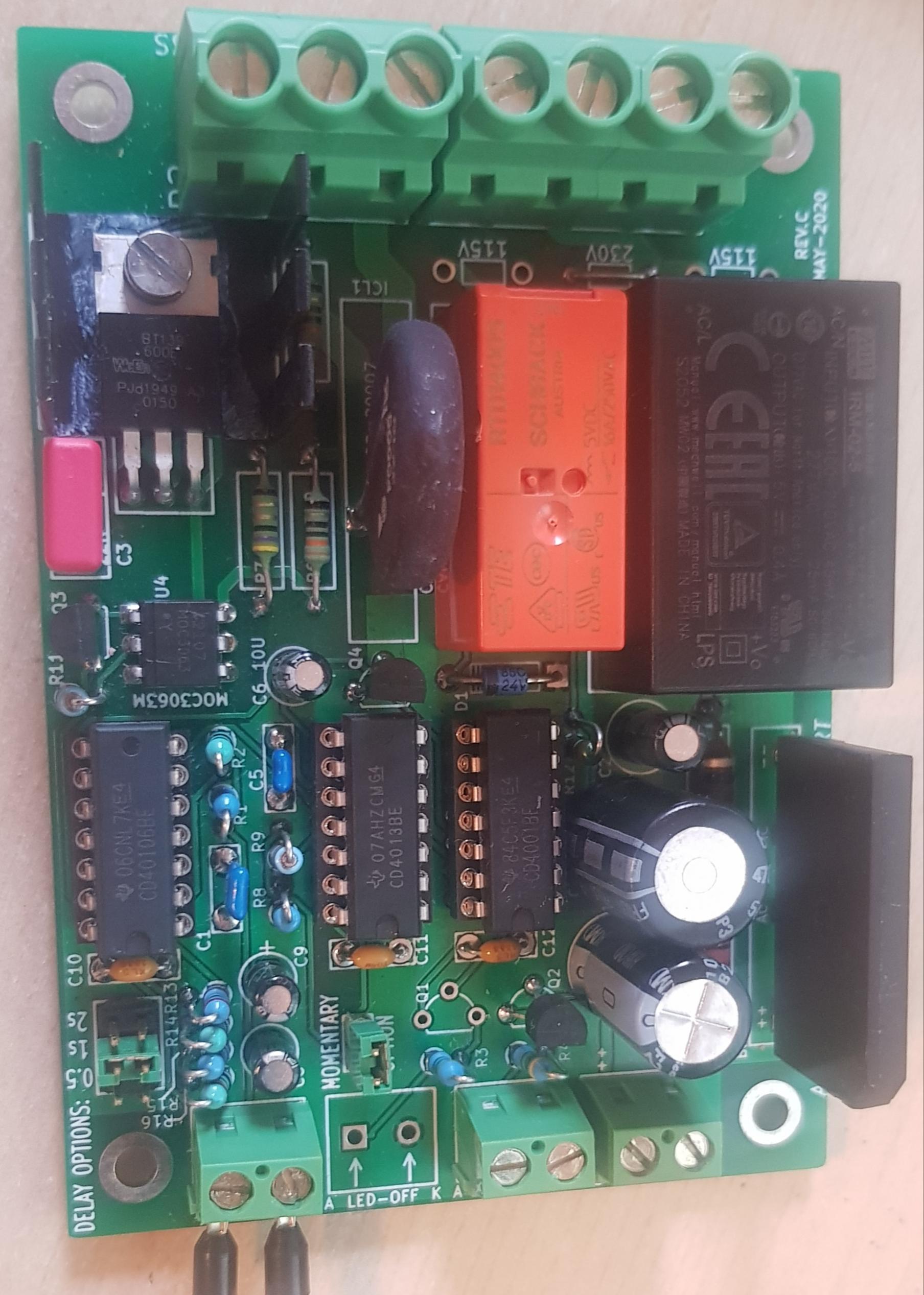

Dear Mark Johnson and all other Forum Members who might help me,
I've built the 230VAC Version of you Board with the Mouser Parts list supplied on Page 2 of this thread. Now I've got the problem that the Board isn't working for me.
I've measured everything on the low voltage side of the board and it seems everything there is working like it's supposed to do. The problem is, the mains voltage is always on the output. I've attached a Transformer-based 5VDC PSU and when switching on the AC Mains switch on the AC inlet, mains voltage is immediately applied to the transformer and the PSU Output. When using the momentary button for the first time you can hear the relay switching after the delay. Mains voltage is still applied. When using the momentary button a second time you can hear the relay switching but mains voltage is still applied and of course it will only turn off if I'm using the switch on my AC Inlet which cuts the power supply of the board, as well as every other mains voltages.
I've got 4 boards populated and got the same problem on all boards. I am using a small 30VA Transformer. Is the mains current drawn to low for the MOC or the Triac to switch everything off?
I hope someone is able to help me or has any ideas on how to fix this.
Thanks in advance
- DosenZorn
Edit: corrected some spelling mistakes
Hello, thanks for the reply. I've attached pictures of both sides to this post.
I do know that I have to insulate the triac from the heatsink and the screw. I have everything to do that and hopefully will do it immediately when I've sorted out the error with your help.
Edit: Of course I've also used the correct NTC for 230V Mains.

Welcome, member DosenZorn!
Other members have encountered similar difficulties. Please read posts #64 thru #69 on this thread, for the problem and its solution.
I recommend that you use a mains-powered, bright light bulb (not an LED) to test your H9KPXG. Here are a couple of examples: (Amazon US link), or in the EU, (Amazon.de link).
I also recommend that you study post #396 on this thread, including the wonderful photo attached. It shows an H9KPXG under test with a proper load.
I also recommend that you read through post #1 of this thread, one more time, keeping in mind that the intended application of H9KPXG is to switch the mains on and off, for an audio power amplifier with a big, >150VA power transformer.
Thanks for the quick reply from the inventor himself.
So my assumption, that the minimal current for the Triac isn't reached and therefore it isn't switching off, seems to be the reason it isn't working for me as intended in my case. So I'll try the Optotriac alone or I'll look for a Triac with low current switching capabilities. If those aren't working I'll just remove the Triac section so the relay does the work alone.
With best regards
DosenZorn

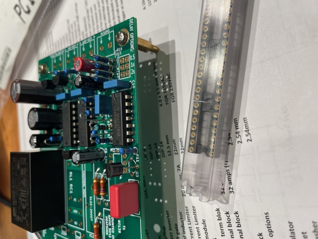

Forgot the socket!?
Hey all.. I've been slowly working on a few of these power boards, one for my Aleph J, and the other for Salas DCG3.. So far, so good until this evening when I forgot that U1/2/3 had sockets.. I mistakenly soldered them directly to the board absent the sockets..
Any issues with this other than an inability to remove them should one of them have an issue? Should I attempt to desolder/insert sockets and re-order U1/3/5?

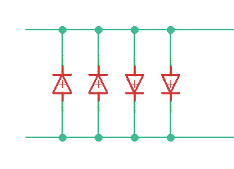

Dear membership of diyAudio,
I was hoping to understand a bit how the implementation of this circuit works. I am struggling to understand the small +5V PSU implementation, particularly the chassis / earth concerns (paranoia in the words of Mark).
How and when is the BR1 useful? Since BR1 legs 3 and 2 are shorted, and 4 and 1 as well, this part of the circuit:
Would be like building this:
If this is correct, how is that not a short-circuit? I am failing to understand where would that kick in to protect and not short D-- to Chassis Earth.
Thanks for any feedback, and sorry if this, as usual, is obvious to most and just eludes me completely.
Best,
Rafa.
My mistake, I need to look further into this grounding circuit myself.
