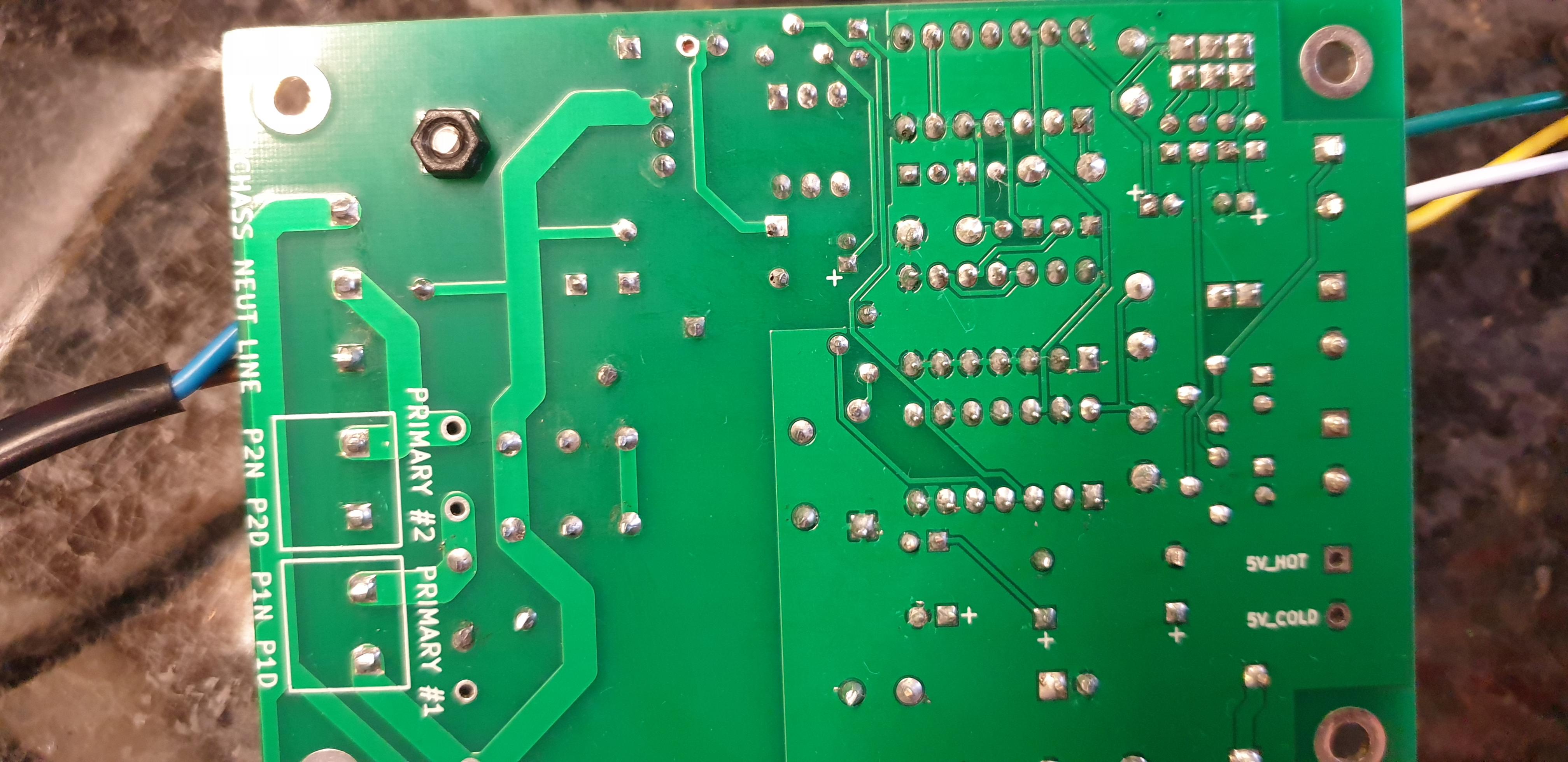

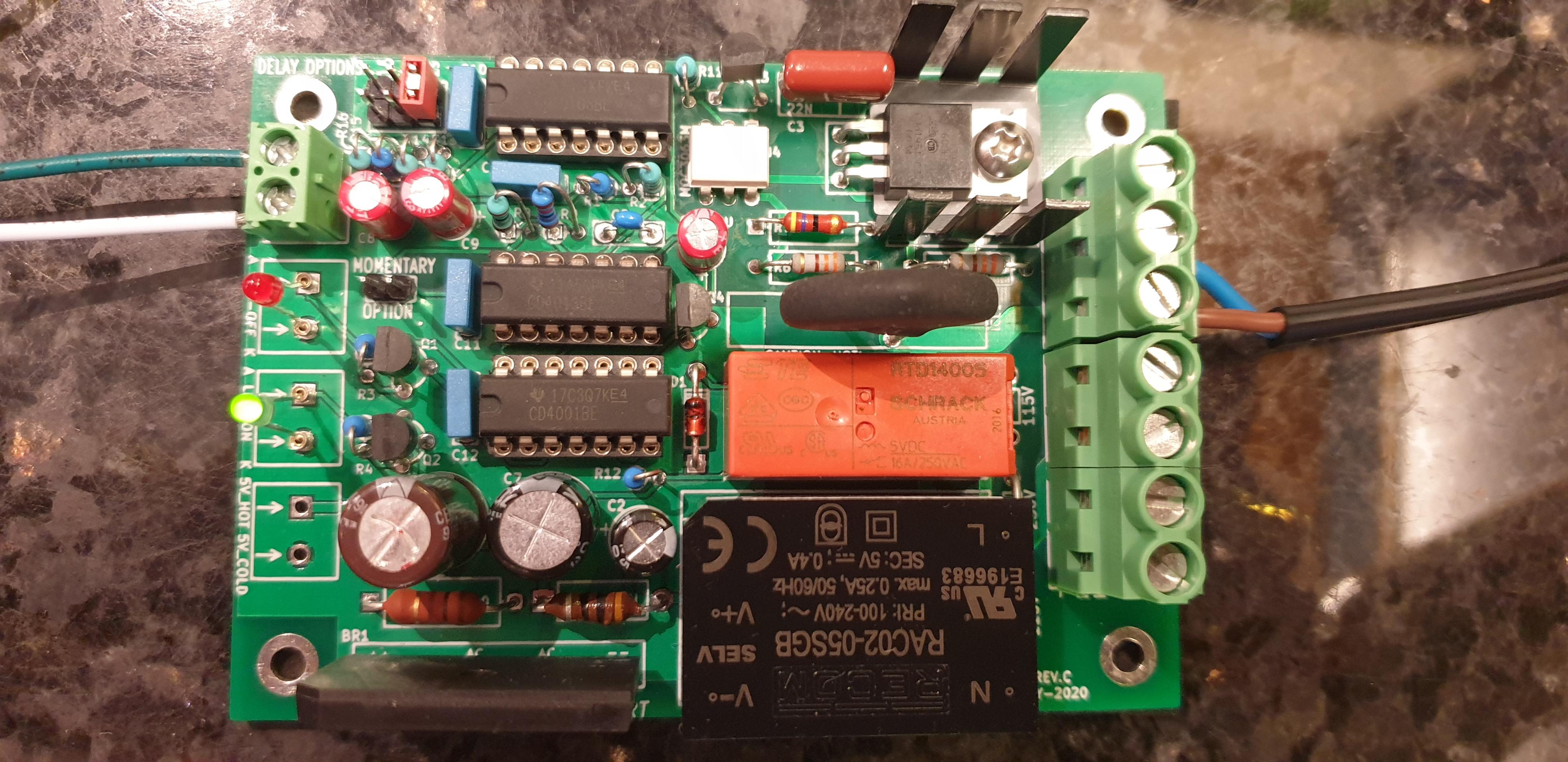

Hello all.
Another one is born, and I was going to say it breathes aswell but all is not well!
Initial power up proves the relay and leds are doing the correct things. But when I measure the output I have the same readings even with the board switched off.
I have jumpered for 230v and I see these VACs.
P1D P2D 240
P1D P1N approx 16
P2D P2N approx 6.
Same results with either switched on or off.
I've read the thread a couple times but I havent been able to suss out where I am wrong. Any advice appreciated.
P1D P2D 240
P1D P1N approx 16
P2D P2N approx 6.
I think I sussed it with posts 125 and 126.....its a no load thing! Just tested it (with a 2 wire primary 240v trafo)

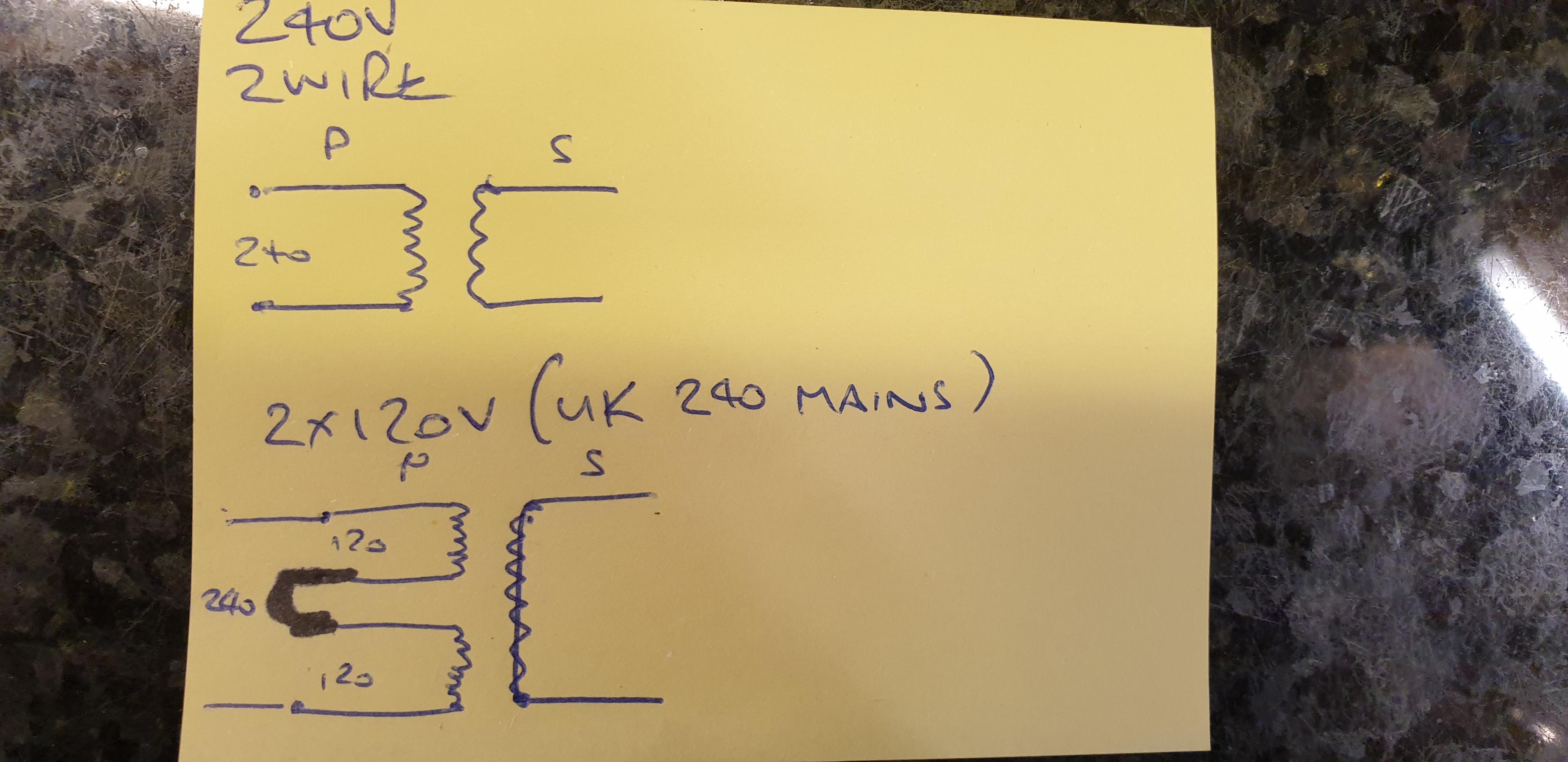

So if I have a transformer that has 4 primary wires would I remove 230v jumper and use all 4 P1 and P2 connectors?
Draw a schematic diagram showing exactly how you'd want all four primary wires to be connected to the mains (or to each other, or both), if there were no H9KPXG involved.
This will make it easy for you to decide, how you'll configure an H9KPXG in order to achieve your desired connections.
Thanks Mark. This is very simple but sometimes the simple things trip me up.
So if I had a 2 wire primary 240v trafo I would wire as in the top diagram.
If I had a trafo with 4 wires ( 2 x120v) to wire to UK 240v mains I would wire as the lower diagram.. Black link wire to create series connection.
Thankyou
Thankyou
So wire it up like diagram #2, and you already have the “link” on the board - the 240V link. You should be good to go.
