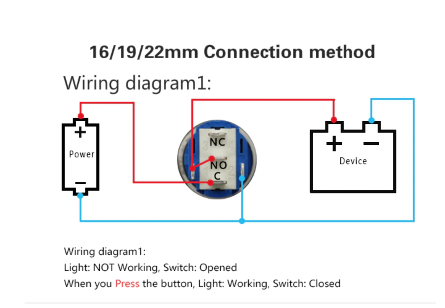

I've built two of these boards and have tested both.. Both working as expected so far. I'll be using one in Salas DCG3, and one later in my Aleph J.
I ordered a latching push button with LED from AliExpress to use on my DCG3. I"m mostly certain I have wired the switch improperly and this application is not very well documented on the tech portion of the AliExpress product page.
Seems to be working however it's powering "On" with the button out, and "OFF" with the button "IN" which is opposite from what I'd expect (and not what a similar switch on my WHAMMY) does..
Product Page: https://www.aliexpress.com/item/1005002610826549.html?spm=a2g0s.9042311.0.0.451e4c4dJtbNm5
My switch has this rear connector:
I currently have it wired to power board "Switch" at the NC and C.. and the "LED on" at power board to the two left and right terminals on the back of the switch pictured above.. Thanks for any suggestions.. Hate to blow the LED or fry myself! lol..

Just move the wire from the NC (normally closed) lug to the NO (normally open) lug...your switch should conduct with the pushbutton "IN" now.
"When in doubt -- buzz it out!"
Meaning: don't trust the documentation until after you verify it yourself on the real thing. Use the continuity tester ("buzzer") feature of your multimeter to find a pair of I/O terminals on the switch, I'll call them "Bob" and "Alice", with these features:
- When button is not pushed, no continuity between Bob and Alice
- When button IS pushed, yes there is continuity between Bob and Alice

Kevin! Thank you.. Super simple solution.. Foolishly, I didn't know what NC and NO stood for.. (I'm learning very slowly!)
