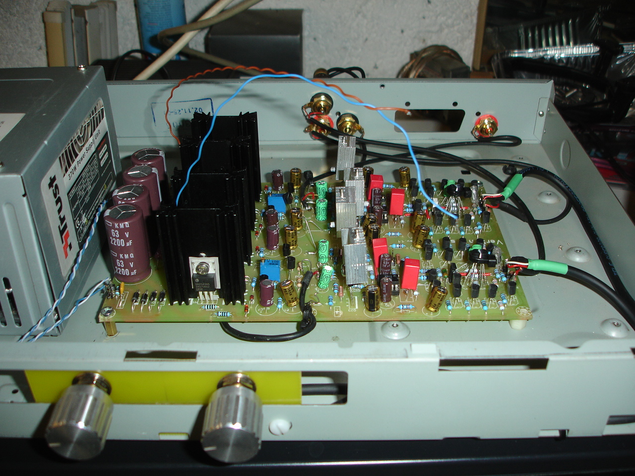

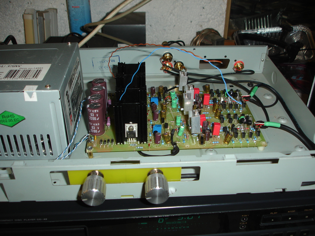

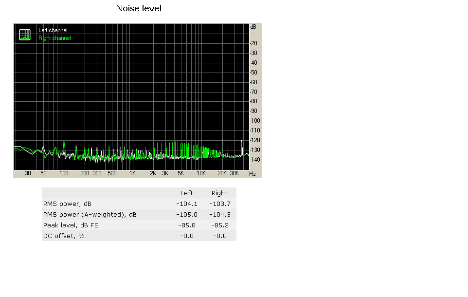

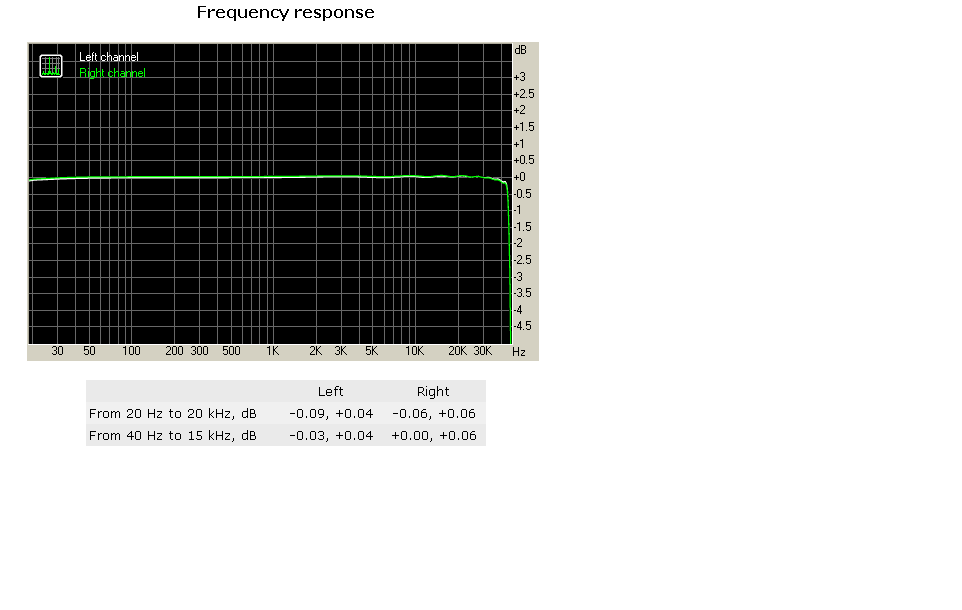

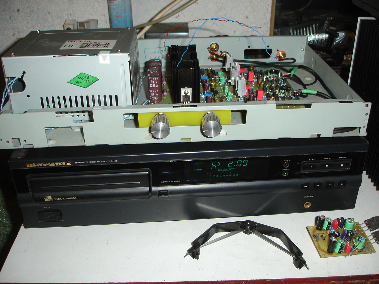

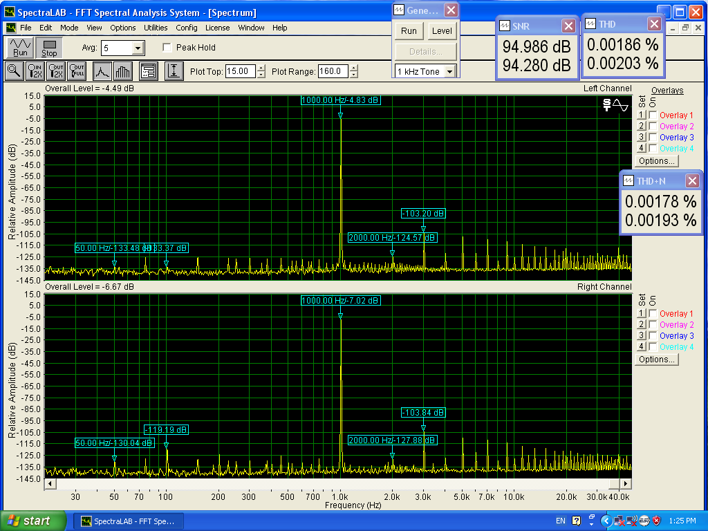

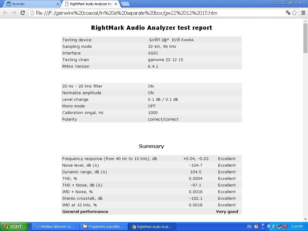

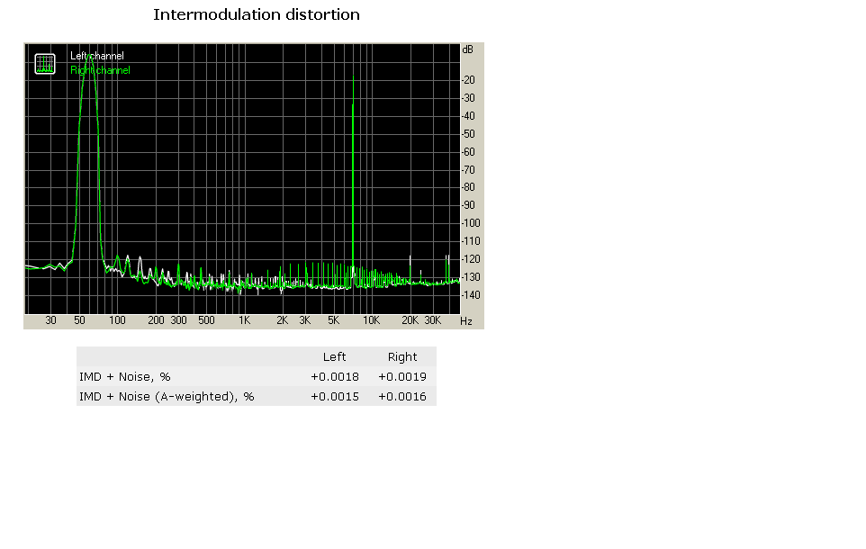

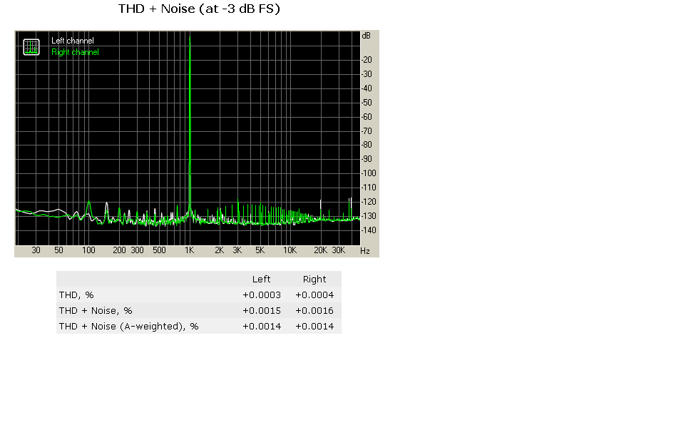

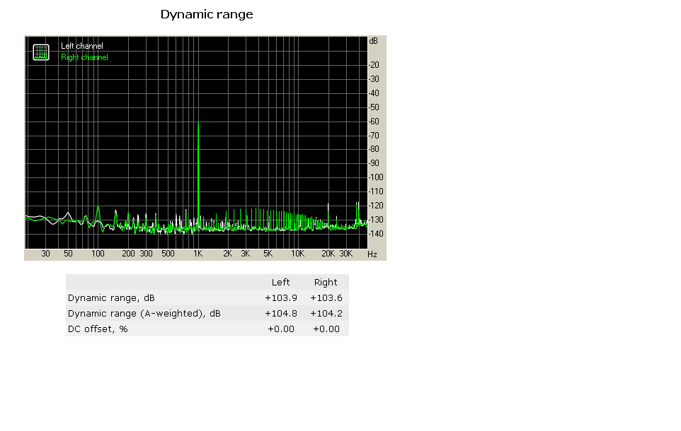

Mk2 as it now
testing results using SpectraLAB
What was the load at the GW output when you were doing the measurements?
Thear isn`t any load than sound card line input impedanceWhat was the load at the GW output when you were doing the measurements?
Thear isn`t other load than sound card imput impedanceWhat was the load at the GW output when you were doing the measurements?
There is always 10k resistor on the output.
Thank you both for reply. That's what I suspected. It would be good to see how GW measures when loaded with something like 50R.
