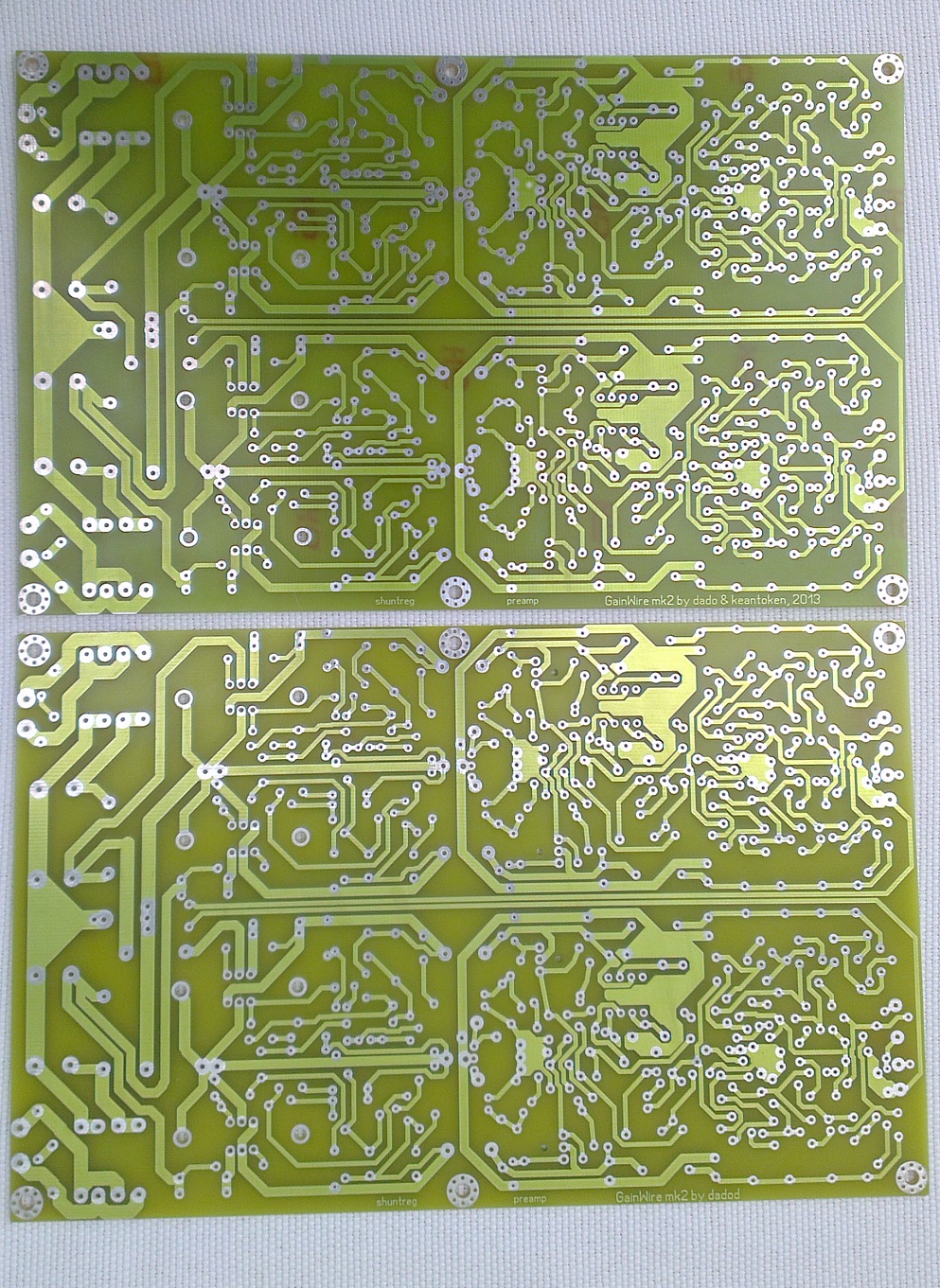

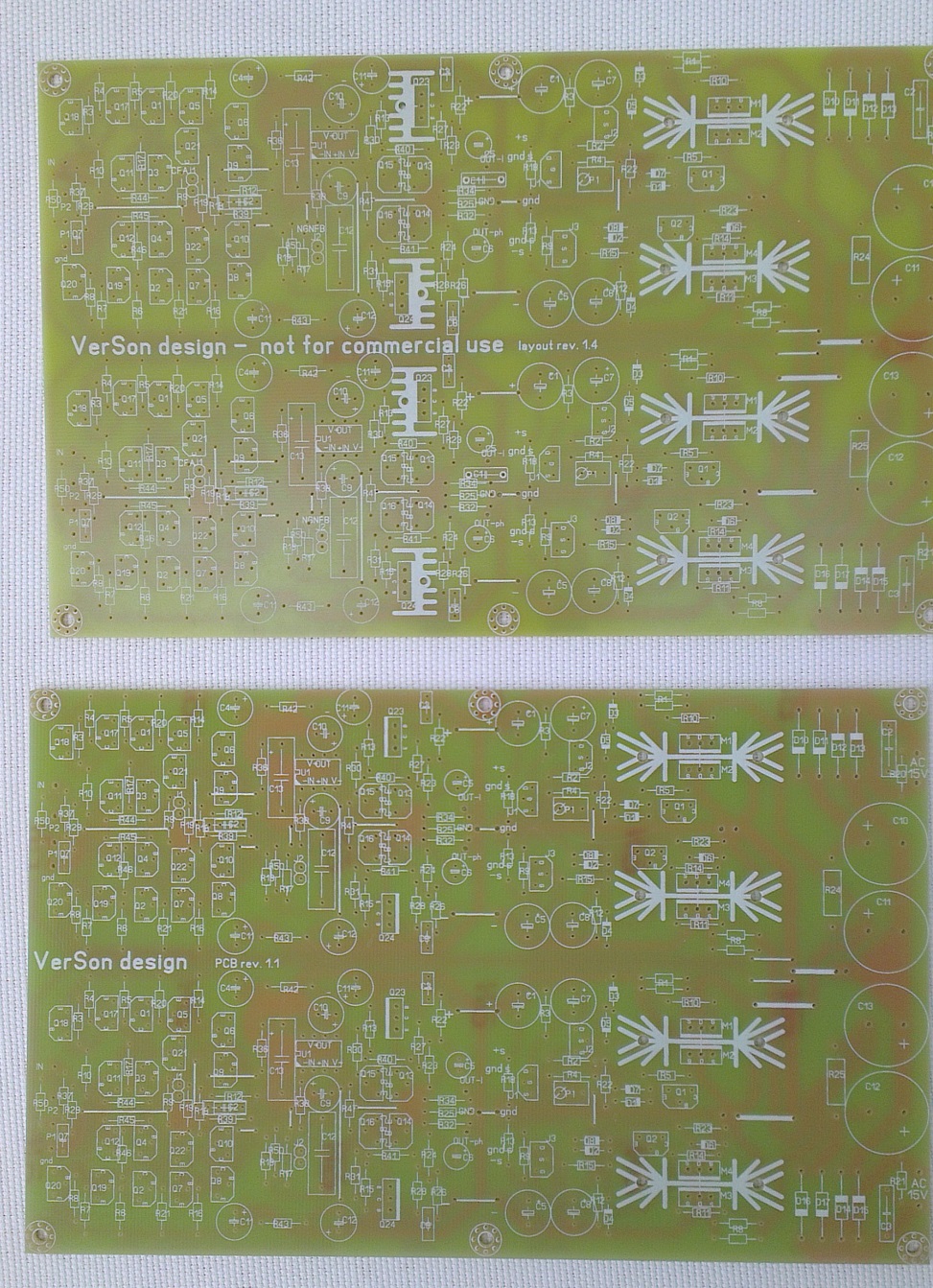

I still have two last GainWire mk2 boards, one PCB rev 1.1 2mm thick and one PCB rev 1.4 1.6mm thick. Both are the same single side layouts, just rev 1.4 has small heat sinks for the output buffer.
If someone is interested PM me, price is 20 EUR per board, plus shipping.
