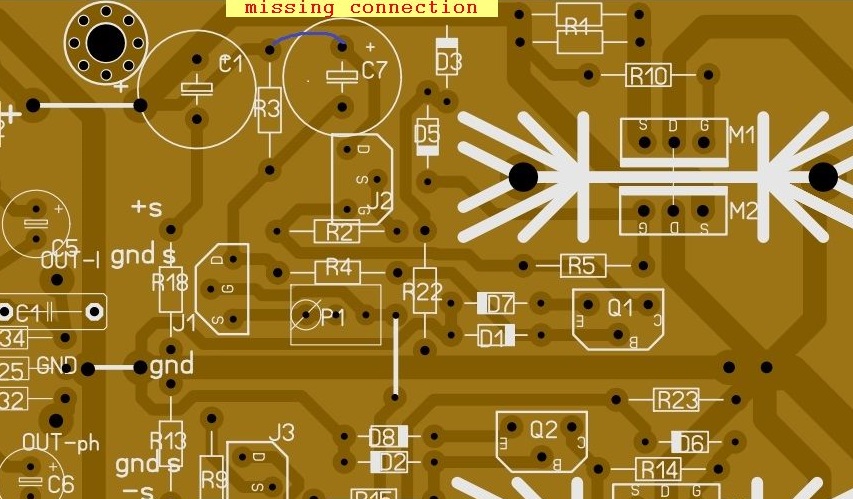

I have to apologize, I missed one connection when I prepared new high bias PCB version.
There missing connection between C7 And R3, picture attached. Just solder sort wire between those two points.
Damir

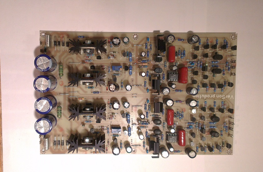

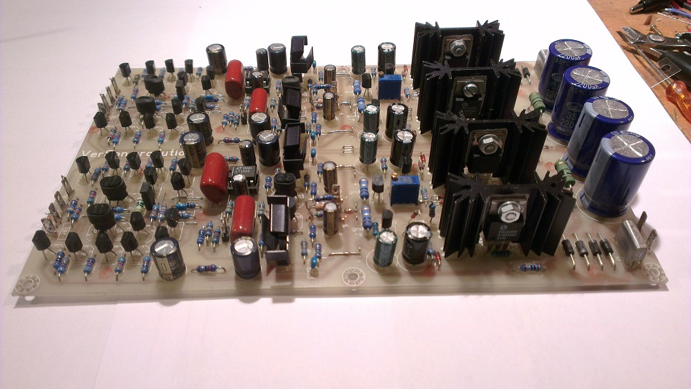

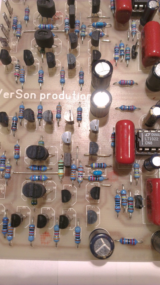

I have one finished GainWire mk2 board. It was used in my setup, but now I don't need it as I am going to balanced mk3 version. If someone interested to buy it PM to me.
This is stereo board with power supply(shunt) with possibility to choose between CFA mode and NGNFB mode with just two jumpers(stereo).
All you need to add are one 30VA 2x15V AC transformer and volume control with input selection.
Damir
