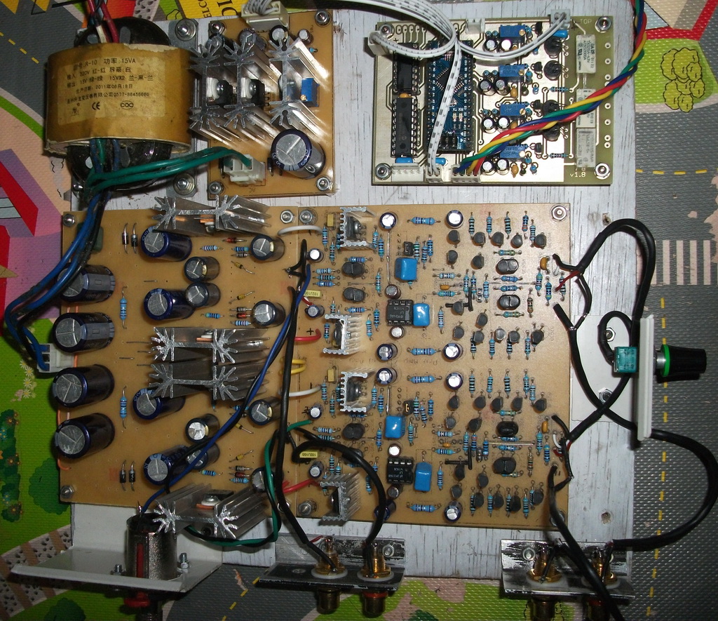

I have to report my transitor roll experience on cascode bjt on the output stage.
I tried BD139C/BD140C, KSE340/KSE350, KSC2690/KSA1220, 2SC3600/2SA1407.
Little different but I choose 2SC3600/2SA1407 in the end, KSC2690/KSA1220 come second place. I think 2SC3600/2SA1407 has a little clear and little dynamic than others. Just my opinion.
I also seperate the buffer part of the GW mkII to a single PCB layout so I can use it for other things. I really like it.

I didn't use shunt reg, DN2450 no available in my country. Just zener string and Mosfet for PSU.

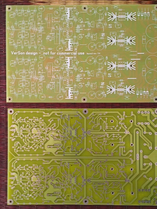

The boards are here, please send me PM with the PayPal email address and I will send PayPal a Request a Payment.

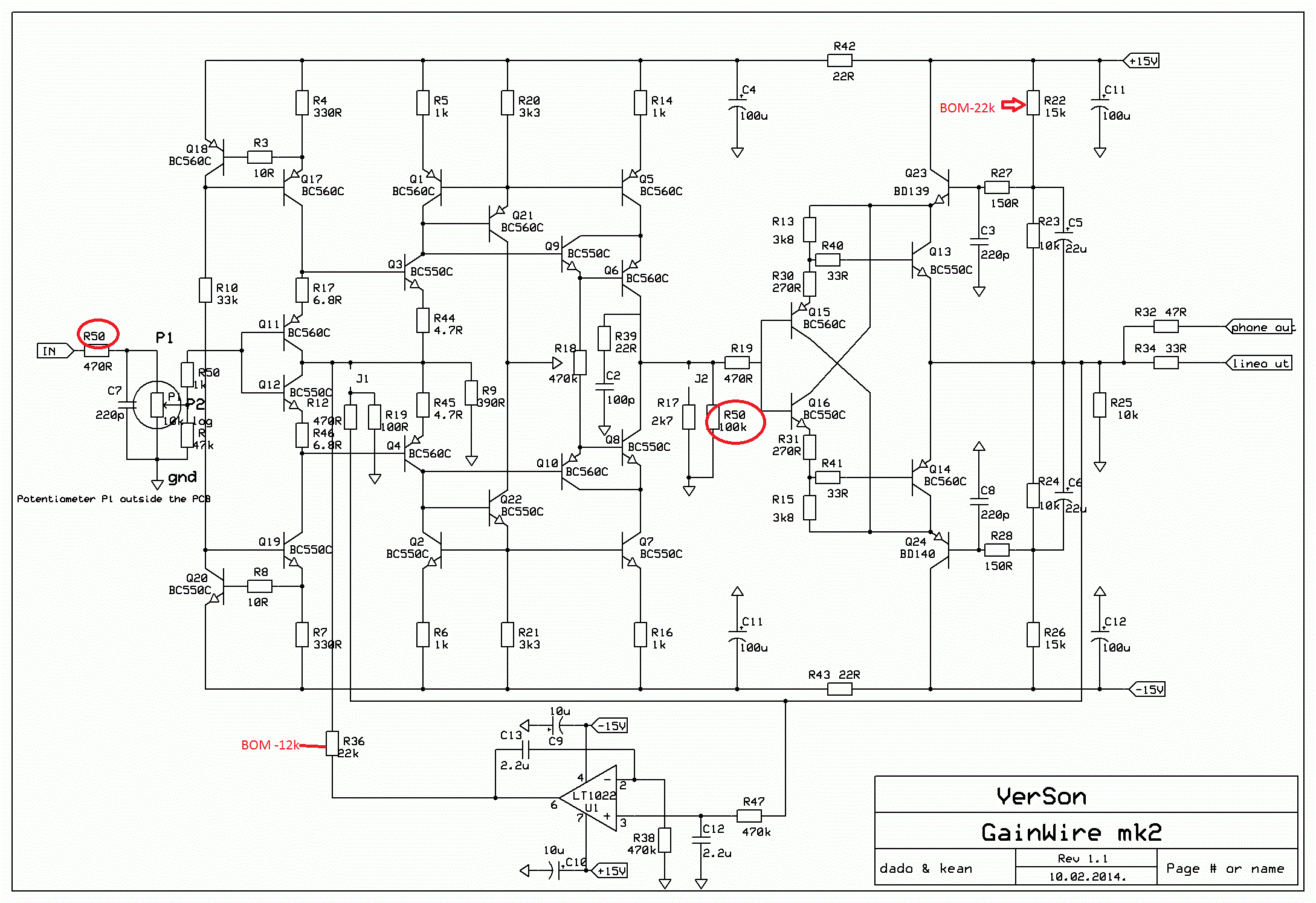

Hello
reading BOM I did found bellow differences in refer to the last ( I hope ) schematic
Wouldn't be also better , if the RC filtration would be placed after the 10k pot instead of before ??
If someone will use long cables to connect the pot to the PCB, they will act as antena and could pick up some high Hz noise which will enter the input BJT pair

You can change that about the pot as you wish.
I will check everything again next week (before you get the board) and make one post with explanation and the link in first post.
