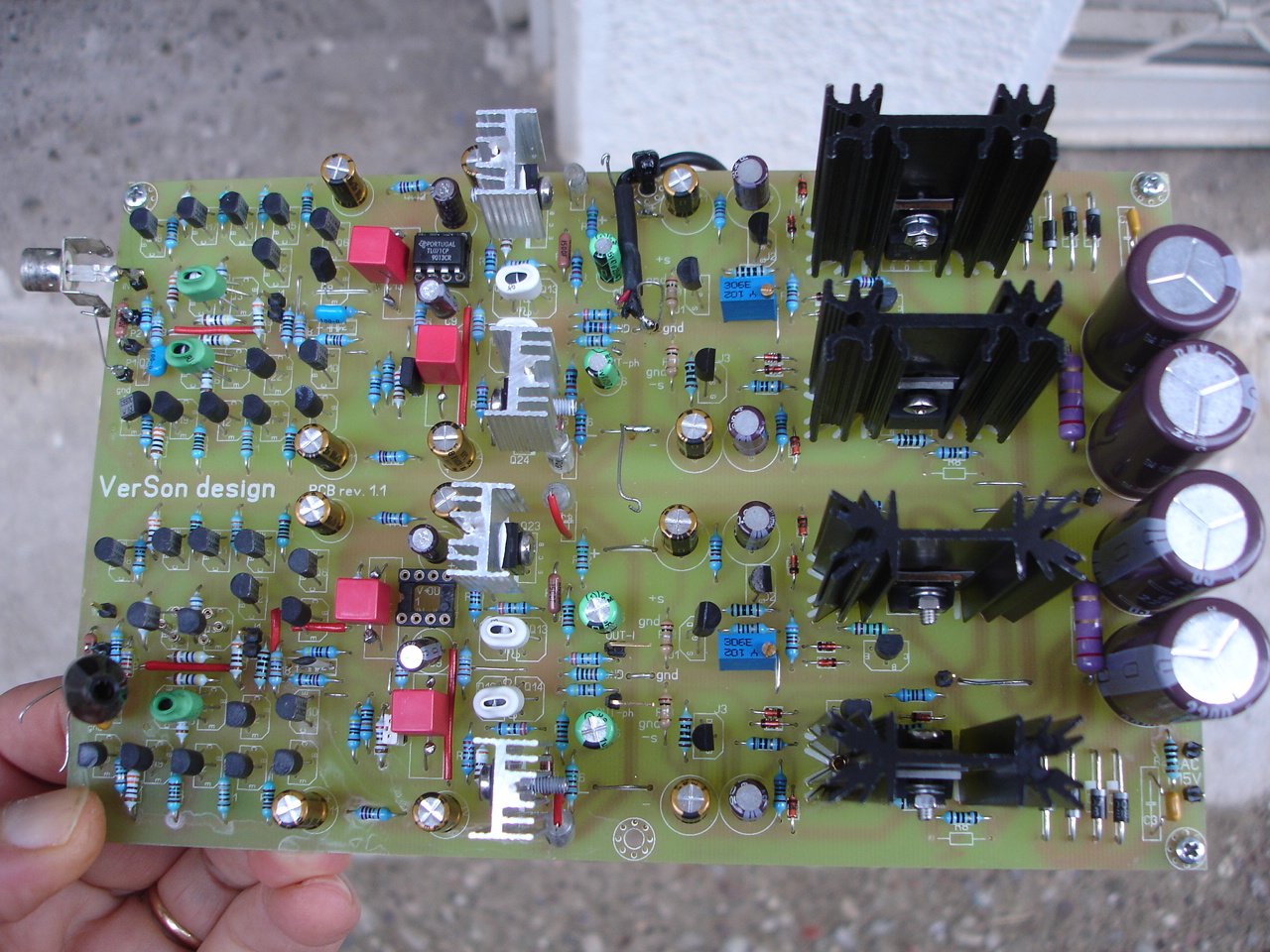

What transformer is the best choice for GainWire MK2?
2x15v 50VA OR
2X18V 50VA?
2x15 V AC is good choice, 2x18 V could produce to much heat on the CCS MOSFET (depends of the heat sink you choose). I use 2x15 V in my GainWire.

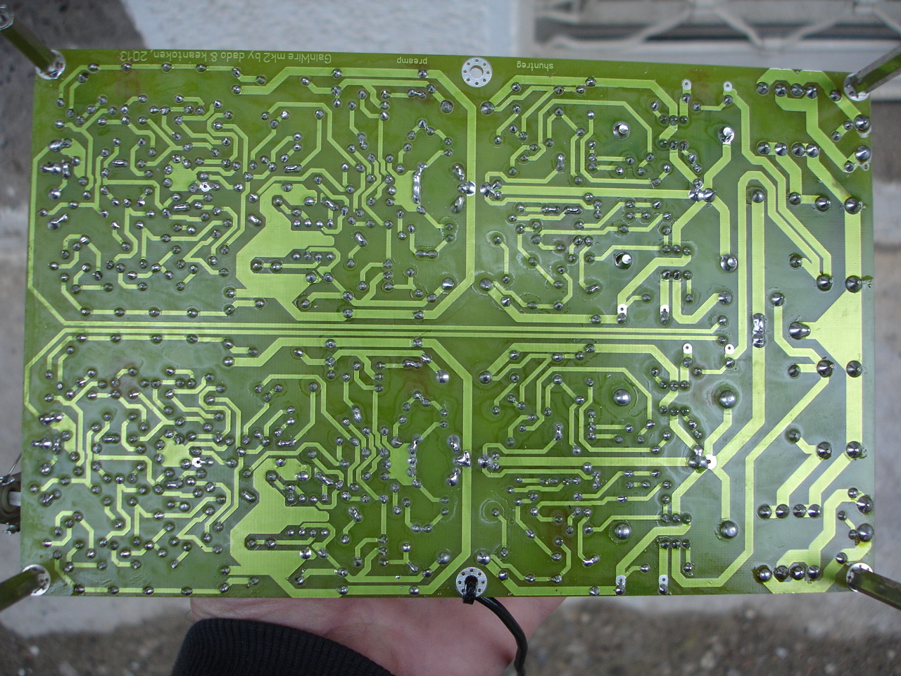

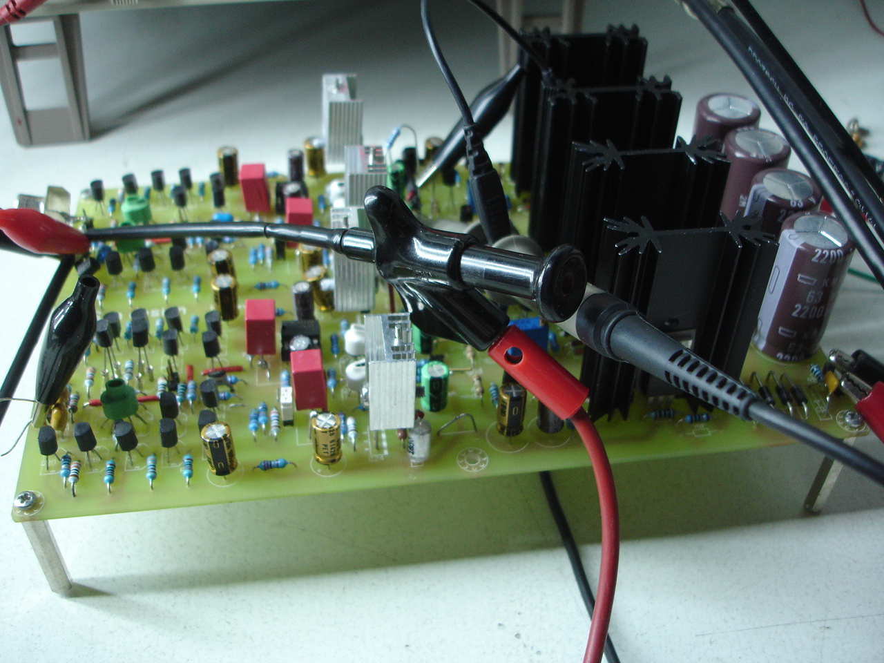

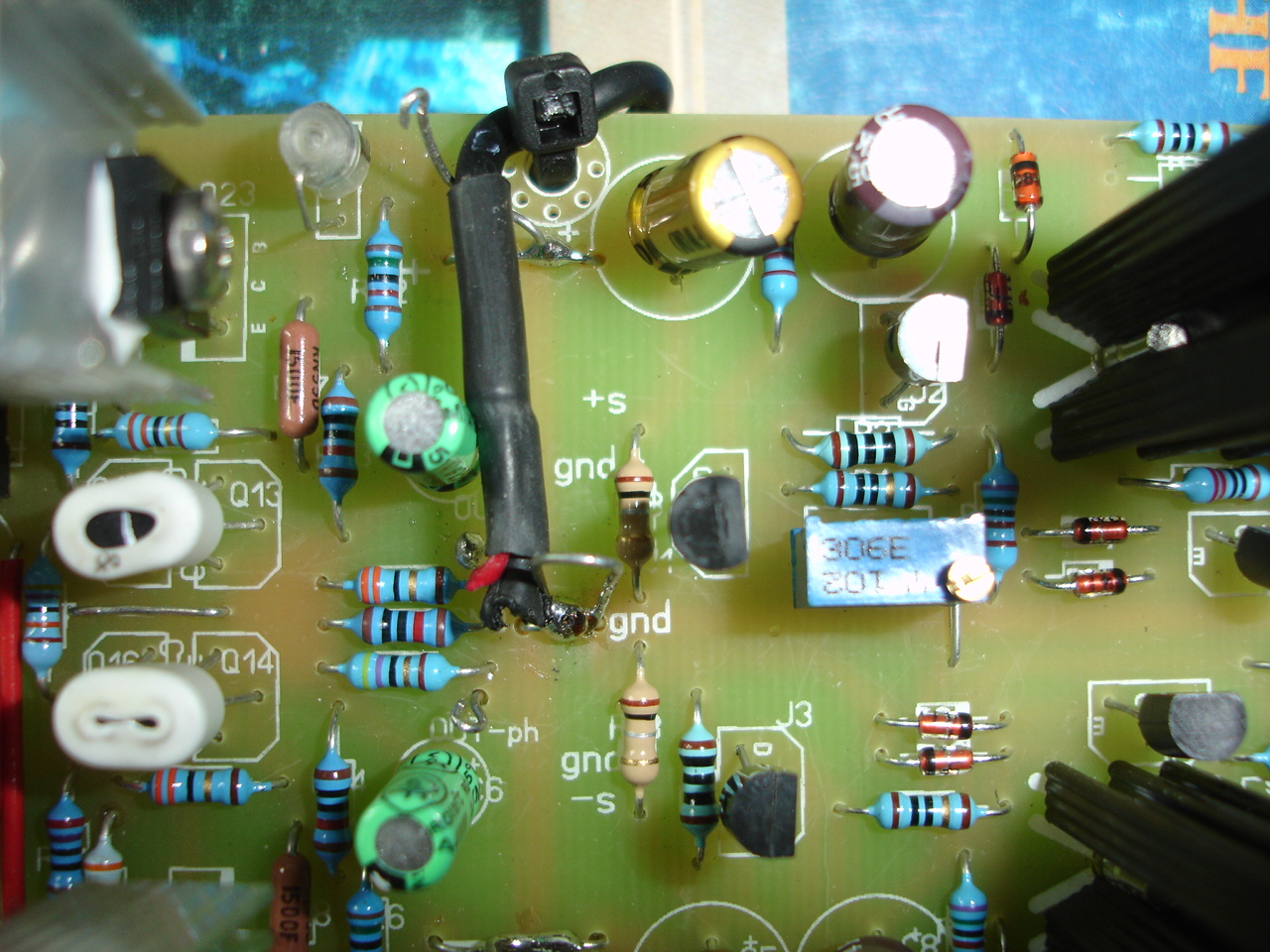

J1,J2,J3 schematics & pcb(FOOTPRINT) don't match. What is the right one?
Please look at the picture J1=2sk117 ,J3,J2=BF245A.
J2 and J3 originally are 2N5457 and the footprint is OK for them, if you want to use BF245A you should rotate for 180 degree.
You know that a drain and a source are interchangeable for JFETs. You can rotate 2SK170 or leave it as it is, it will still work. It was to late to change silk screen when I ordered the board.
Ok ,so i can power this using the original power supply this afternoon .J2 and J3 originally are 2N5457 and the footprint is OK for them, if you want to use BF245A you should rotate for 180 degree.

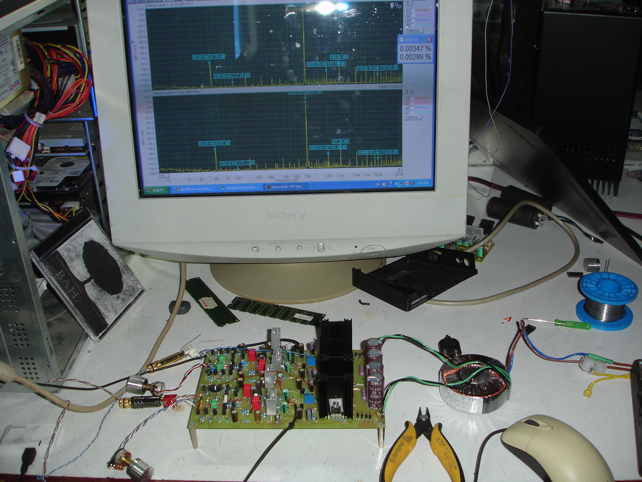

I am waiting for your opinion.
Damir
Take care, it looks like one of the transistors should be upside down in one channel, comparing to the other.New progress
Are you talking about J 1?Take care, it looks like one of the transistors should be upside down in one channel, comparing to the other.
It is a JFET 2sk117. Drain and source are interchangeable. Any disadvantage?

?Are you talking about J 1?

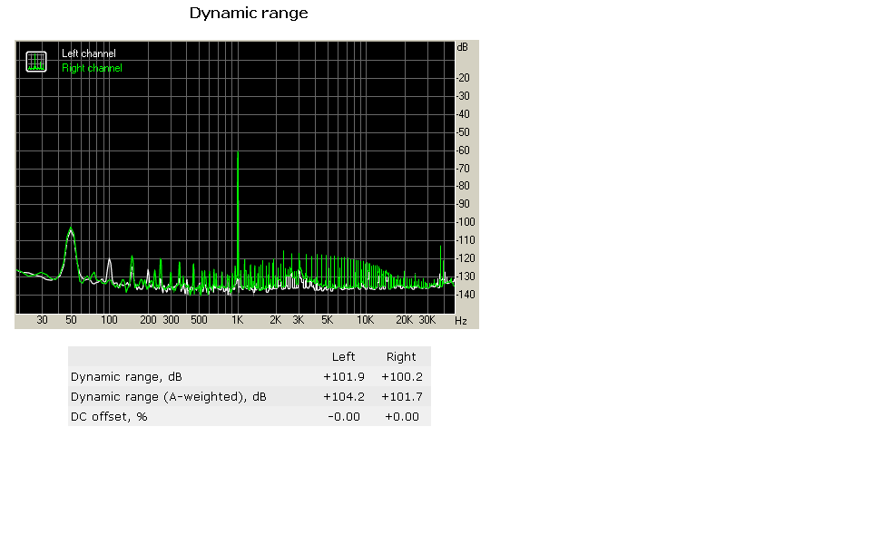

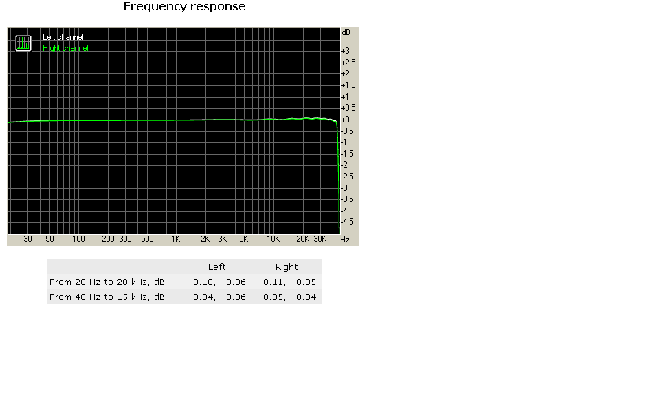

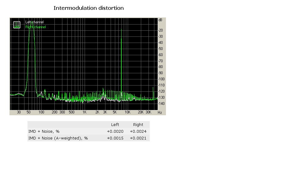

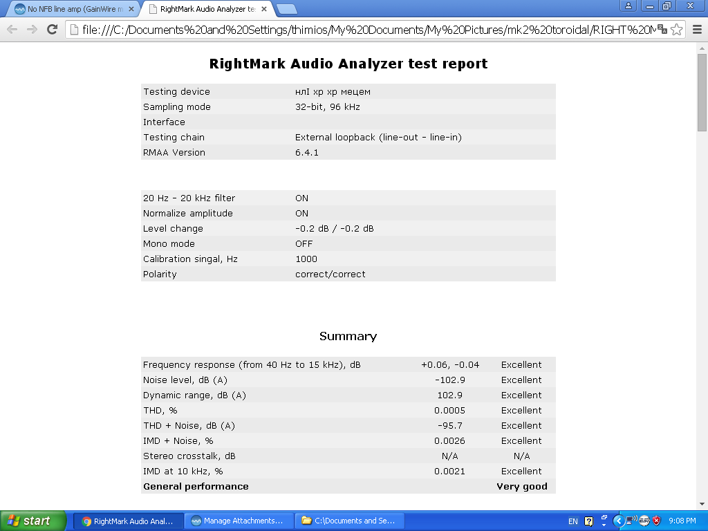

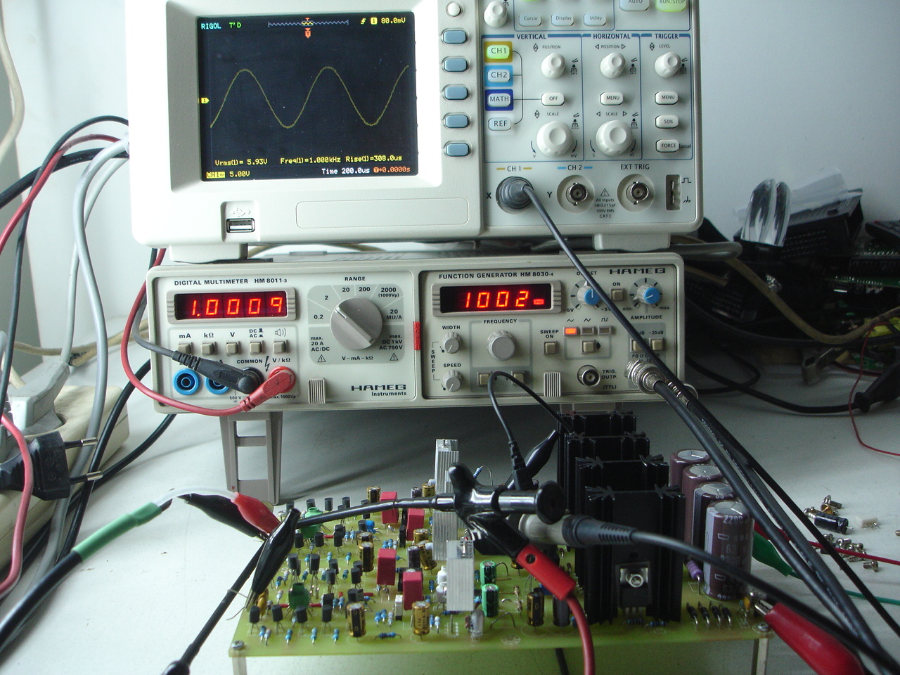

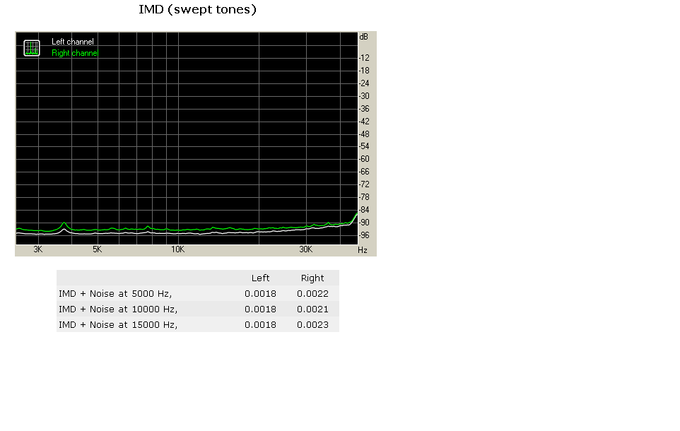

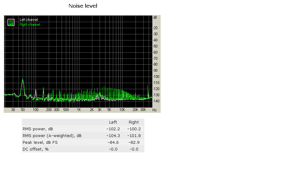

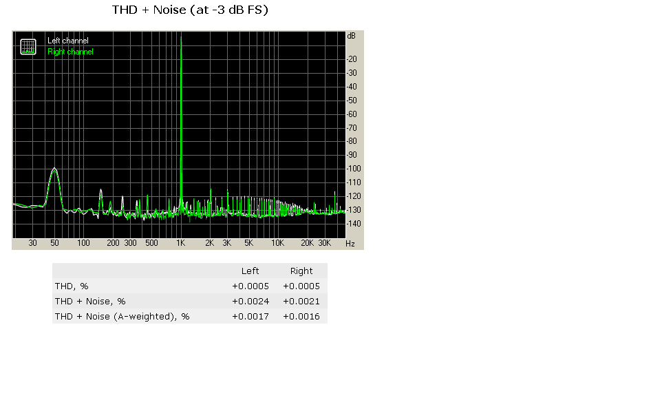

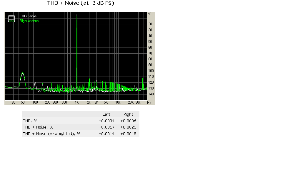

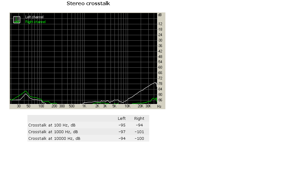

mk2 lower gain

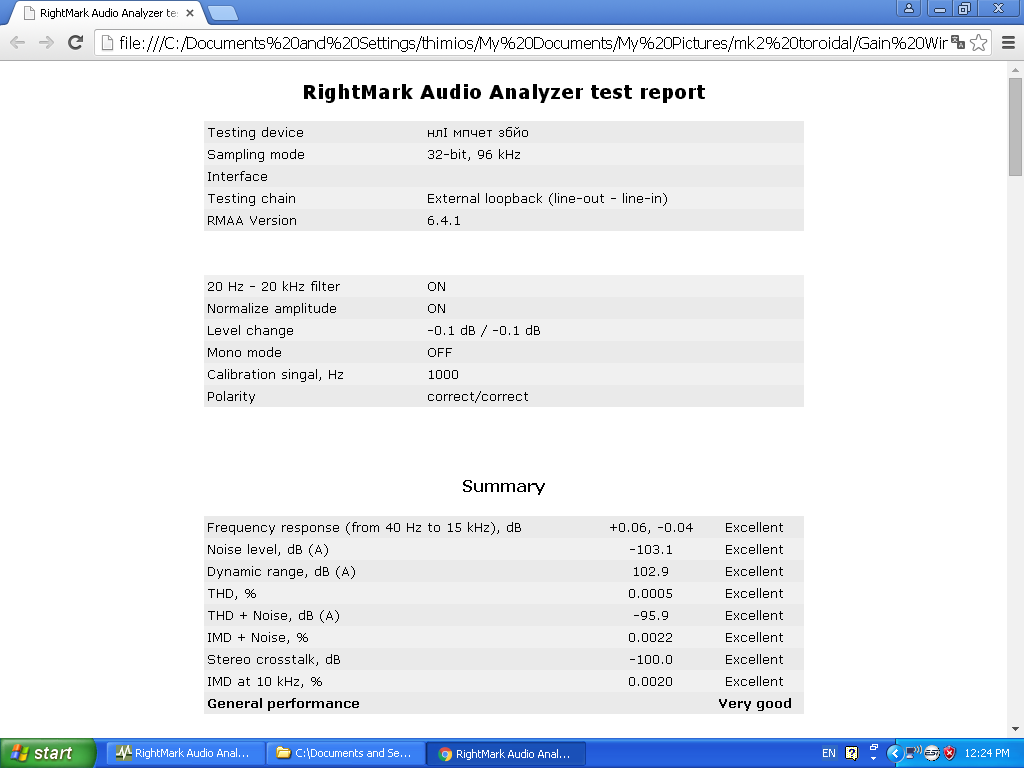

A GainWire lower gain version(CFA mode) ,using RightMark software.
Please keep in mind ,this is what MY sound card measure.Probably the GainWire is much better!
I wanted to ask you what's that 50Hz hump on the distortion graphs, and than I see different text "Please keep in mind ,this is what MY sound card measure.Probably the GainWire is much better" ?
How is that possible?
edit: after I quoted you I can see complete text?????
This 50Hz hum is something i see always when testing with my p.c. I don't know whyI wanted to ask you what's that 50Hz hump on the distortion graphs, and than I see different text "Please keep in mind ,this is what MY sound card measure.Probably the GainWire is much better" ?
My sound card is an esi julia (pci).
I'm sure with a better sound card the GainWire will measure even better.(lower distortion)
Does lower gain suite you better?
- No NFB line amp (GainWire mk2)
