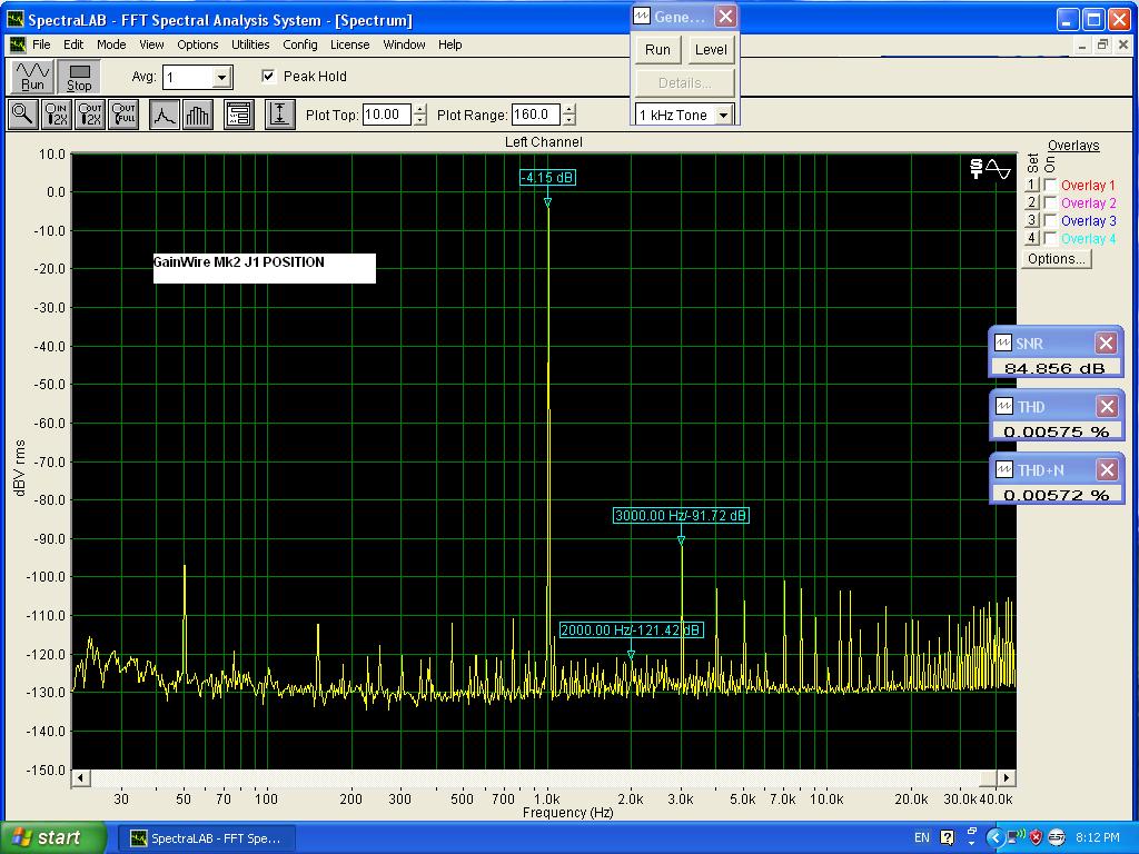

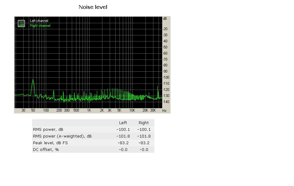

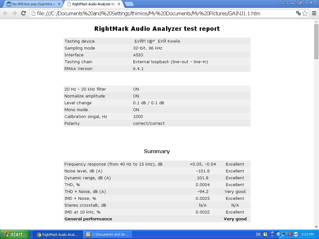

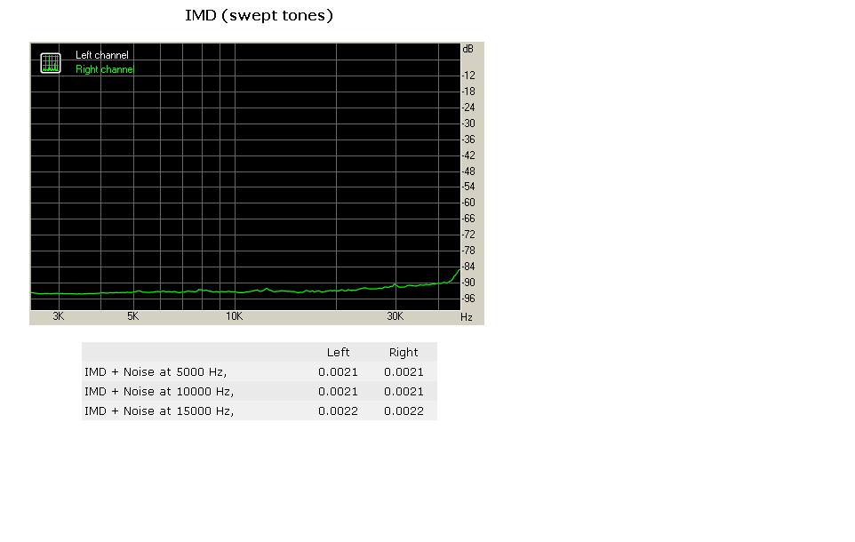

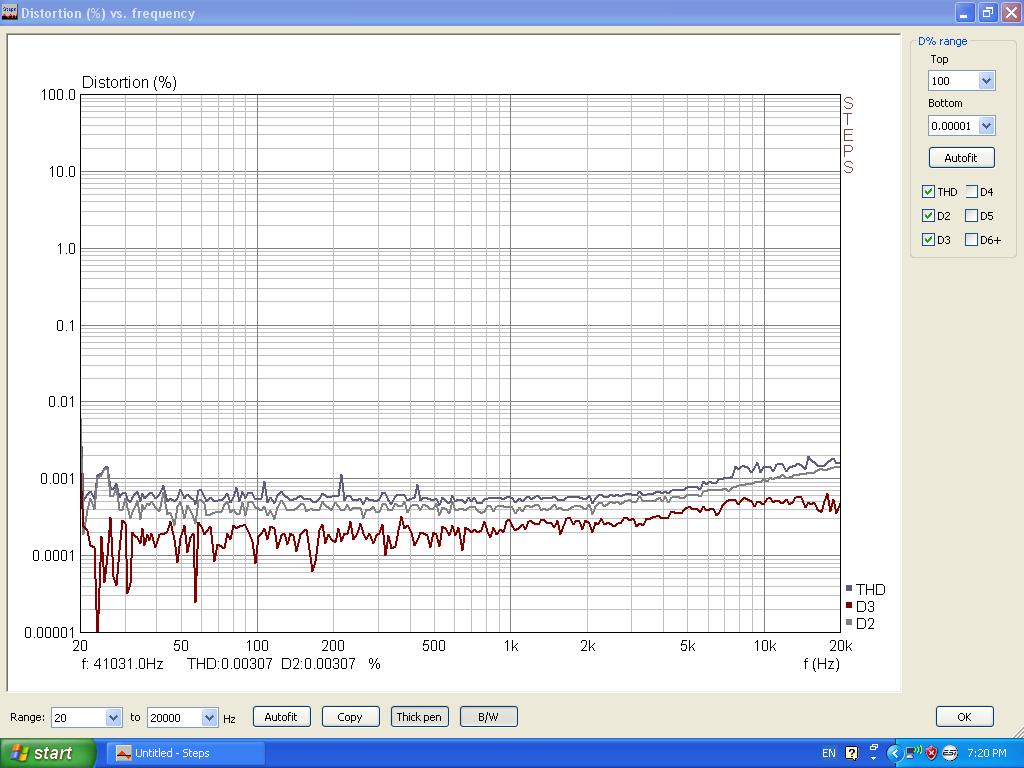

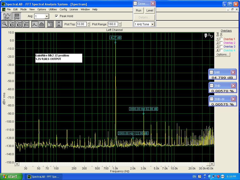

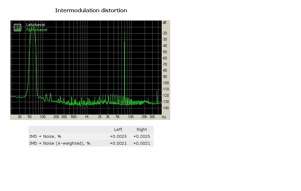

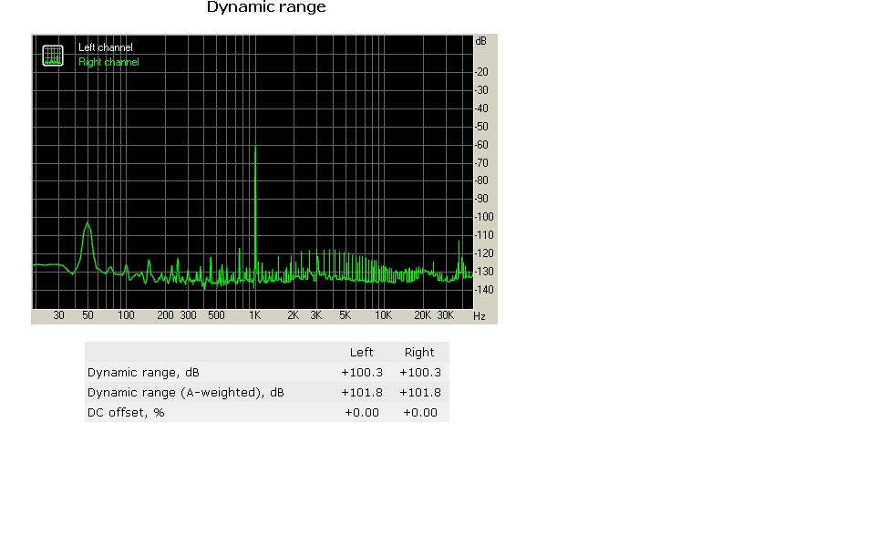

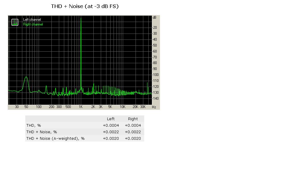

Gain Wire Mk2 test
Testing GainWire. Power supply +/-15v (two separate regulated power supplies)
Please keep in meant, this is what my sound card can measure.
Where J1,J2 are the jumpers settings.
Right Mark test is at J1 position.
You don't say in what mode you did the measurement, CFA or NGNFB?
OK, I see it now.
Too late to editing.You don't say in what mode you did the measurement, CFA or NGNFB?
Picture number 1)CFA
2)NGFA
3)CFA
All the RightMark audio anal. in CFA Mode.
