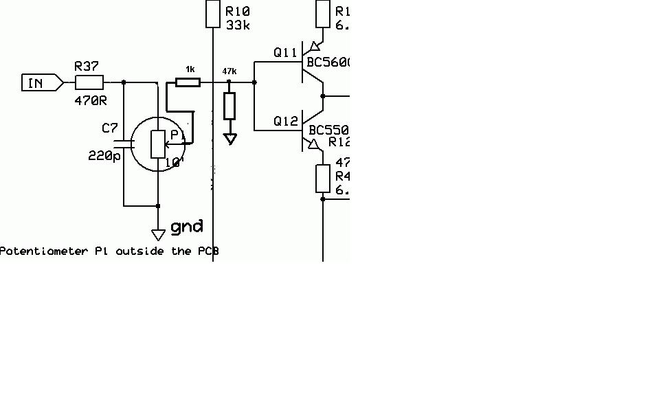

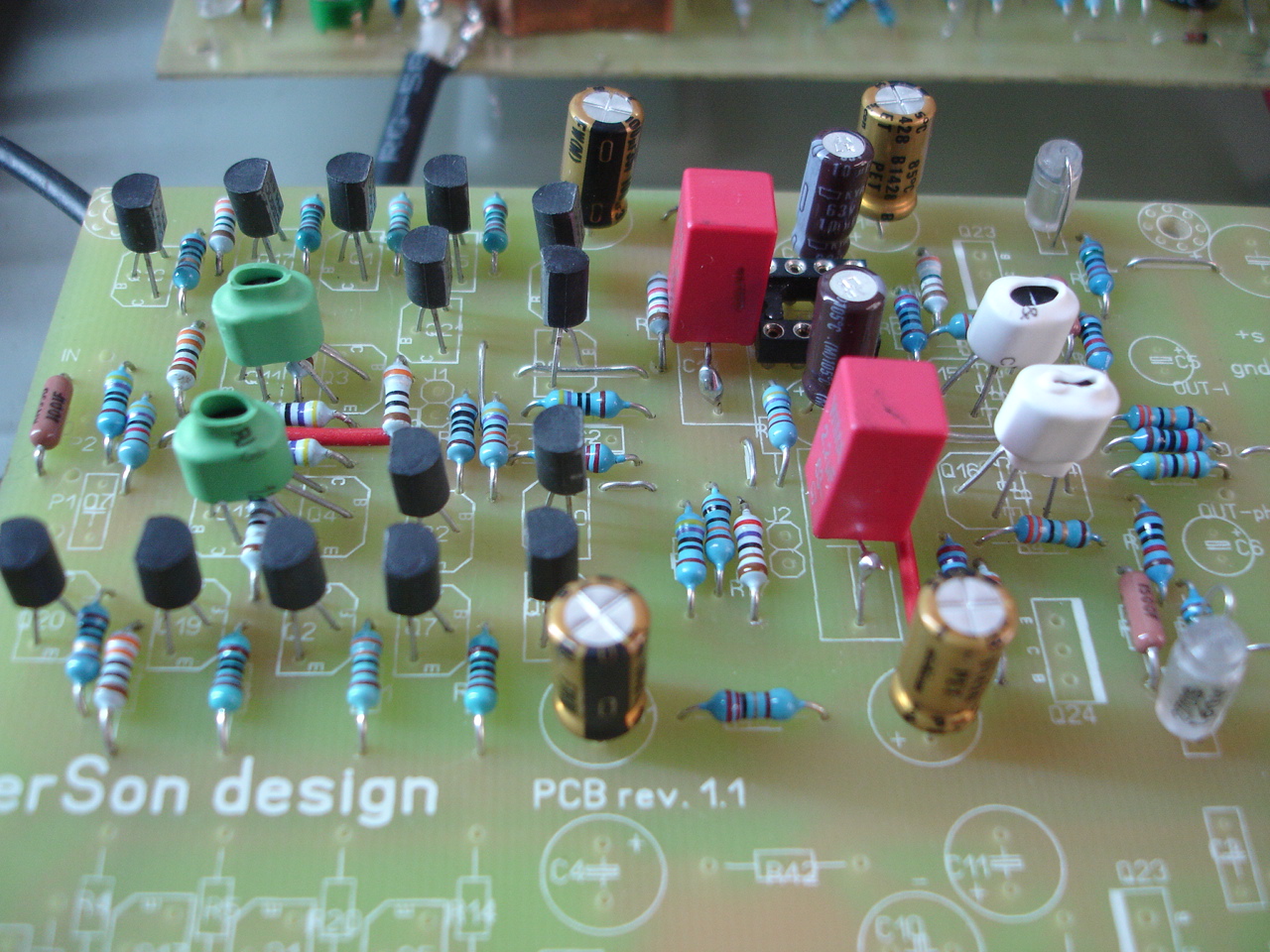

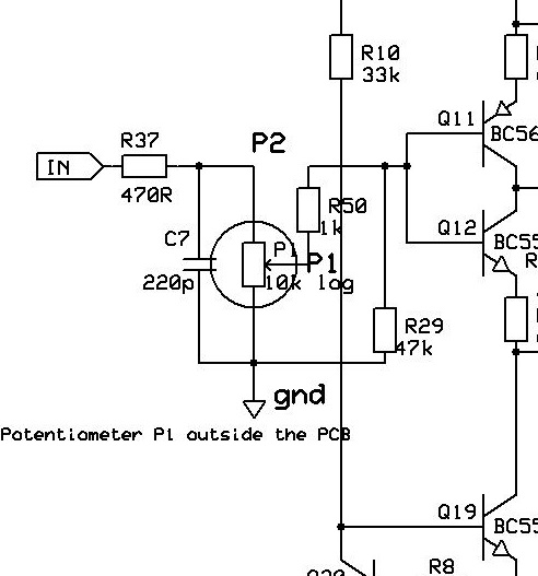

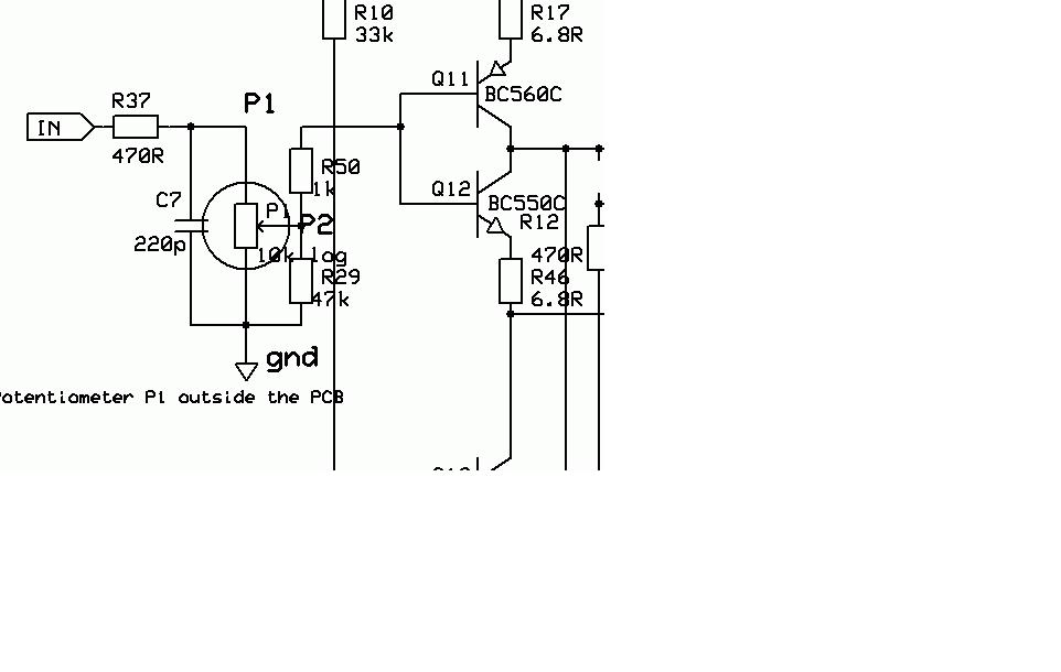

look this .
First image is pcb arrangement when second is what schematic show.
What is wrong?

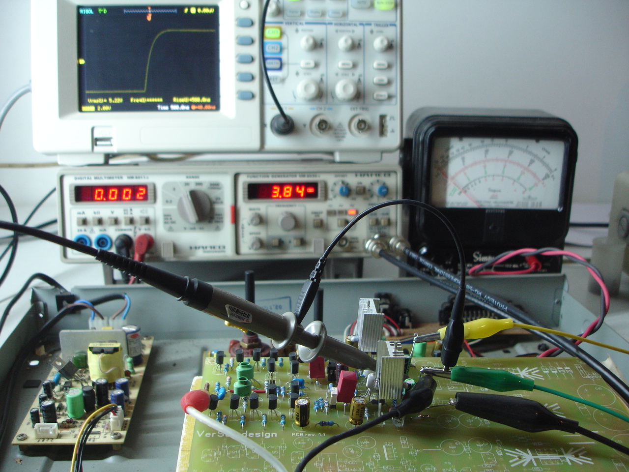

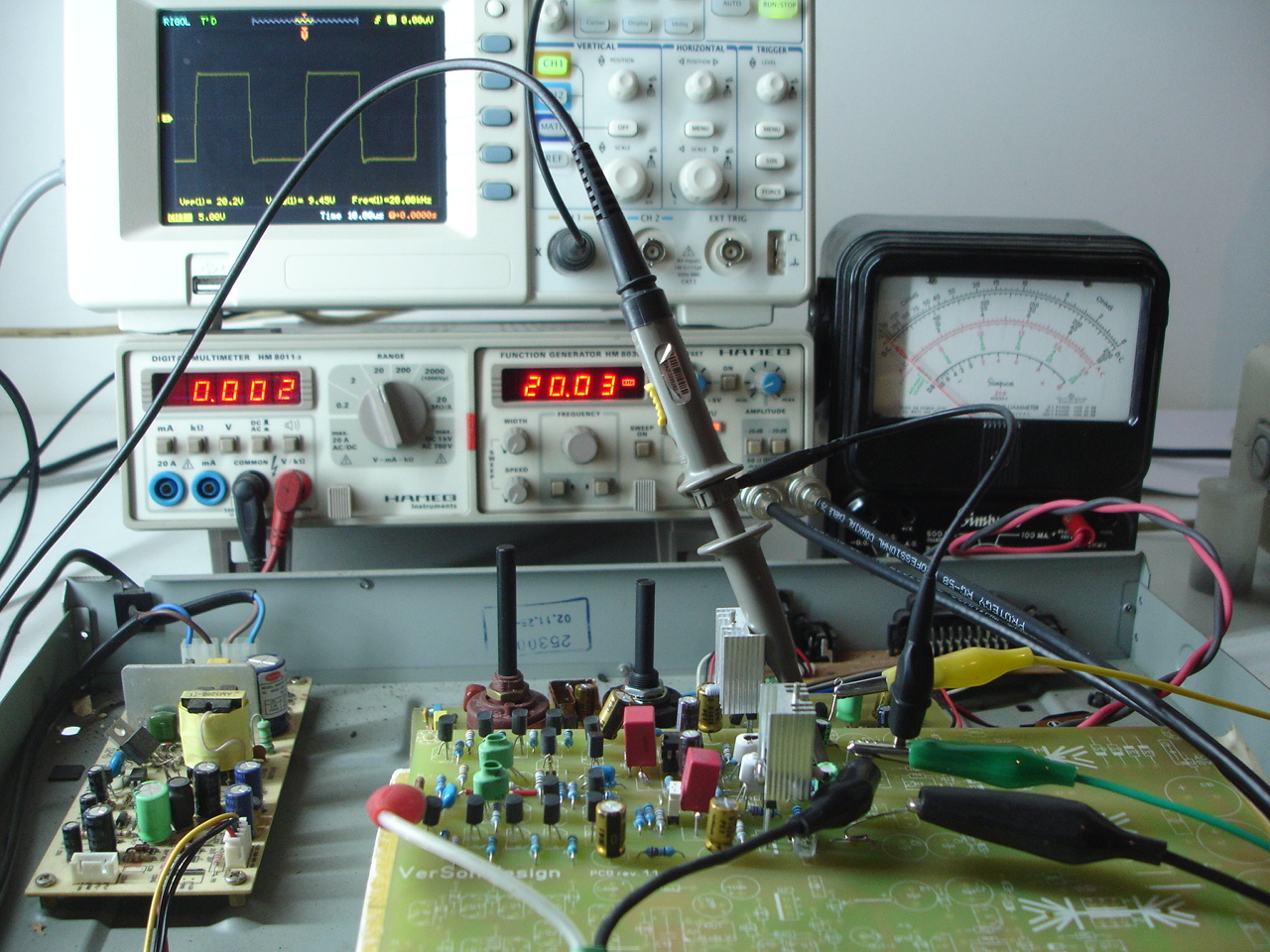

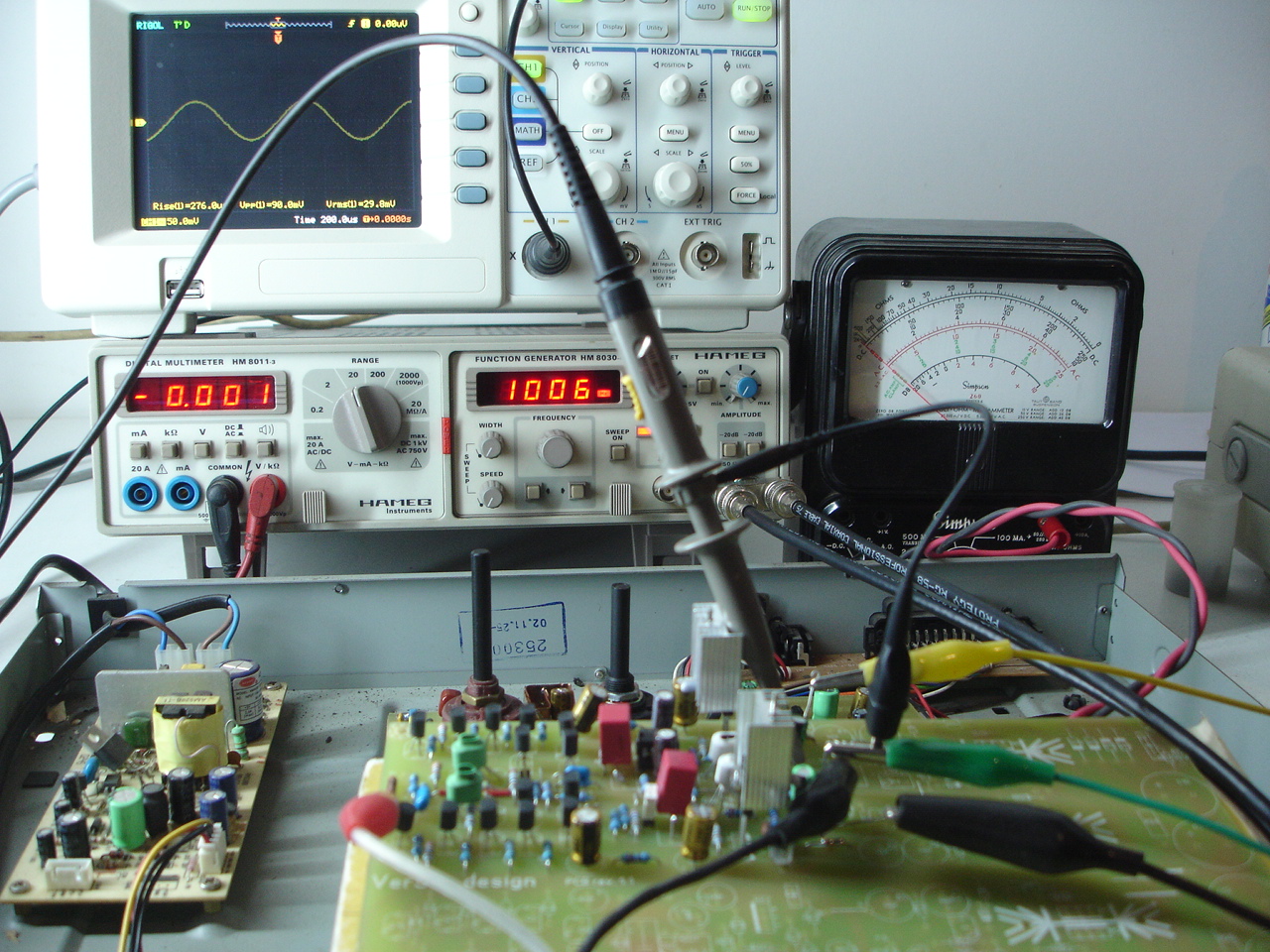

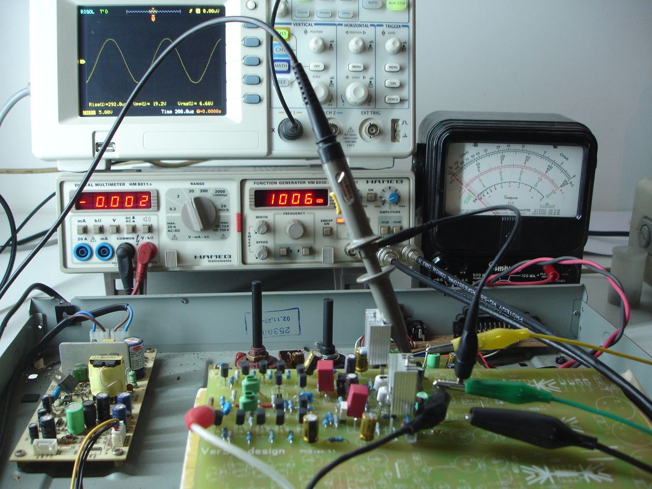

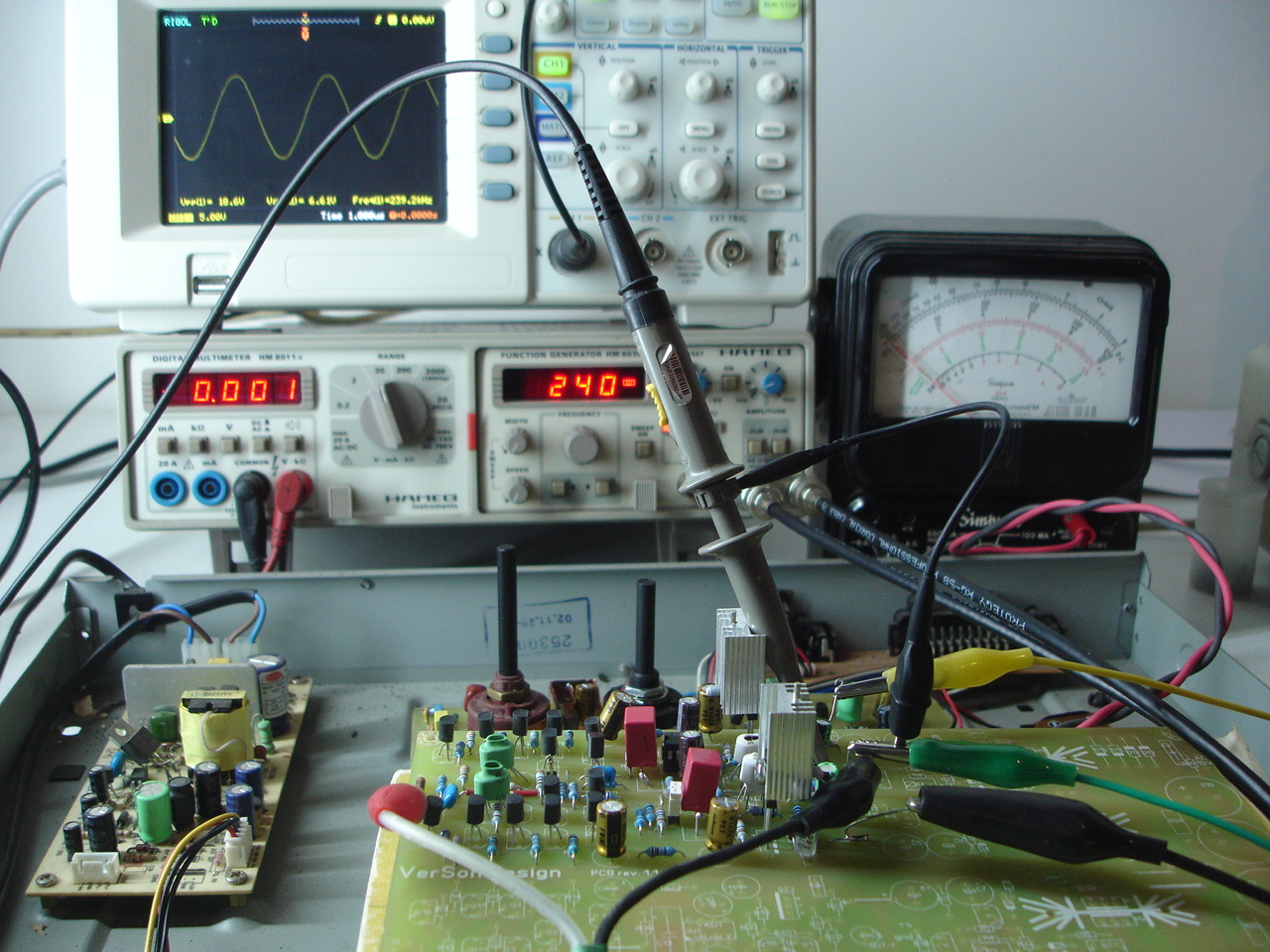

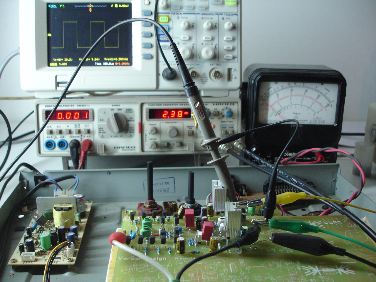

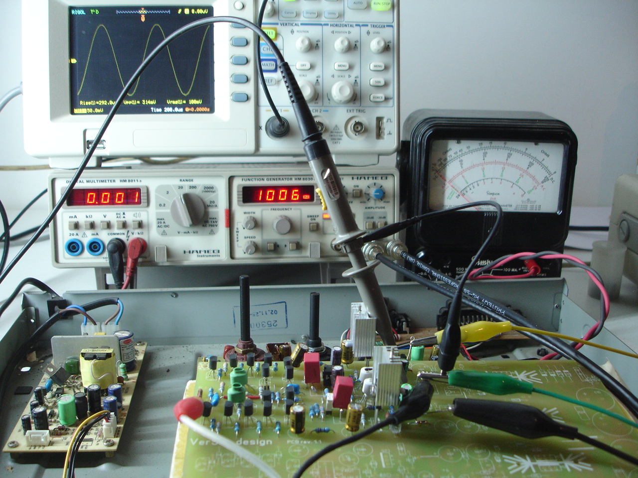

It is alive!
First test.
+/-15v
offset without servo=12mV
offset servo used=3mv
1v RMS inp 19.6vpp out ,6,68vRMS
-3db 700kHz
Rise time 590ns

No irf830 can not be used. It's depletion.. For the diode, there are lots of possible replacements, but the one used is very much a standard part and very easy to source.
Don't see any issues with a other pot. Just change ten input impedance to match. However in my expirence higher impedance also results in higher noise.
