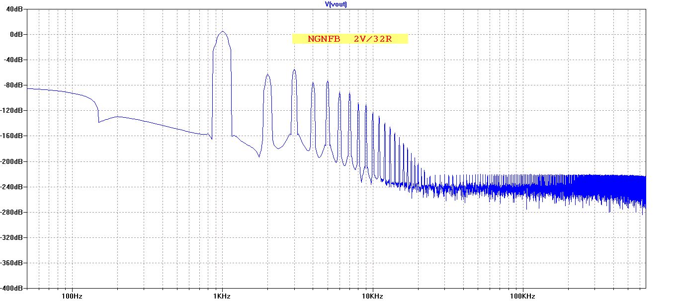

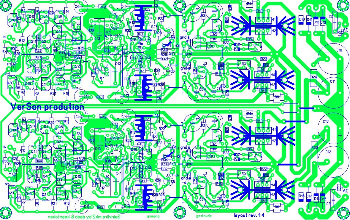

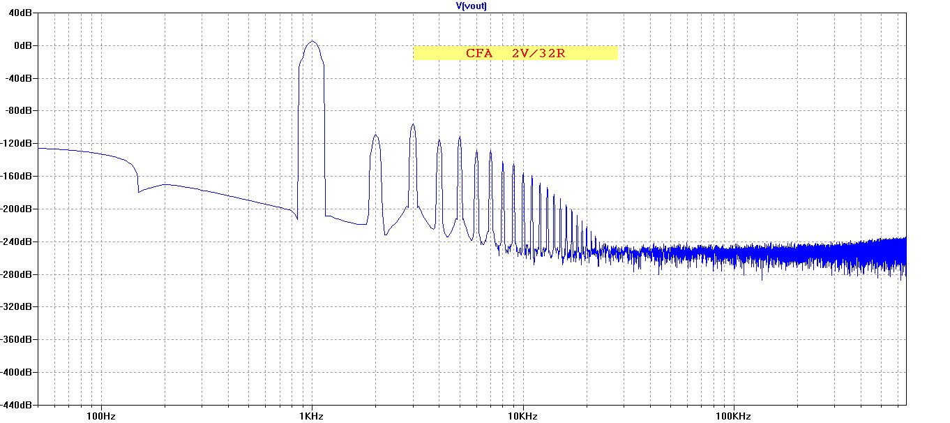

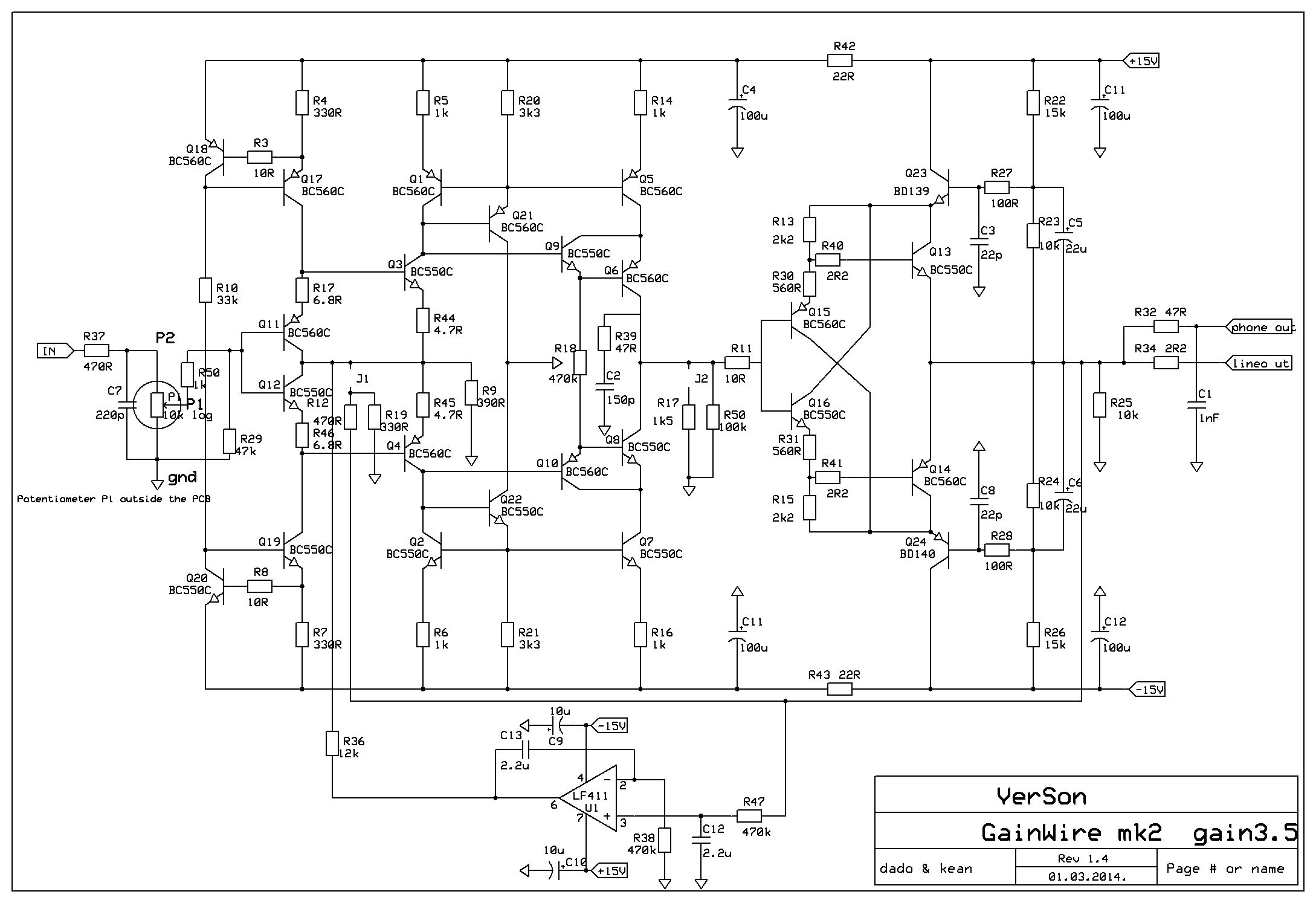

This version is better suited to drive low impedance headphones as 32 ohm Grado.
The bias for OPS is doubled from 30 mA to 60 mA and now BD139/140 transistors need a small heatsinks. The compensation is a bit changed, R39 from 22R to 47R and C2 from 220pF to 150pF. The phone output resistor decreased to 2R2 for better damping factor.
Attached FFT for 32 ohm load, distortion is much lower for 300 ohm or higher impedance phones.
Damir
Damir
Is phone out and line out swap in your schematic?
What is C1= 1nF for?
I also saw R7, R8 reduce from 150 to 100 and C3, C8 from 220p -> 22p, R11 from 470 to 10 whichs you didn't mention? I just want to make sure.
With new bias = 60mA, can BC550C and BC560C in ouput buffer withstand the heat?
Good observation, phone and lineout are swapped, my mistake.
C1 is there to lower the long line cable capacitance influence and together with other compensation changes (R39, C2, R27, C3, R28, C8, R11) gives better stability for increased bias current.
New bias current heats mostly BD139/140 cascode transistors, not much the BC transistors.

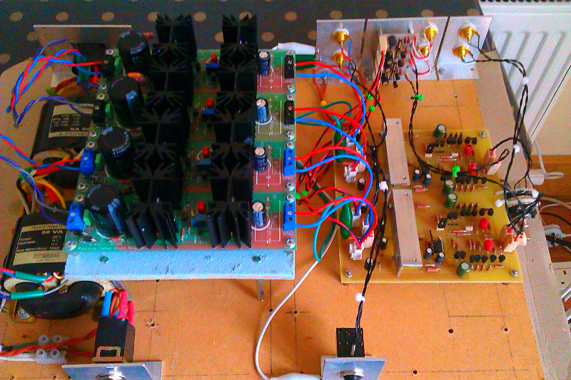

Here is some more observations:
I changed power supply to Salas shunt and that brought some sound improvement: better details and greatly improved sound stage and smother top end. It seems my previous PSU was not the best choice for GW. I still have one more regulator to try.
I was intrigued with my results with valve buffer and I decided to try j-fet one. I have built a small version of DCB1 and I can now confirm my previous observations: improved dynamics and fantastic bass. Anyone else tried a buffer at the input of GW?
Finally, many thanks for showing the improved version of the schematic. I will try this mod as well. At this point I have a question: is there an easy way to measure the bias current for BD139/140?
Frd
PS. Sorry for late reply - I do not have free time lately 🙂
