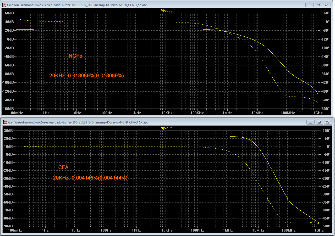

It seems most of the happy builder of this fine preamp prefer CFA mode. I wonder why (while I'm not surprised, as Wally already knows ;-)
When I started with this preamp design, the idea was non NFB as a current conveyor is good choice to start with. Latter it came a CFA as good alternative.
This said, i would be really interested to understand why this difference i noticed so often.
I made a lot of comparisons in my life between VFA and CFA with the same global designs. Always preferred CFAs during listening sessions.
But I never did this with non NFB.
On an intellectual point of view, this result is surprising (at least for the objectivist troop here). With so low distortion numbers, in both modes, I believe nothing is to be found in this direction. As with no GFB, no TIM to fear, and no stability issue, nothing there too. And nothing in correlation with speaker's drive, here. So, what ?
The difference is clearly to be found in the "Expansive VS Compressive" dynamic behavior.

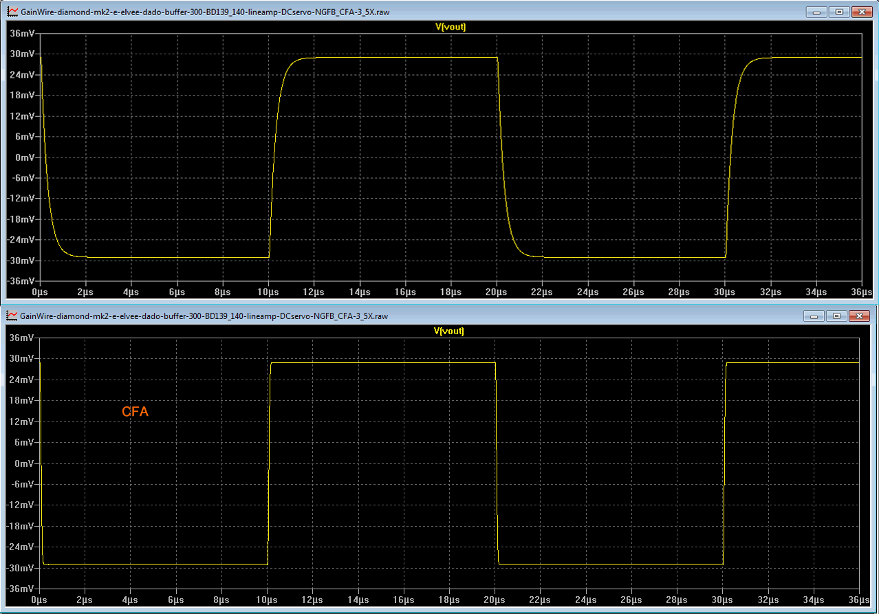

Ok, this is what i got with little signals, gain 10:

No way to get clean little signal fast square waves in CFA.

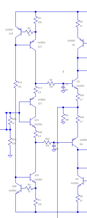

I believe your input stage have to be dumped (as expected). I have added base stoppers to the second stage. (100 Ohms )
Still a point to fix: the catastrophic clipping behavior.
Sorry to say this Esperado, but you are doing something wrong here.
In the gain versions of 7x and 3.5x I showed, the square waves are very clean with no overshoot and no need for base stoppers (as expected). You can find all this simulations in this thread.

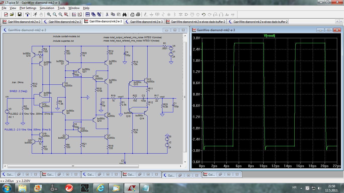

On the subject of square waves, there were one of your sims:
diyAudio
Notice that your track was not the same than mine: you worked with a NGFB , while i am optimizing-it in its CFA mode witch is faster and more prone to overshoots.

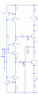

I used "Diamonds" or "Super pairs" long before names were put on those assemblies. And designed several industrial products with them since 1970. I always found-them "nervous". Here again. And, as those base stoppers killed the problem, with no major impact on the distortion, what the hell ? I supposed you will be happy to look at this as a contribution. Notice I did exactly the same thing than here:
www.esperado.fr - VSSA with Diamond input and DC servo
And that this offer several advantages. Clean square waves, extended bandwidth, isolation of the input low pass filter from influence of impedance of the source, as in my sim where your input pass filter was removed. In the VSSA Diamond, the positive influence of this filter was obvious in listening. And I expect the same here.

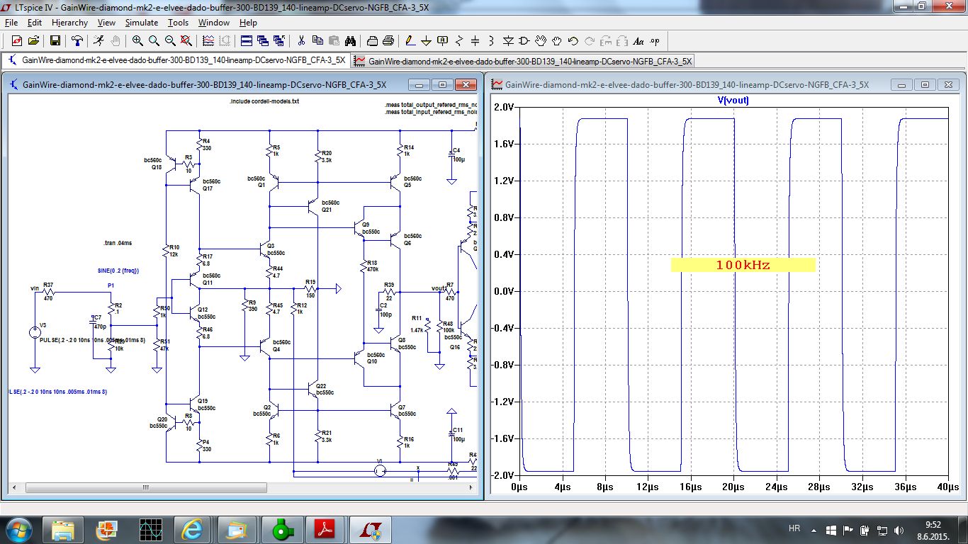

Here is square wave simulation with input filter removed, no nervousness here. I think that you are a bit nervous about it not the circuit. I used similar input configuration in my CFA VMOSFET power amp with no problem, stable as a rock. Some overshoots on the square wave simulation is nothing so bad to worry about it.
I know about your suggestion where to put LP filter, it has a advantage to be not sensitive to the source impedance, but has disadvantage as it requires two precise resistor and two precise capacitors.
By the way in your attached IPS schematic there is missing connection between Q11, Q12 collector and the feedback input.
