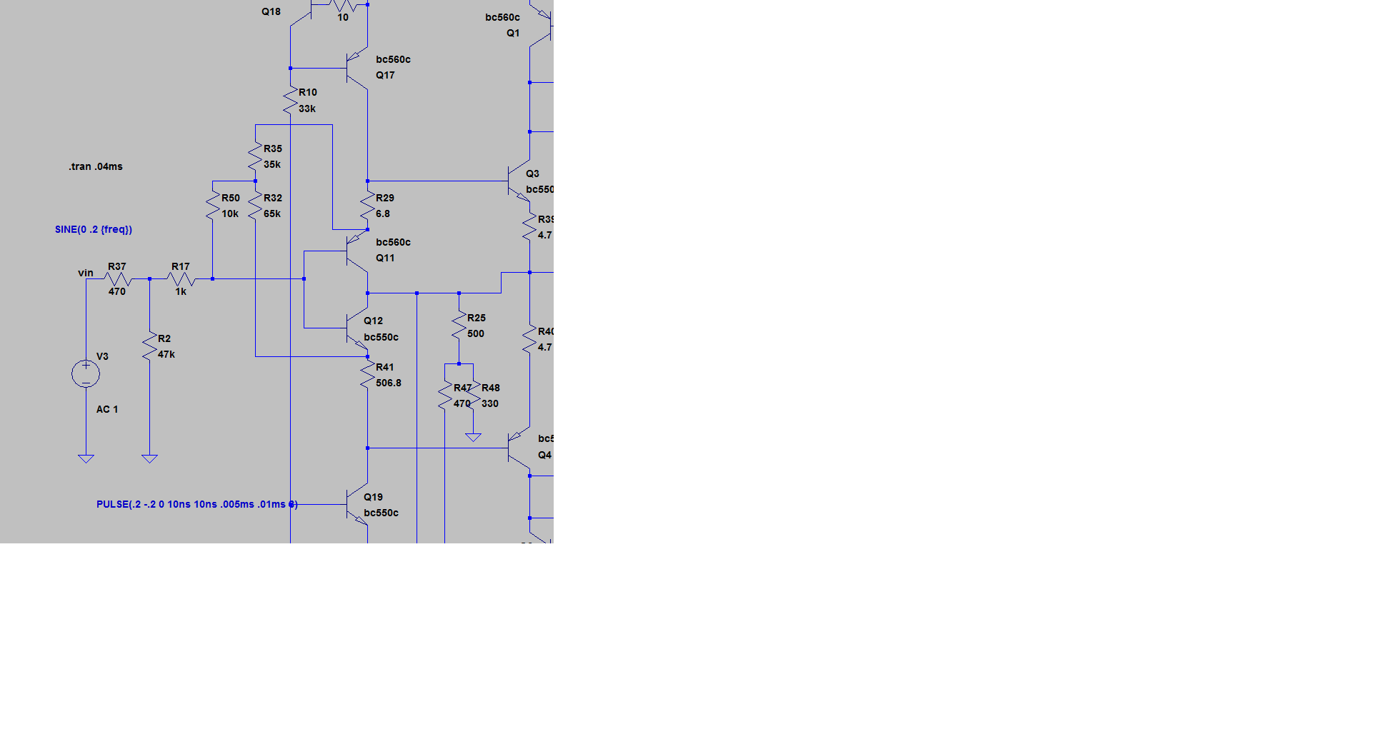

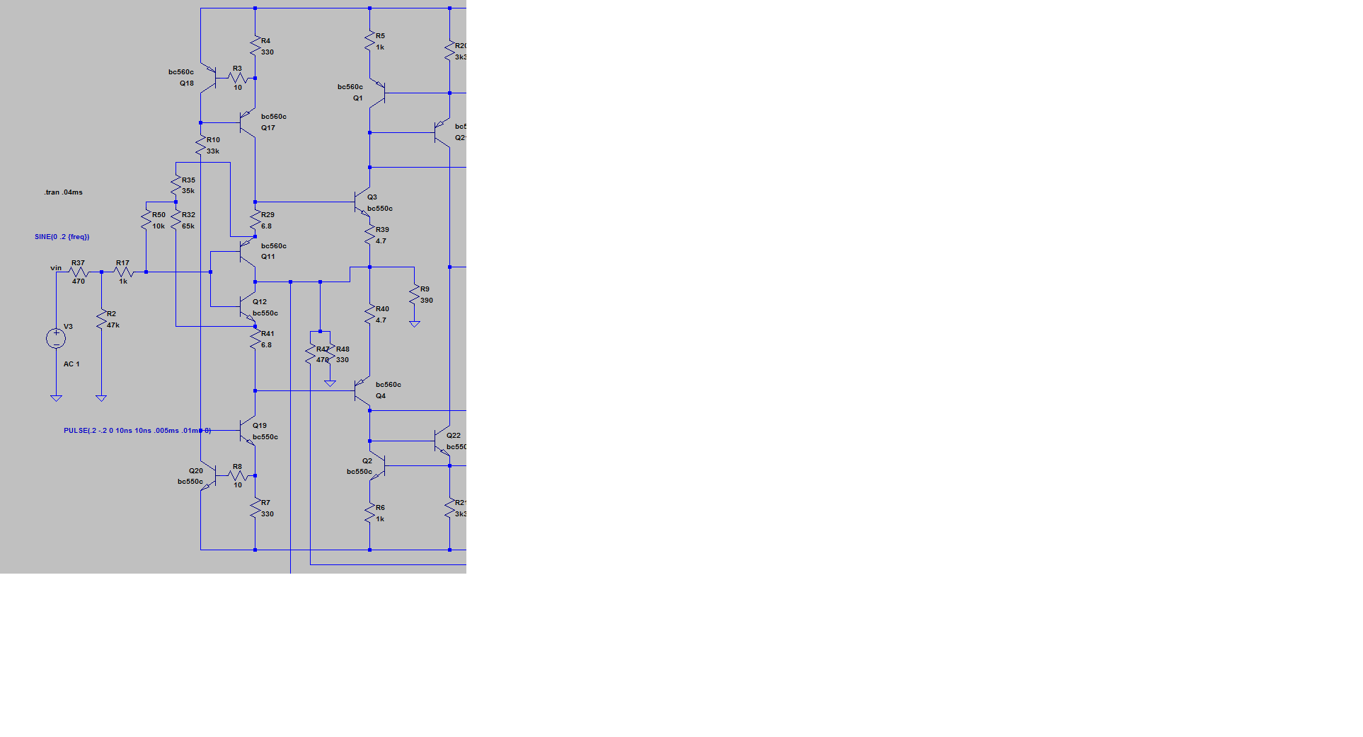

Now working on input offset....
If I do correctly understand, input offset voltage is originated by beta mismatch between the two input devices.
One way to correct this would be to place a resistor between emitter and base of the bjt that has higher beta.
I placed a trimmer (100k) between the two emitters and bases according to the sim.
As the simulator does not help I modified one emitter resistor (R41) just to produce input offset and playing with the trimmer (R32 - R35) I am able to eliminate input offset.
Please see the sim and let me know if it should work in reality....
No, not by the beta (hfe) but Vbe mismatch between NPN/PNP pair at the input. Don't play with R41(in your schematic you set it to506.8) or adding R32,R35 and R50, it is not good way to correct input DC offset. If you must try with CCS, R4 or R7, but that could upset output DC offset. Best if you can find Vbe matched transistors pairs, Q11/Q12, Q3/Q4.
Something is very wrong with your schematic, what is R25 doing there in the feedback part?
maybe you did not understand my idea.
R25 was an experiment.... it does not exist in the real build
Also I did not play with R41 (I just modded it in the sim to be able to produce input offset)
The only important things are the 10k R50 and the 100k trimmer.

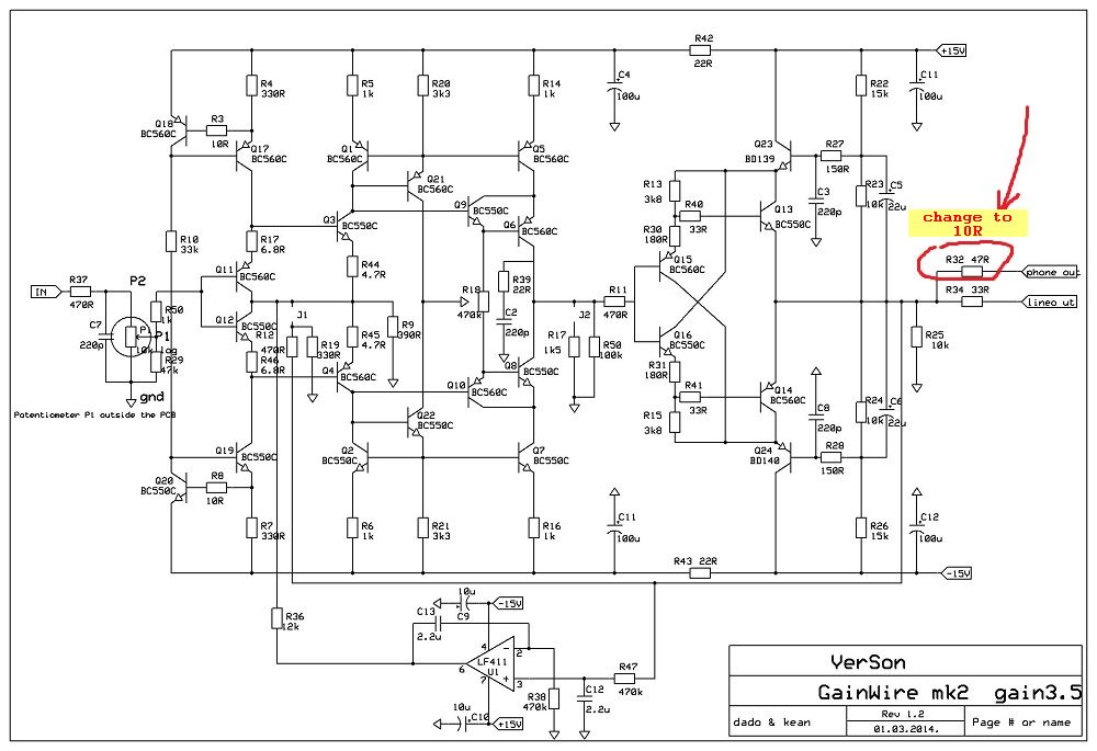

For some low impedance headphones the quite high output impedance could result in not the best bas.
R32 could be change from 47R to 10R and this will result in better dumping factor and better bas for that kind of headphones. Result is some increase in distortion (only for low impedance headphones).

If you look carefully this preamplifier does not use diamond but a supper pairs (or as some call it Baxandall pair) and what is important here is to use transistors with low saturation voltage to allow first transistor in the supper pair to work with Vce as low as second transistor Vbe. This prevent use of the emitter resistors of higher values.
This configuration is working in Class A and all transistors are turned on all the time.
Regarding adjustable resistor aging it is possible after trimming to measure the needed values and use fixed resistor, but again I think it is not needed to do that trimming, this preamp sounds exceptional without it.
