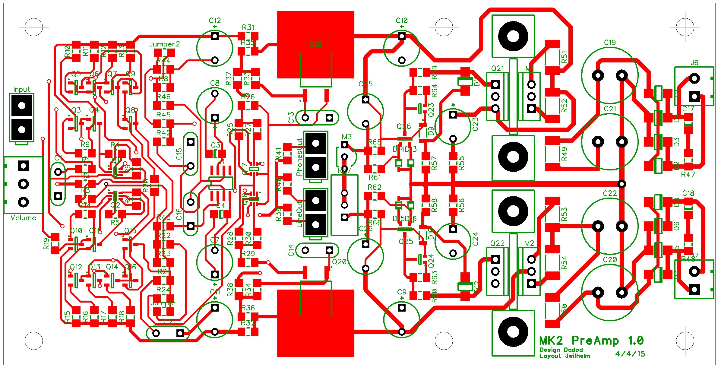

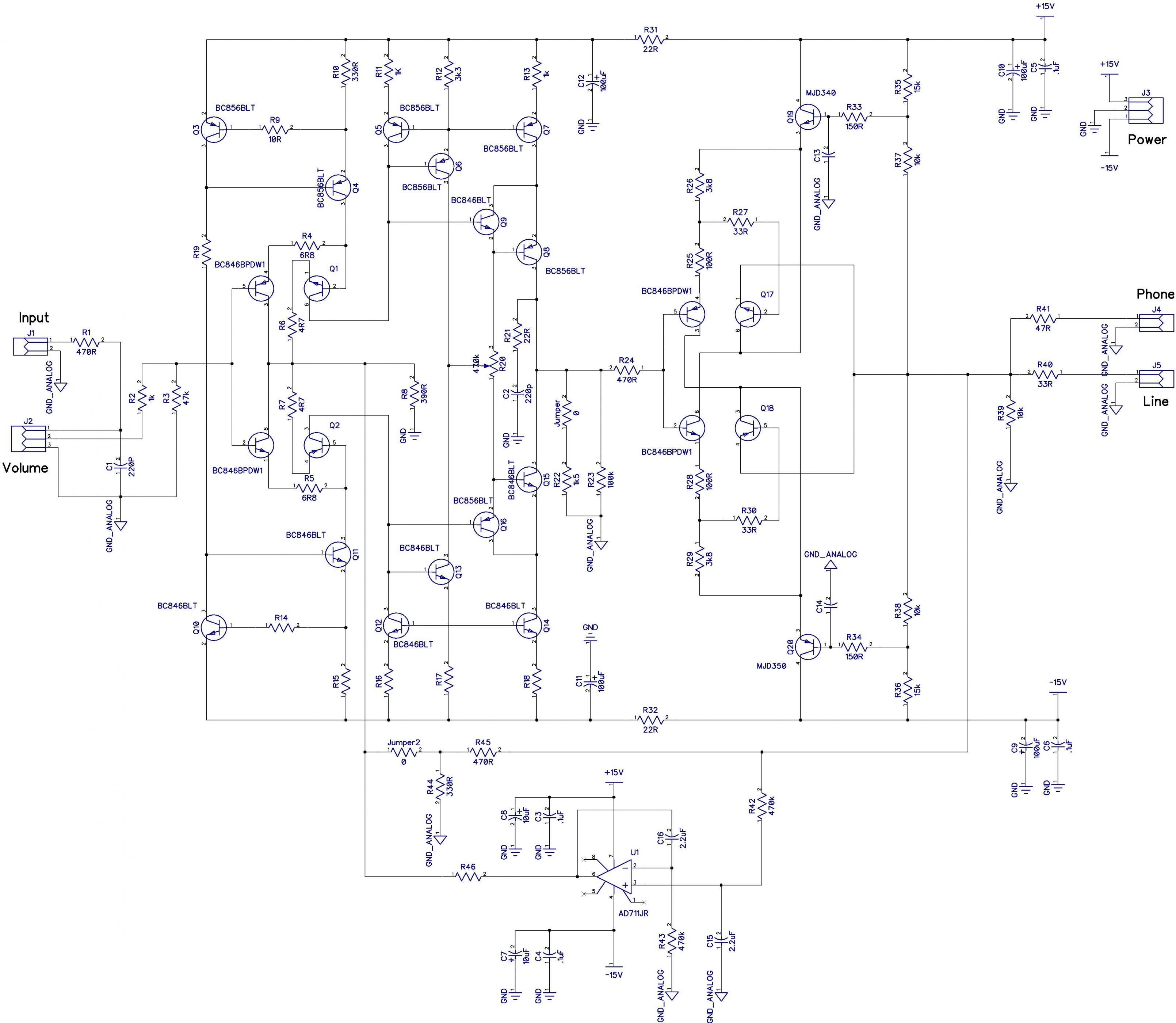

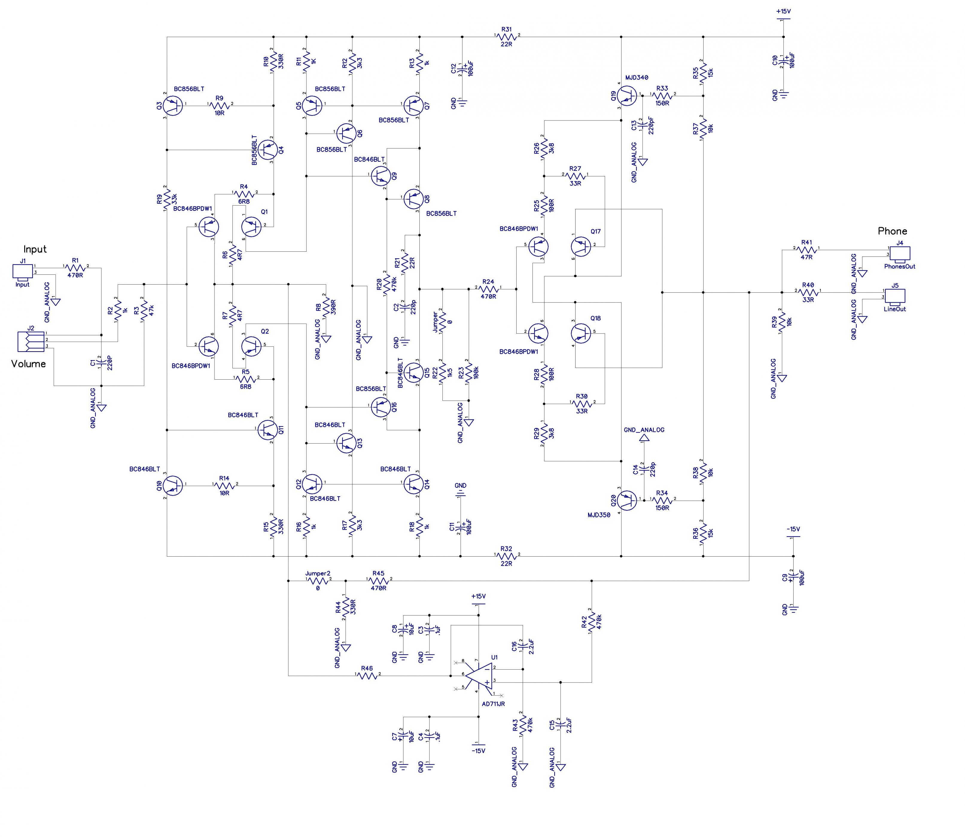

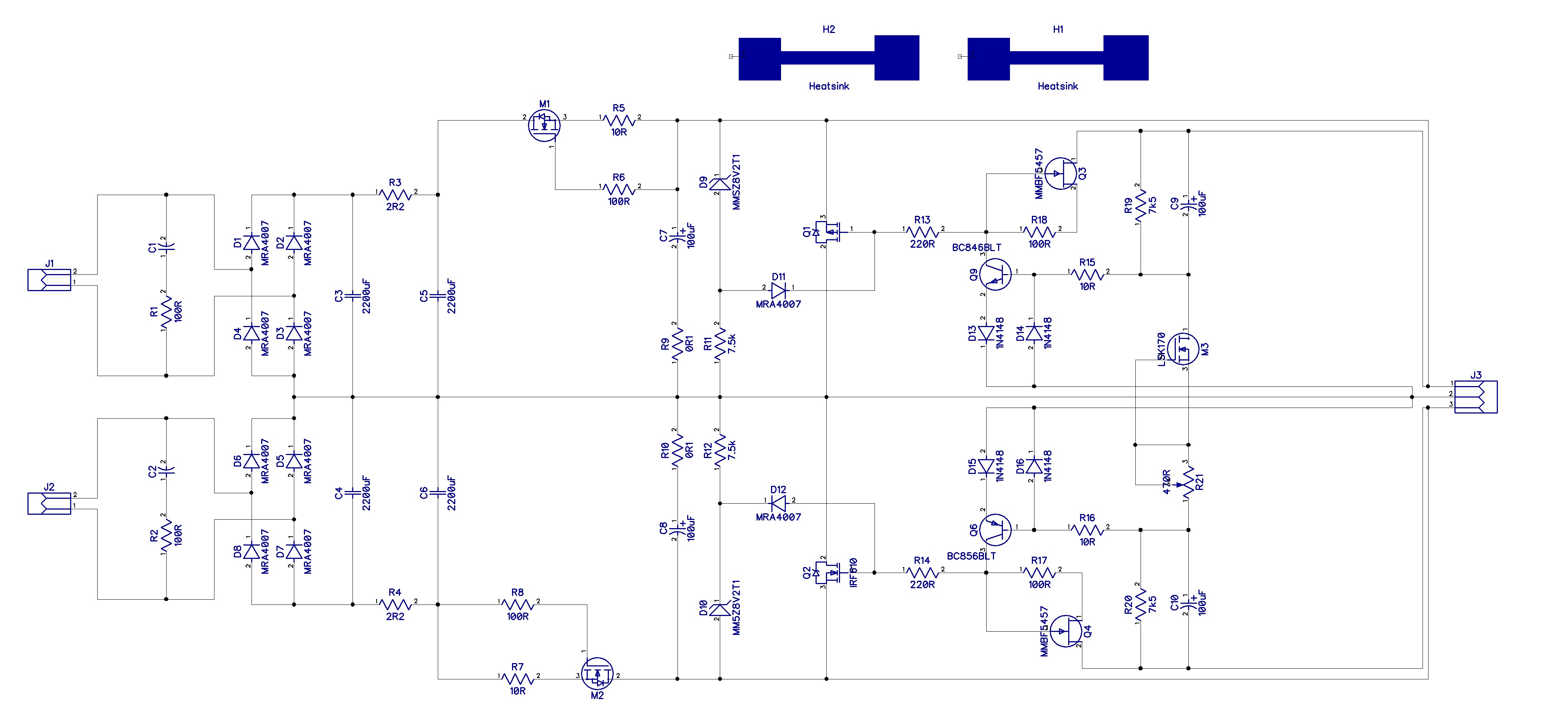

Here's what I've come up with so far.

I've found one error on your schematic, Q6, Q13 collectors(your schematic) should be connected to the ground, and there is no trimer pot.

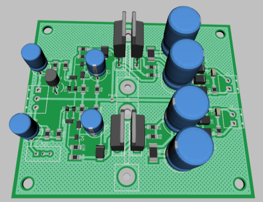

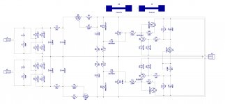

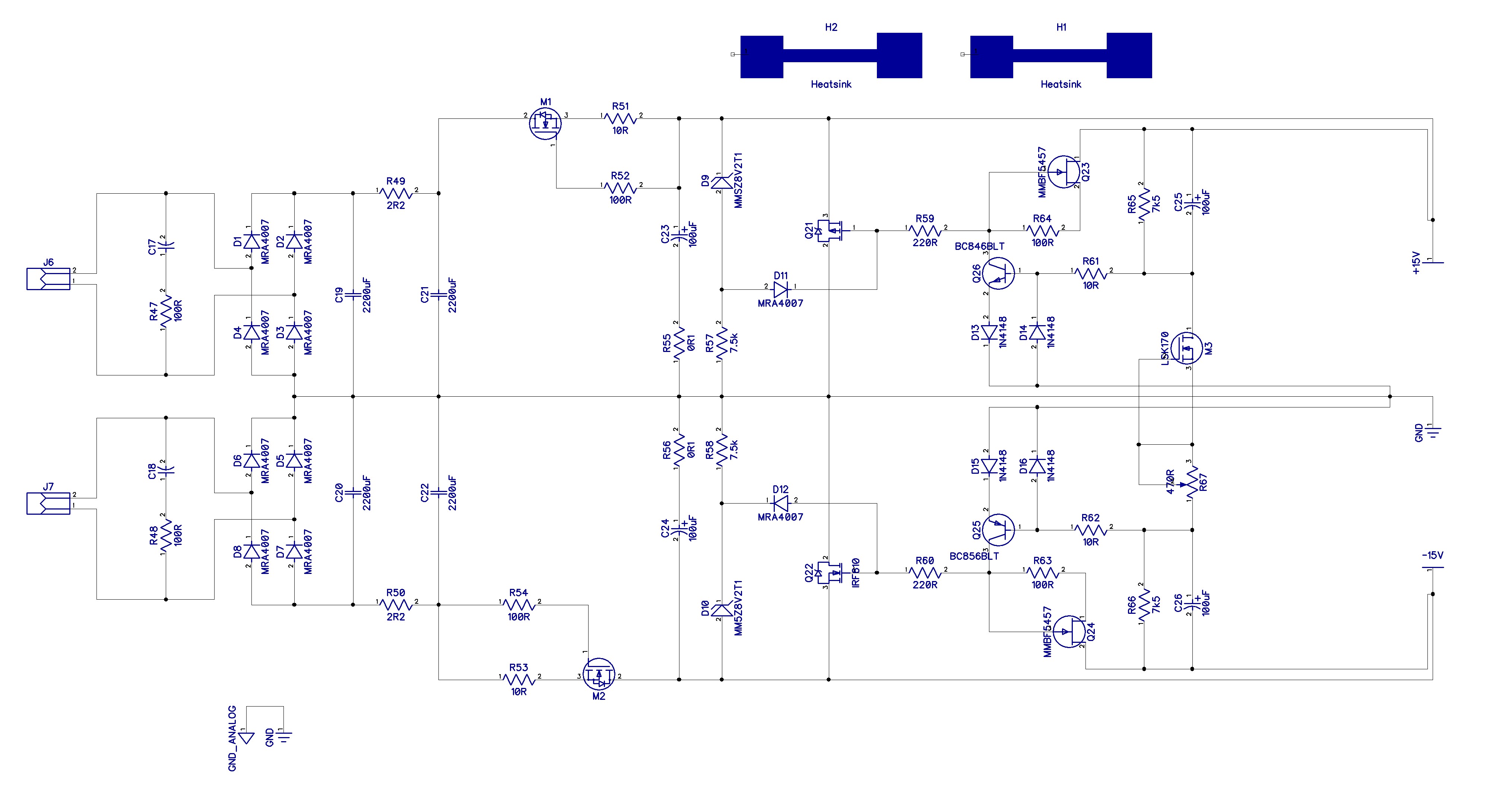

If you want separate boards for preamp and shunt regulator in this case connection between them should have five pins terminal. Outputs from the regulator are +-15V, +-sensor, and the ground. The +-15V and +-sensor should be connected on the preamp board not on the power board.
You need +-80 mA from the power board, so calculate the SOA accordingly.
Damir

Thanks for checking my schematic. I thought R18 in your schematic was a pot. I've also got R8 connected to the wrong ground.
I will likely attach the shunt regulator to the preamp board. I just like to design in modules and join them later. Where would the best place be to take the +- sense from?

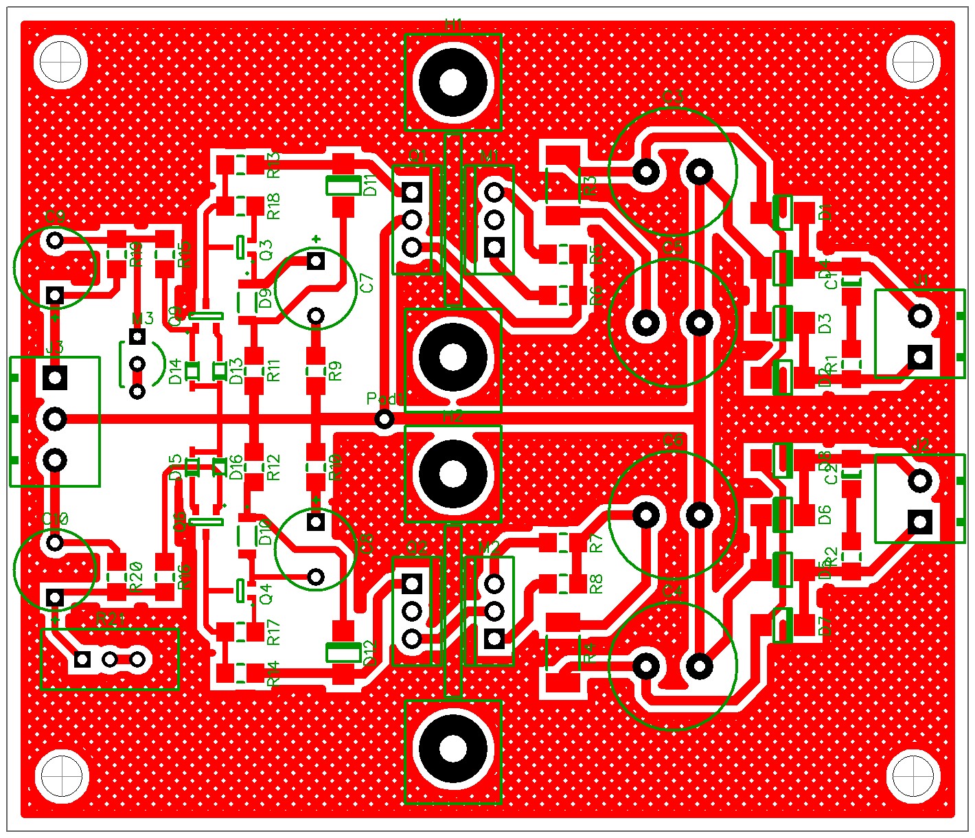

Make that connection on the preamp board or close where +-15V is entering the preamp board.
If you look mine layout than you can see that I have connected that on the shunt regulator side (but it is close to the preamp part). First I made the layout with provision of separated shunt regulator, but later decided to make all on the one board. Separated shunt regulator could be quite distanced from the preamp board and in this case is important to connect power and sense together on the preamp board.

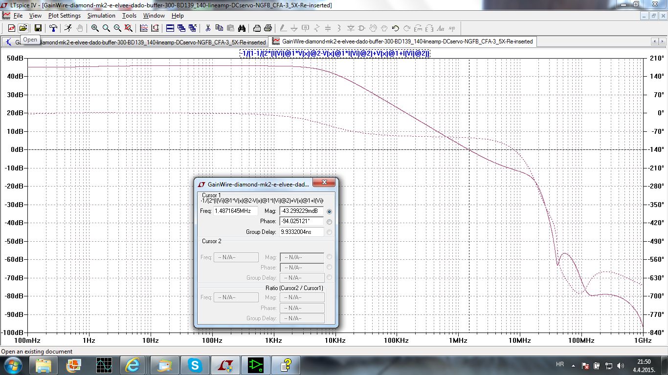

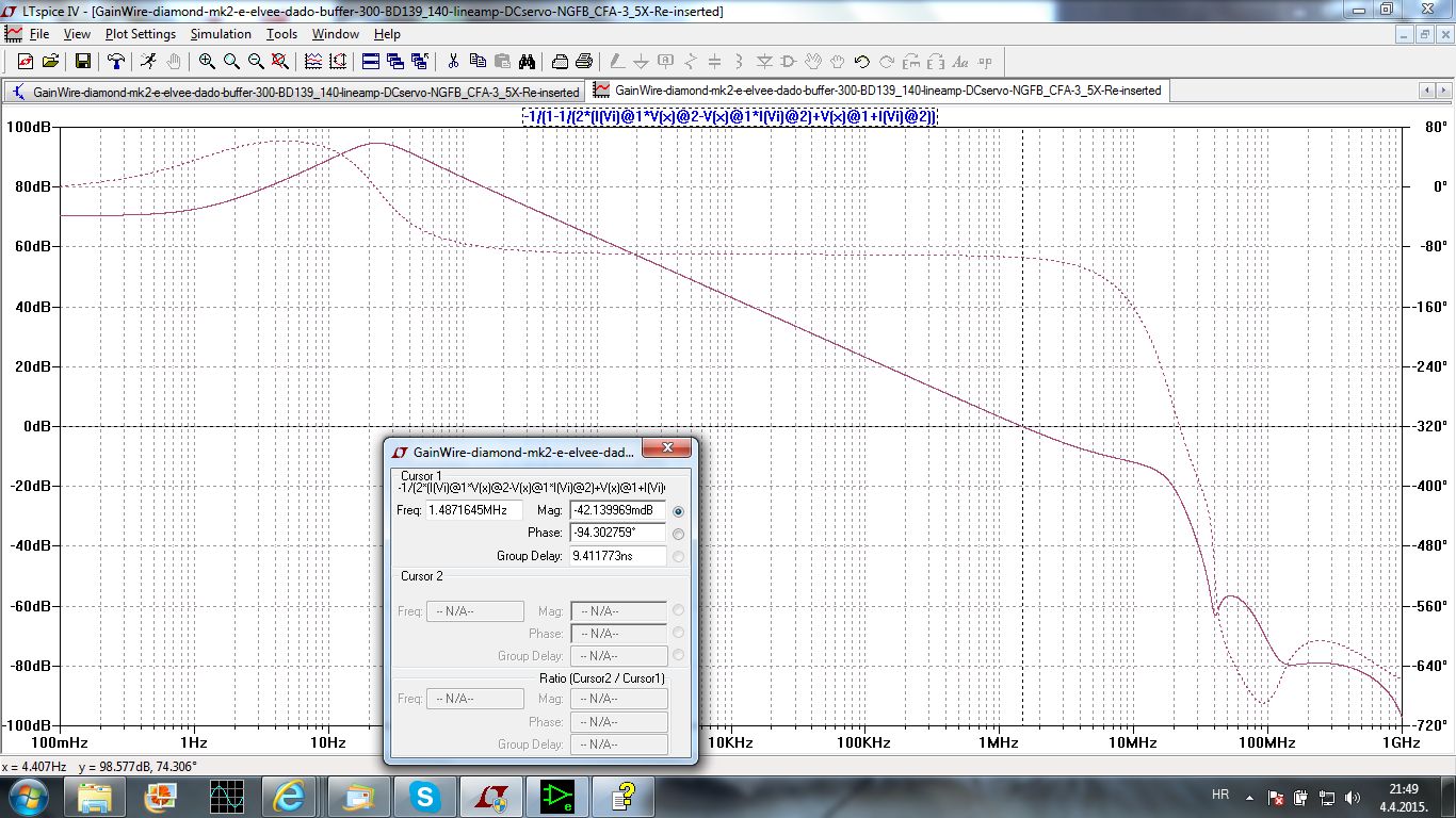

wht was the reason for R50 = 100k ??
I suppose that R50 is from my schematic, current conveyor shunt load.
I think that I explained that somewhere in this thread. Attached are two Loop Gains, with R50 and without, and I think that those pictures talk by itself.
