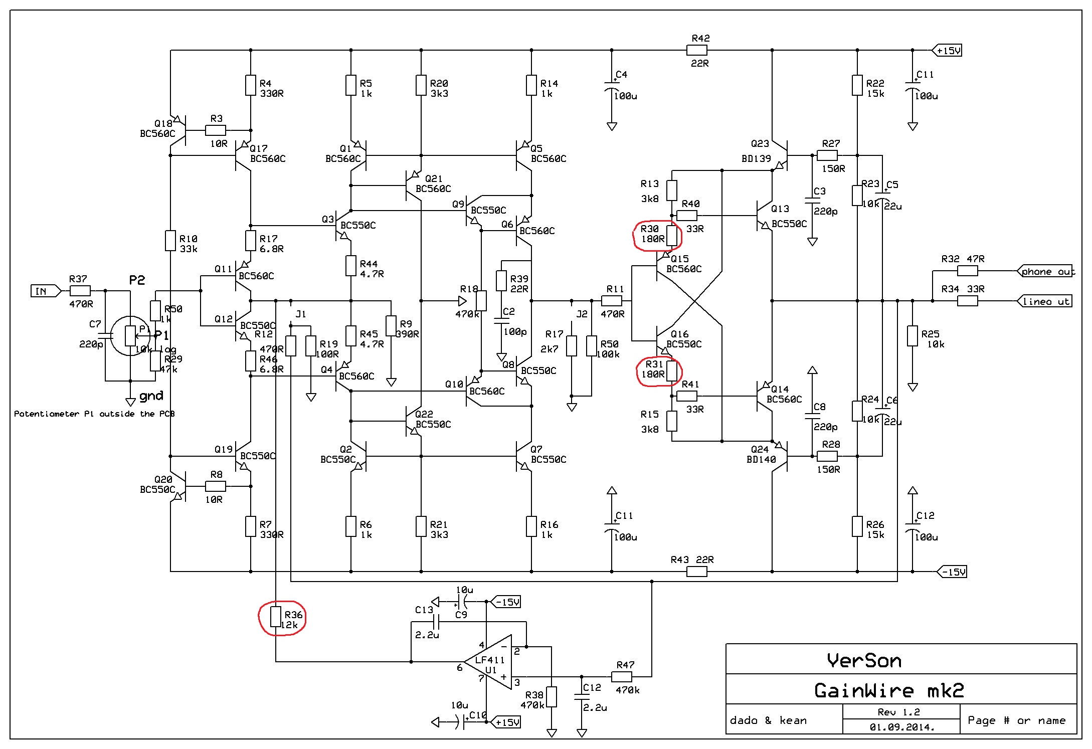

The longer I listen to it the better it becomes..... Now I must really convert it to 3.5dB by reducing R17 to 1k5 but I have a doubt... should I also increase C2 to 220p ?
Why do we need to increase capacitance if having less gain ?
Don't forget to change R19 from 100R to 330R too. C2 was increased to 220pF in 3.5x (11dB) to get better Phase margin in CFA mode, but you can try with 100pF, phase margin is still good at 68 degree. It does not influence non GNFB mode to much.

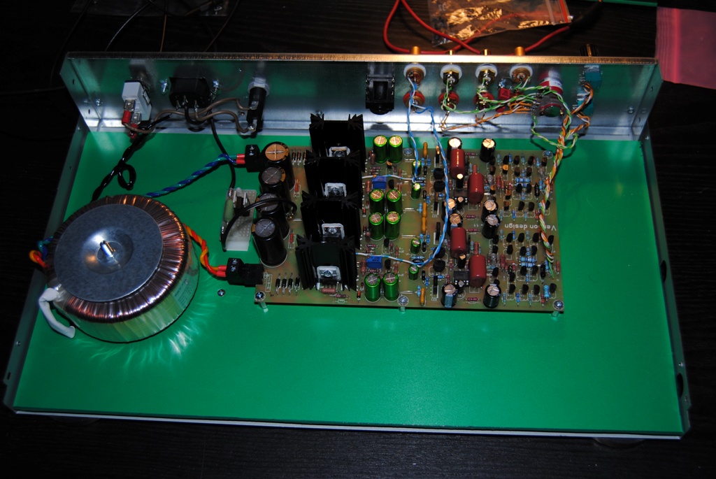

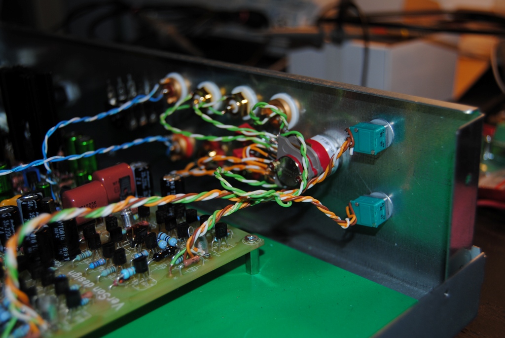

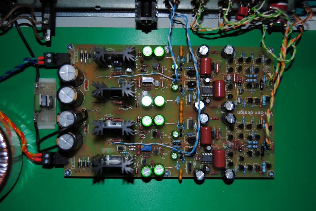

I'll see what I can come up with and post some pictures then.
That will be very nice.
Here we are.
During my latest listening session with a ZYX bloom cart and a Nagra pyramid poweramp, I noticed some sibilance.... probably due to cart misalignment.... this preamp is ruthless.
But the soundstage was huge and the transients really fast.... will need to replace the rectifying diodes and the volume pots.
No hum, no hiss... perfectly silent in operation.
Here we are.

What would the collector current be on Q13?
About 29 mA, defined with R30 and R31 values.
