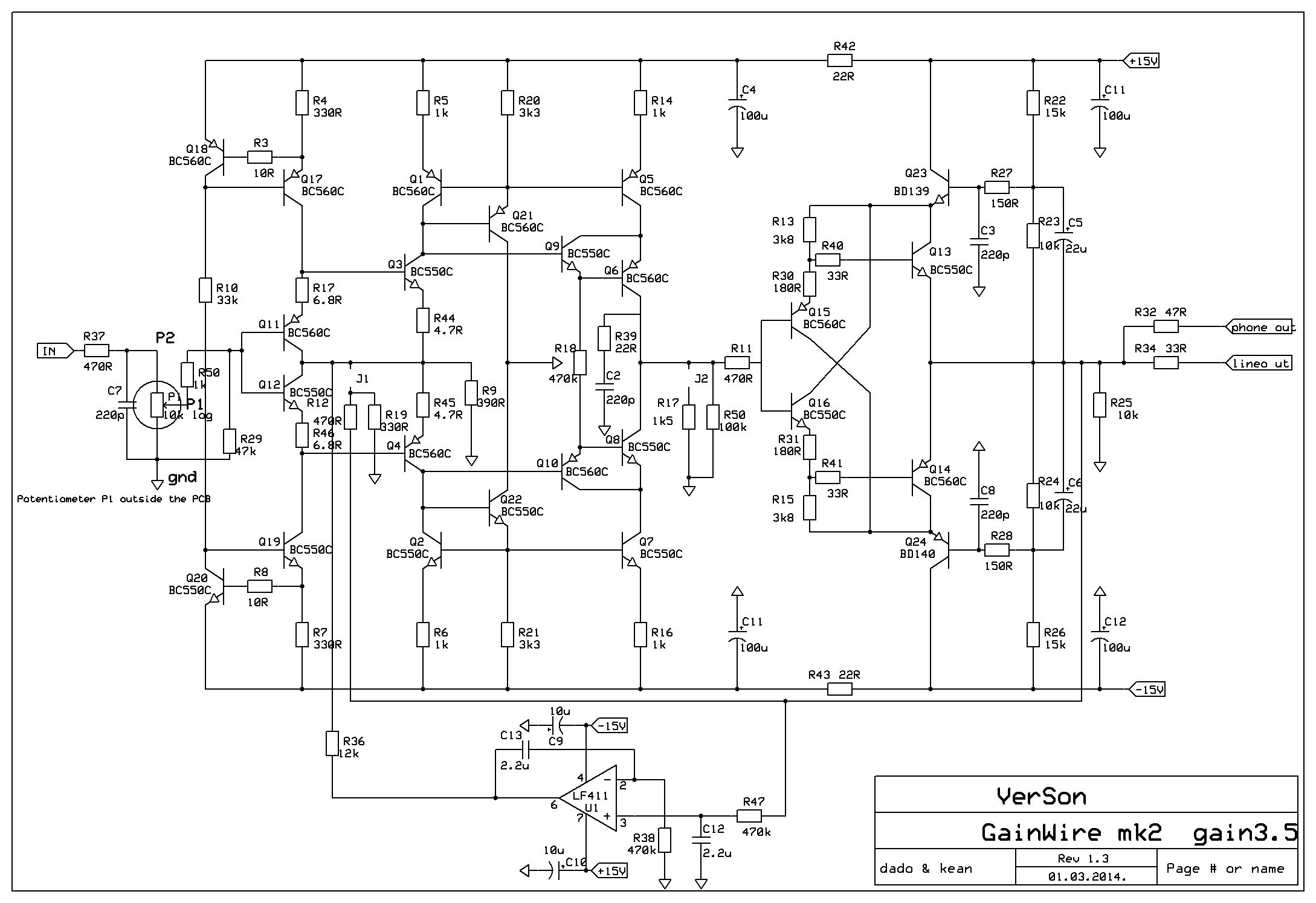

There is a difference between the schematic and the board layout in the input.
Resistor R29 (47k) is connected between gnd and Q11 Q12 bases.
So P1 from the pot only connects directly to R50 (1k) and not to R29.
it seems ok to me but am I right ?
I have static (DC) offset in the input.
I did not connect the 10k yet so I am measuring input offset at P1 (just before the 1k R50)
I read 11mV..... should I expect a reduction of this value when I connect the pot ?
IMO it is the Q11 Q12 base current flowing in the 47k to gnd, so paralleling the 10k pot should reduce the offset right ?

Yes you are correct. I changed that on the layout but forgot to do that on the schematic. This does not change anything functionally.
Attached is corrected schematic.
