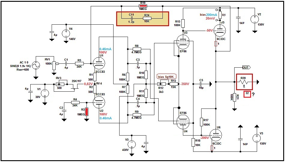

In our prticular case with Tims's OTL, if 32 ohms speakers (modified Quads 63) are in use, shall I rise the bias? How shall I find the best working point (class A)for the 6c33c ?

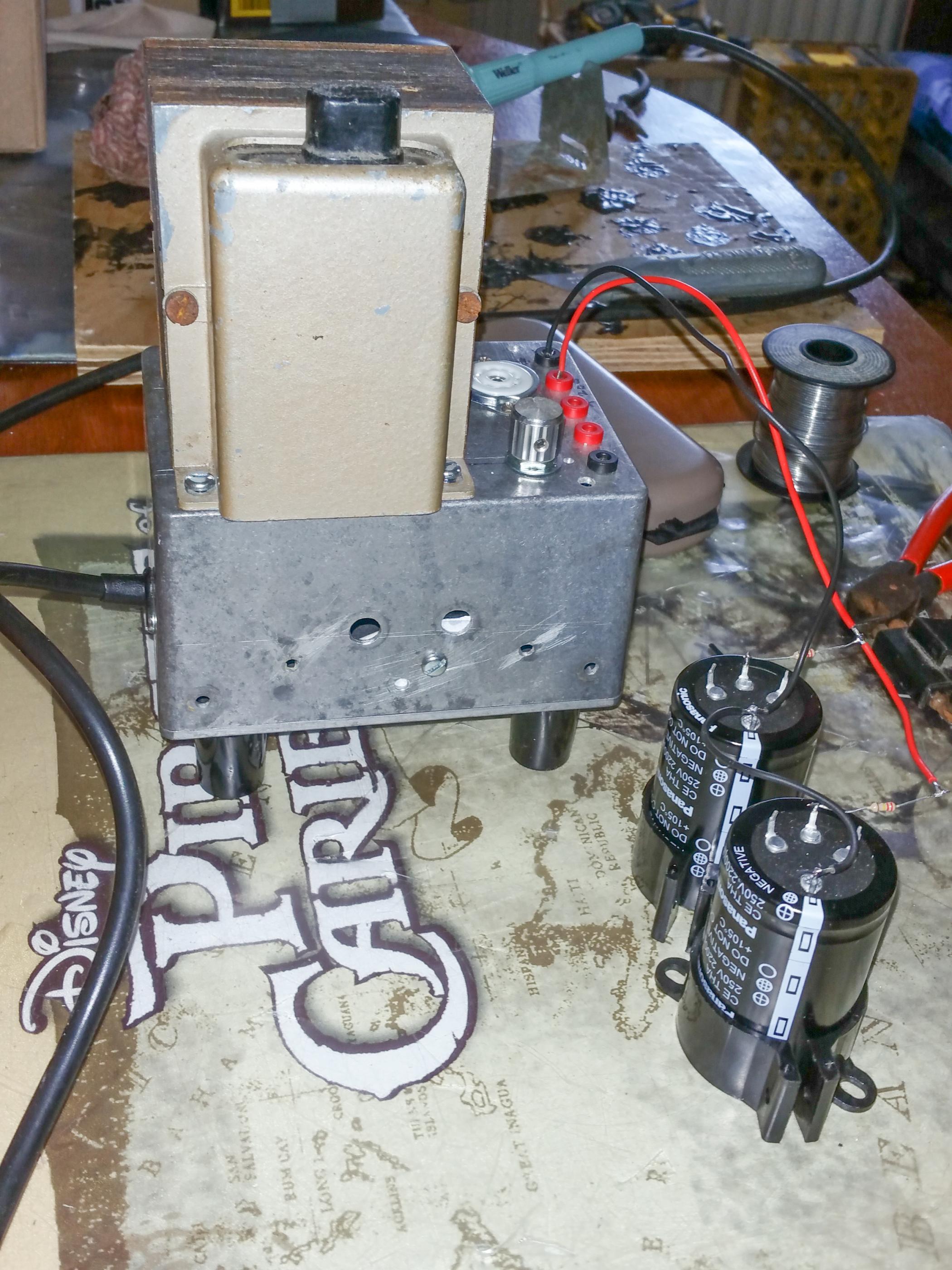

Last night I heard two sharp cracking sounds from my speakers which were being fed from my OTL. The music I was playing sounded normal enough but I decided to measure the DC offset; it had shot up to 350mV on both channels. I de-powered immediately and opened the cover.
Because the problem was on both channels, I suspected a power supply issue. Lo and behold, one of the main smoothing capacitors had burst, but luckily in a sort of gentle way. It's a 3400uF 250V Panasonic hi-grade item.
I remember dropping one of them accidentally from about 1.5 Metres onto a hard floor during assembly, so I think I may have damaged it internally then. Panasonic have now taken this particular capacitor off the market, so maybe there is something else to consider, but finding an alternative which fits into the existing space may be difficult.
I got some 2,200 µF, 250 Volt electrolytics from IT-Tronics in Germany for $5 each. They are 9 years old but fit nicely into the existing space inside the chassis. I'm making sure they are completely reformed before fitting them. I have a tube tester unit which I built a couple of months ago for my Svetlana NOS 6J32Ps which supplies 200 Volts. I'm feeding each cap through a 220 K resistor for about 24 hours. That should do the job.

I decieded to go further. As one of Tim's advices was, if possible, the balanced input, I'de like to use my Nagra PLL preamplifier which allready has balanced output.
What changes do you suggest at the first stage of the OTL (getting rid of the input caps...etc) ? How shall I manage the mfb connection (+/-)?
Apreciate anny ideea.....
That might be a bit of a trick with that tube. It tends to run really hot and has a tendency to eat its socket, so its often biased low as the reduced heat allows the socket to last a little longer.
However the 32 ohm load is going to help quite a lot with the heat, as more of the output power will be absorbed by the load rather than the output section.

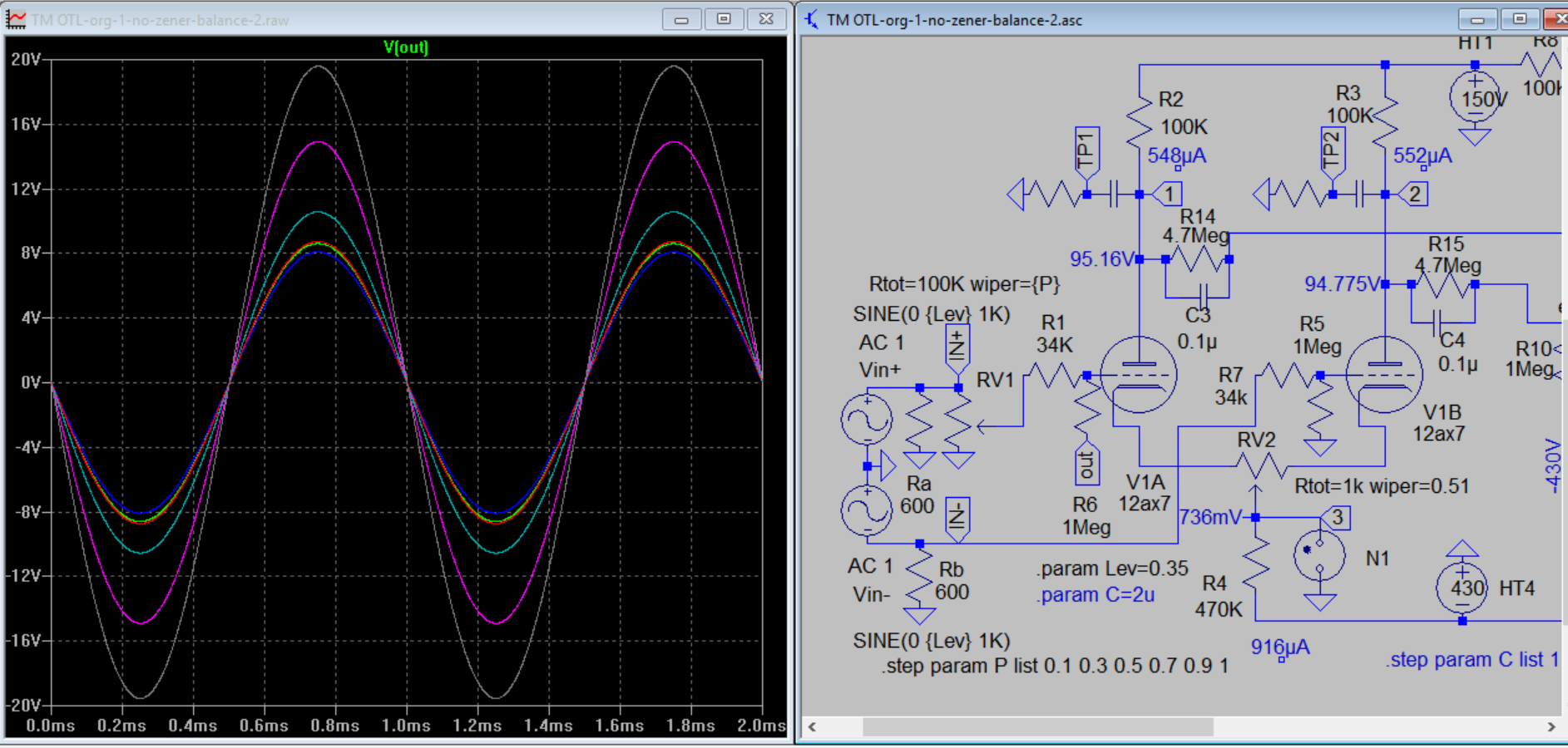

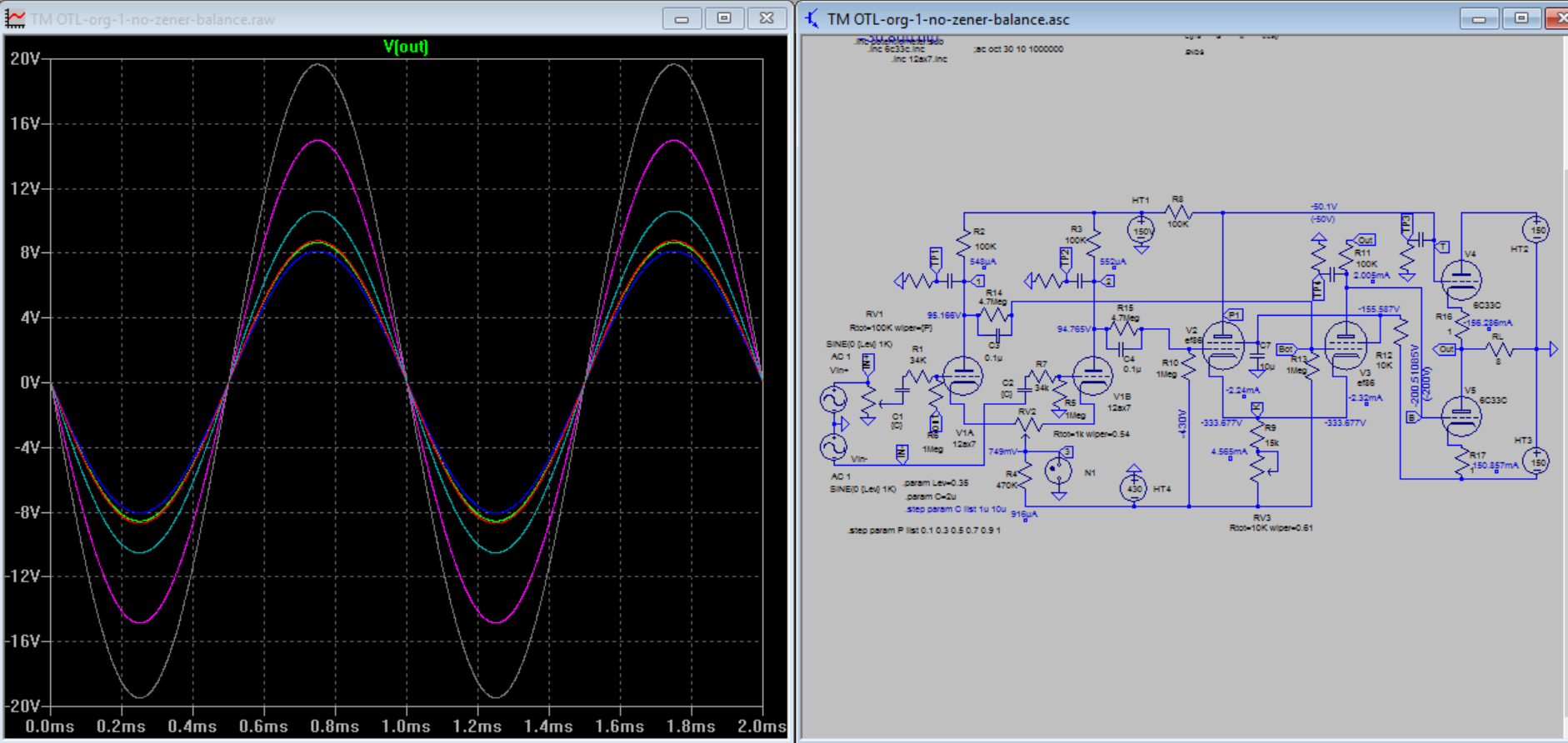

Have you try this? If you're nervous, you can just remove the volume control, and put it in the balance input of pre-amp instead. But I can't see why it should fail in actual circuit however, do you?

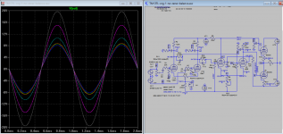

My concern was gettin rid of the two input caps which put some phase issues and tonal modifications as well as the cost.
Yes replace them with solid wire there is no phase loss but you wary of external dc on the input. Balance line has 600 ohms termination resistors, which is different to 47k of RCA input so it's good if your interconnect is very long. Nevertheless it can be done.
You are right, but vr1 is useless as I have volume control in the line stage. and in anny case the vr1 cant work asimetrical in simetrical input, has to be cut off.
You dont think in+ and In- must be inverted , I meen I would disconnect C1 from the gain-control slider and connect it to the negative (inverting) input of the XLR socket. Then disconnect C2 and connect to the positive (non-inverting) input of the XLR socket.
Also loading the imput with 600 ohms resistors, shall change imput level as well as nfb ratio I suppose....
