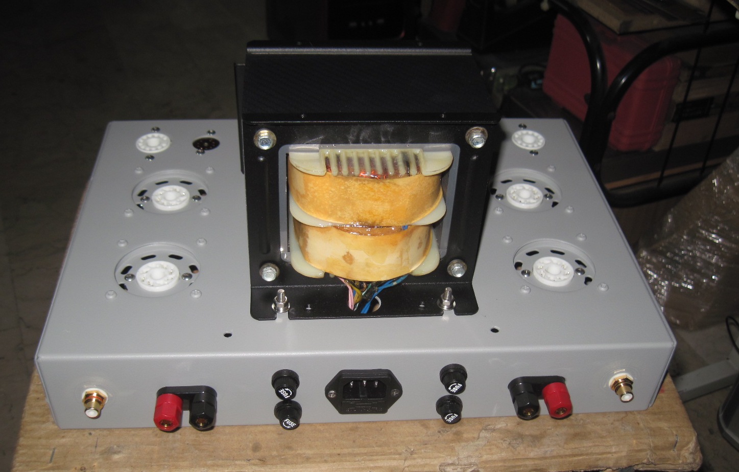

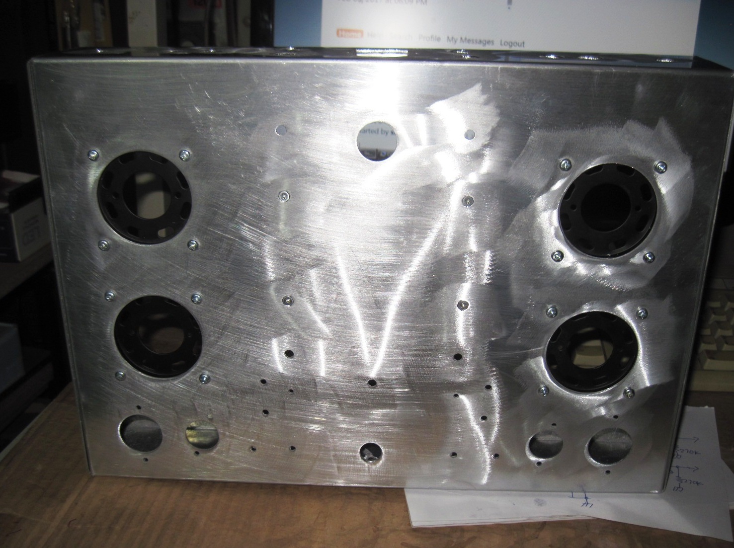

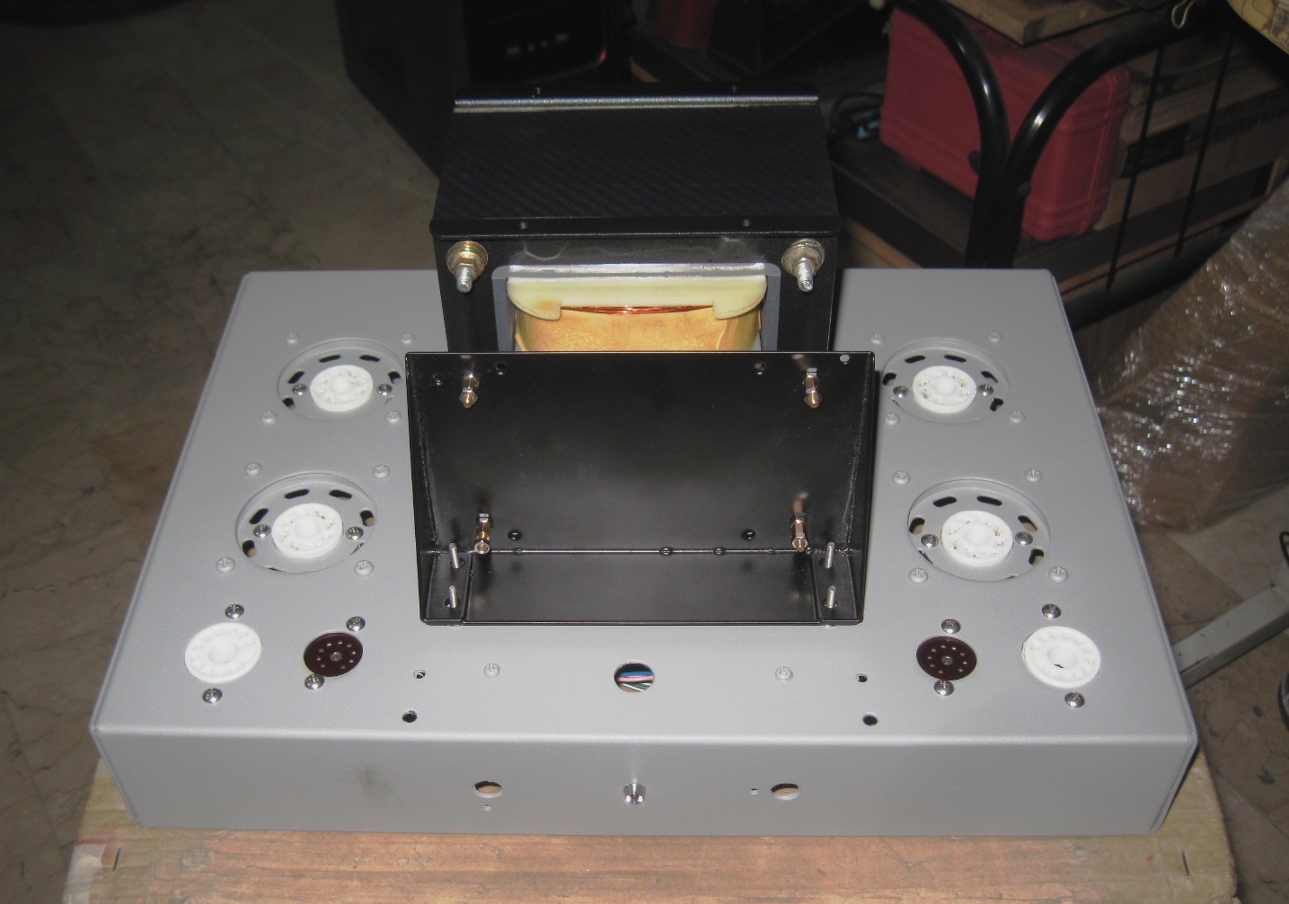

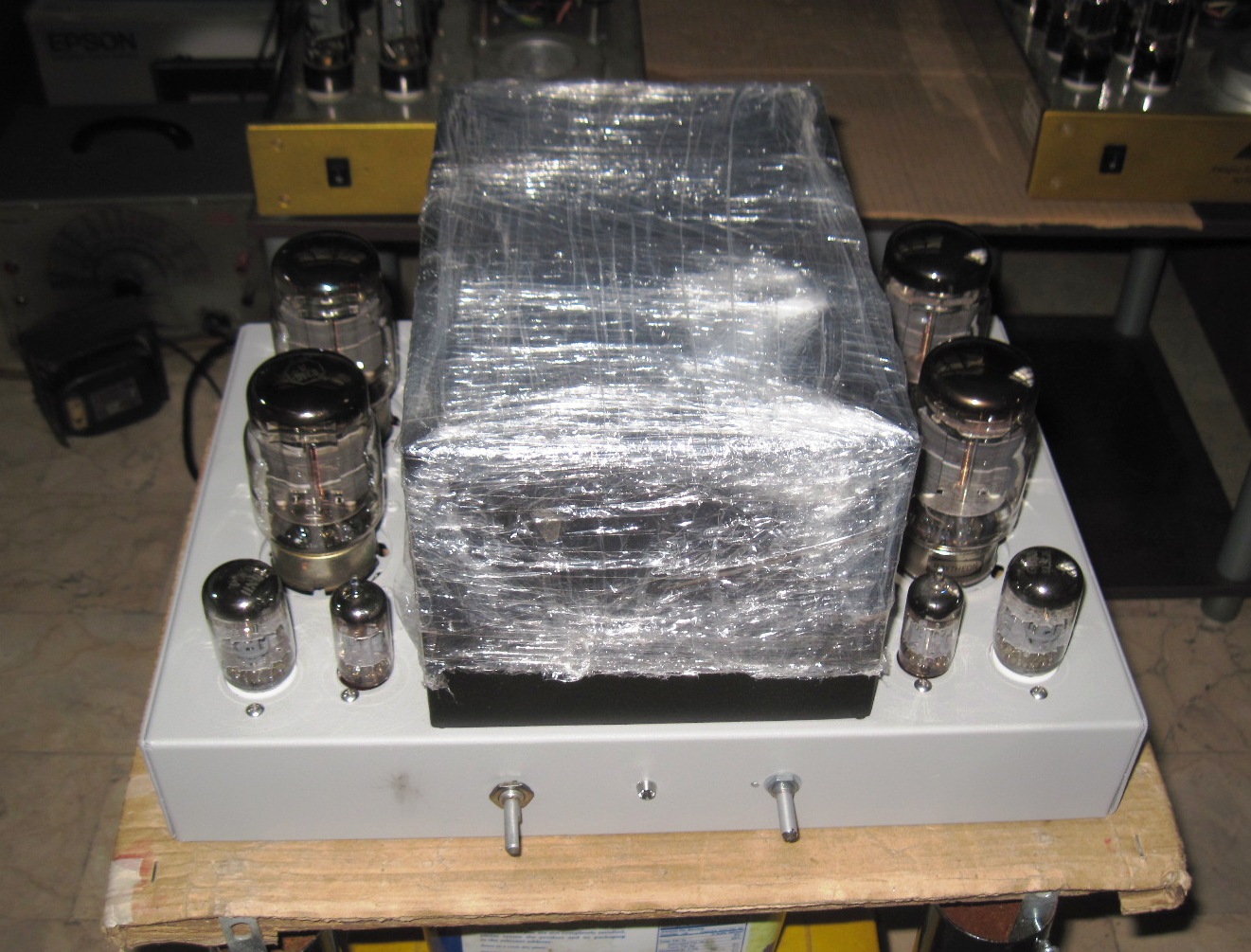

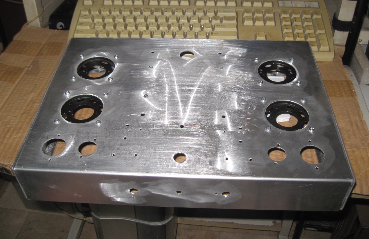

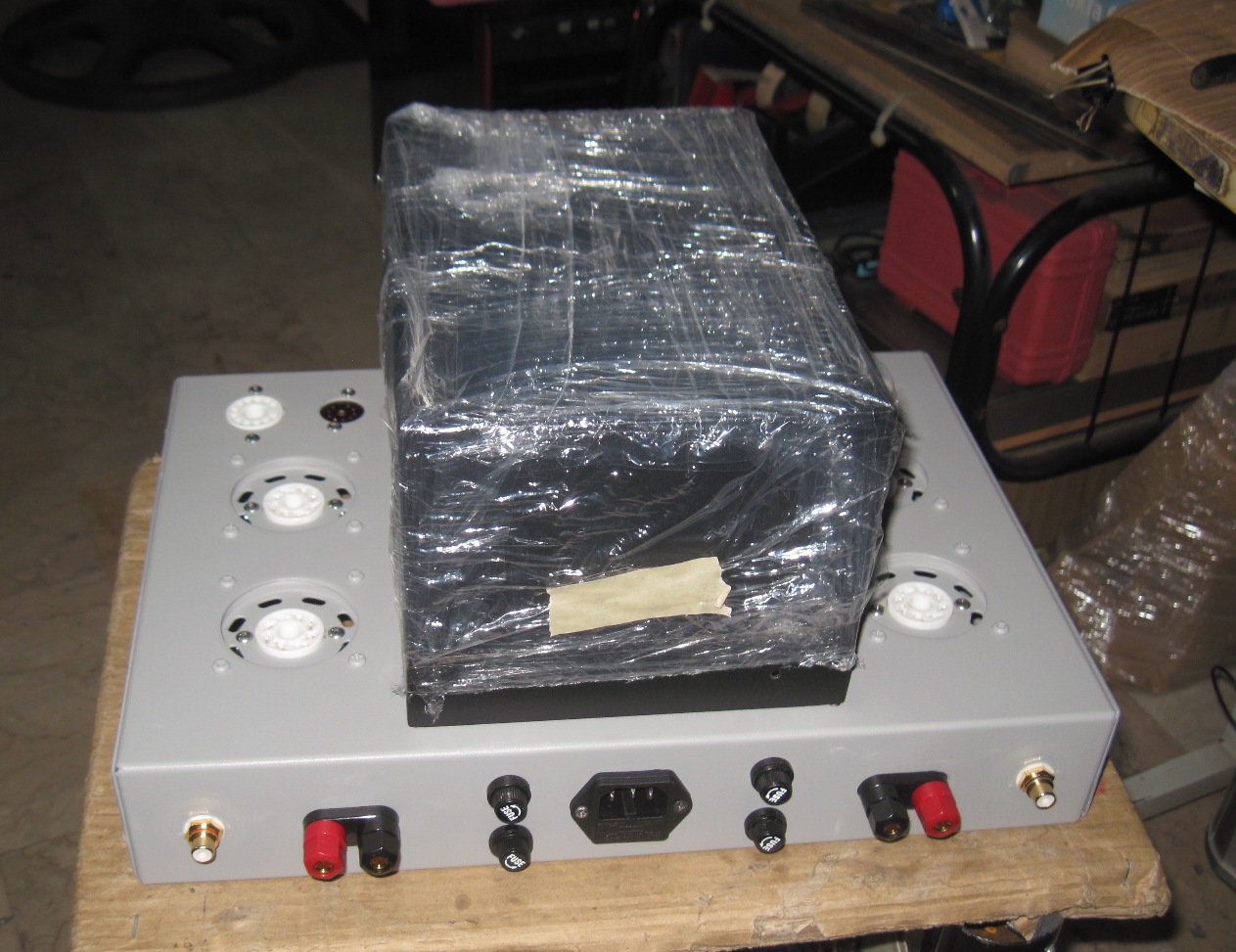

I already have the tubes, sockets and applicable power transformers and it's not a terribly complicated amp...so it still has my interest.
my thoughts too, but start building it and get the excitement of your life....
Nobody has reported speaker destruction when fed from this amp - YET.
OK, it's living dangerously but the sound from the amp is A1. If you accidentally knock one of the 6C33Cs out of its base, you get full HT across your speaker. It's a bit more difficult to build than you think; sourcing the right components was my biggest difficulty.
It would be be completely unsuitable for a guitar amp; it's really only for pure HI-Fi aficionados The sense of reward and achievement after building it is immense when you hear the end results. BTW, there is a previous thread on the same amp which is also very informative. Reading all posts on both threads is worth the effort - both inspiring and slightly daunting.
