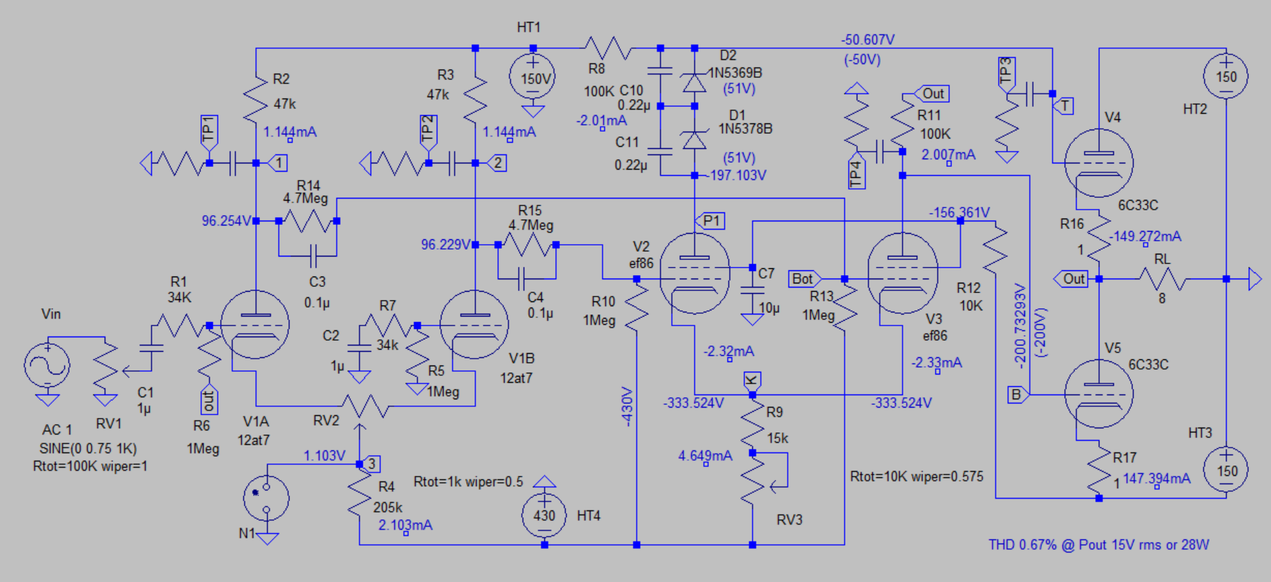

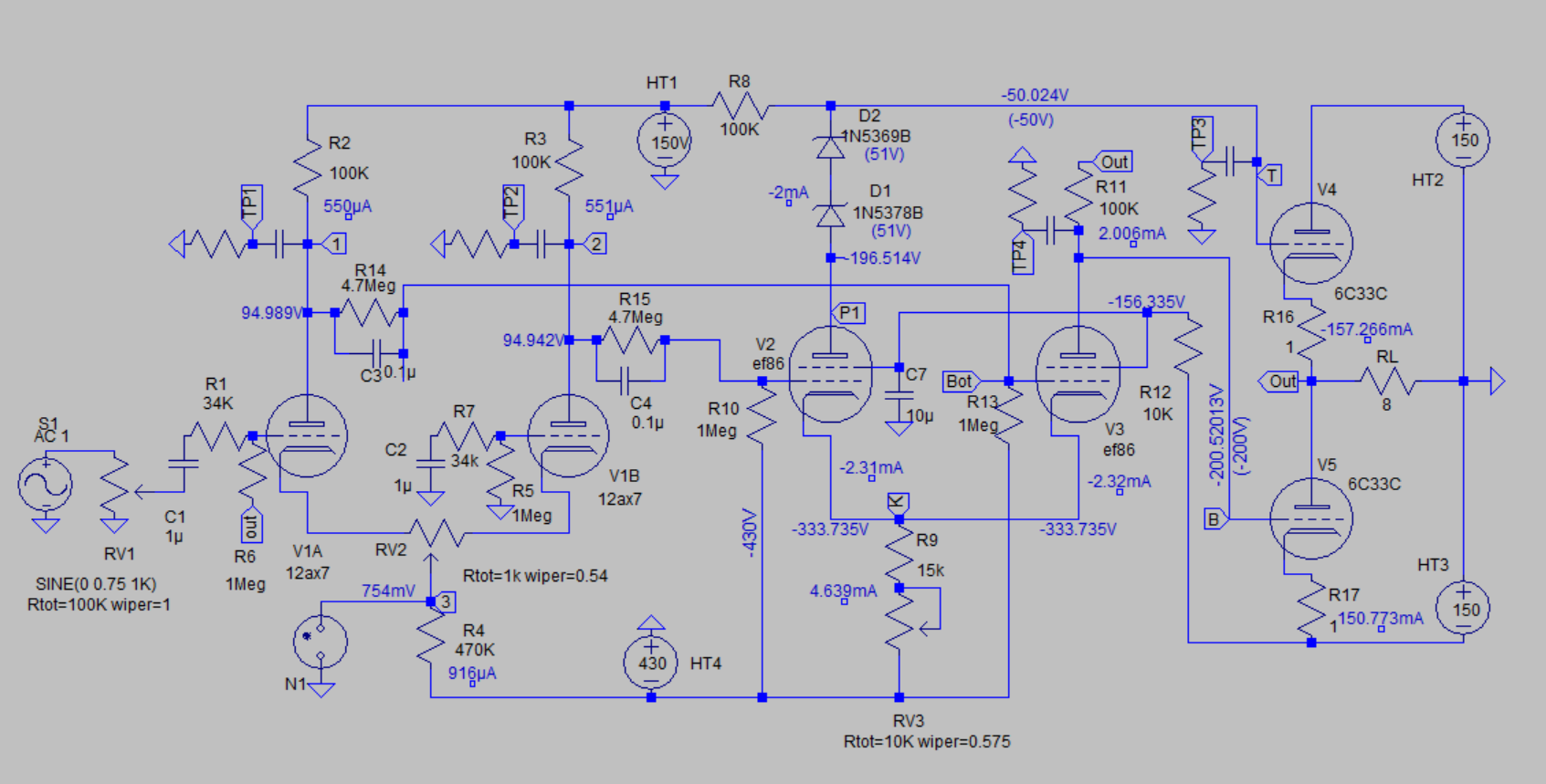

looking good.....can you simulate using 47 volt 1 watt zeners as i described?
also there ought to be a cap at the g2 supply of the ef86...
in the 12ax7 input stage, i would like to put 10ufd bypass caps...
can you also simulate for a 6201/12at7 inputs?
1) I am aware of the method you mentioned, like this one is a little involved, but I"ll give it a try.
2) Yes, about 10u on g2.
3) Can do, very soon.

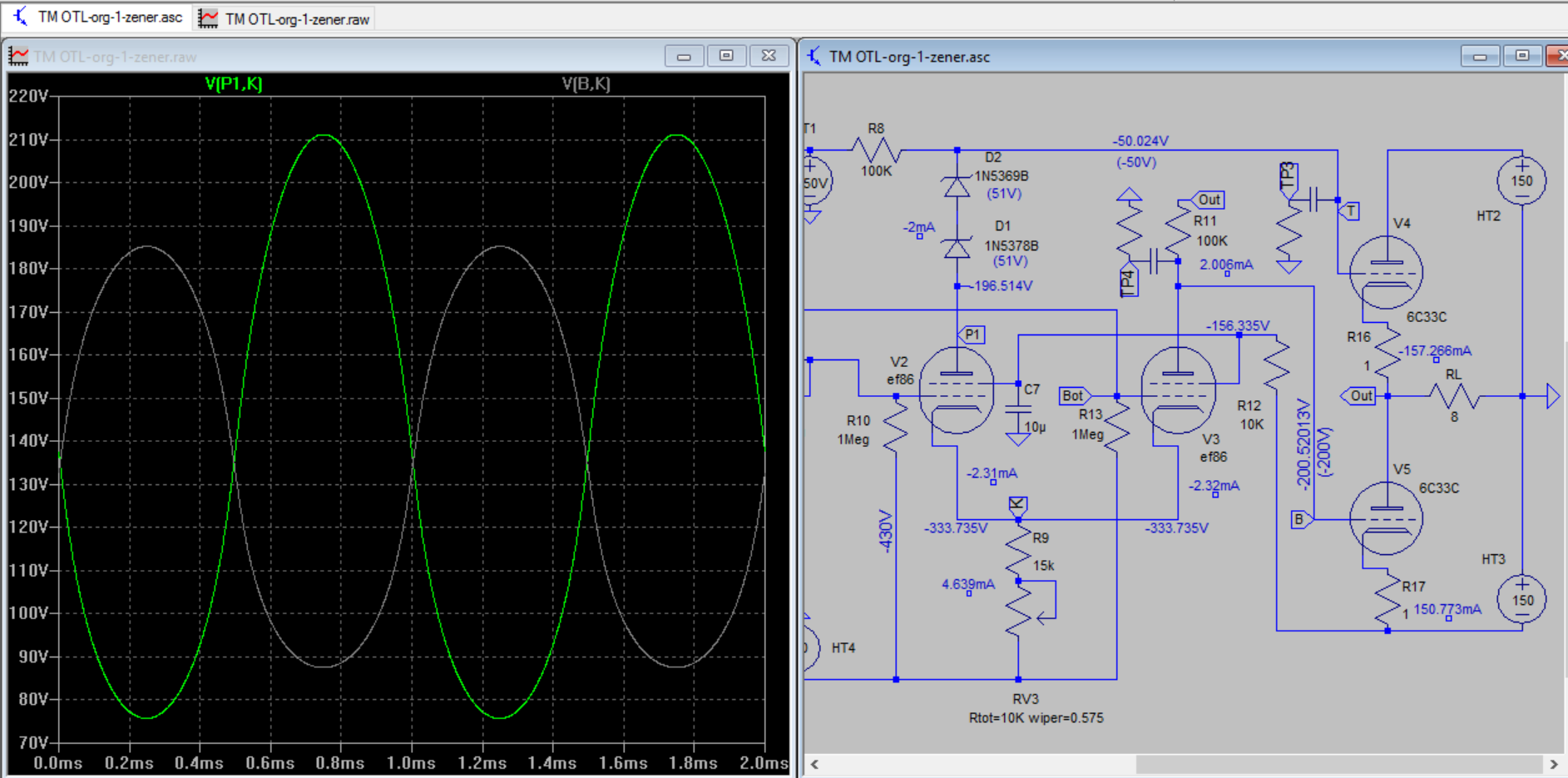

Here is your 1st request. I think it's working very well, no noticeable changes now. Sonic wise as audio now passed through solid state devices, please comment later as you implemented it. Next is 12at7 as front-end.
thanks, the diodes are shunted by 0.22ufd/400vdc cap so that at ac, it bypasses the diodes.....
this is meant to address reliability issues when using the ef86....
this may raised some eyebrows, but if you want reliability, i think this is the way to do it...
for the ef86 drivers, the output swing positive halves are important, they should be of the same amplitude, an equal 50 volt peak would be nice....
to address this symmetry issue, i think the thing to do is to add a pot
between the two 100k plate resistors, a 50k trimpot can be trialed,
with the midspan wiper connected to B+....
My oppinion is that Tim's project is perfect as it is. Nevertheless, I tried several improvement, but only feu were succesfull. FET CCS instad of R7 was one of them as well as separating the power supplyes (eg. +/-150V; +146V; -460V; )
the thing with Tim's topology is its almost dc coupling that i really like....
and listening to it confirmed it as having great potential....

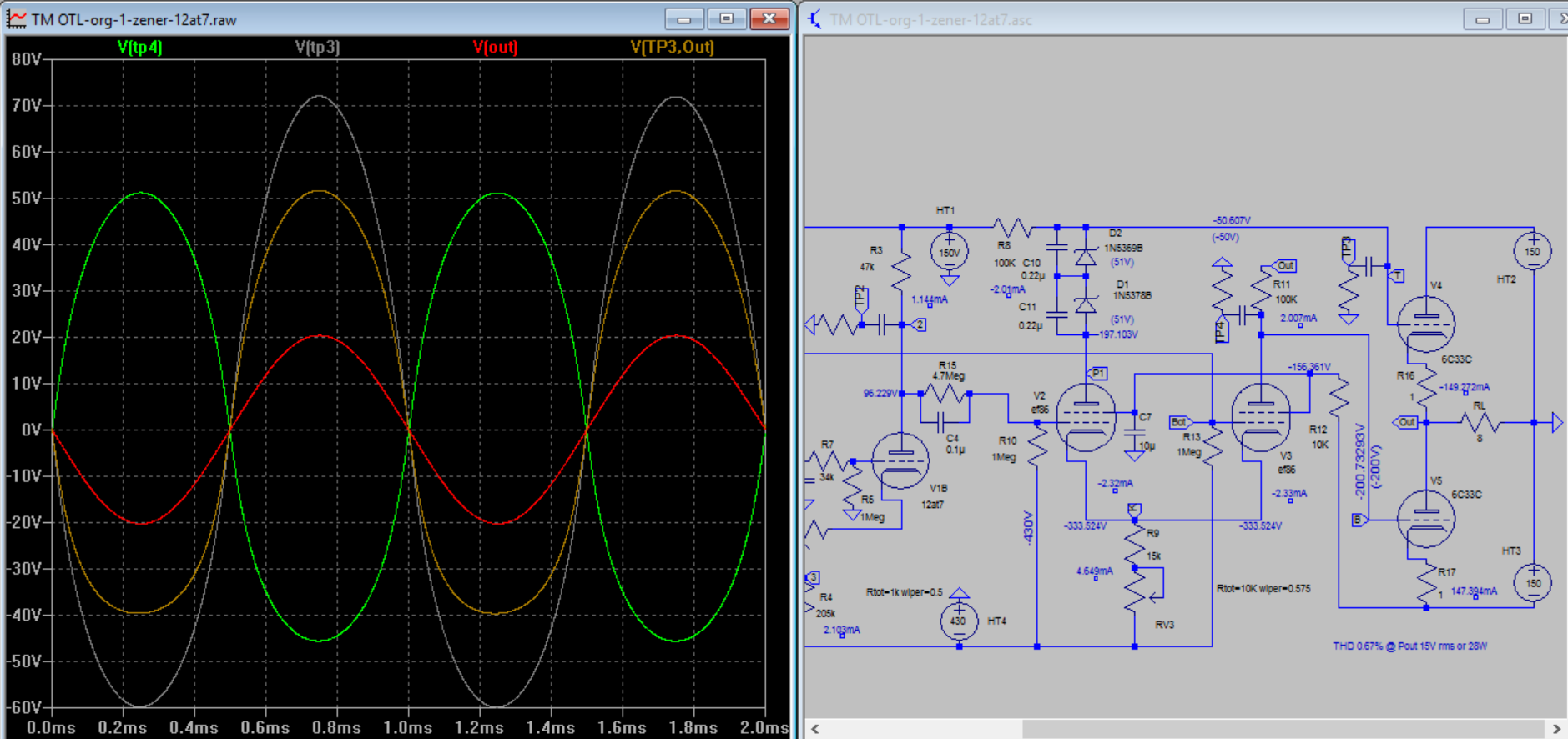

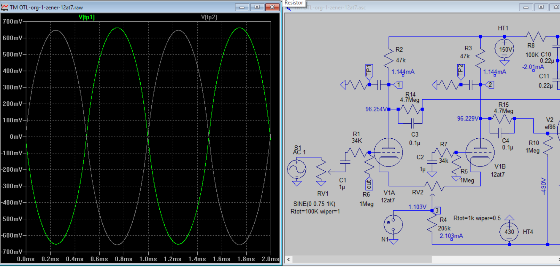

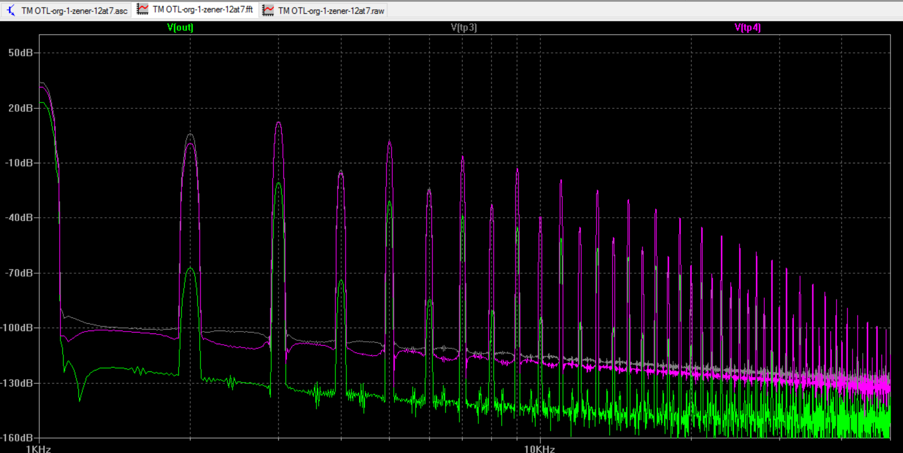

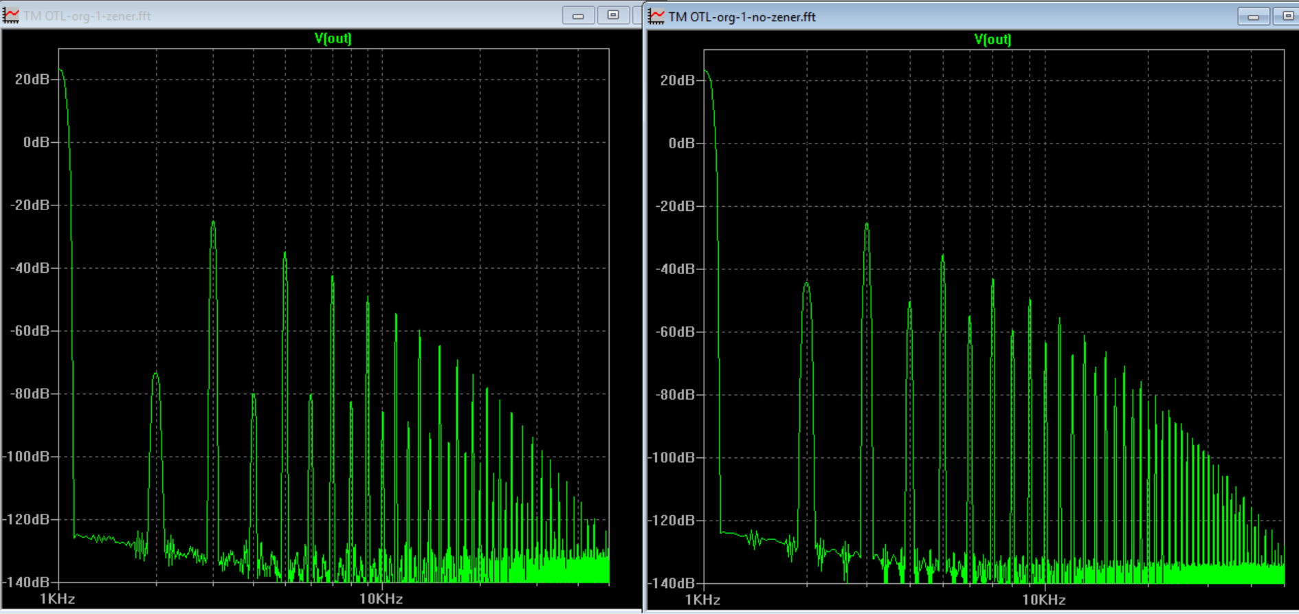

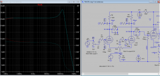

Right, that should make it sounds better. As you bring down the plate to closer level to the other one, this LTP stage now is getter better in 2nd harmonic cancellation, odd harmonic is unchanged, so there is a difference if you drop 50V or 100V (one or two zener), so you would implement jumps to select 1) no zener 2) one zener 3) two zeners.
Here are 12AT7 sim plots, also included FFTs of zener and no zener plot of original 12ax7.
i plan to use just one cap to shunt the zeners, and i use 2ufd input caps because i have a lot of them....
i am not sure how to interpret the results, perhaps some more knowledgeable members
can chime in.....but i read somewhere that 3rd harmonics helps the bass...
