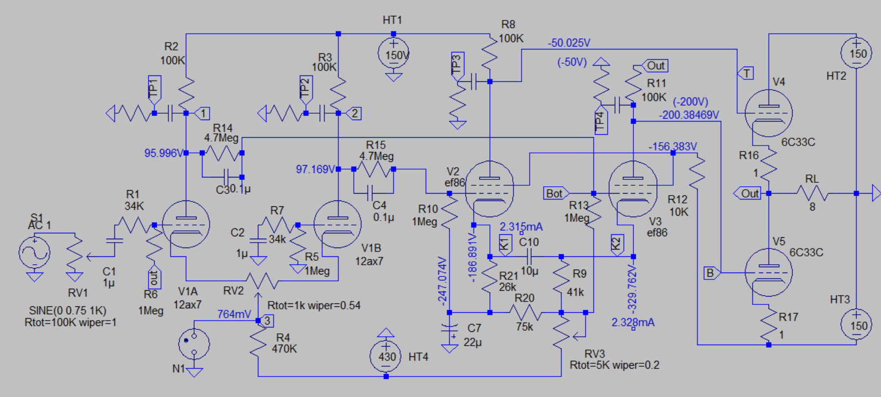

please check the one ef86 driving the 6c33 on the negative rail...
one ef86 has 150 volts plate while the other 250 volts,
so in my next build i am eyeing pentodes with 300+ volts plate ratings....

My oppinion is that Tim's project is perfect as it is. Nevertheless, I tried several improvement, but only feu were succesfull. FET CCS instad of R7 was one of them as well as separating the power supplyes (eg. +/-150V; +146V; -460V; )
The EF86 IMO is a poor driver tube in general and its a bit mysterious to me why this tube is being used as such. Good ones are expensive, and they are not going to hold up if things go south with the power tube.
I think a better choice might be a small power pentode, since the gain is needed and the tube has to be robust. The 6AQ5 might do the job quite nicely and is far more likely to survive the voltages and currents that are required in a driver circuit!
The EF86 is a voltage amplifier that is commonly used in lower voltage settings- such as in the preamps of my Neumann microphones. I've never seen a circuit that subjects them to much voltage- the TM OTL puts them right on the edge.
So you might think about rewiring for the pin base of a common power pentode. 6AQ5s are cheap; 3 or 4 dollars on ebay.
EL84s are bit more expensive, but have the advantage of using the same 9-pin miniature socket, so might be easier to use.

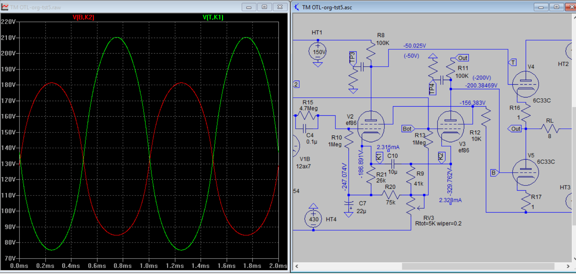

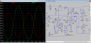

Level drops of two points in a single LTP is not easy without compromising the operating points, that is one too high and the other too low. It's necessary to lower the negative supply on the high side, here I have made them almost equal. The distortion is lower somewhat, Let me know what you think.
