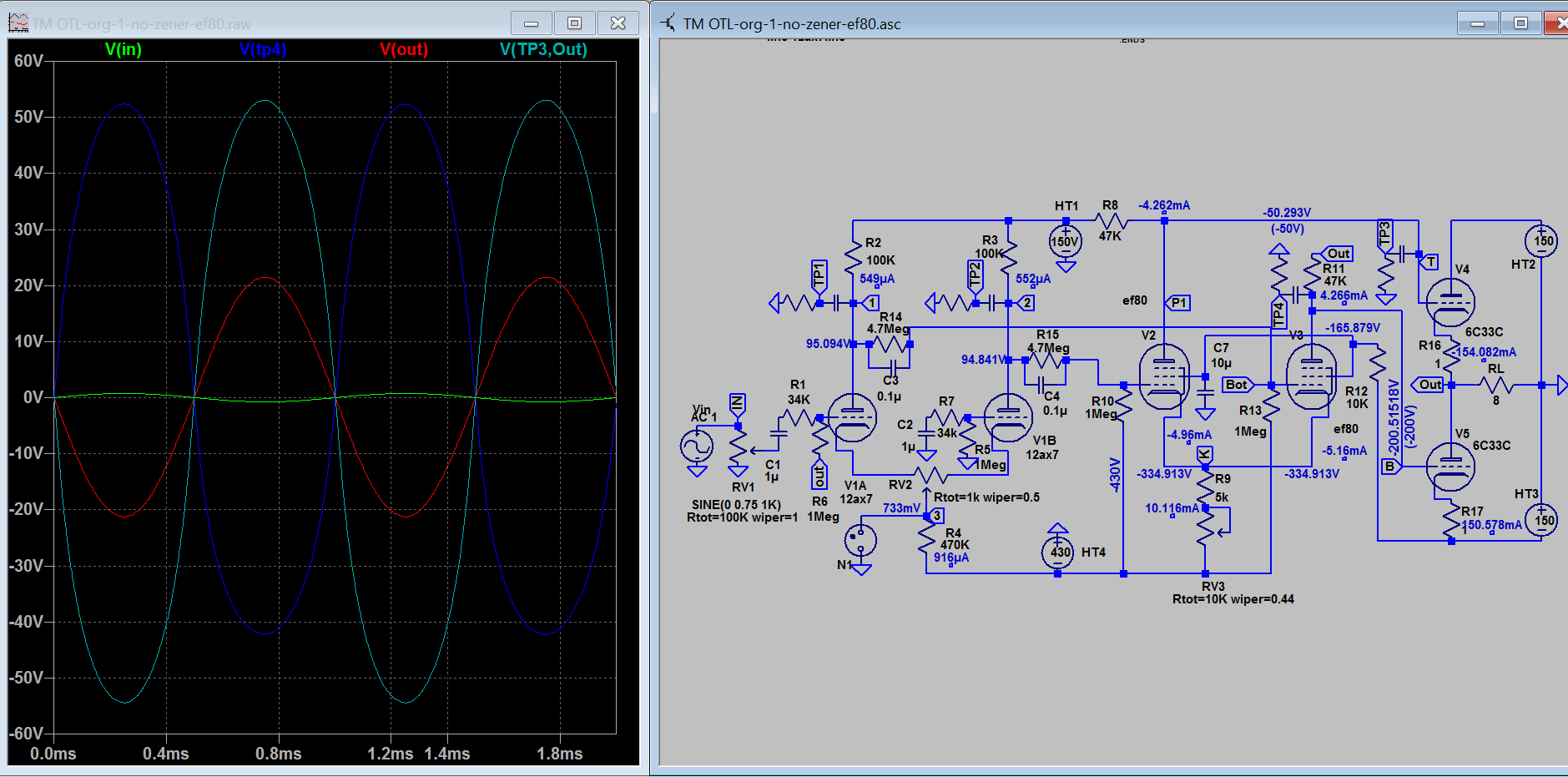

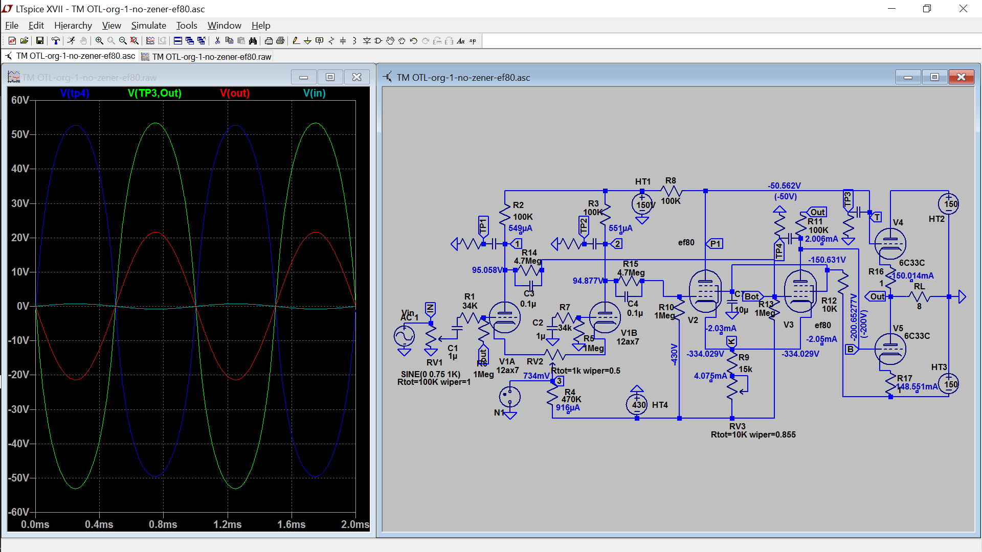

@KoonW, can you run simulations using the 6bx6/ef80 instead of the ef86/6267?
then with a 47l plate resistor at twice plate currents? thanks...
ef80 model found does not include screen current. I need to generate another model using Philips datasheet here, may take awhile. The screen voltage Vg2 option for model is 170v, 200v and 250v, so the screen voltage in the actual circuit should be about the same as the model, screen supply voltage may need adjusted. Anyway I can adjust in the sim. Do you have any preference for Vg2 voltage?
Also as there is no screen current included in datasheet, so I need to adjust the screen current so the pentode strapped triode curve close to this. First of course need reasonable accurate pentode model.

Here is the sim with ef80, adjust the bias volt, no other components changed.
EF80 model in use:

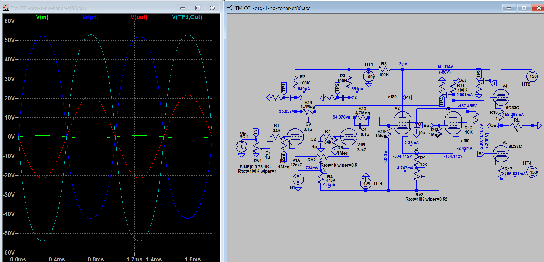

Here ef80 screen current has been adjusted higher somewhat so the triode plot is closer to the reference mentioned earlier. The increase in screen current affect the bias, but looks within the range. Noted that screen voltage is about 170V.
Code:

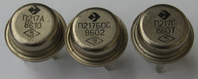

We've been using Russian tubes for about 35 years. IME, there is always a number associated with the OTK stamp; the higher the number the better. Generally speaking though once the number was more than about 15 or so we had little troubles with the tubes.
But it was quite clear that the tubes we got, which were bulk packaged, came to us untested.
At any rate, if you want your tubes to last, do the preconditioning! I've been on both sides of that issue and the preconditioning has saved us a lot of failures. IOW, we found that we got a lot less arcing in new tubes by preconditioning.
"OTK is similar to JAN" - wrong statement. OTK could be same "by sample testing", hence not military grade at all, but for civil use, though could be for both. The mil would likely have the special stamping, most often the diamond (with the number inside), sometimes as a star, or the "ВП" letters.
Here is the thing: some species were not made for civil use, hence for those OTK means yes, military grade only. The common ones like you mentioned 6П14П in order to be considered a "JAN" have to have that special stamping. Sometimes it was only on enclosed spec/datasheet inside the box of e.g. 50 pieces, which individually might have none.
What I really mean to say OTK is minimal requirement to acceptance into military. OTK system provided a first level of control, filtering out goods that were obviously substandard, and this freed the military agents to focus on the next level of screening as military agent so you see OTK form the dual regulation of the quality control. Likewise JAN stamp can do the same for US military.

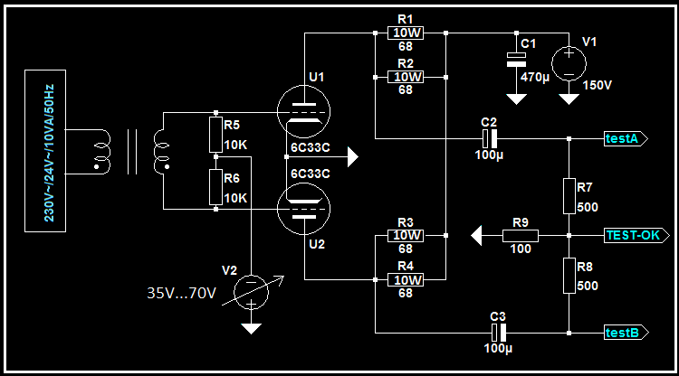

I have just received a lot of 10 pcs 6c33c-v from Russia (1976 production) Do I have to burn in prior to check them ? Did anyone try this?
As Tim's OTL schedule seams to be somehow dependent on tubes matching, I intend to match them as close as possible using atached schematics. Did someone tried this kind of device?
regards

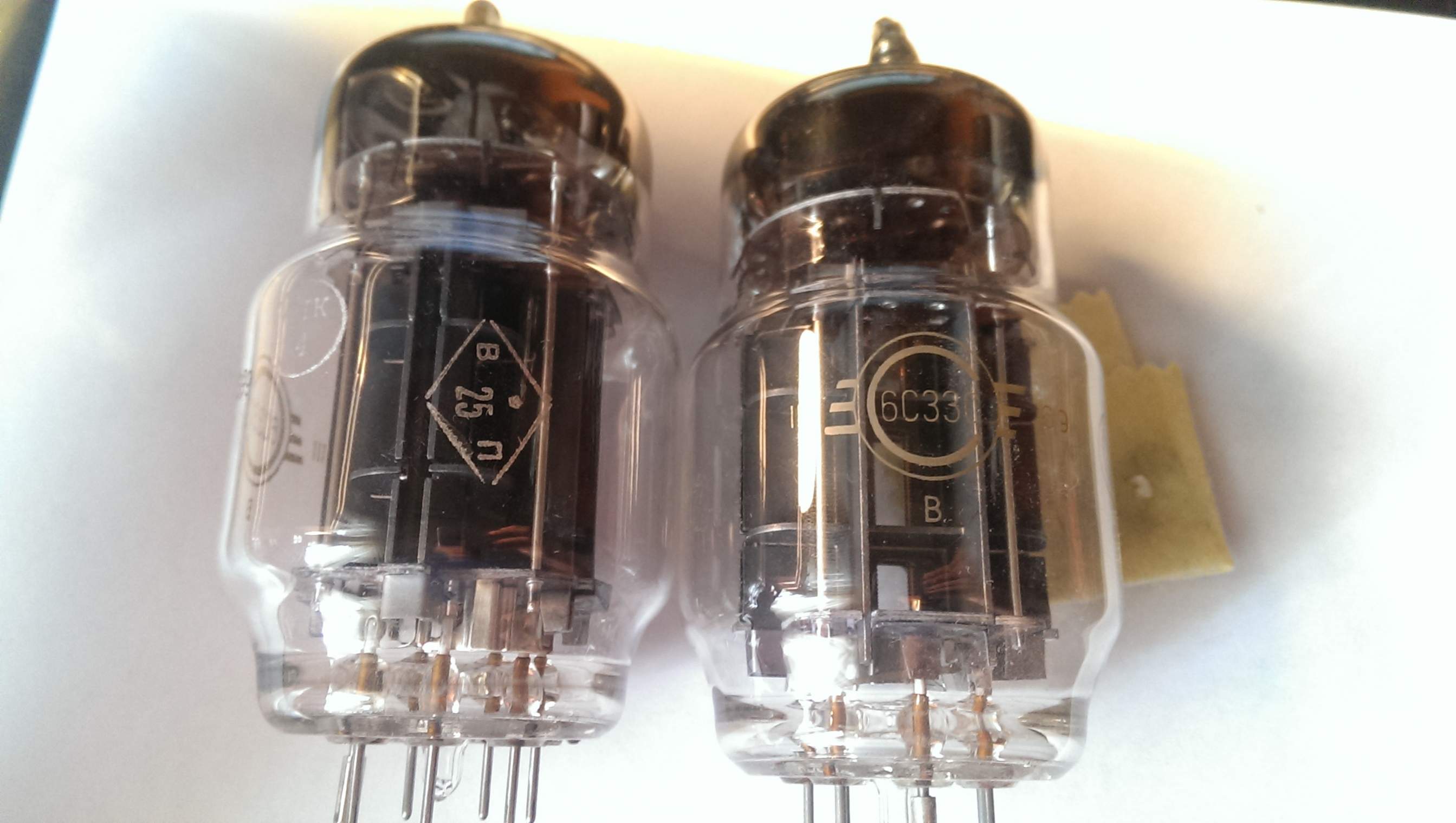

It can be a stamp of person from OTK department not OTK Level
Look at picture
5, 9 and 5 level inside rhombus
Also other marking available. "ВП" = military check and approval. For example, "ВП" in rhombus and 25 (OTK department\person designator)
