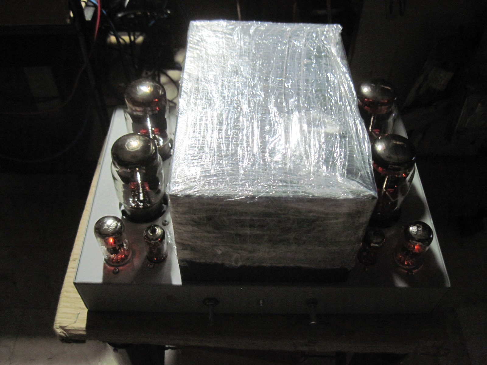

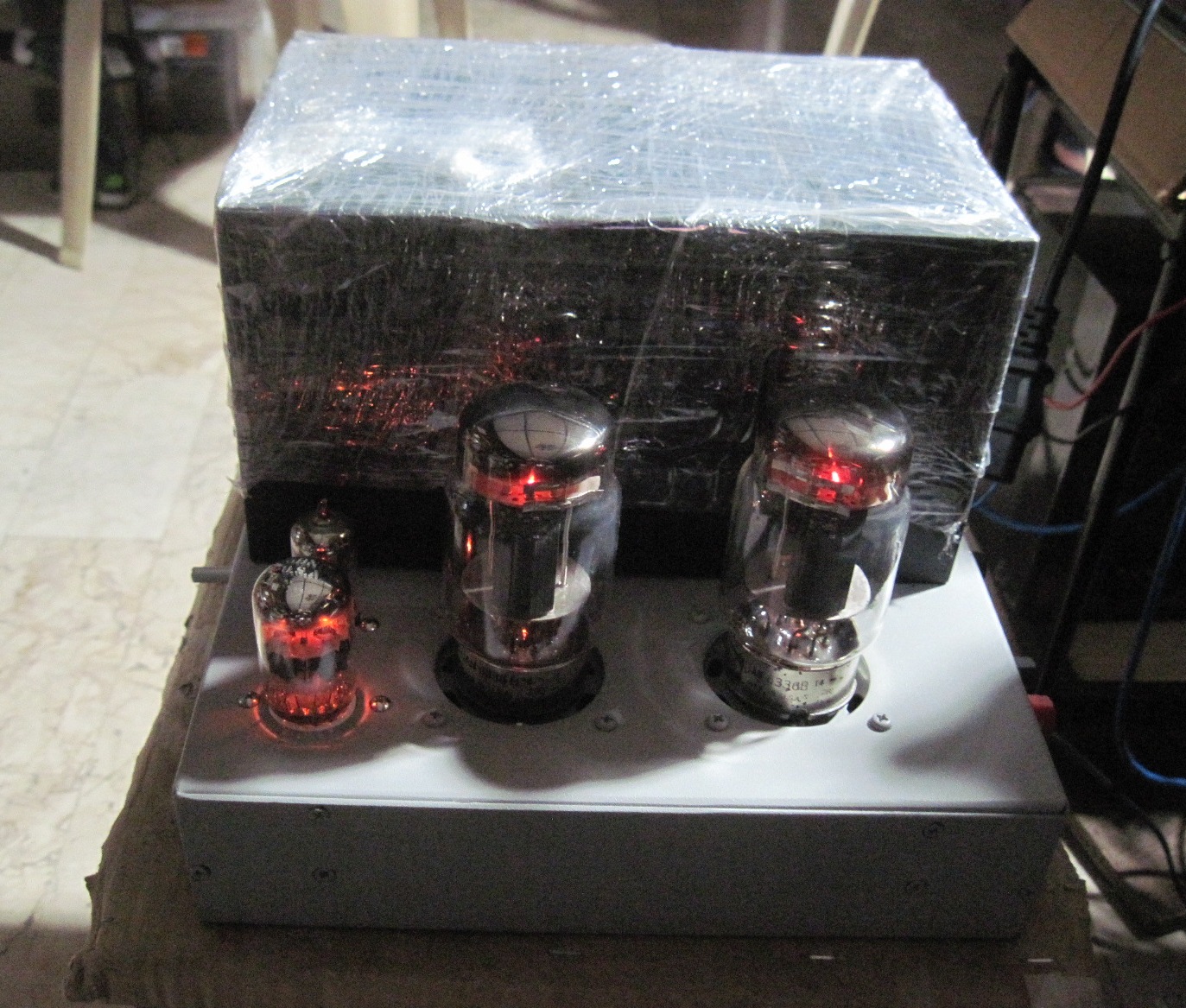

^^ Nice! Make sure you fuse the cathodes. That tube can fail with hard shorts that can fry a speaker in an instant.

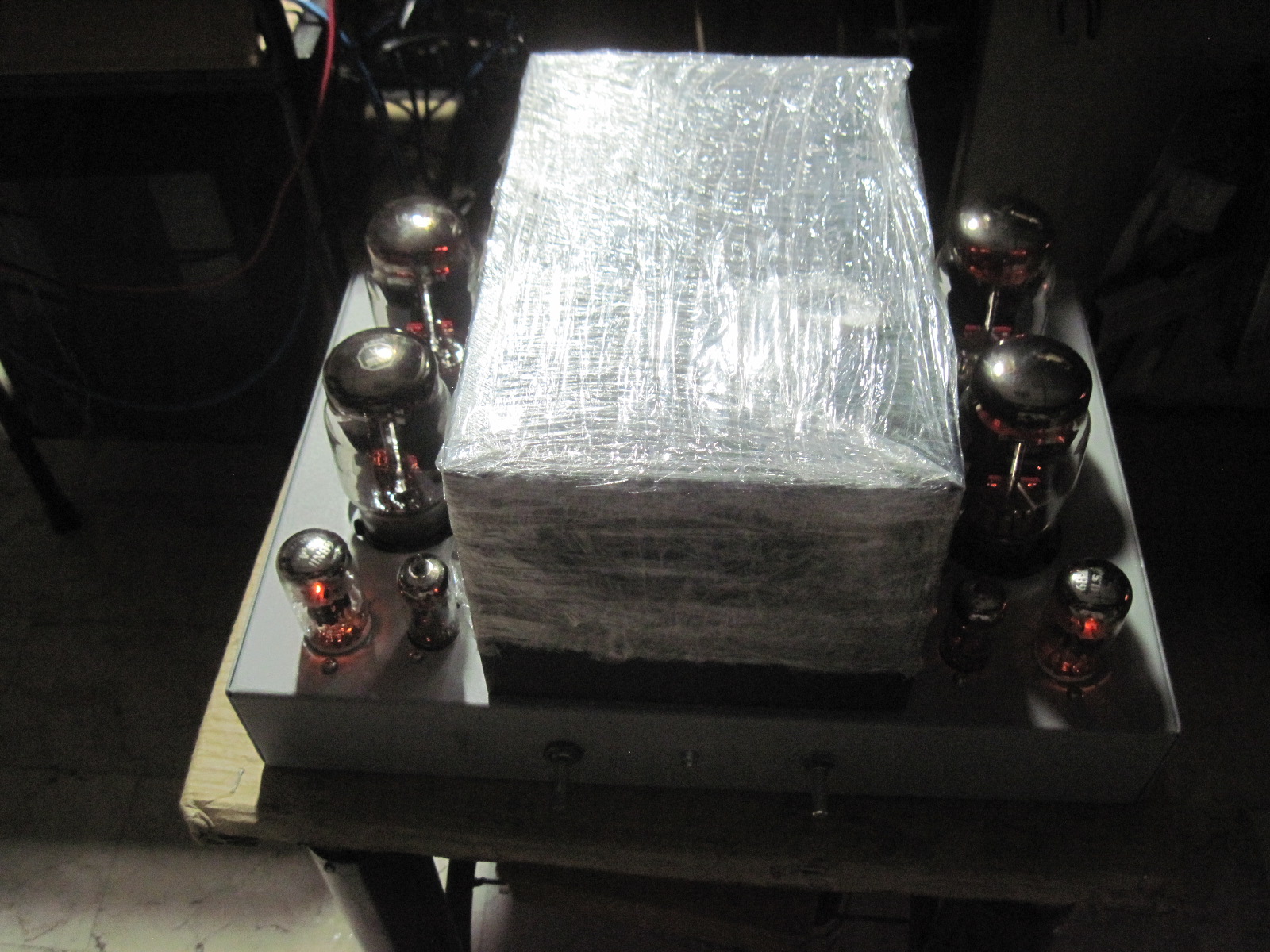

thanks, i have made provisions for that....
my main concern is that i only have 6 pcs of 6336 for matching,
not enough tubes to go by....
btw, i am sticking to the output capacitors,
with provisions for taking it out of circuit as option...
i am also making a speaker matching, 64/32 ohms to 8 ohms speakers....
Used to have some 50 of these 6336 (A) and could not match any.
Do you put the two triodes per valve in parallel ?

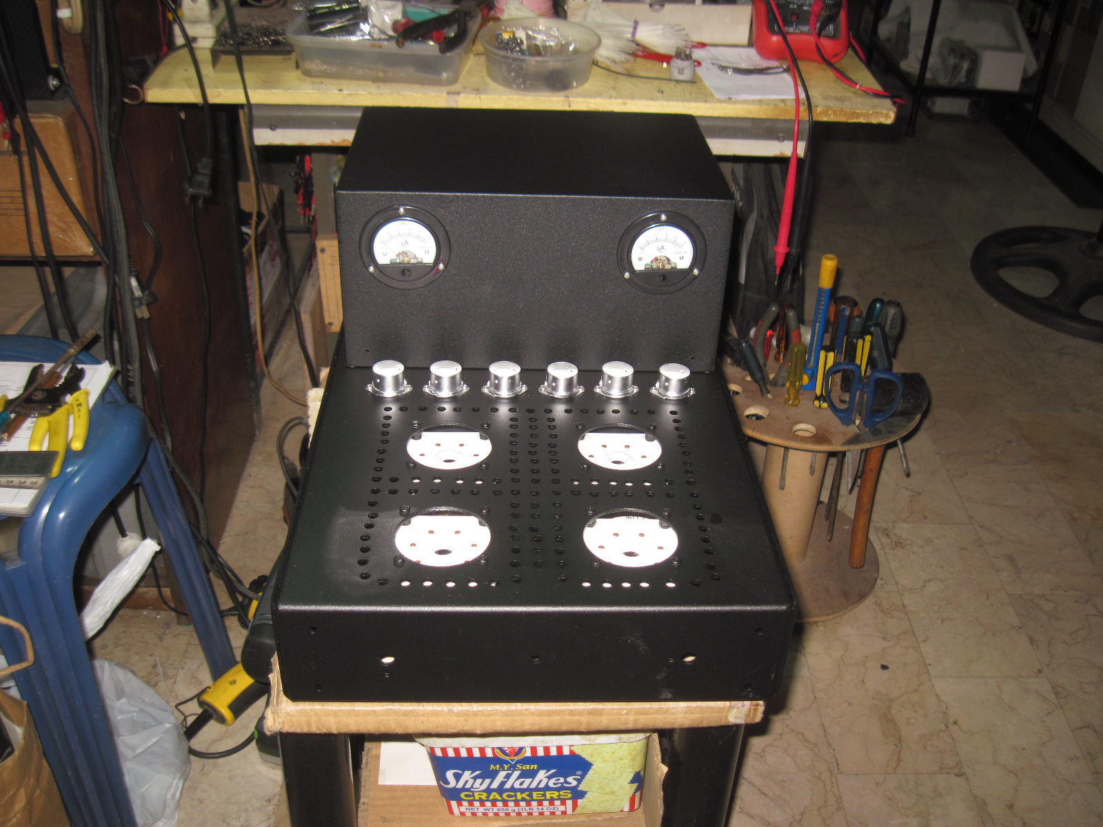

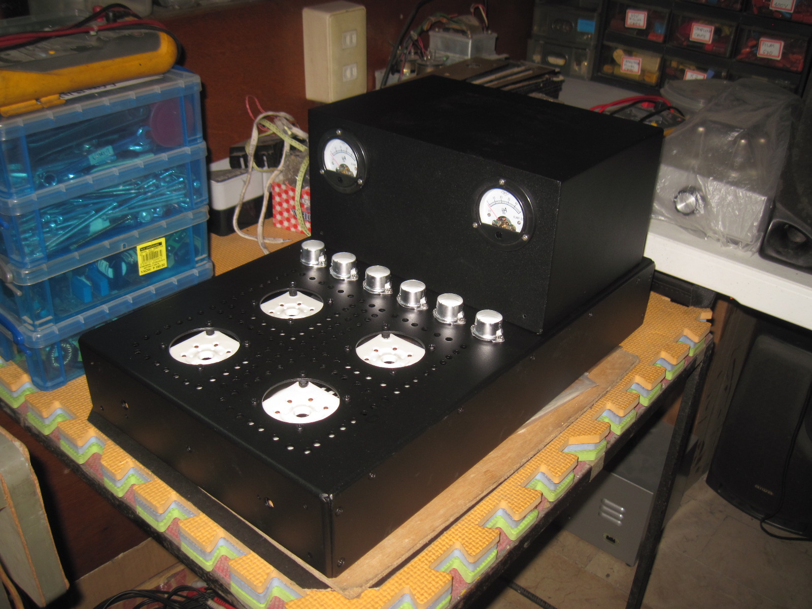

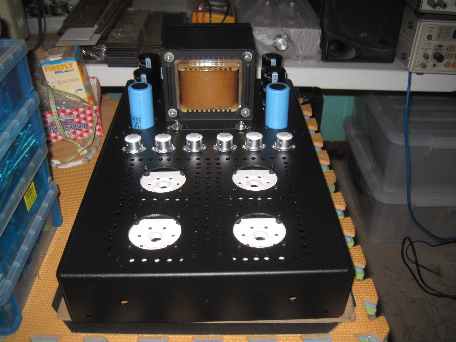

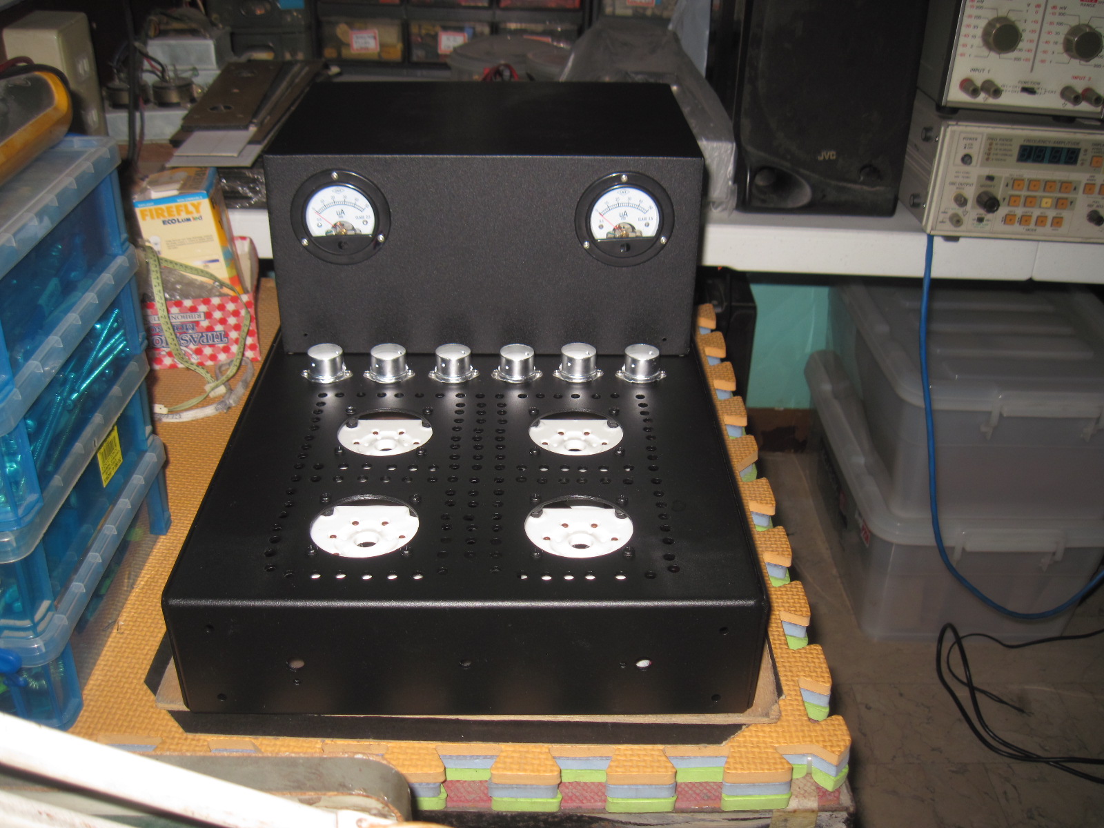

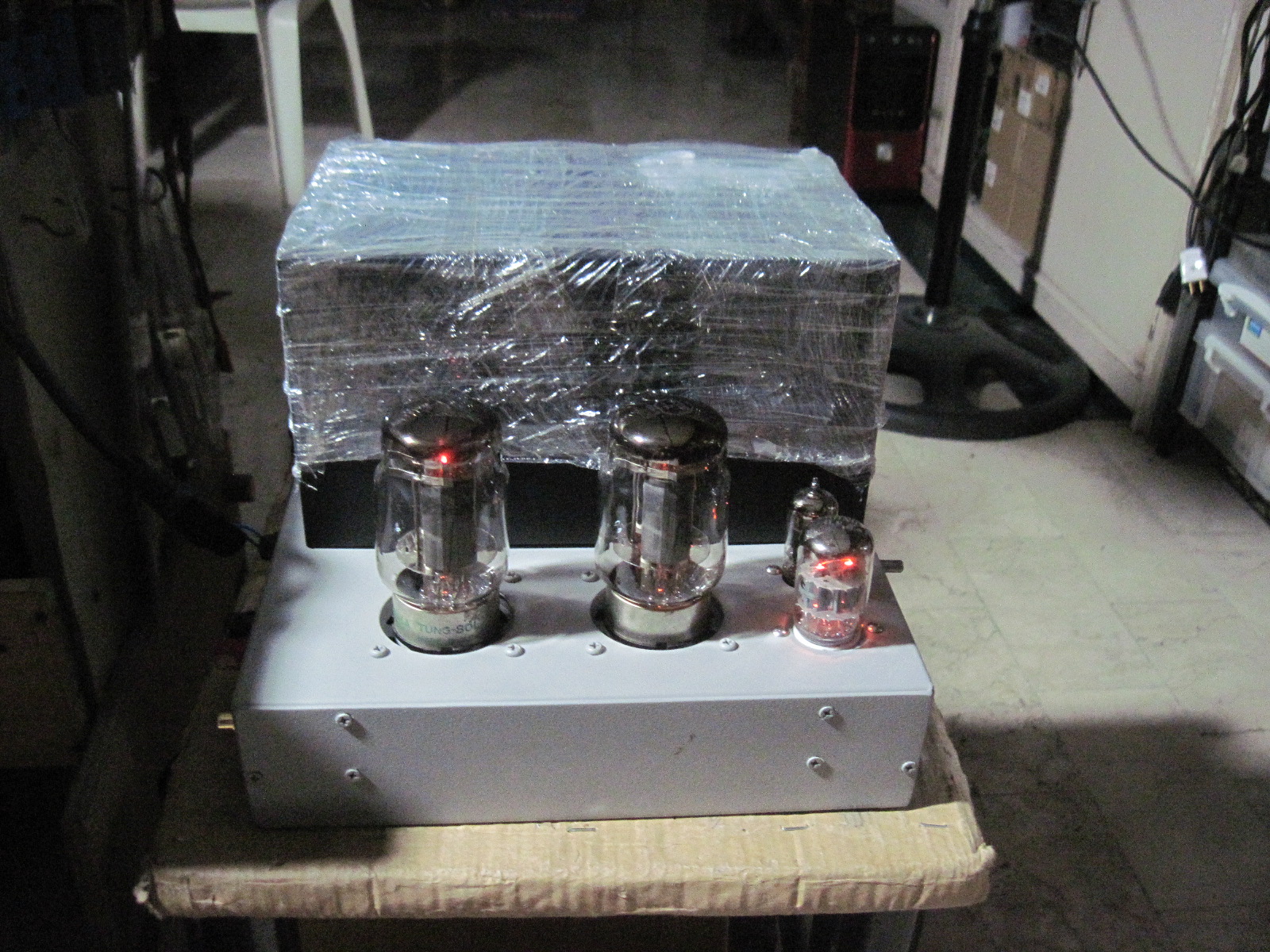

yes, individual cathodes with resistors and a fuse...btw, i now have 8 tubes and looking to get more...i have 3 6528's and also looking for more...
wired up the heaters for all tubes and power draw comes down to 160 watts.
so that 80 watt power budget for the 4 output tubes add up to 240 watts....
that is a 100 watt lower than in the 6C33 case....

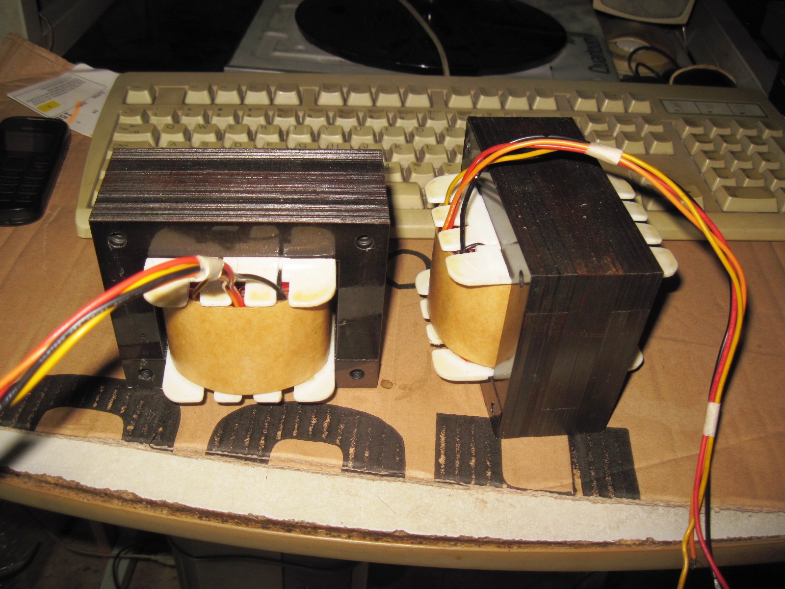

i am designing an outboard output transformer to reflect 32 ohms to 4 or 8 ohms.....
it is done, 64, 32. and 8 ohms for about 30 watts....
