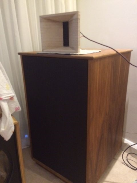

Tonight I hooked up the Beyma TPL150's into my CNC'd horns...lovely sound, smooth, lots of sizzle. Crossed a little low at 1,400Hz...maybe 1,800Hz better.
The Altec 420A is running 'full range'....no low pass.

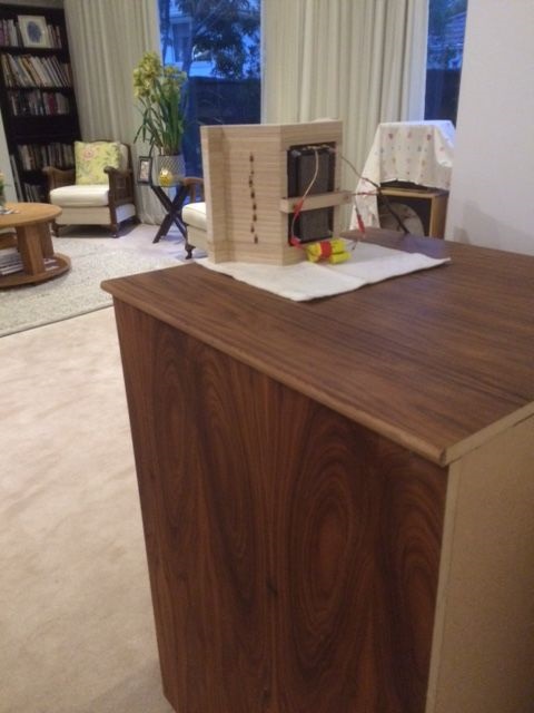

That's great. Looking forward to reading your comments when you replace the factory back chamber in the TPLs with the much larger space you built with the wood enclosure.
BTW, the yellow caps in the back are for protection only? What values are you using? I guess I should do the same.

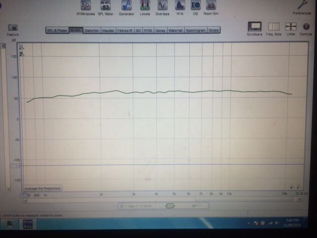

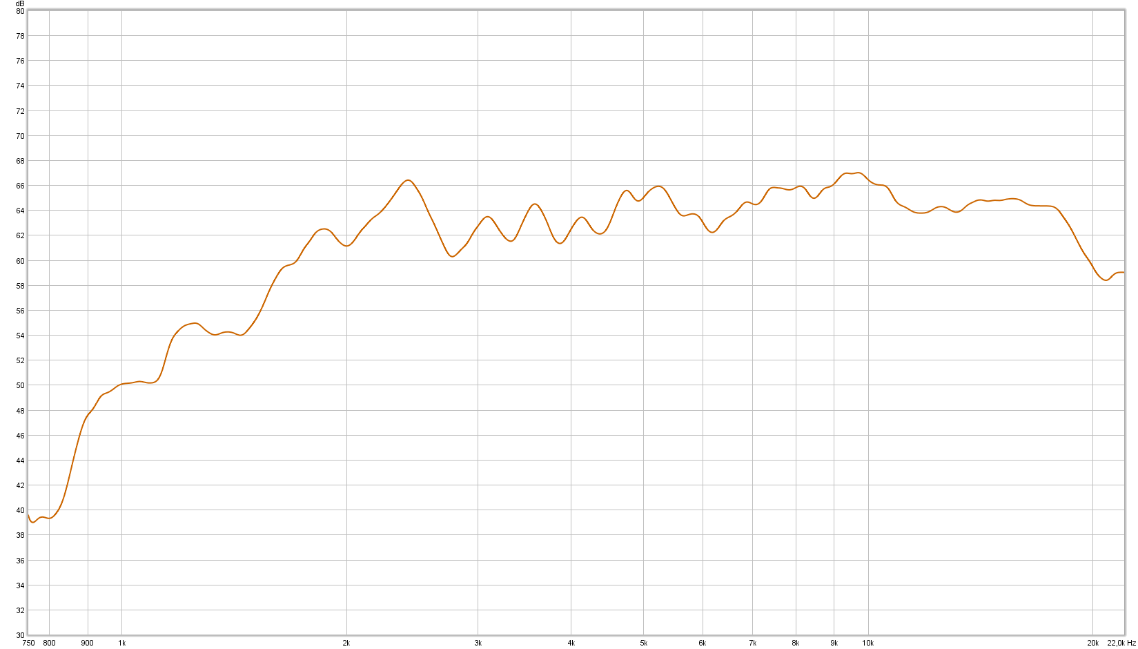

Here's a measurement of the tweeter, with sweep from 800Hz to 20,000, 1/12th smoothing. I'm happy with the result. I'm keen to test it at a higher xover point, eg 2,000Hz.
Looking smooth, although the vertical scale is way too large to tell much. Can you show for example 5 dB above max attained by the tweeter and down to -10 or -15 from average tweeter response?
Agreed, also appears to be on the 65-75db range? Would be better to see something closer to 80-85db, and a scale in the 60-90db range, that will give you much more resolution. And definitely no need for a negative scale.

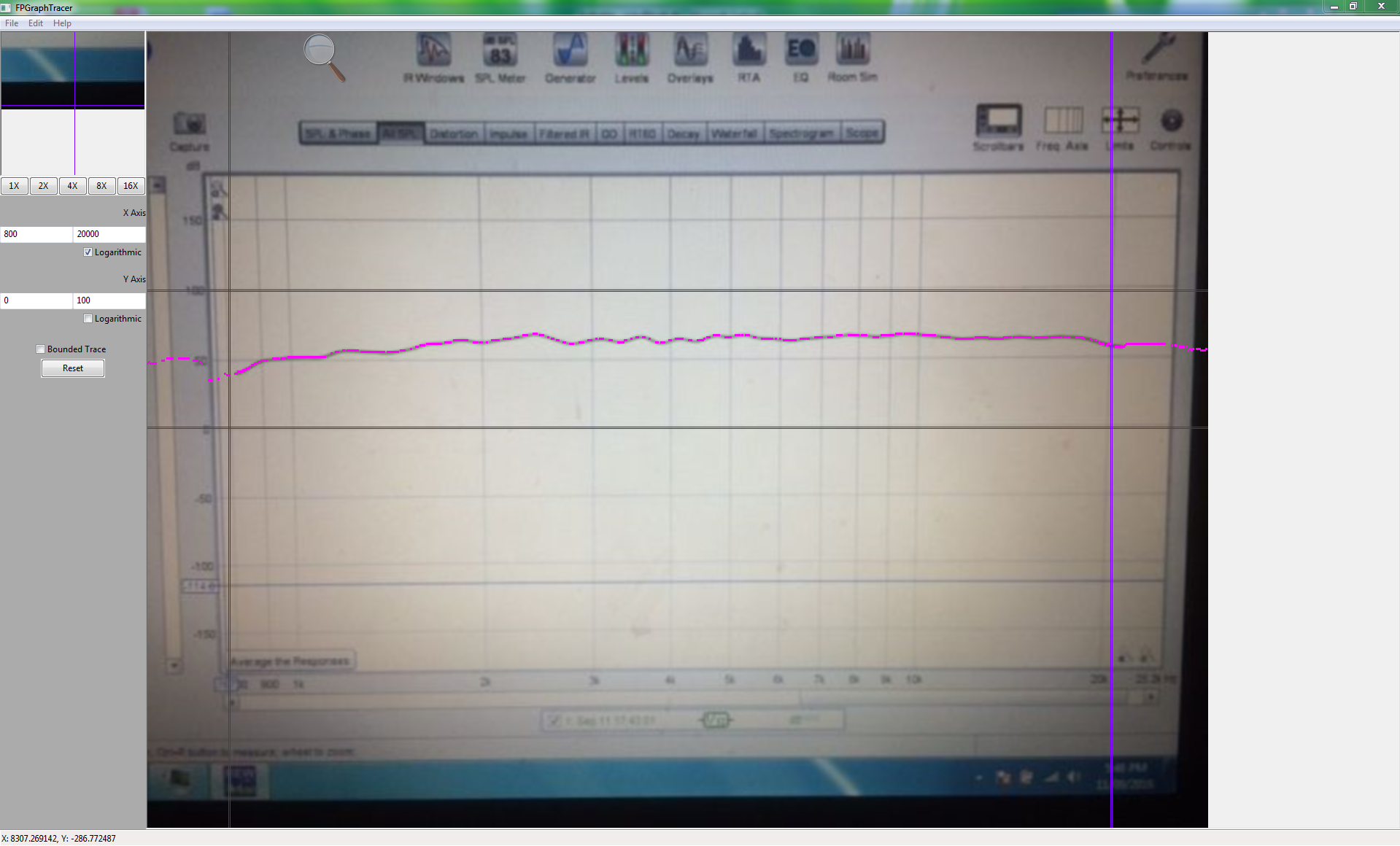

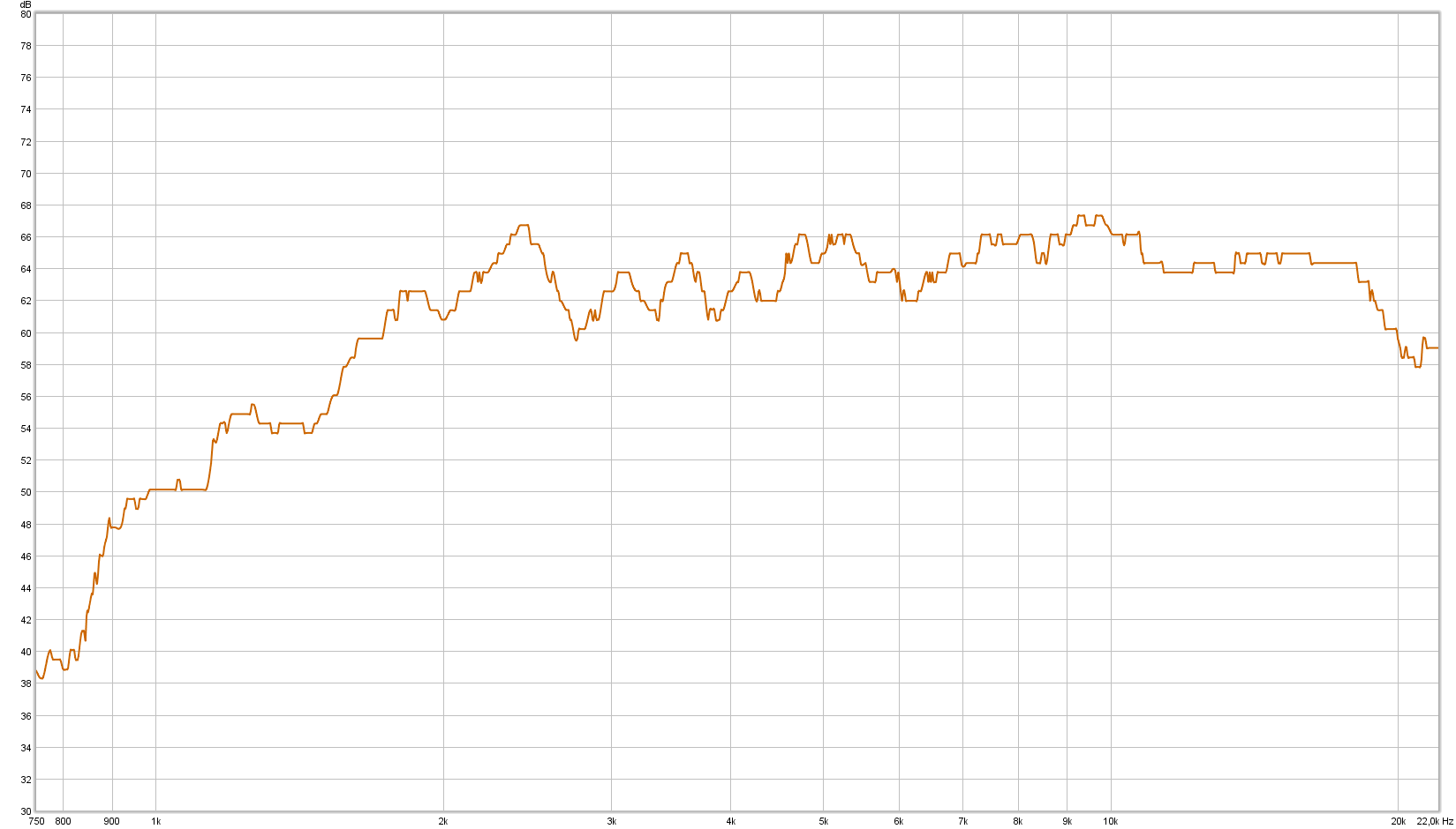

🙂 50dB scale into REW when photo-plot is traced with FPGraphTracer : fprawn labs.
Picture one is the tracing act to show there will be some small distortion taking place because camera is little angled verse LCD screen when photo is shut.
Picture two is frd-file imported into REW and no smoothing.
Picture three is frd-file imported into REW and 1/24 smoothing.

BTW, I've been doing some reading towards protecting my TPLs from low frequencies and DC in the context of an eventual malfunction of the active xo, and/or DC burst at amp turn on. Doing the math, I suspect your 18uF cap won't operate as you expect:
I think you ran the numbers assuming it was an 8 ohm load:
F=1/(2 x pi x 18uF x 8 ohm) = 1105 Hz
But the TPL is a 4.9 ohm load, so rerunning the math I end up with a corner frequency of 1800 Hz, which I understand is too close to the actual xo frequency.
From the same reading I've been doing I came across a recommendation from the guy behind DEQX saying a good rule of thumb for tweeter protection caps in an active system is to use a corner frequency two octaves below the intended xo.
Please take it as constructive feedback! And if I'm missing something please explain so I can learn. I'm coming up with a protection cap of 65uF, which is expensive for protection only...😱

Lewinski, yes, about 18uF, giving theoretical first order xover @ 1,100Hz, 8ohm.
