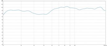

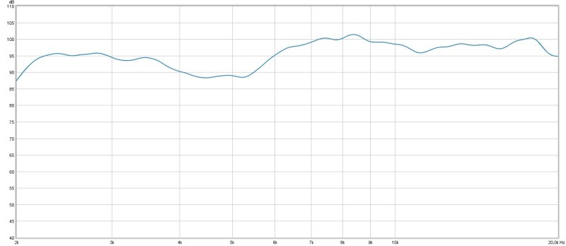

I am planning a similar build, but it will be a two way system from 80Hz and up, all active and controlled with a MiniDSP DDRC-88A + BM.
The TPL-150/H will be for sure the tweeter to use, so I dit a long search for a Bass/Mid unit that would be adequate to connect to the TPL at about 1700Hz and also go low enough in a closed (Qtc 0,56) box with a Linkwitz Transform filter, the one that game up in my eye's best suited is the 18 Sound 12NMB420 (I am from The Netherlands so the AE TD12M is out of reach for a normal price), bought one for testing and dit some close range measurements in a little dampened (Qtc 0,702) 21 liter closed box, I like what I see but would really appreciate your commends and advice about this (or other) bass/mid driver.

Any tips for alternatives that I can look into?
Looks perfectly usable to me. I've had good results with 18 Sound drivers as well as other reputable prosound manufacturers.

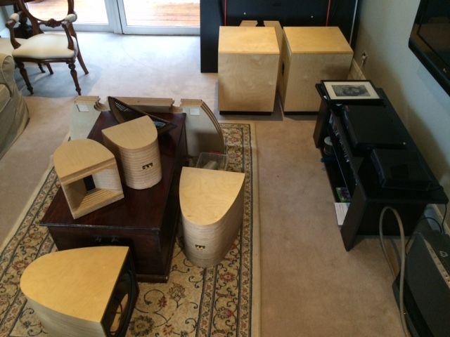

Back from hols in Coolangatta, Queensland.

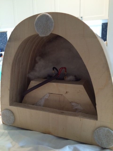

Fitted drivers to the tweeters, added wool, felt pads etc. Added extra coat of gloss poly to the tweeter housing.
Next week, I'll assemble all units and test with amp and xovers.
Mrs wants the lounge room back....talk about demanding.

Looking good!!
One suggestion, if I may, and from a conceptual point of view rather than from actual experience: you migt want to try also with a reflecting piece of wood at the back of the TPL, reflecting downwards. Dificult to explain in words. Let me try.
The inside surface of the tweeter enclosure, as seen from the back of the TPL is a concave wall that will bounce back sound onto a focal point. Like an optical lense, it will take reflections from around the curve and reflect them back to a center point near the exit of the ribbon. So there would be sound exiting the AMT that is the summation of the back reflections.
If you placed a flat piece of wood with a vertical angle (say 70 degrees) it will reflect the back waves to the "floor" and those wouldn't be coming back. Anyway, and easy to try option.
My two cents
