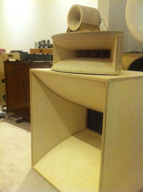

Just about to start Vilvotreter bass using FP 12pr300 driver. The attached pic is not mine, except for the White yuichi 290 horns I built.
What did you think of those Yuichi? Are they used from about 550Hz? Up to where? Obviously you didn't think they were the best match to the TPL-150H. Why?
I admire the pace at which you move forward. I have a hard time finding enough time to move my stuff on. Oh well. 'nough whinning :eek:
Yuichi good from 400hz if driver ok
That pic was a different rig, nothing to do with tpl.

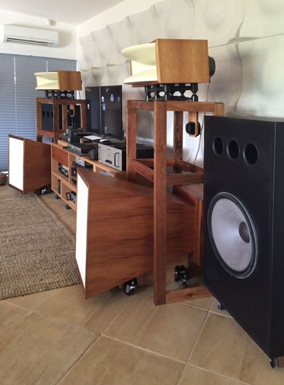

On another Yuichi, see attached, we ran radian beryllium 2 inch driver to 10,000Hz, then small wood turned horn from 10kHz.
I realize it's a different rig. My question was: you like Yuichi from 400Hz and you chose a different midrange horn to pair with the TPL. Why?
OK, to clarify, they were for different end users, not my own system. I love the Yuichi and horns generally personally. My current rig is a massive 200Hz custom horn with Altec "Giant Voice" 290 drivers and smaller tweeter. Bass is 420A Altec in large 250 liter box.

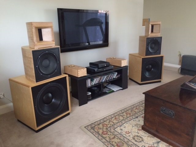

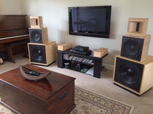

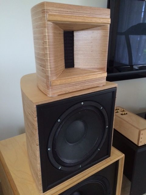

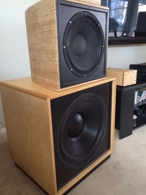

Finally setting up the system for final room testing. Phew.
Need to wire up amp box, then test.

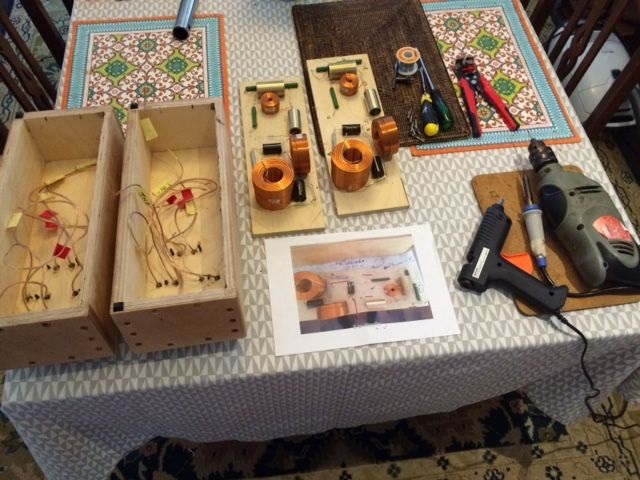

OK, just spent quite a while trimming all the necessary cables (20) in total.
Testing a few CD's now....as I type, Dire Straights, Money for Nothing (loud).
The system is performing very well from the get-go....though a little tight.
The listening room is rectangular, approx. 5m x 7m....I'm listening on the 'short' side...not as good as the long way. However, furniture dictates.
The couch is quite low...and the tweeters are very tall...so I'm sitting on 3 cushions to get better dispersion.
There is a huge amount of output...the bass (mid and LF) is extremely punchy...very different from my big Altec's, which is soft, yet deep. This system sounds more 'pro'.
The upper mid is something I'm getting my ear tuned to, as this is the single biggest difference I'm used to, particularly as I have just finished building the massive 200Hz horns with large format compression drivers. Very hard to compare the two...the horns are airy/tingly/light...this system is more laid back.
The tweeters are lovely...tingly. The sound stage is set back from the speakers, and nicely centred.
Brothers In Arms...nice snare/attack.
I would appreciate some more time for the drivers to loosen up....and if anyone is around Sunday arvo, feel free to visit. Kellyville.
Just played Michael Jackson, Thriller and Billy Jean...wow...huge output and super punchy, frightening...very cool.
