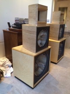

why not swap mid and tweeter positions, or place tweeter next to mid ?
Thanks.
I think a straight swap would be clunky...given the size of the mid bass unit. It weighs about 30Kgs also.
I think the angled down approach is working better...and I'm going to do more adjustment tonight.
I'm also going to assess the original metal Beyma wave guide against mine, as I'm seeing a dip around 3kHz. If I can't adjust this via the xover, and the Beyma wave guide is smoother...I'll probably reconfigure the top unit and insert the original guide. A minor bummer....but we'll see. The system is still sounding pretty awesome. With all the tight bass, it really hits you in the chest...also, because of active sub bass, it plays very nicely at low volumes also...nothing lost.
Thanks.

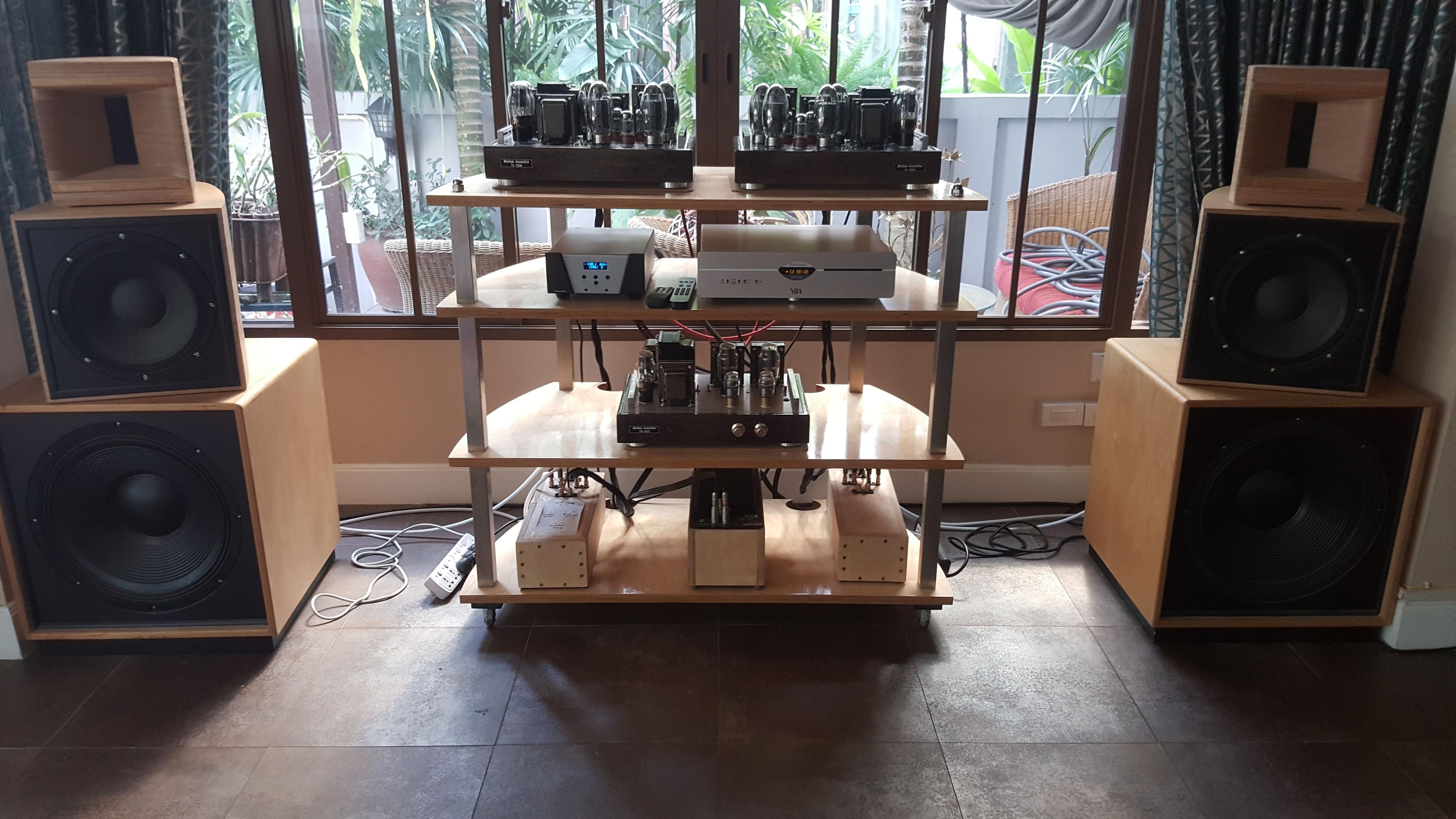

Yep. All complete...now shipped to Malaysia. Client waiting on new valve amps for mid mids/tweeters. Andrew

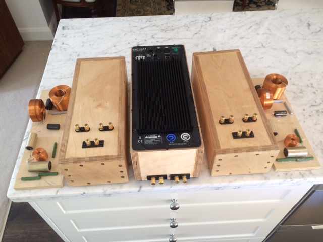

Try to locate/position the woofer boxes above the tweeter, leaving those other two unaltered.
Then, moreover, swap between the two ( mid ( mid:umbrella: 😛 ) and tweeter)
Thanks for the suggestion. The room is very large...and the tweeters are angled down a little to suit the listening position. I think it would be hard to put the mid woofer on top of the tweeter...though I understand your point. Regards. Andrew
